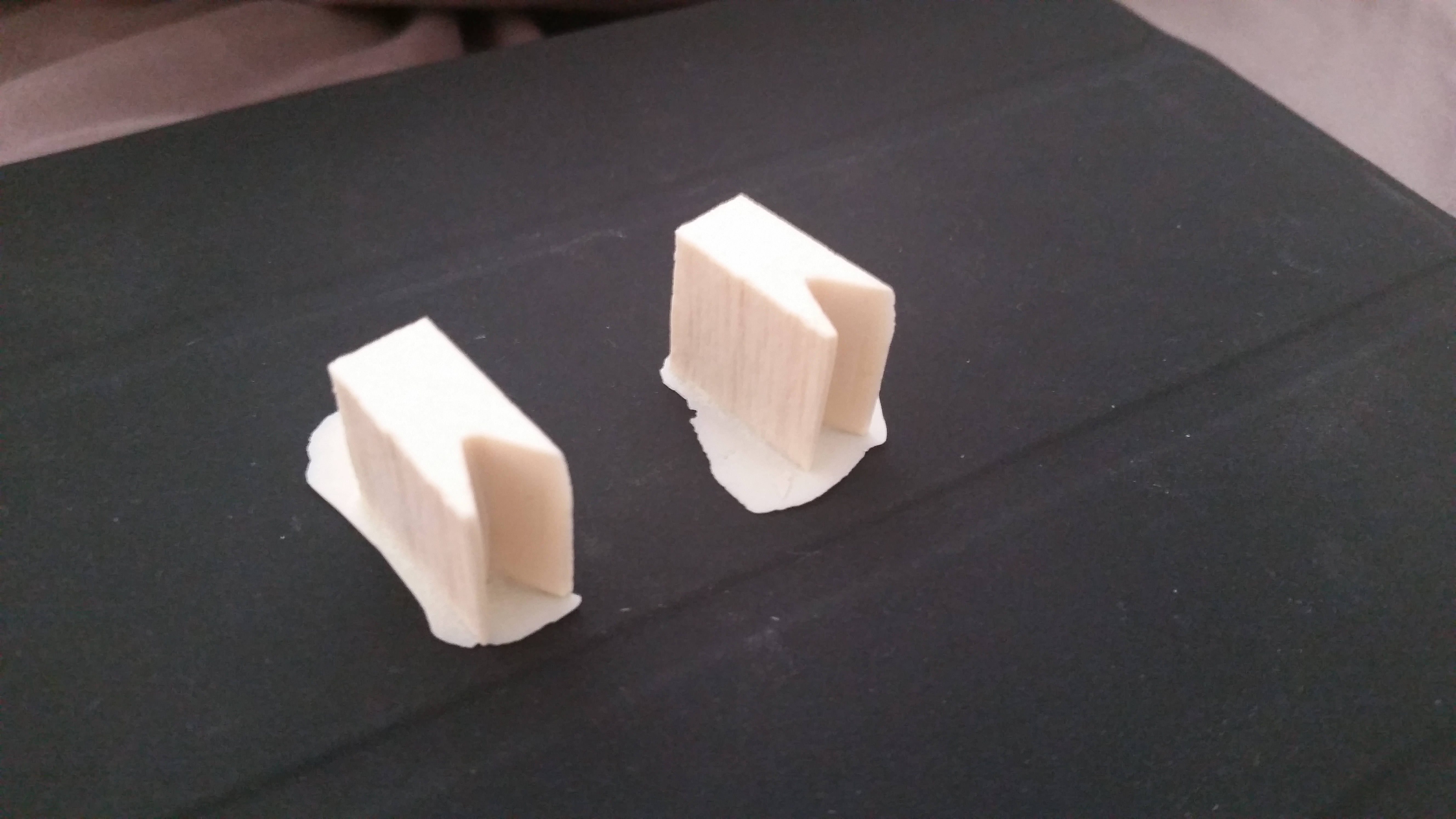

I'm excited to see people posting on this thread and am looking forward to seeing peoples builds coming together. I've identified all the parts on my Red-2 build except these. Can anyone help?
Those hold the armature cover when the wings are open. Basically those parts will be the plug that goes between the armature "arms" in the center. Should hold it together with a friction fit so you can remove it when you want to close the wings.

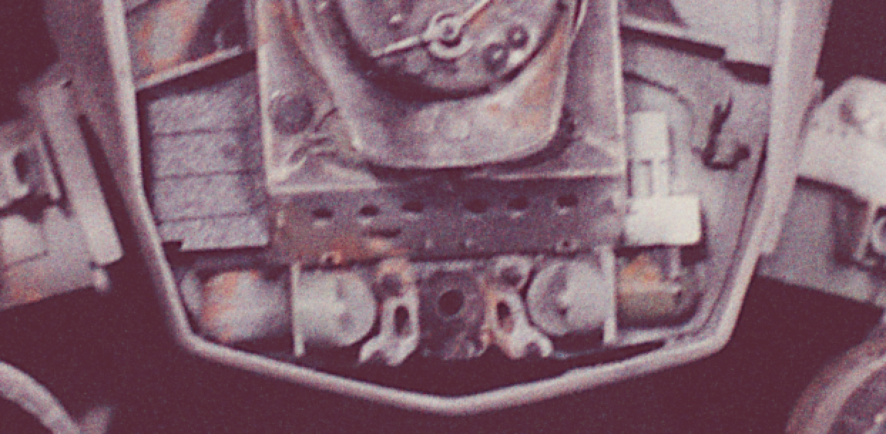

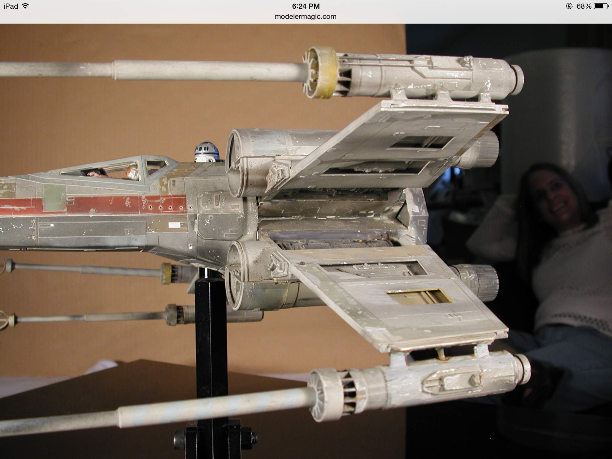

I kind of figured out what those blocks were on mine when I studied the filming models like this Red 3 (see pic). The hinge plates don't seem to be at the same angle as the wings, or maybe not...I can't exactly tell from this pic what angle the plates are at. What do you guys think? Could it have been the hero model method to keep wings open also?

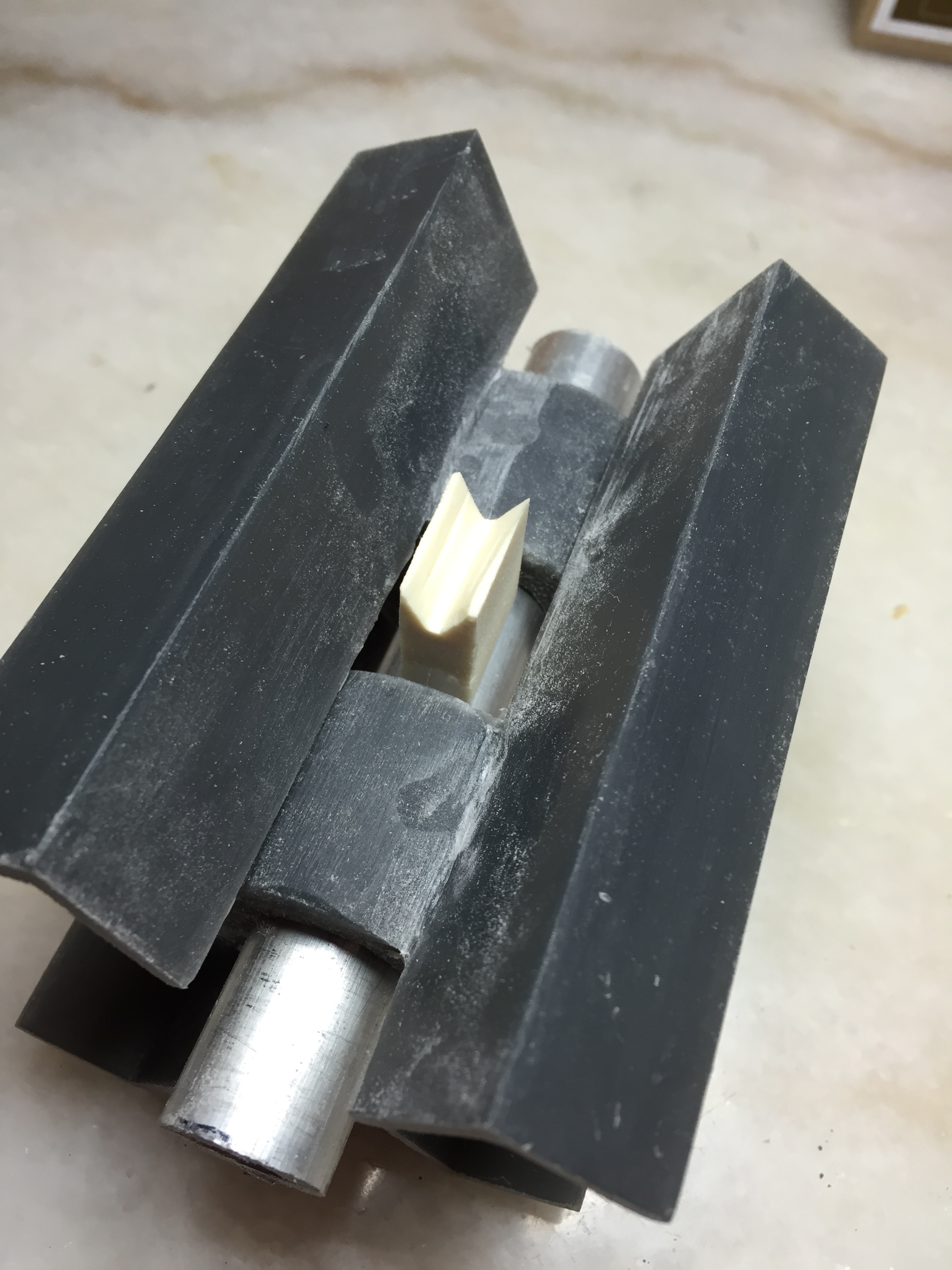

Thanks Mike and Scott. So, is this the block piece here (circled) or is it supposed to be used to set the angle of the plates by using the V shaped cutout?
This is what I think is happening with the block location. I didn't cut the block down yet, so it looks odd and they hinge covers don't sit right on the block. The hinge covers should be at a better angle when sitting into a cut down block.
I could be wrong. Jason and Mike should be able to confirm. It's my best guess as to what's happening there.

I believe so yes!

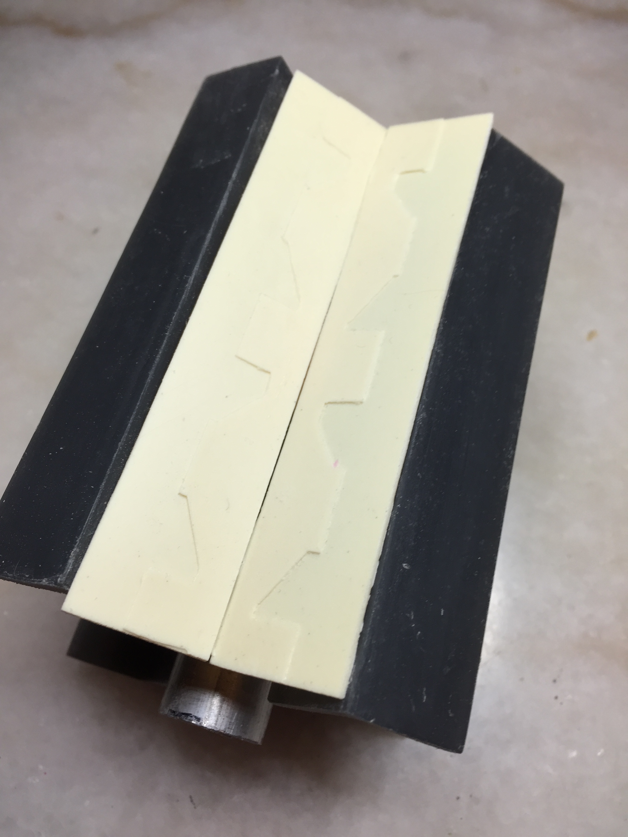

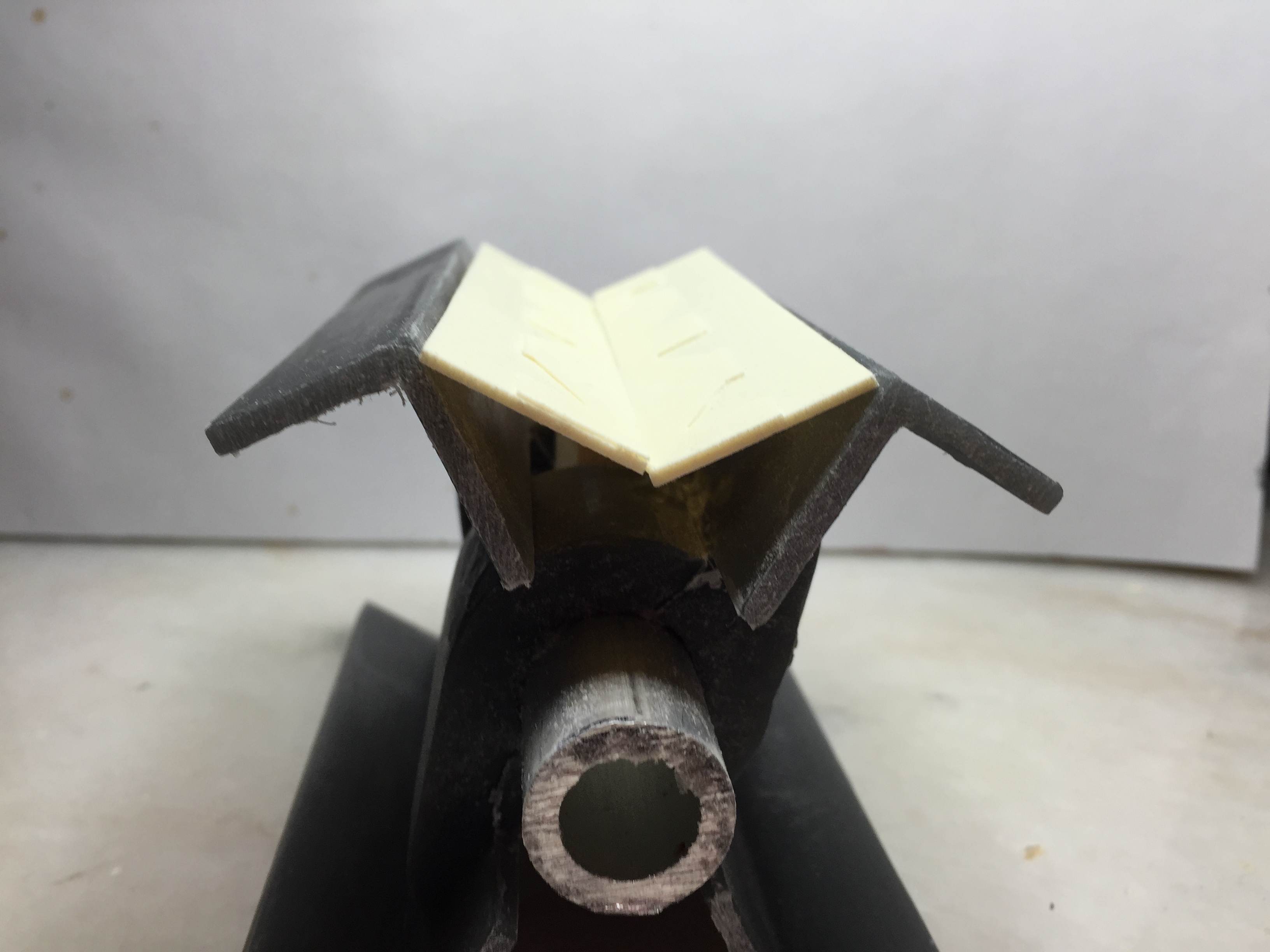

Last time I made one, I made the parts from sheet styrene and taped the back sides to hinge...
The assembly compressed like a sideways "M" with the outermost strips glued to the armature "L" brackets.

Funny that you mention it .. I actually got it out this week end and installed magnets in the wings to hold them in place. Because I didn't want to glue them on the armature so that it would be easy to disassemble it if it needs to be moved! Check my build thread for some updates! Back to topic :)
Great idea Jason! Just wondering with the "M" shaped strips in there permanently are you able to close the wings flush? When I test fit my wings the L bracket closes completely, not allowing a space for a folding mechanism.
I believe mike meant this to be in there only with the wings open - as a plug. That's the problem they must have had in the movie too - that the wings won't close if the detail was in there, but you need the detail in there so you don't see the armature when open. There seems no other way to disguise that armature otherwise.

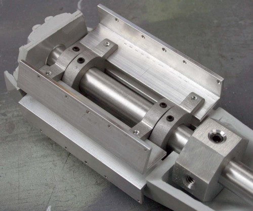

I'm glad the subject of an armature has come up. I've got one of these kits on order from Mike as well and I've been wondering what the options are for mounting it. I see the armature that usaeatt2 posted, but does the kit come with a basic armature? What are different people using?
