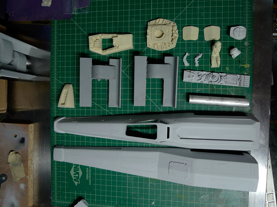

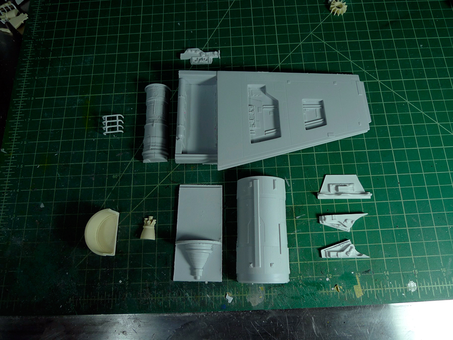

Okay, here's what you'll get in the kit - do a parts inventory.
Everything associated with the body:

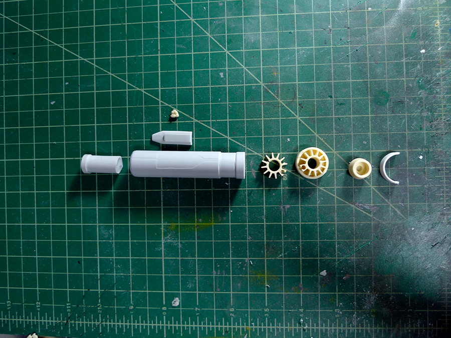

2x for the guns:
4x for the wings:
4x for the engines, and one set of the new-to-this-kit wing inner-hinges

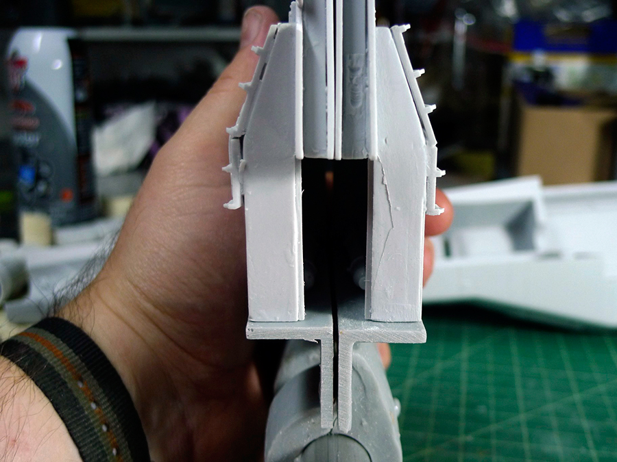

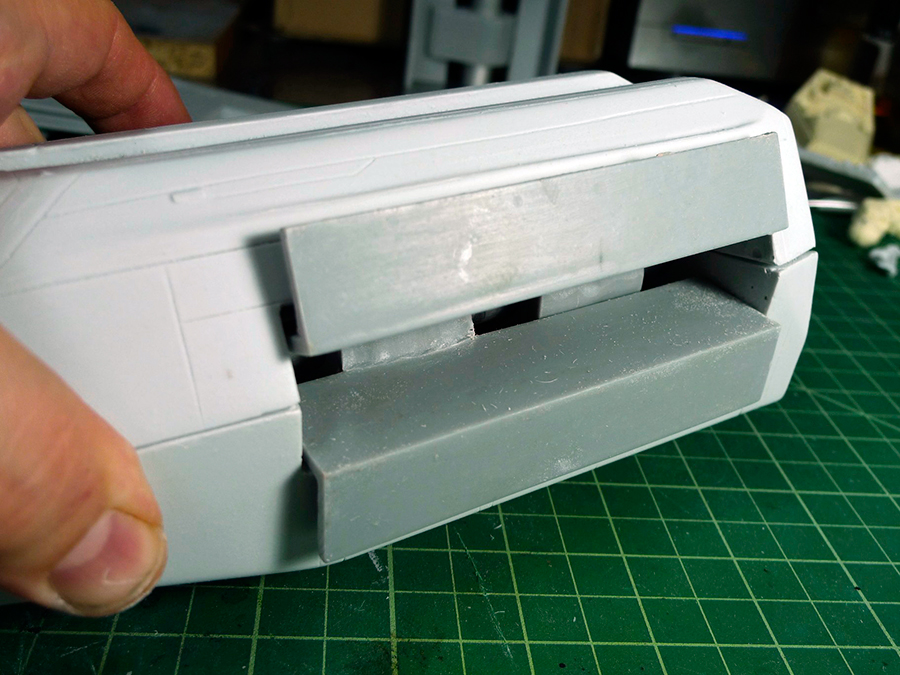

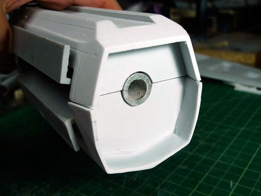

First ensure the supplied hinge assembly fits and operates within the body halves. You will need to sand the hinge halves themselves, and possibly trim the BOTTOM hull recess:
When done, they will close:
And open!
Aluminum bar will sit flush against the rear, which will allow the buttplate to fit.

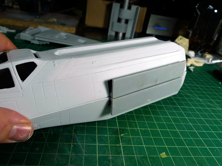

As you can see, the wings will fit nicely against the L brackets!

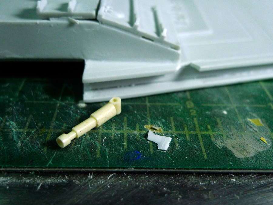

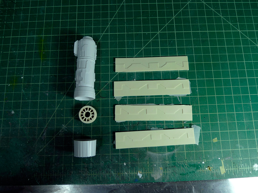

Oh! There are also four of these plant-ons that fit inside the wing's edges (I'll show that later)... I dropped a wing and a chip blew out, so I'll fix that with Apoxie Sculpt shortly. Things happen when you build, so relax - everything can be fixed.
I'll also show how you can add the metal armature, which will require a little routing of the front inner hull, from where the landing gear box was in a previous version. More on that later. You won't need to do this at all if you stick with the resin/metal armature as seen above.

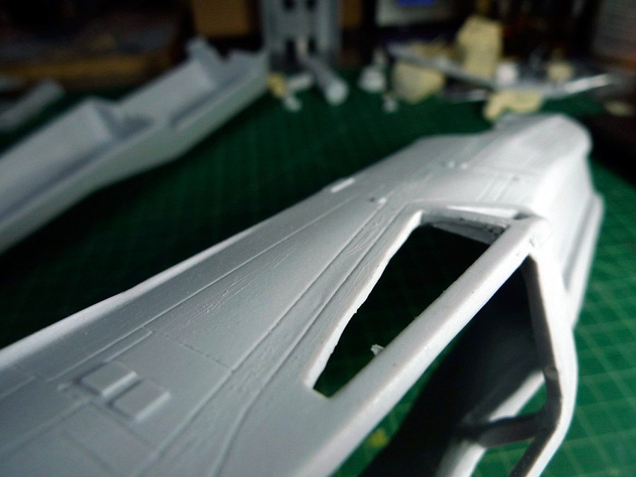

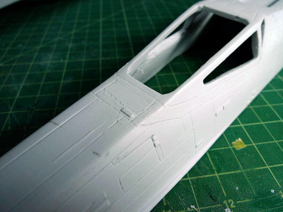

Things to note - you will need to clean up and rescribe some panel lines. I'll do that next.

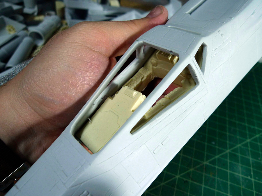

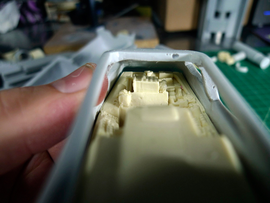

Also, you will need to remove some material from either the inner upper hull or the cockpit insert to get it to fit as high up as you see on the ILM birds. That will also be next:

First just want to address the panel line thing, for some reason a few of the panel lines "grabbed" when i pulled the pattern out of the molds. It has been happening on a number of parts across a couple of different kits that i have poured molds for. I have not changed the way i do panel line scribing, so i don't know if it's a new formulation of the mold max 30 (it has happened thru at least 2 or 3 recent batches), or some other weird thing. I thought about making a new set of molds for the fuselage, but since i have no way of telling if it would just happen again decided against it (these molds are big).
If you go slow and use a reversed broken tip #11 exacto, it should only take 10 minutes of clean up to fix. I kind of hate sending out kits that need something like that, but figured it would be ok.

I don't want to get ahead of myself here, but this is my first Salzo or SS X-Wing build. By the looks of the above included pieces I'm guessing we need to buy the tubing for the laser cannons on our own. Is there somewhere that I can find the length and width for cannons?
