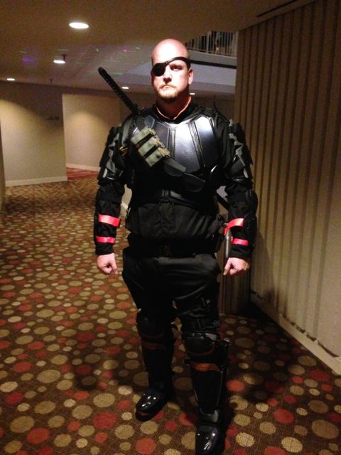

First, here are a few shots, from left to right (Full body shot, without the helmet [I got a patch to do casual time], and my group with George Perez):

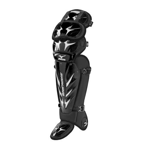

Knee Pads
The knees are modified from
Mizuno G3 Samurai Shin Guards.
I removed the top two pads, and the bottom ankle protectors. For the bottom ankle protectors, I re-sewed the trim back over the foam to make it look like it was meant to be that way. I painted Plasti-Dip over the visible logos (foot cover, and between the knee and shin guard), then used Plasti-Dip Glossifier to make it look like the rest of the existing leather in gloss.
I added some foam to simulate the details, then wrapped it in vinyl.
View attachment 374034 View attachment 374033
I used 3M MATTE COPPER METALLIC M229 Scotchprint Car Wrap Vinyl Film 1080 Series to give the orange look:
With some furniture tacks for the details, here's my final guards:
I drilled holes in the foot guard to allow chicago screws to hold a leather strap to keep the foot guard on the boot. I did not get around to the nylon strap to help keep the leather strap back, and on my second wearing the chicago screws worked their way open, and so I need to replace them (and why they're not pictured).
