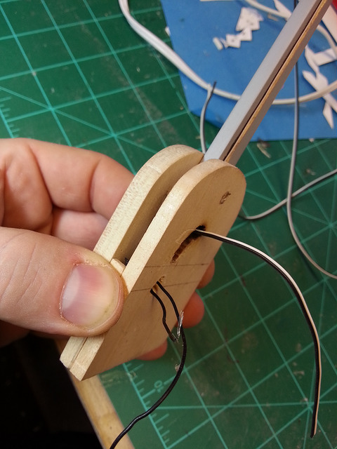

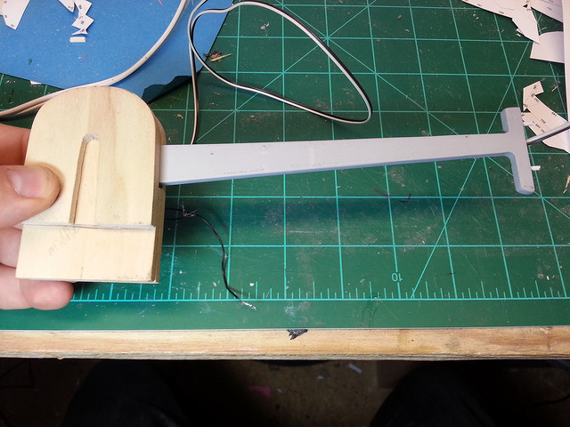

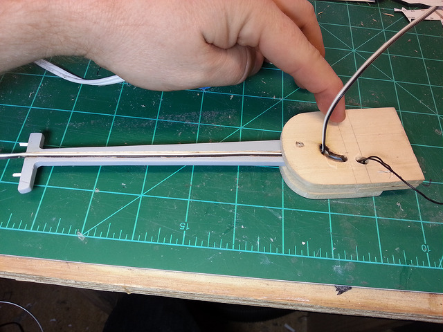

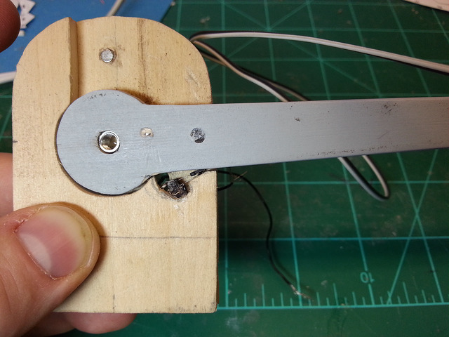

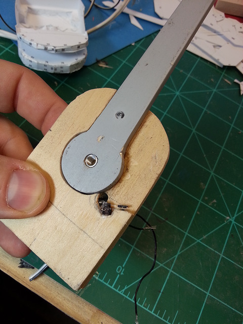

Here's the low-down on the electronics for the range-finder. Again, I kept this VERY budget. I had an extra set of battery-powered LED X-mas lights on-hand that I wanted to have light up when the range-finder was down. But in order to do that, I had to get power from inside the helmet all the way up the swing-arm to the range-finder. So, I took some wire I had on-hand, cut a groove into the swing-arm and glued the wire into the groove.
You can see from the above photo that I've left a curved hole for the power wire so it doesn't bind as the swing-arm moves up and down. The other wires you see are coming from a tiny micro-switch I tore out of an old disposable camera (those things have all sorts of cool parts btw). The point of this switch is to turn on the lights automatically when the arm is down.
Here's what it looks like with the swing-arm up (held by rare-earth magnets):
...and here's what it looks like with the swing arm down (circuit closed).

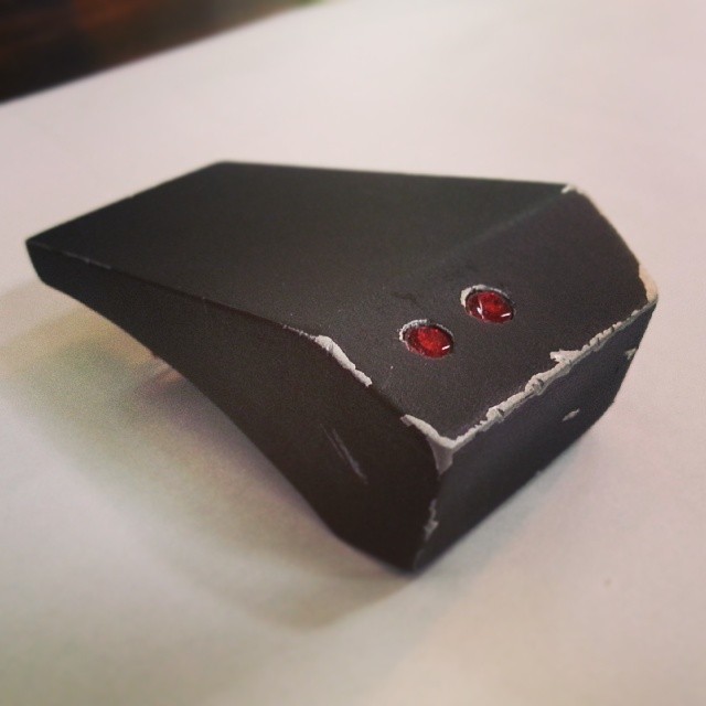

After this I painted the range-finder silver, used a blocking agent on certain areas and then gave it a coat of black paint. When the areas with the blocking agent were removed, you get this very nice 'chipped' look. Adding a few 'scratches' with rub-n-buff helps too.

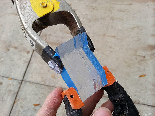

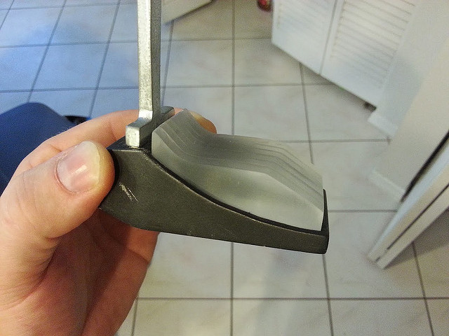

Then I had to make the lens for the range-finder (cheaply). So, I just took some plexi-glass and cut a series of pieces that I sandwiched together to make the lens.
After a lot of belt sanding, it finally fit into place. Not screen-accurate by any means, but for a project costing less than $50 (total), I'm happy with it!

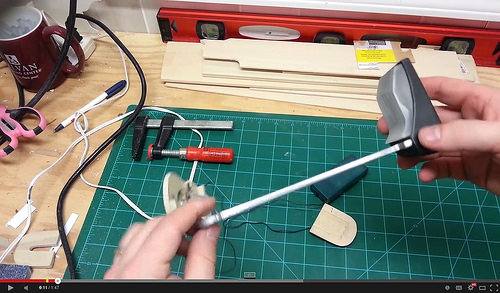

For a complete break-down of the parts/electronics/wiring, here's a short video walk-through I did:
https://www.youtube.com/watch?v=2TP9gk4KelE
