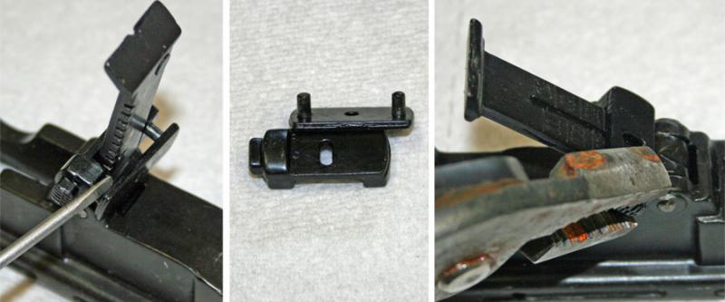

REVERSE THE REAR SIGHT
The sight is made from 2 halves that are held together by 2 molded pins and friction force. When separating the halves, work both sides a little bit at a time or you could break off a pin.
- Use a flat tip screwdriver to pry the rear sight apart by wiggling it into the seam between the two halves
- Move from one side to the other separating it a little bit at a time equally until it pops apart
- Reverse the sight so the molded release button points to the right as you hold the gun and press the two halves back together with pliers
- IF the friction is not enough to secure the sight, use a small dab of glue on each pin.
