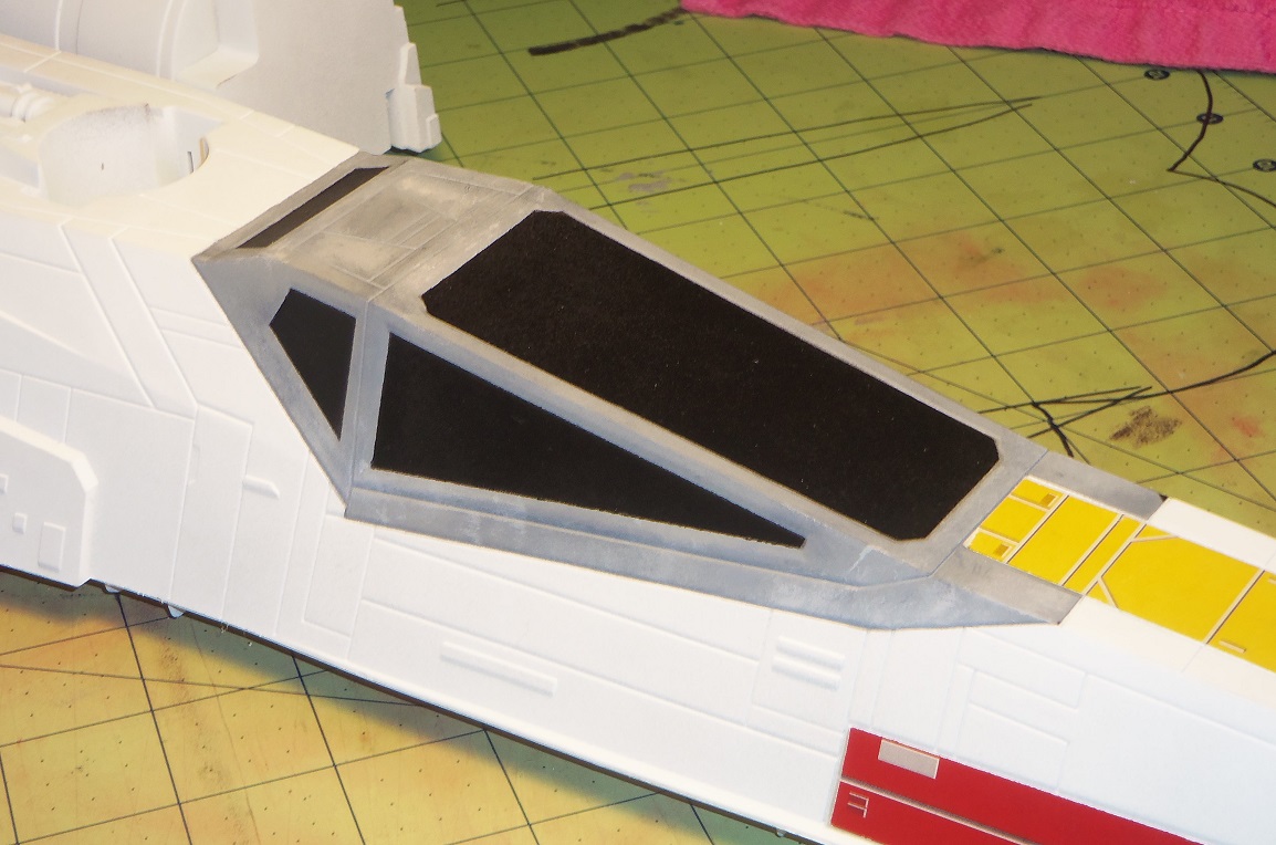

I've yet to see one of these things on the shelf where the cockpit decals are not peeling off but i am really looking forward to what you guys can do with these.
Yeah, the cockpit stickers are crap. They definitely have to come off. I've been working on my cockpit this morning. Here it is so far. Still needs a little work, but it's getting there. 100_0421.JPG100_0421.JPG

Wow, Albertese, how did you get that cockpit cut out so clean? I think doing that cut that good and building an interior cockpit is a little above my skill level at this point. I think I am just going to go for the black windows right now. I guess I could always come back to it later, but since I am doing two of these I'll just let it be for the time being.
Good job, though!!
