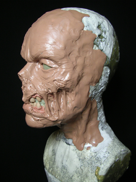

While working on my 1/1 Predator moulds, killing the dead moments so to speak, I started this 1/1 scale sculpt. Again I use polymer clay like Fimo and Super Sculpey. As a starting point I used a foam head, wich I carved out here and there and covered with epoxy to become a smooth surface. This helps the clay to stick better. The eyes are Aves Apoxy sculpt, the teeth baked polymer. I added some more teeth in a later stadium. If I manage to finish the sculpture bij saturday, I will have spend a week on it.

Nice work. Will you bake that once it's finished? If so how do the teeth stand up to a second bake?
I don't think I will bake it. My experience with the Predator head showed me it can be perfectly moulded while still soft. To answer your question about the teeth: There would be no problem to bake them a second time. Most of my smaller work is done with polymer and since I work in layers, they are often baked as much as 10 times.

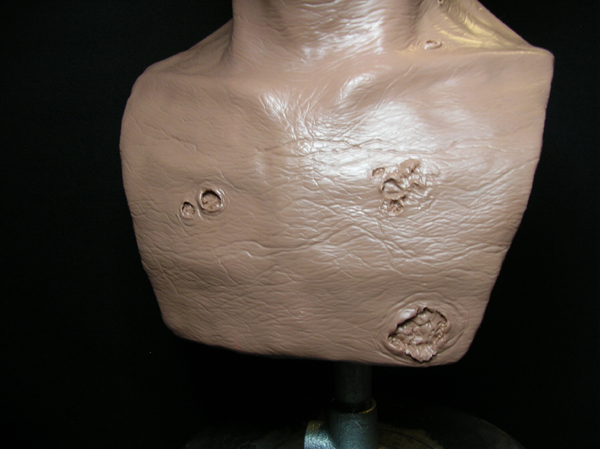

The Predator moulds consume most of my time now, so this one will gow slower now. I finished the frontside of the torso.
