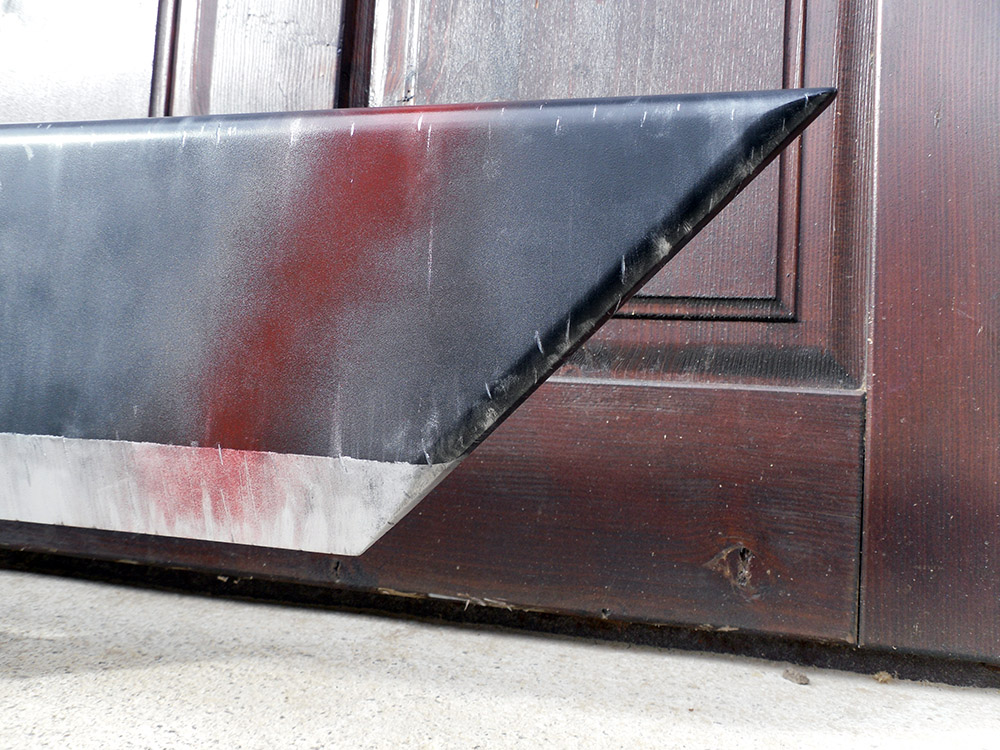

Also, there is a red line on the end of the sword during the beach attack that isnt there on promo shots. Probably blood splatter, but could be painted (check middle picture) like Rita's suit. It's on both sides of the sword.
I finished the build a few days ago and made a fancy stand for it too. I decided to make the end of the sword look finished rather than cut off. And I painted the red line on the end.The white "UDF" graphics are mostly made up.
