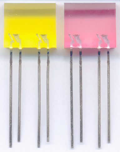

Studying the photos, I see that the prop was made using at least 4, possibly 5 or more different physical styles of LED "blocks" (multi-emitter light bars and single-emitter units), many of which were stacked together to form larger blocks. Checking my electronic components stash, I found that I have 2 of the large 2-emitter style LEDs, but the prop needs many more. A local friend may be able to help me get another handful or so, but not enough for the complete prop. I've had no luck at all yet on the 3-emitter lightbars, but I have discovered that the smaller 2-emitter lightbars and the square single-emitter units are still being made. I also managed to get one of the "T-shirt flasher" kits that apparently may have been used as part of the real prop's lighting control circuit. I believe I have enough acrylic in all the right colors to make the basic case, and sufficient electronics knowledge to build the lighting circuit, if only I knew more detail of what the original circuit was. For example, exactly how were the LEDs wired? Were any current-limiting resistors used, and if so where are they? How did the T-shirt flasher connect to the EPROM? How were the "touch switch" controls implemented, and what did each of them do?

All right, if that's the way it has to be, here's some info on LEDs still available:
Kingbright.com styles WP1553EDT (orange), WP1553GDT (green), WP1553IDT (red) and WP1553YDT (yellow); all 5 x 5 mm square
and Kingbright.com styles WP835/2GDT (green), WP835/2IDT (red) and WP835/2YDT (yellow); 2-emitter 5 mm x 10 mm light bars.
I believe the LEDs that face out the back of the prop may be the 5x5 mm style, ground down to the minimum height practical without damaging the emitter. Oddly, most of the replicas I've seen posted seem to lack those LEDs; there are roughly 14 of them glued on the inside, rather than the outside, of the clear main body. There is also an additional green one installed in some versions of the prop in the same manner facing out the front, to the right of the large touch switch array.
The 5 x 10 mm light bars are not the main large ones that make up most of the prop's lights; they are slightly smaller. There appear to be three or possibly five red ones used. There is a square yellow block of 4 emitters (appears orange in some photos) which may be two of these, or it may be 4 of the 5 x 5 mm units, or it may be a single 4-emitter unit. One version of the prop has a similar square red block of 4 emitters directly on top of the battery (in place of the pink/orange acrylic square). Between two of the other red 5 x 10 mm light bars appears to be an orange 5 x 10 mm light bar, but since that color is not currently offered in the WP835/2xxx series, two of the 5 x 5 mm single units should work as an acceptable substitute.
It should also be possible to use some combination of the above LEDs to "fake" the 3-emitter light bars -- a cluster of 5 green ones at the top center and a pair of red ones ground into a "ramp" shape at the left center just at the top edge of the battery.
All of this means that it's now possible to easily replicate the original prop's physical appearance with decent accuracy, except for the large 2-emitter LED light bars which unfortunately make up the majority of its front face. I have written to Kingbright asking about availability of the other styles we need but received no response.
Kingbright's stock on some of the above are currently rather low, but other distributors carry them so an internet search should be able to find you what you need using the part numbers.

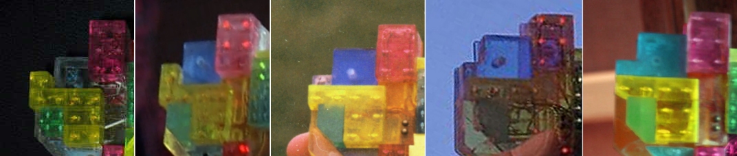

Here are a couple bits of detail that changed from time to time:
These images are, from left to right:
  1. Prop photo, Gene Crowell via Al's Place
  2. Screenshot, Liberation (ep. 86) {this portion of the prop appears identical in The Leap Back, ep. 53 also}
  3. Prop photo, Mark Dickson
  4. Screenshot, Lee Harvey Oswald (ep. 75)
  5. Prop Photo, The Leap Back Convention display 2009 (photo by Morgan Feldon, prop owned by Deborah Pratt*)
First, the small green section near the top left corner of the prop (bottom left of these detail images)--
In (1) it looks like another of the 4-emitter 10 mm square blocks that may be made of 1, 2 or 4 individual LED "packages" as described in my previous post #6 above. In (2), (3) and (4) it looks like the same thing, but with material added at lower right to give it the 45 degree mitered shape, and a frosted layer added on top. If you look carefully at (2), you can still see the 4 LED emitters inside. This appears to be the only part of the handlink that ever has this exact color and texture. In (5) it appears that there are now either no LED emitters inside, or there may be two of them arranged vertically in the center. I'm more inclined to believe that the apparent vertical line is merely a reflection/refraction off an interior edge of the clear acrylic body of the prop. The color of this piece also seems to have changed somewhat, but it's hard to be sure just from this photo.
Next, the yellow LED blocks--
In (1) and (2), there are nine total emitters here. How did the props makers accomplish that; was there a square, single-emitter version of these LEDs larger than 5 x 5 mm? Or did they simply cut one of the large 2-emitter light bars in half? (I vote for the second option.) It appears that the extra single-emitter square was added on as the "tail" piece sticking up at the left end. Unfortunately, being right on the corner of the prop where "Al" would often smack the balky handlink, this is a vulnerable location for such a small part to be stuck on -- if I had been the builder, I would have wanted to use a normal 2-emitter block for the "tail", and put the single-emitter unit between that and the other group of three 2-emitter bars. Other versions of the prop (3), (4), (5) show this upward "tail" LED is not present -- perhaps Mr. Stockwell broke it off and it was never replaced, or perhaps it was omitted due to its vulnerability. In (5), and possibly (4) also but the photo isn't clear enough to be sure, the blue acrylic tile beside this position has been replaced with one reshaped with a "tail" of its own to fill in the "hole" left by the missing LED "tail". Also noteworthy in (5), the leftmost of the 2-emitter light bars has been reshaped at its lower left corner apparently by grinding it away at about a 30 degree angle, and the blue acrylic tile no longer appears to have the screw hole drilled all the way through it.

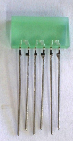

I found a current maker of what may be the correct style of 10 x 10 mm square, 4-chip LED blocks found near the upper left (green) and upper right (orange - a color they don't currently offer in this style) of the prop -- SunLED. Unfortunately, they don't appear to have any retail distributors: there seem to be about 5 commercial distributors of their product lines, who only take "RFQ" (Request For Quotation) production orders, with typical minimum quantities of 1,000+. Interestingly, SunLED also make 5 x 5 mm square single-chip and 5 x 10 mm 2-chip units that look just like Kingbright's. In addition, SunLED make 3-emitter light bars, but they appear NOT to be the correct ones used in the handlink; the correct ones have 4.5 mm spacing between emitters, but SunLED's have 6 mm spacing. I know that doesn't seem like much difference, but it is a +25% increase and I guess you could call me a stickler for accuracy in some respects.
EDIT: SunLED now has a retail distribution agreement with DigiKey, but DigiKey does not list all of SunLED's products, and most of those that they do list, are shown as "non-stock" with minimum order quantities in the hundreds. So we're still mostly out of luck.

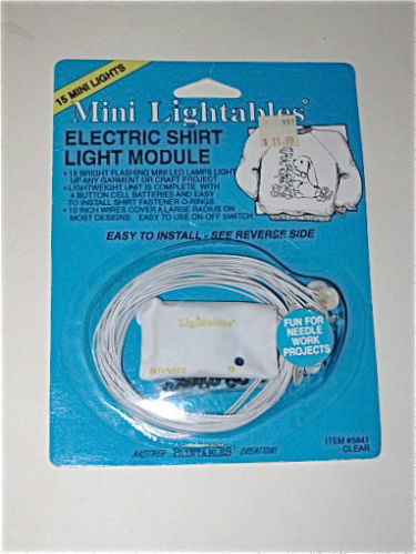

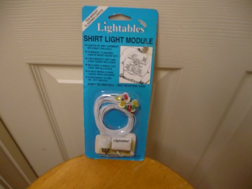

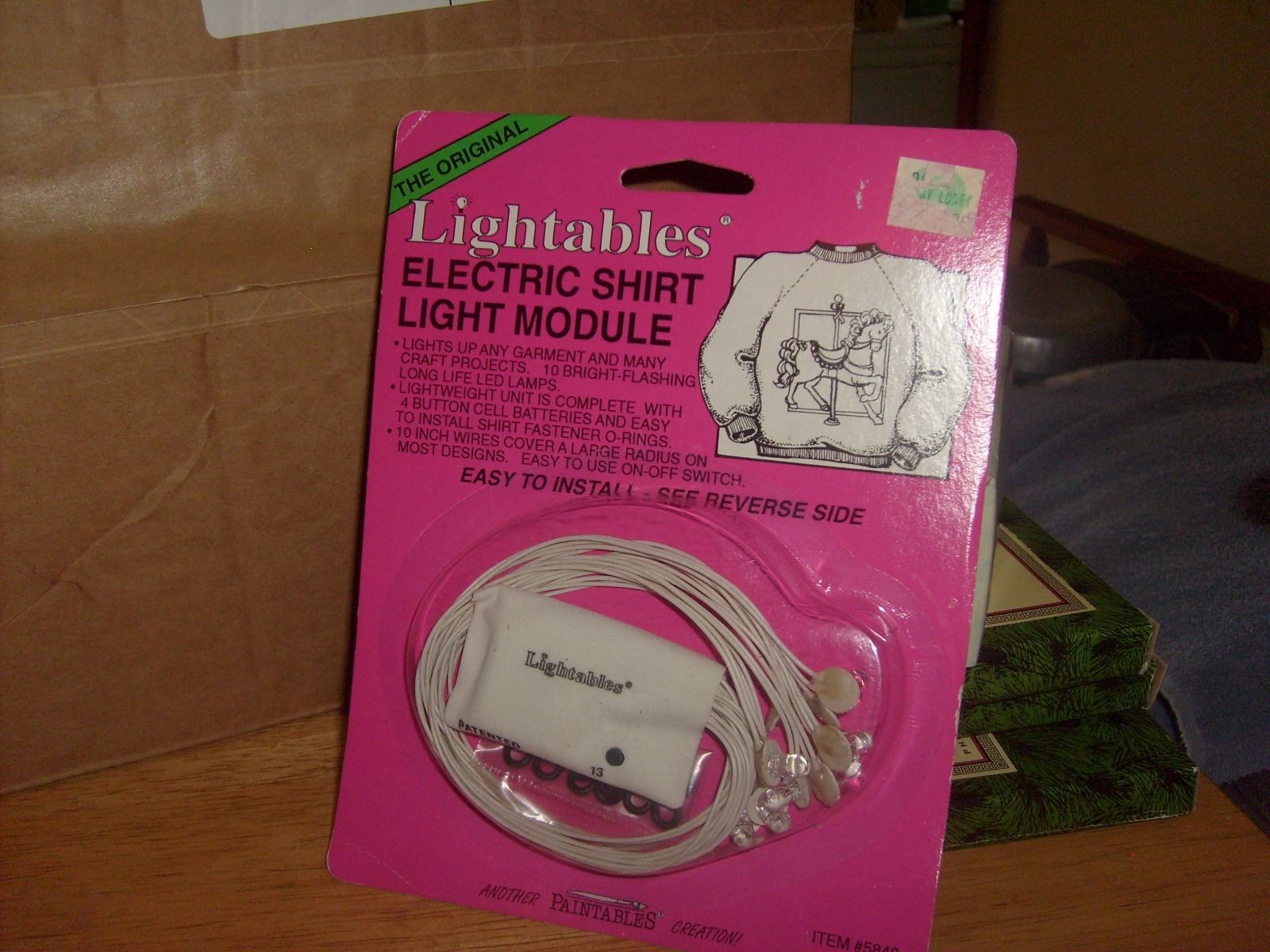

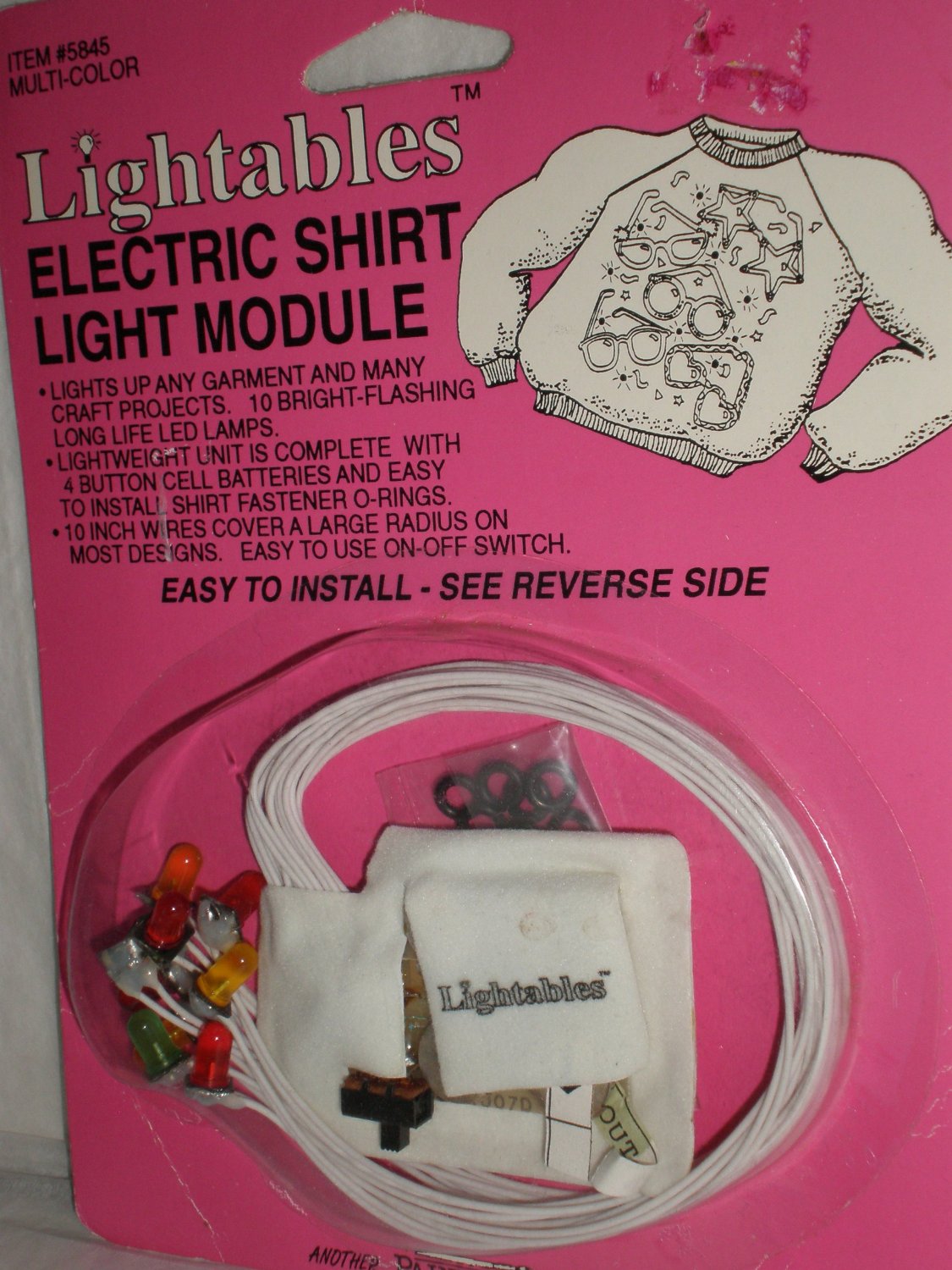

Just in case I'm wrong on that last point, another minor addition: I have found alternate versions of the "T-shirt flasher" circuits, called "Lightables" by a company calling itself "Paintables". Here are some package variations. Three are 10-LED versions, while the "Mini Lightables" version has 15 LEDs. These seem to still be fairly widely available, so I'm done posting on the subject. Also, I read at Al's Place where Cyland Props alleged that only "less-than-hero" versions of the handlink used these pre-made circuits anyway.
Lightables Mini 15.jpgLightables 10c.jpgLightables 10b.jpgLightables 10a.jpg
