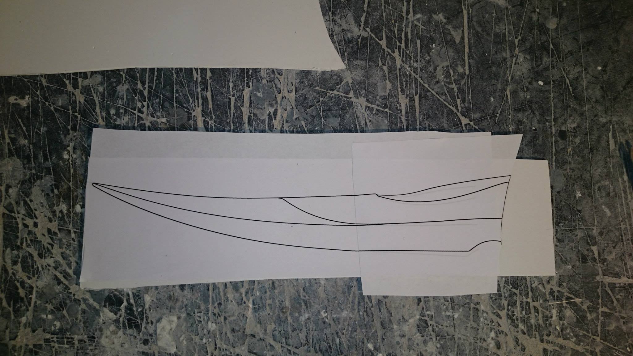

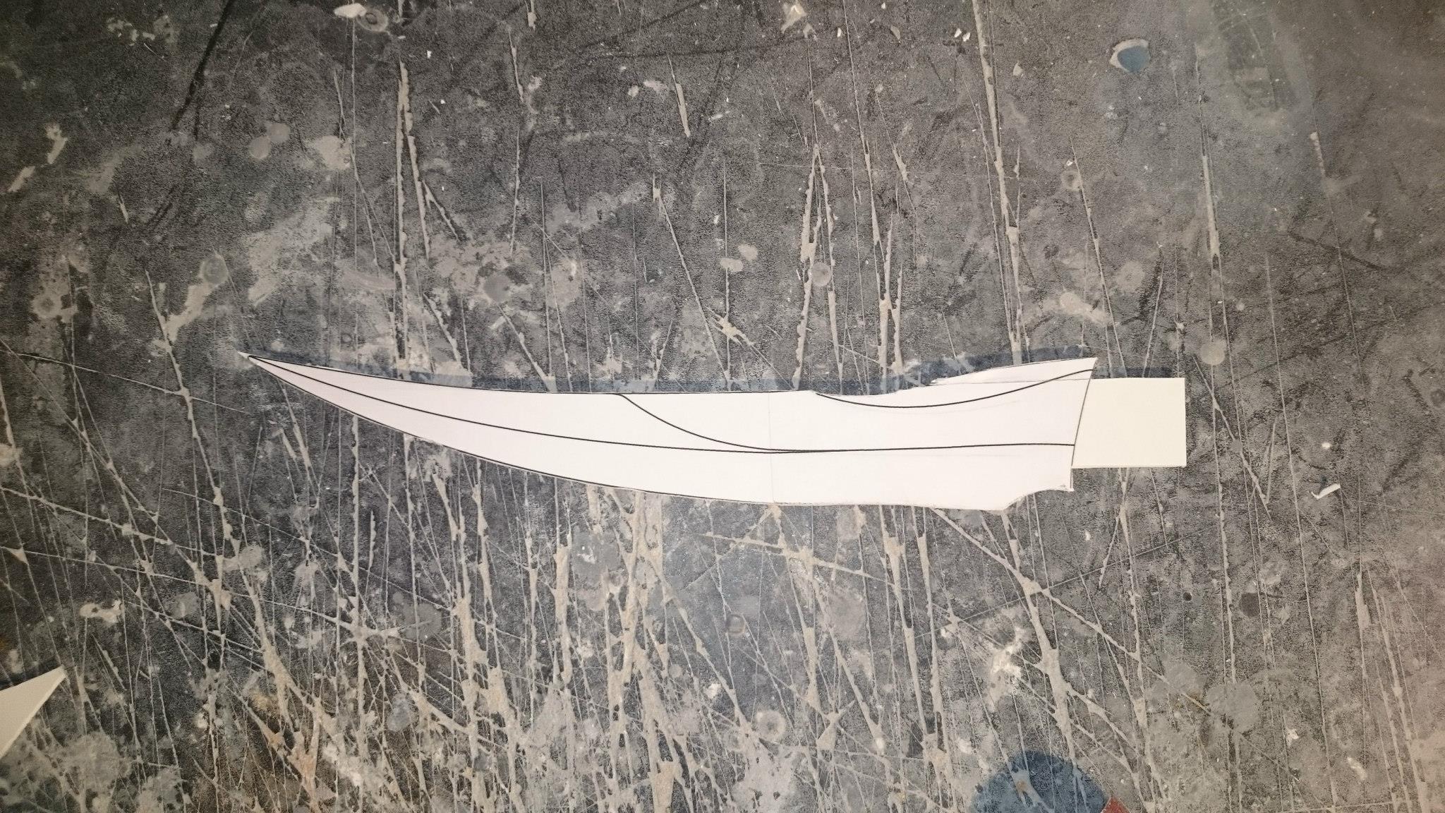

I started obtaining the shape of the blade and the handle with forex from 05/64 "
10540584_843170812368654_8877365202195671171_o.jpg10572187_843170815701987_2055973822025825696_o.jpg10517651_843170895701979_2963736261318824001_o.jpg

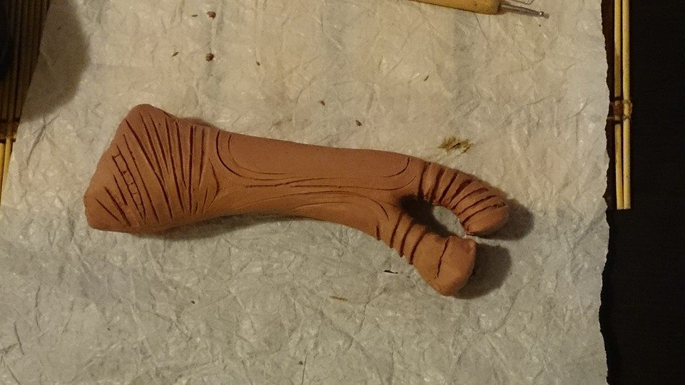

A draft of the handle plasticine and a first test assembly.
10557613_843170929035309_8496649274164253873_o.jpg10580713_843170962368639_2669227875912827911_o.jpg

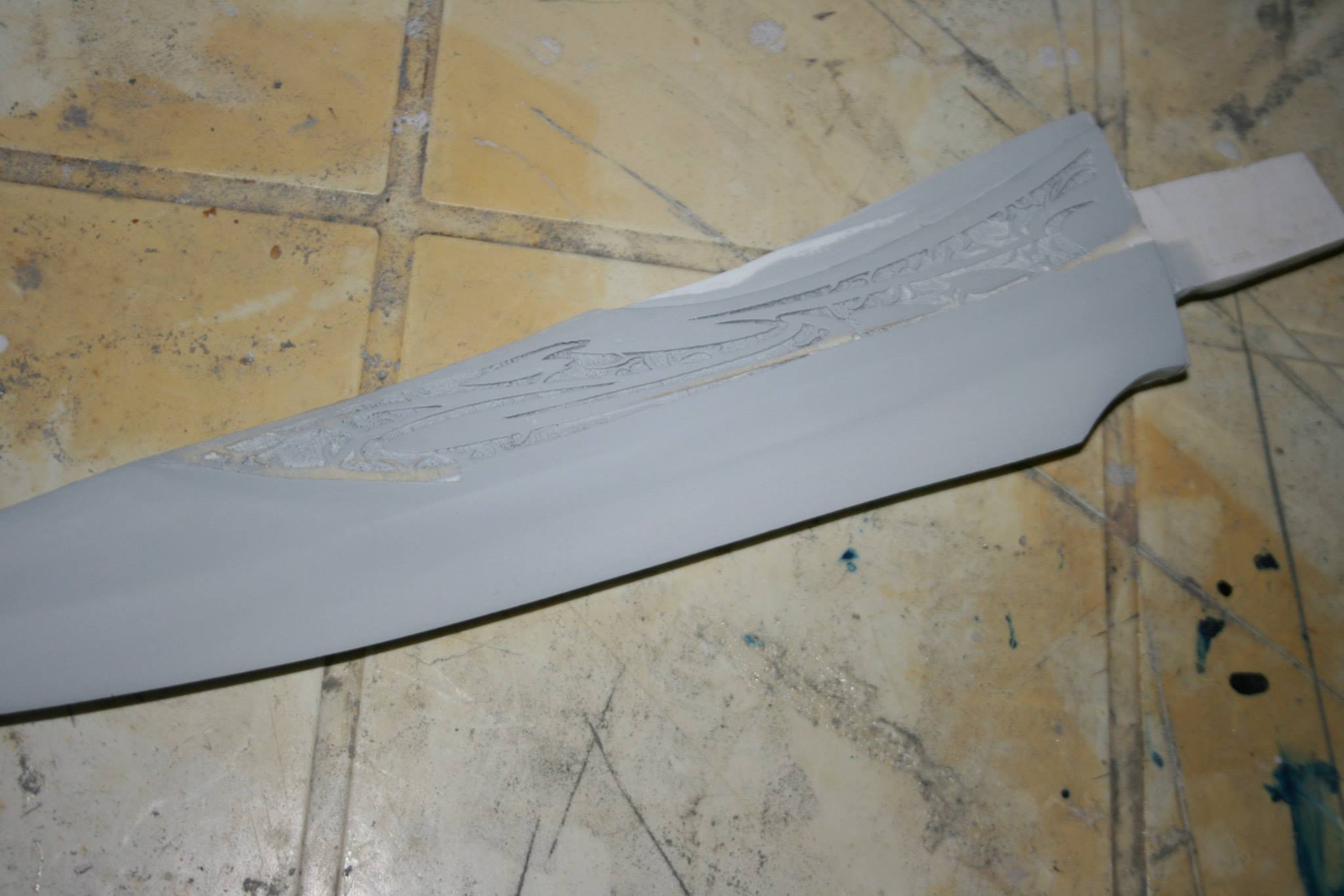

Adding the part of the blade above the decoration.
10495294_844261562259579_1901248128966088942_o.jpg10514161_844261552259580_5084668881935858922_o.jpg

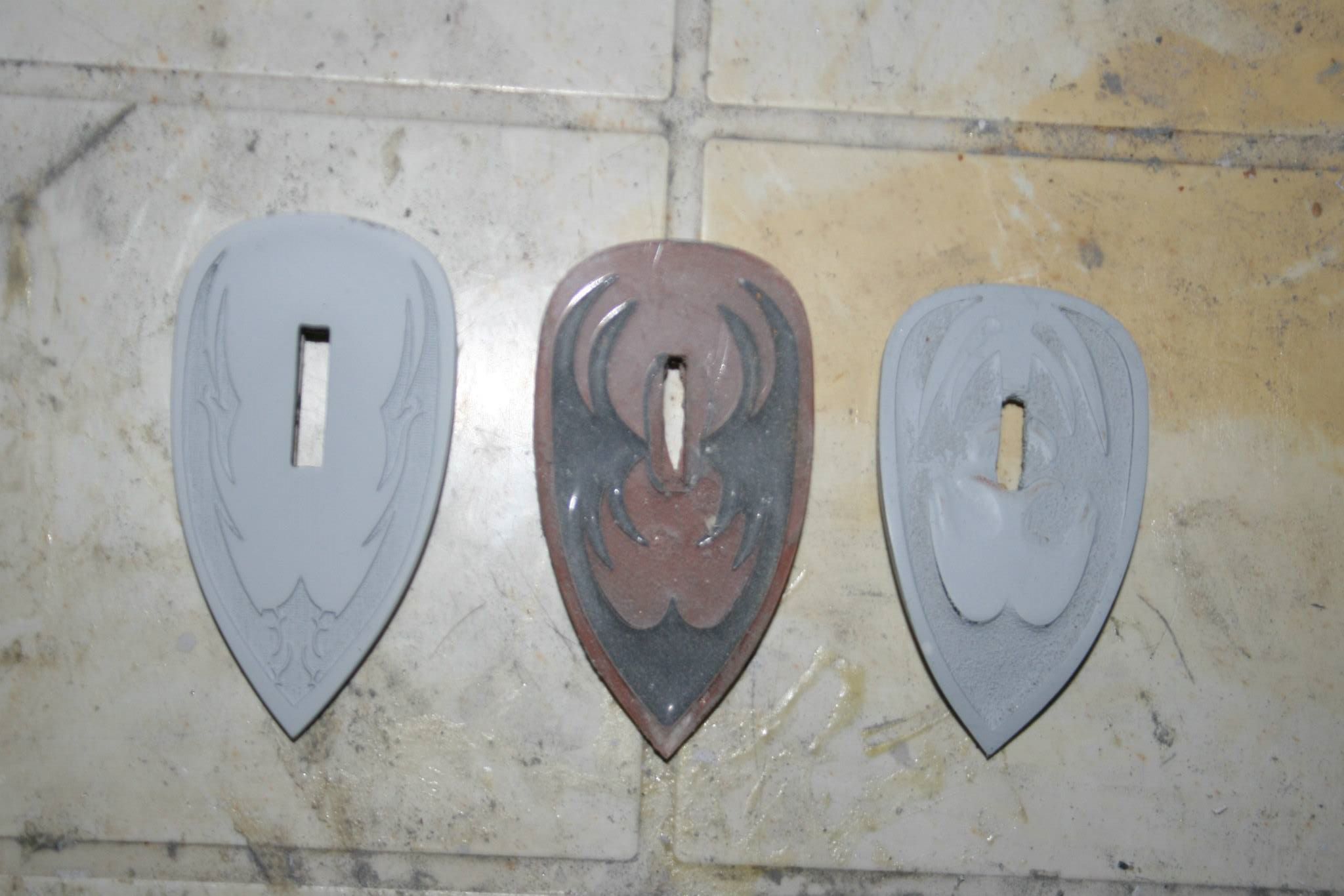

Marvel has made ​​public the pictures of Props officers GOTG, so for the third time I had to redo the flange daggers Drax.
Now, however, is perfect.
53e3c9ba16caa.jpg1518231_855808134438255_2524296768924491920_o.jpg10628792_855808114438257_2155759390315978265_o.jpg10481688_855808124438256_3797297040923149072_o.jpg
Here are three versions to compare

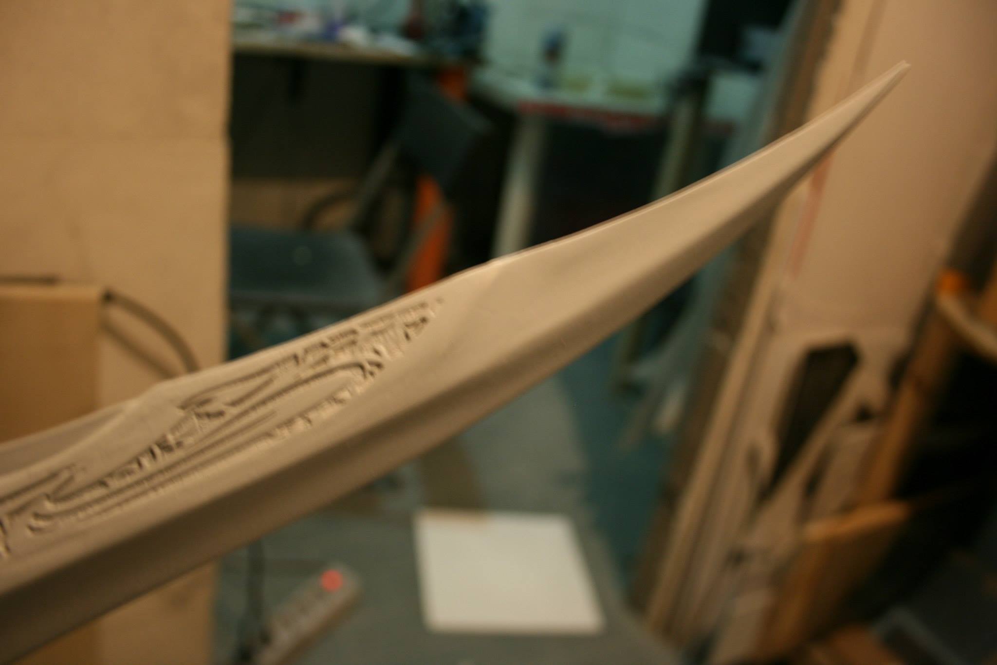

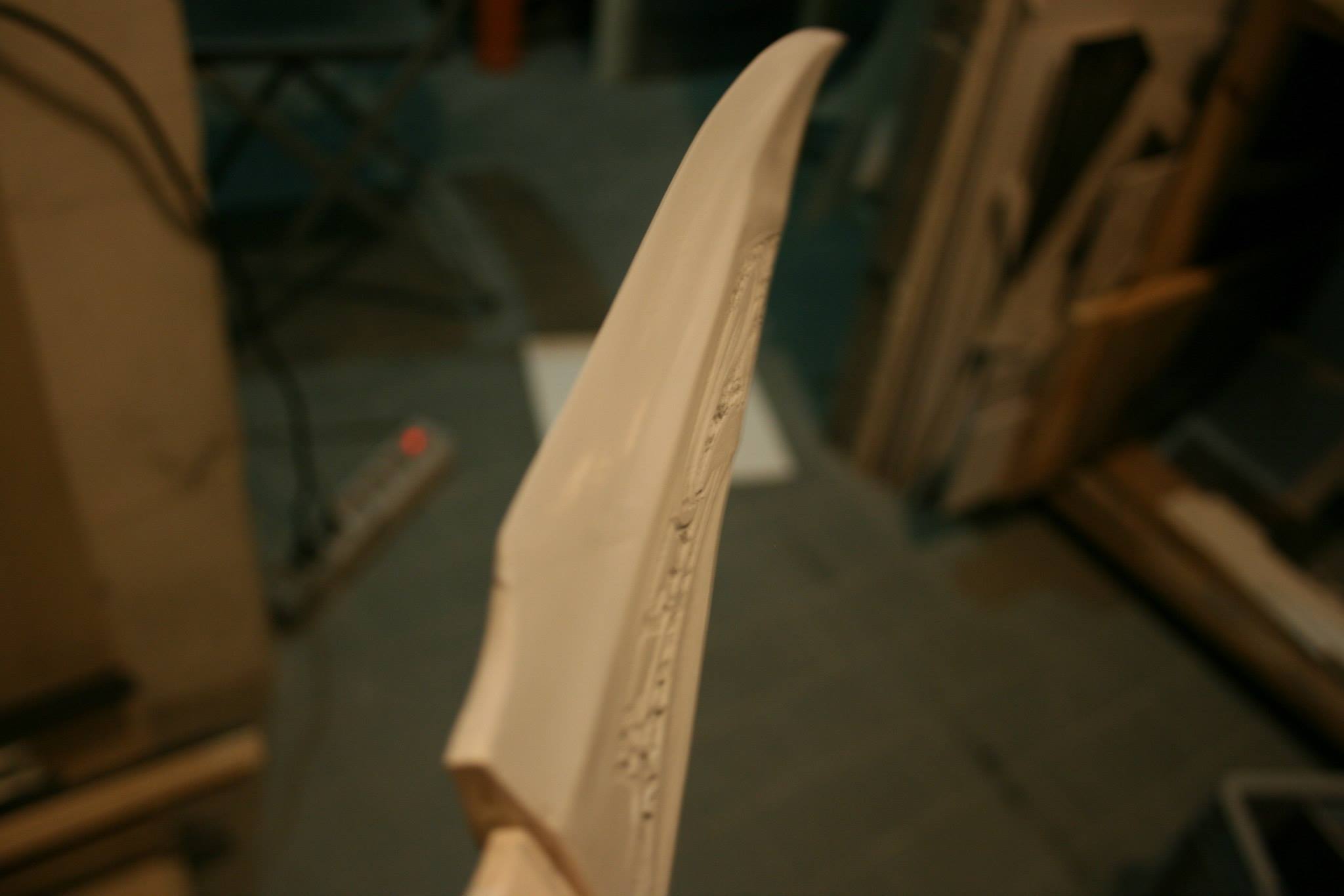

Then I also had to thin the top of the blade, since there are no pictures had made it very thick.
10623361_855808284438240_2431283460055375133_o.jpg1529842_855808411104894_5018471416281365029_o.jpg10623357_855808471104888_5224984255213764133_o.jpg10552421_855808504438218_2306144005343192629_n.jpg1900034_855808571104878_8742293037777733483_n.jpg10583895_855808661104869_1833049148562520680_n.jpg

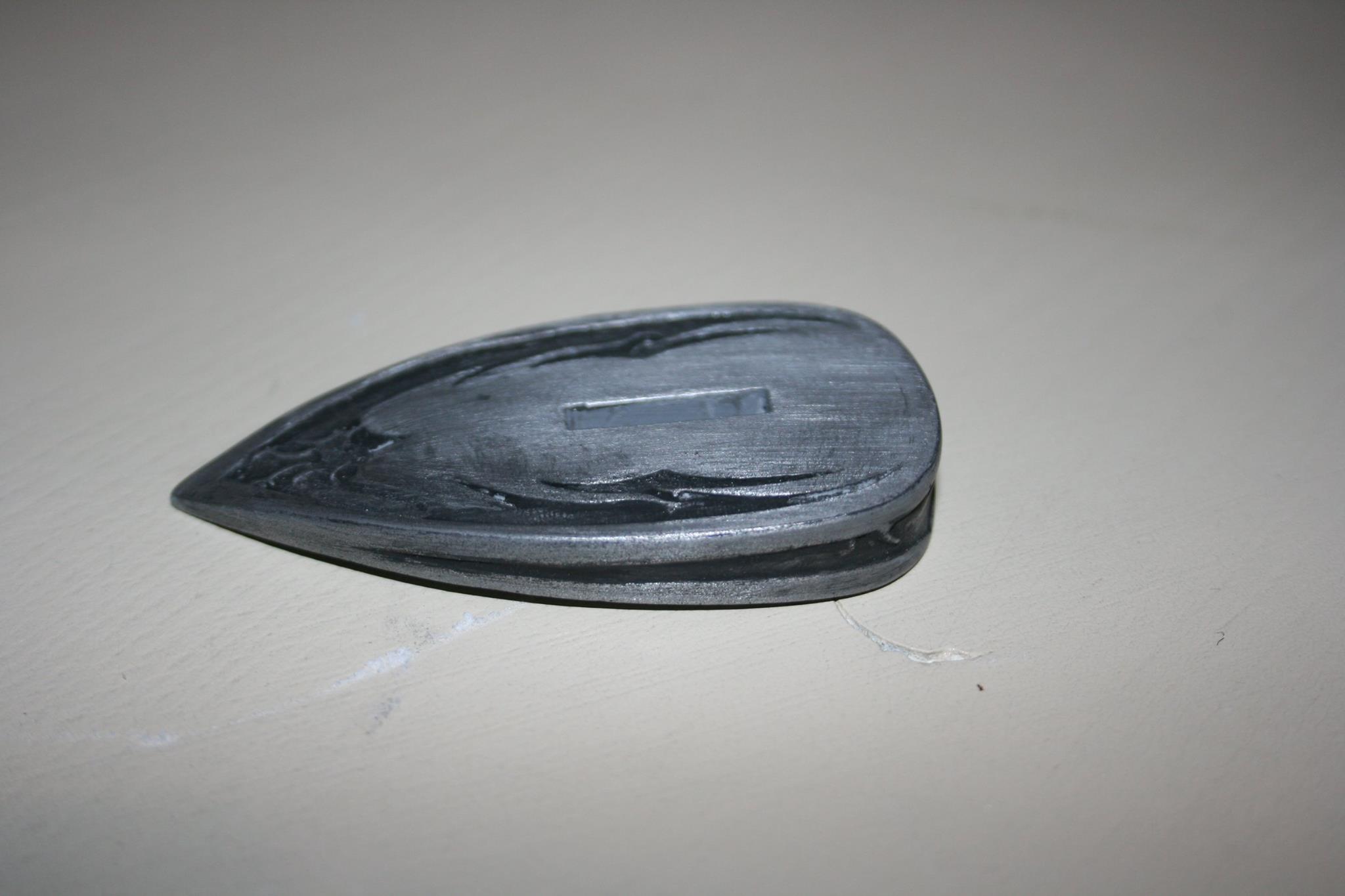

While waiting for my friend complete the handle, I'm going crazy to make the decoration of the flange has the details so small, that even with the laser cutting is difficult to get them.
10636426_858937280792007_1654154268891179755_o.jpg10551431_858937277458674_4211295735322365568_o.jpg1909457_858937284125340_217708765419511267_o.jpg1912461_858937290792006_4769254820174636063_o.jpg

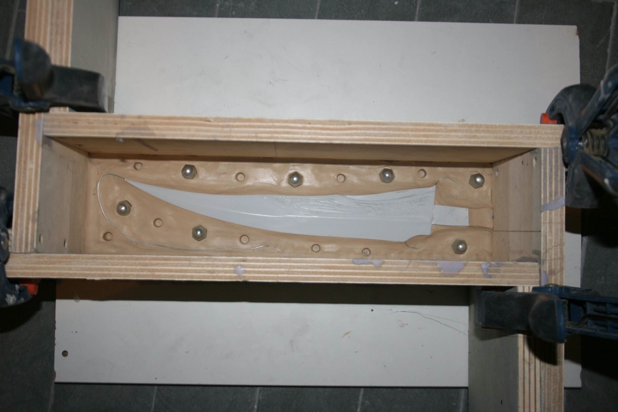

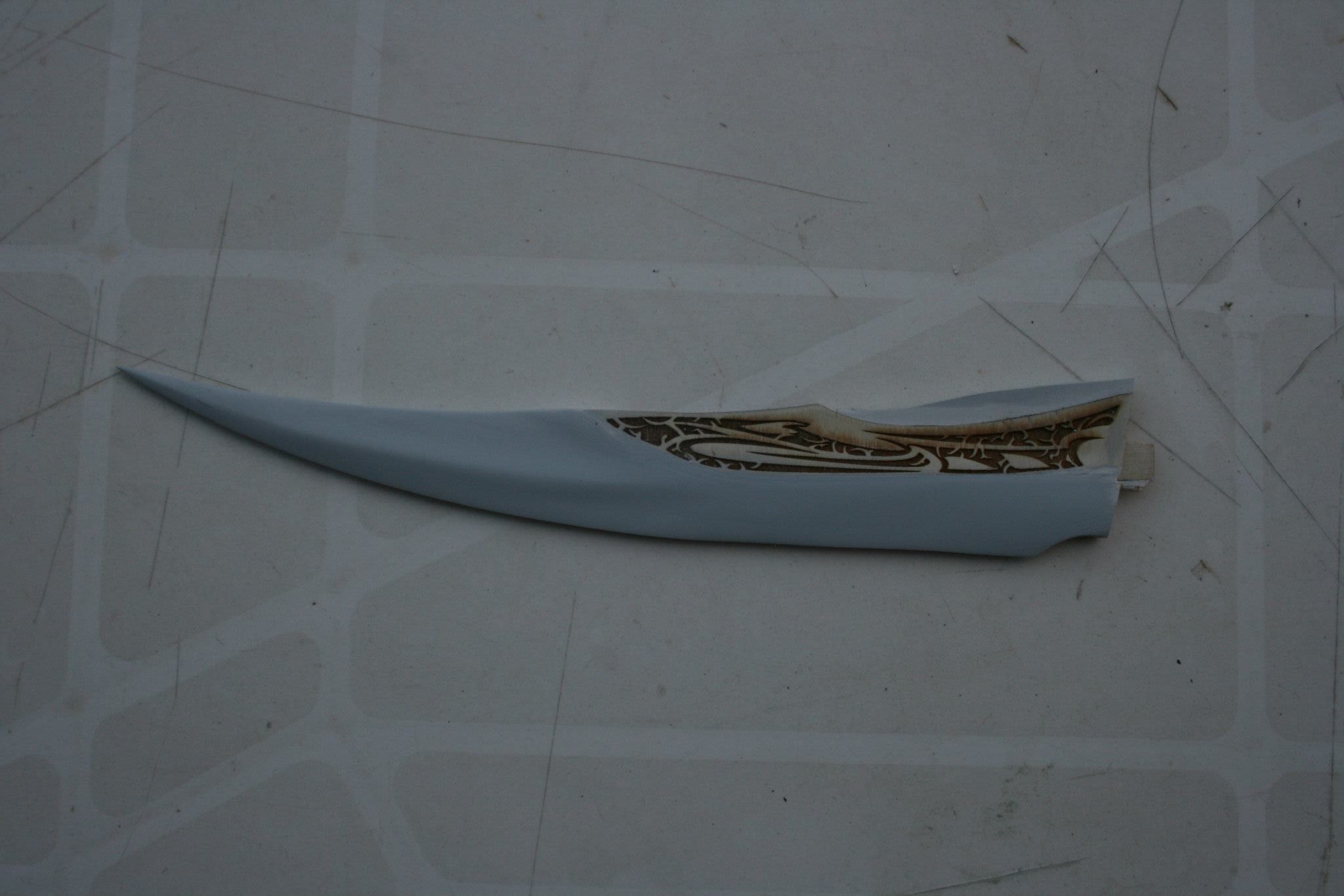

Meanwhile, began molding of the blade, this is the first side.
10549933_858938314125237_7001334147977448948_o.jpg10644432_858938310791904_6823300333745201821_o.jpg10626365_858938317458570_6361080566165877260_o.jpg

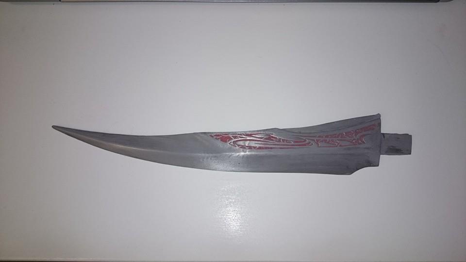

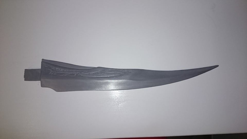

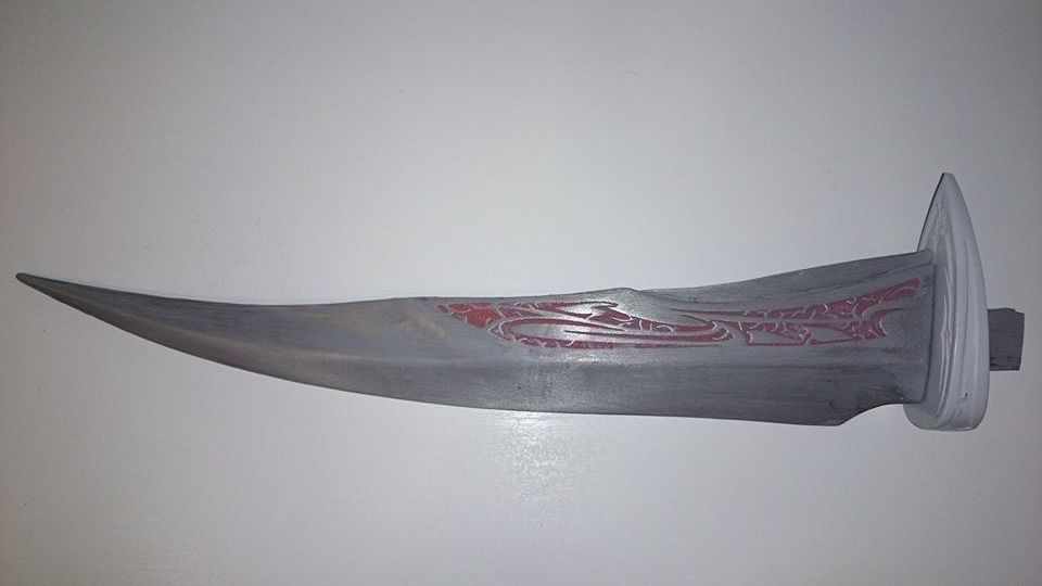

Ready the first copy of the blade, I loaded with aluminum powder to achieve the metallic effect.
I also did a test there with the red color of the decor to see how it is.
10540855_859447067407695_620137387282534725_n.jpg10540855_859447084074360_6986435241656217840_n.jpg
