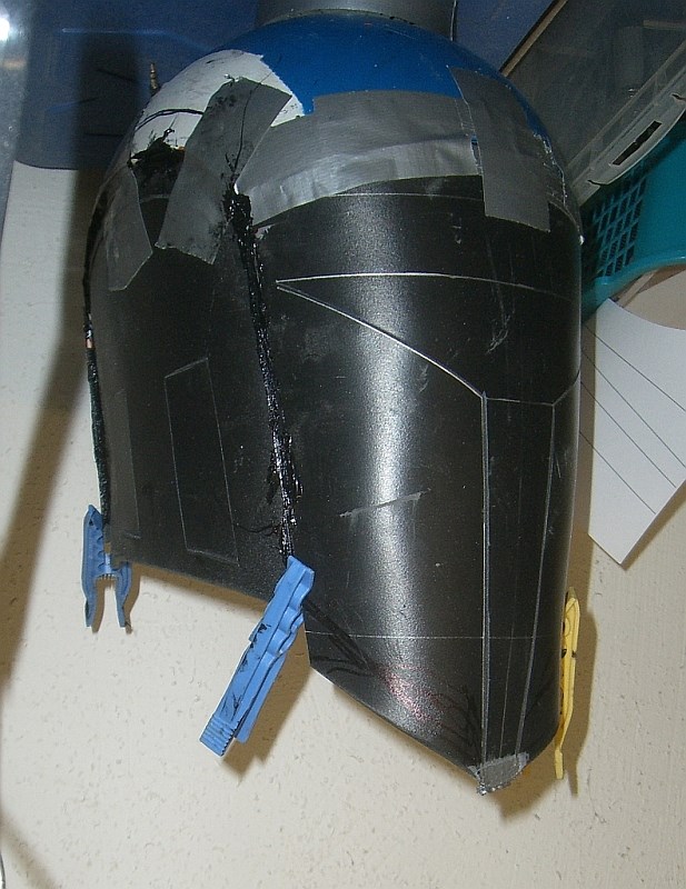

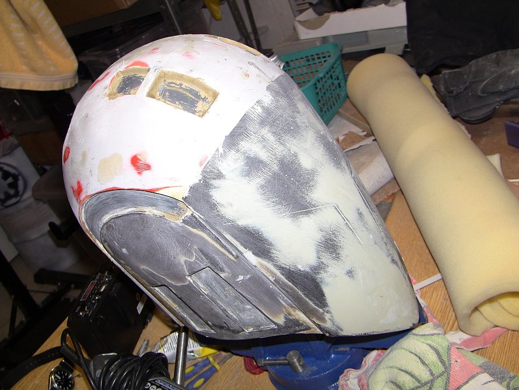

For the Helmet:
Making it out of Metal was then too big because of the round shapes. No one did the helmet so far so o chooesd to make it myself.
I never casted a helmet and i'm sort of heavy handed so that was the first time i tried to put in some details.
After making 3 molds ( the first 2 sucked and made wobbly casts) i think i learned enough ^^ The Bad think is. I used my head as areference for the Model so it is very very small inside. Mostly because the Form of the Modell is intended to be tighter at the Helmet openingfor this bole shape.
But hey, atleast i can now cast helmets on my own.

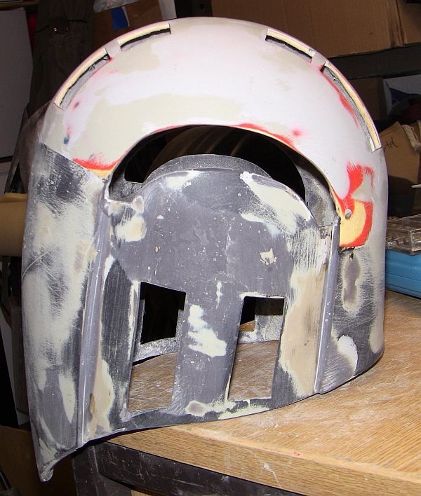

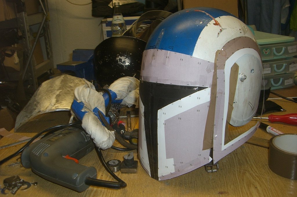

i tried something crude with Paper
Used PVC Hardfoamplates

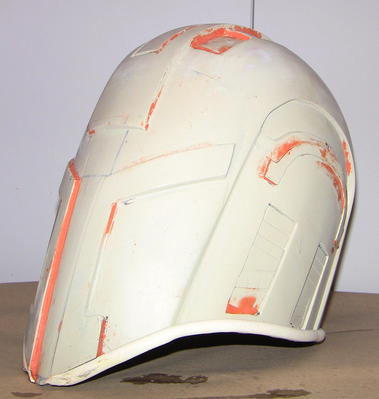

Grinded alot

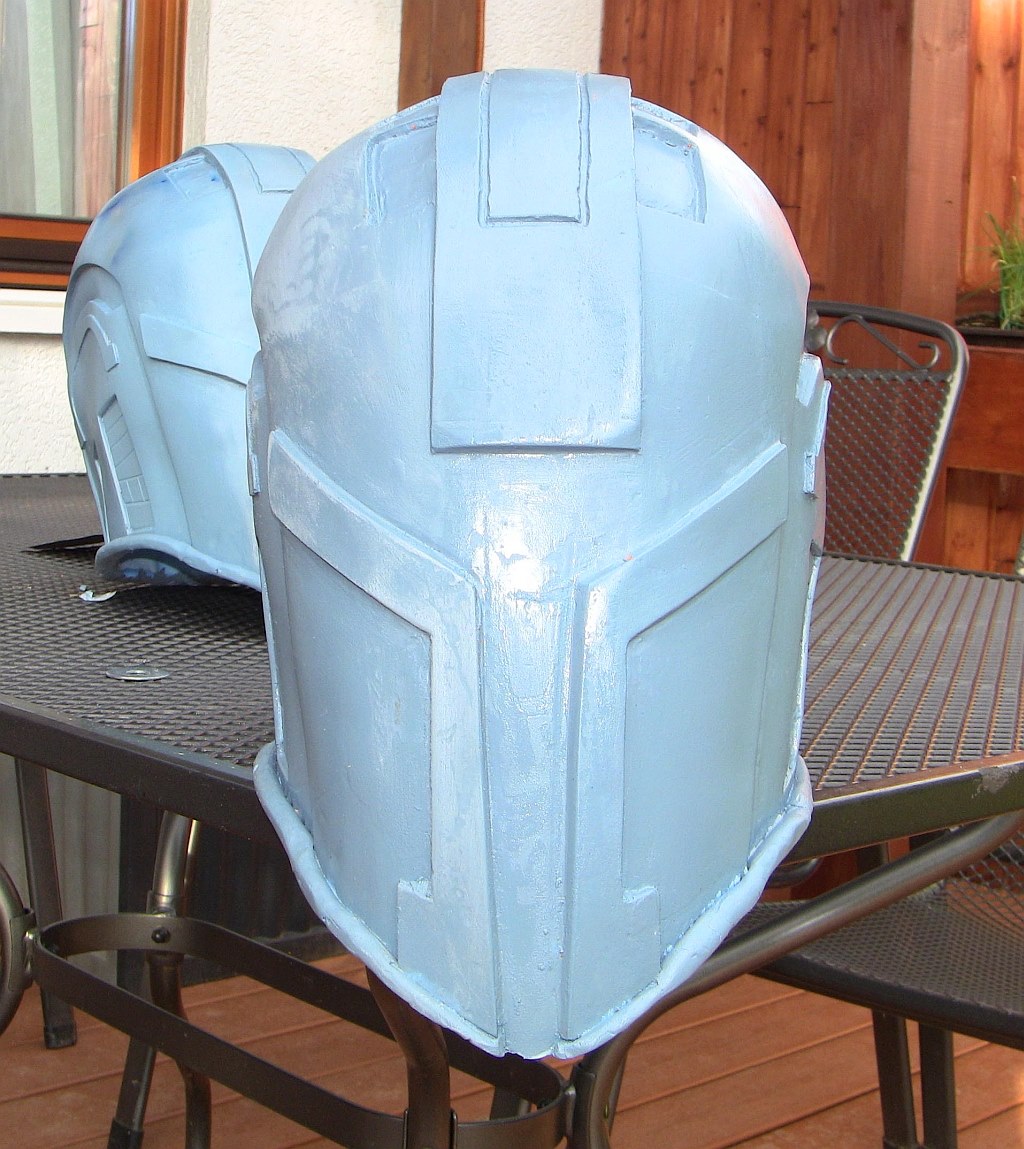

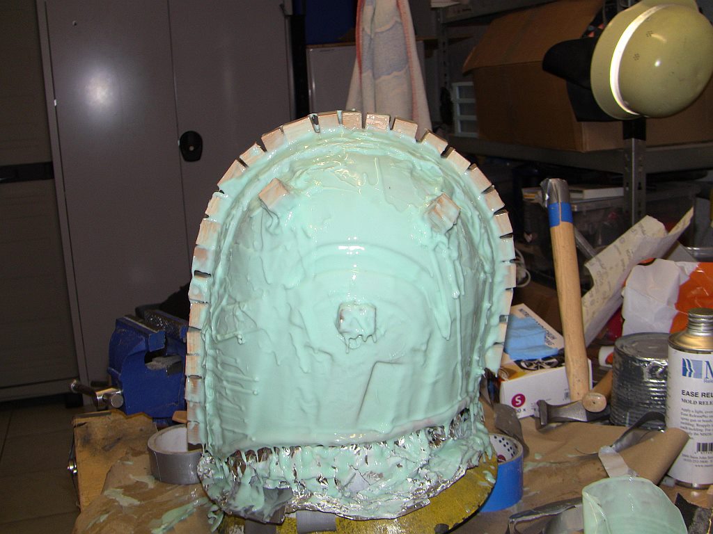

Molding
Casting
This helmet project was last year and a bit hurried because of the Celebration Europe 2 back then.
It major lacks that it is tiny and small for a regular sized male head. Most women or people with a more slim head can use it...

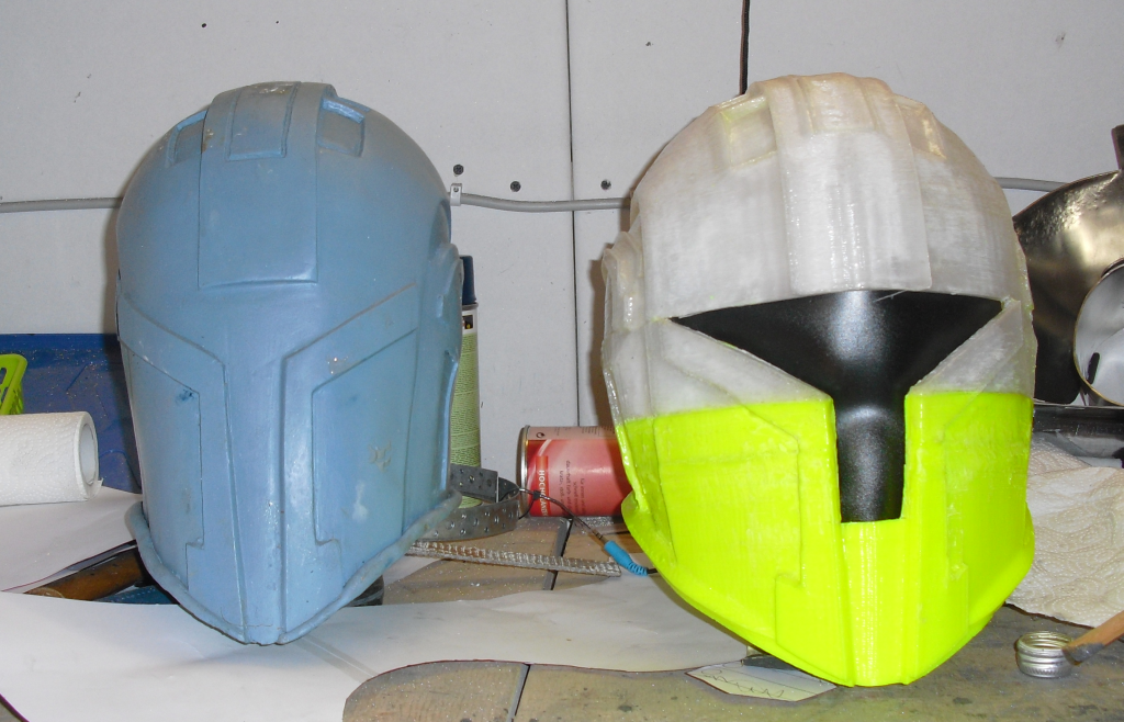

But i gonna do a MARK 2 this Summer right now
This time the Modell is 3D printed and way bigger ^^
