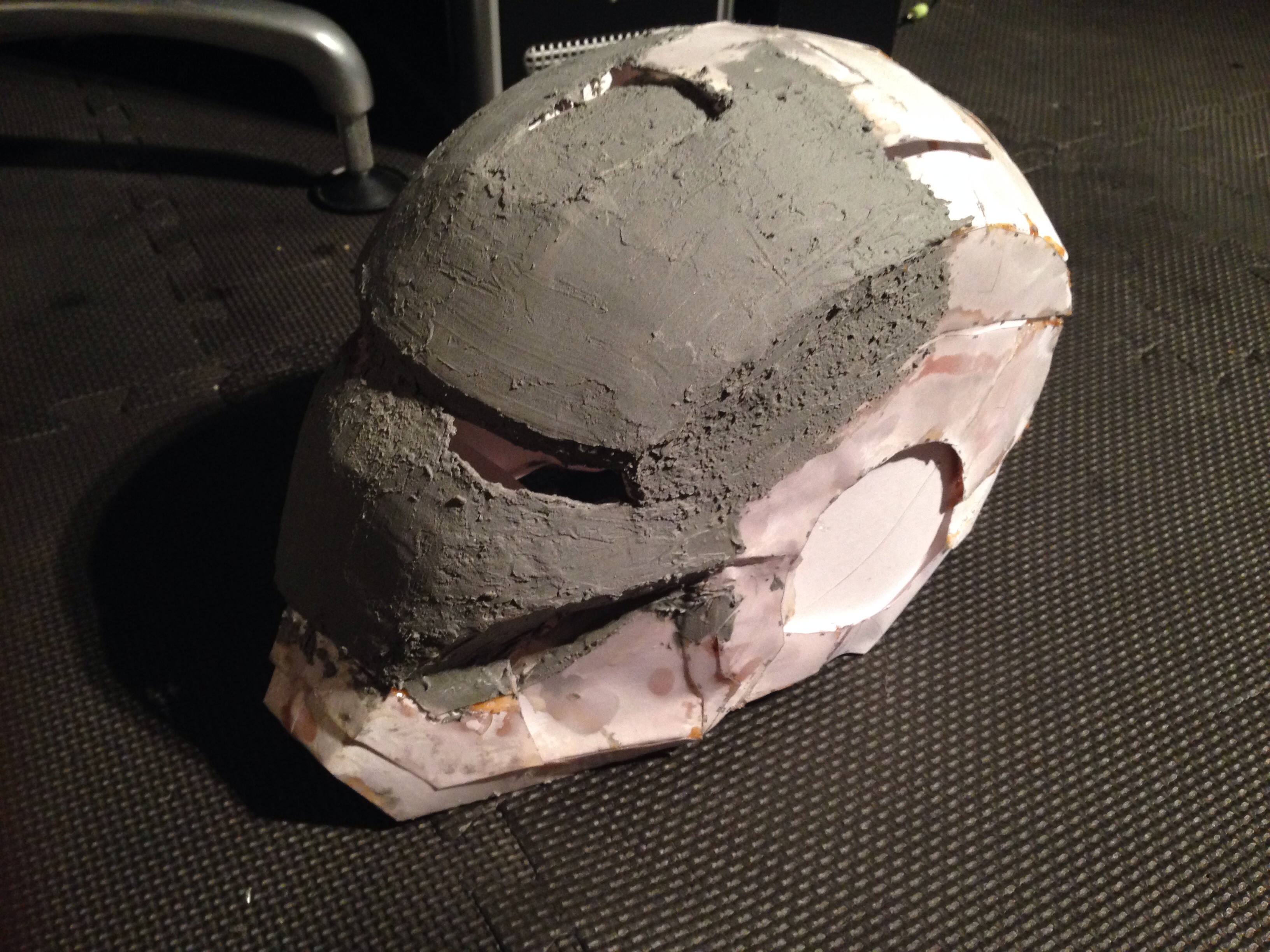

Hi, I have been working on a new Iron Man helmet having done one before using body filler... I found that the body filler I used took a long time to harden and this slowed down the process majorly this time I have tried Chemical Metal and have had a great result am currently in the process of covering entire helmet and have done first coat of chemical resin
I was also able to use this straight onto the cardstock paper without the fiber glass without warping the paper and sanding was just as easy as body filler
Pro's
  1. Cheaper than body filler 560ml £11
Dries in 10 minutes
Doesn't require use of fiberglass or resin underneath
I found it easier to use
Con's
Haven't found any (yet)
If there is anything you would like to add or if there is a reason people don't use chemical metal please let me know :)
(this is only my second time doing pepakura and i know that one side of the helmet looks bad :S)
