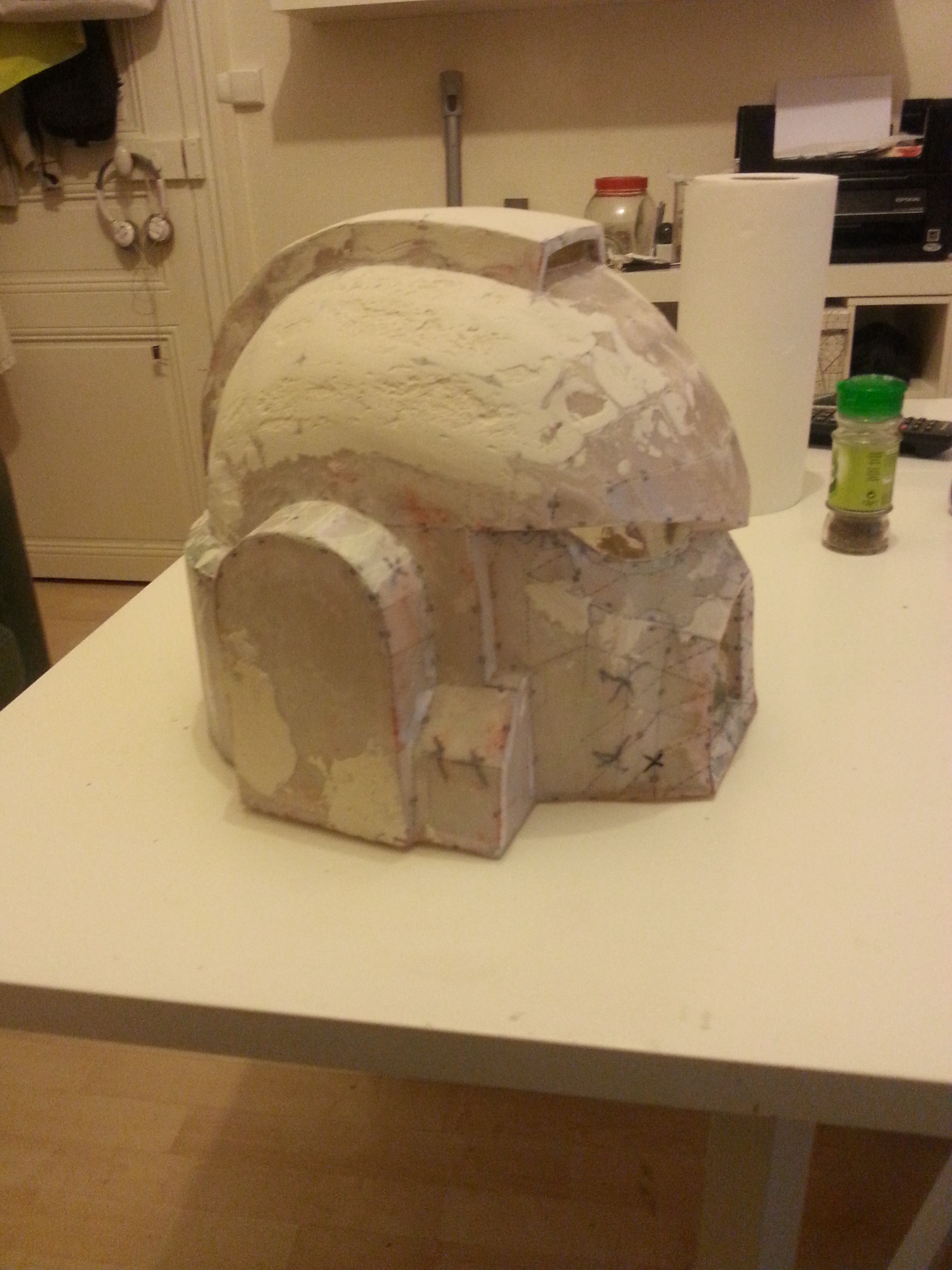

First steps with bondo, 1st layer, 1st sanding !!!
I realize that the curse where quit "sharp" so I marked the inside, where I estimate that sanding would "go through" :
then fill those mark with bondo.

Any more progress on this? You've done a great job with the formation and sanding... what's next?
