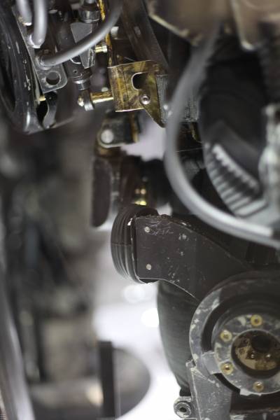

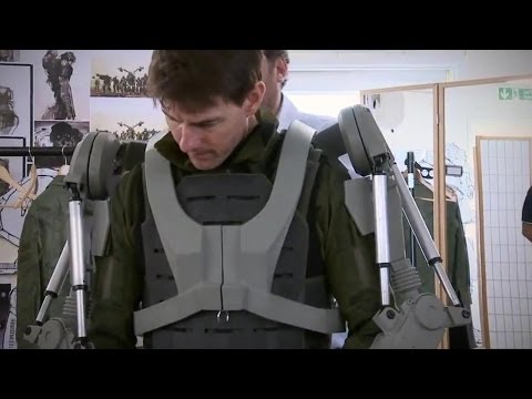

In all of the images above, in both the male and female suits, the shoulders, elbows, hips and knees (and two scissor-style movements on the spine which I've seen in other shots) have very large, very sturdy "pods" which hinge. These are the key to the build, and the rest of the skeleton is relatively straight forward beyond this.
My question at this point, which I'm finally getting to, is how exactly can anyone suggest I replicate these kind of mechanisms? Bear in mind that I am a man with a limited workshop, by which I mean I don't really have one and have to rely on simple tools and methods excluding vac-forming, 3D printing etc. In my mind, I'm wondering if something similar already exists in the "real world" that I could extract and re-purpose (I was thinking maybe a toy or cheap piece of equipment)?
