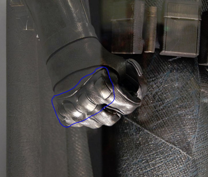

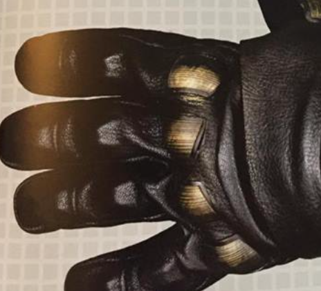

anyone notice that the knuckles look like they are protruding from beneath the glove? to me it looks like the glove has holes were the knuckles are supposed to be and beneath that theres a pad with the knuckles on them. and were is the thumb knuckle placed? bat knuckles.PNG
Re: The Definitive BvS: Dawn Of Justice Batsuit Research Thread
anyone notice that the knuckles look like they are protruding from beneath the glove? to me it looks like the glove has holes were the knuckles are supposed to be and beneath that theres a pad with the knuckles on them. and were is the thumb knuckle placed? View attachment 614424
No... sorry but they are on top as there is a shadow from them on the material above. It certainly gives off an illusion that they are beneath the glove..Screen Shot 2016-04-13 at 22.41.50.png
oh ok thank you very much. Btw what is the glove that everybody buys when adding the knuckles? ive been looking on amazon but havent seen any that look similar.
No... sorry but they are on top as there is a shadow from them on the material above. It certainly gives off an illusion that they are beneath the glove..View attachment 614659
They are inserts. They aren't top mounted. There is open leather around the knuckles.
thank you. i think i try sewing some pleather gloves and make inserts for it to see if i can get a look similar to the pic i uploaded earlier. should it be like a pad with the knuckles on the that i slip into the glove?

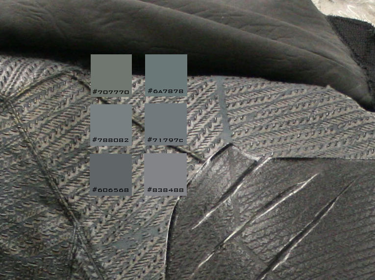

Anyway, here some grey colours pulled from a studio pic, in case it helps.
edit : I keep forgetting brucebatman has the real fabric. Might be better to let you take care of that if you don't mind ? I'm guessing it's not written on it what kind of fabric it is, but someone might now by the feel, stretch and pattern.

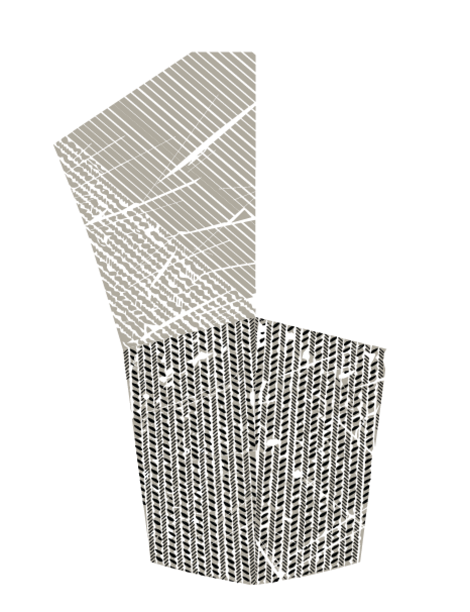

Oh 3-4 weeks aren't a problem. This is we're I'm at :
It is extensively time consuming. I can't use illustrator automatic effects to create the ragged strips unfortunately, otherwise they don't fit the tire tracks. So it's all by hand.
teragon
Before you sink more time into it. Only one of the companies I've spoken to has said yes specifically to AI files, and that's not even the company that said yes to doing the screen printing for us. The company that has said yes hasn't specified which file type they want, although it could very well be .ai. That's not to say that others won't accept the .ai files, it's just that I want to be sure they will, otherwise you'll be wasting your time. I should know more by the end of this week, every company has been so busy, and usually the approval has to come from a manager. As of yet, I don't even have a dollar amount quote, since they all require more information including fabric type/color, ink type/color.
Sorry I disappeared from this conversation. Moved this last week and have been without internet until now.
You seem do be doing what we normally have to do with custom art we get in our shop. Our artists use Adobe Illustrator to convert all files to vector graphics. So basically they have to go through and manually trace every aspect of an image and break it up into "layers" for each color. It's an extremely time consuming process. IMPORTANT thing you'll want to add to each layer are registration marks so that when the images are transferred to the screens they can be lined up again in their original positions.
There are programs available that can help automate this process. Found this video that may be of some use. It's a free program and I don't have any experience with it but it may be worth looking into. Not sure what file formats it supports, though.
