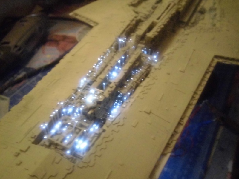

Then I started to drill the holes for the fiber
Passage of the optical fiber
I repare the edges of the SSD with styrene
Test lightup

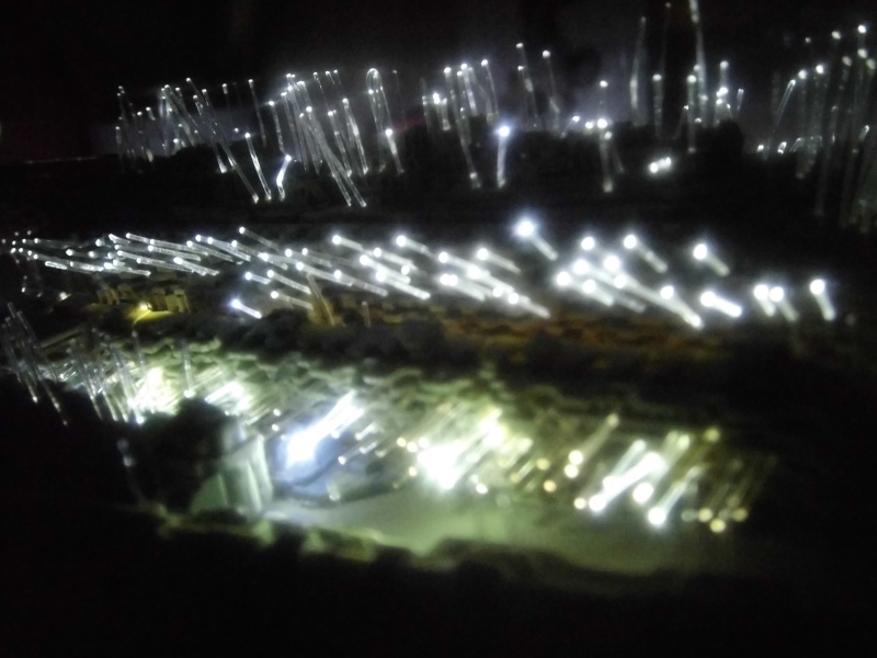

I do not know how many holes I drilled, but I drilled a sacred numbers, I know that I used pretty 200/250 meter fiber
Here is the result with the passage of fiber optic deck upper and lower, control station and motors

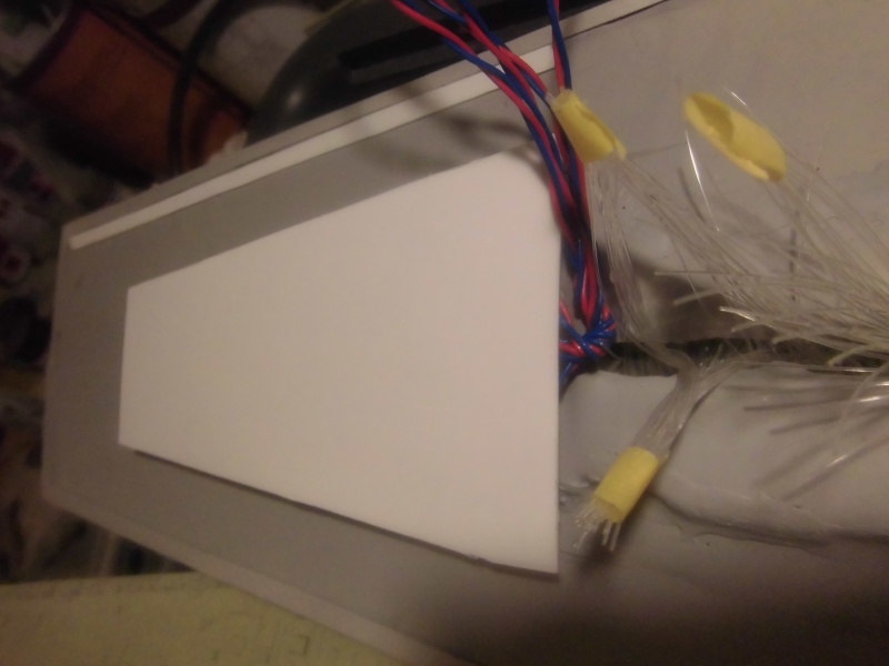

Edges for the job is not finished, I repair the missing parts by scratching pieces of styrene, the outline that I have realized is used as base to work.
I feed the fibers with ribbon del, I made boxes inside the vessel, the fibers arrive in the box or is disposed del ribbon and diffuses the light.

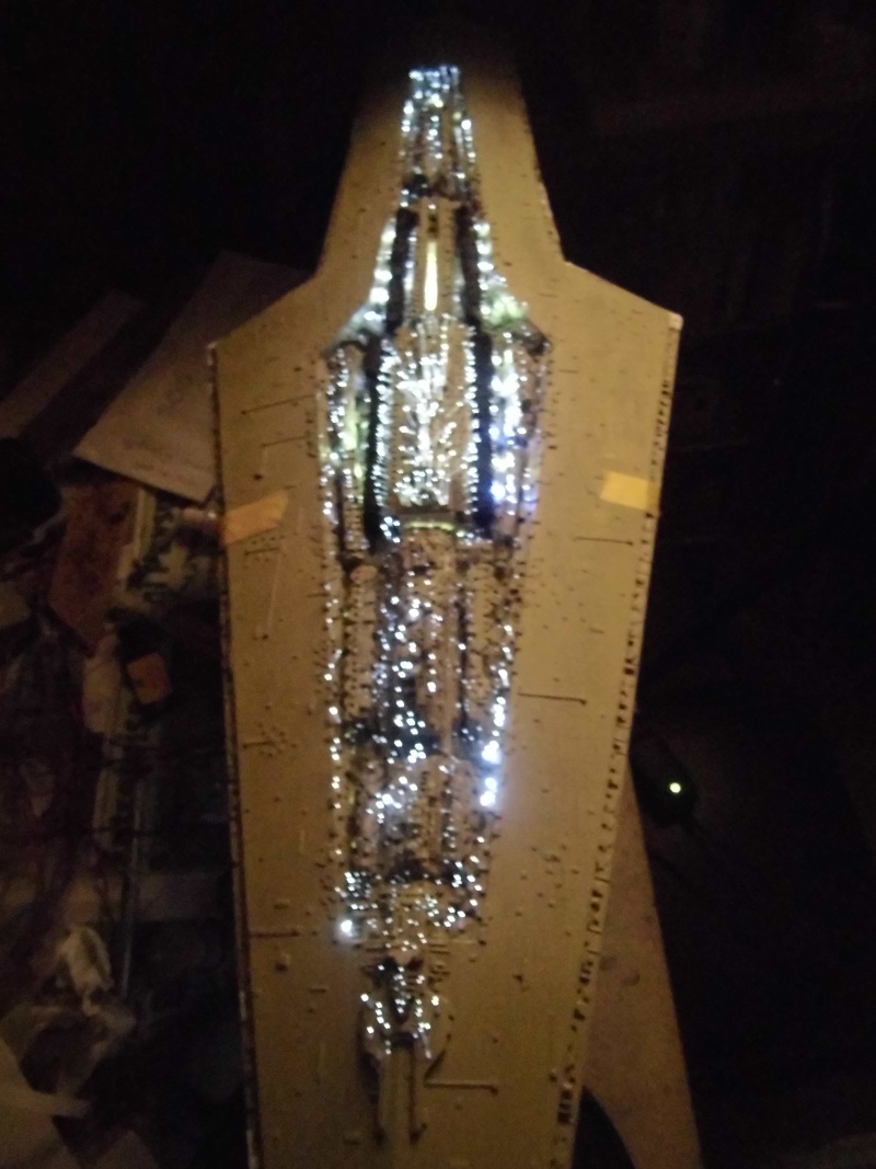

Following the upper deck

The lightup is finished, I'll start building and the paintjob

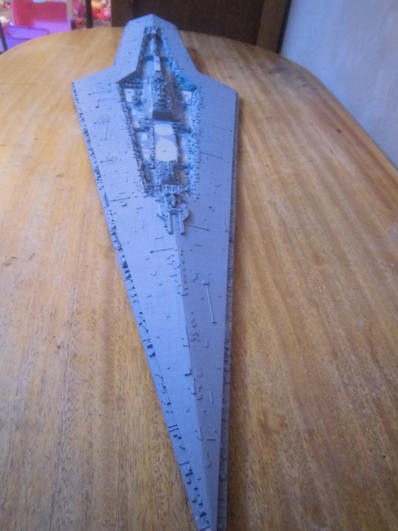

I started to make the base, while the epoxy glue dry
