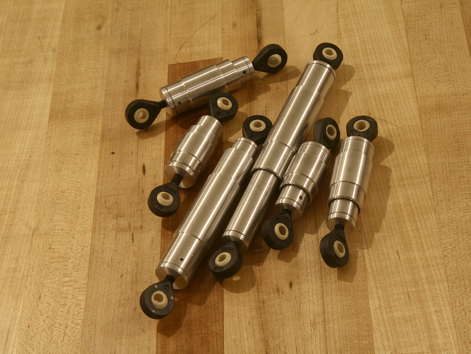

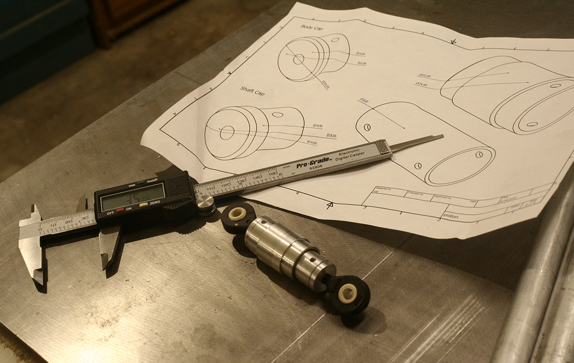

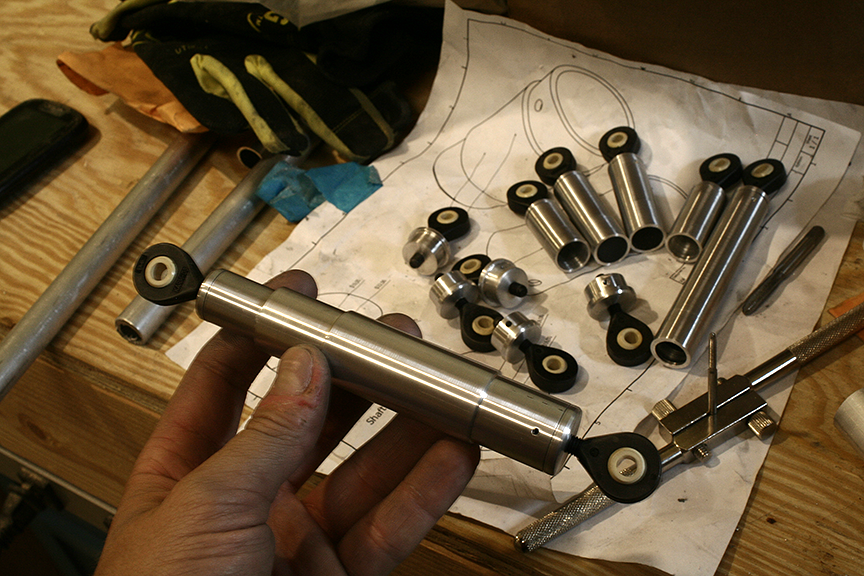

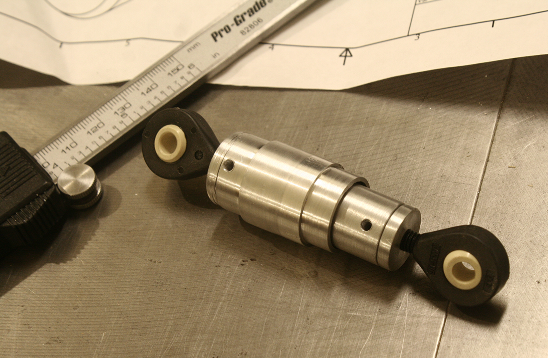

Finished prototyping pistons, additional adjustments pending when I get all the connectors in.

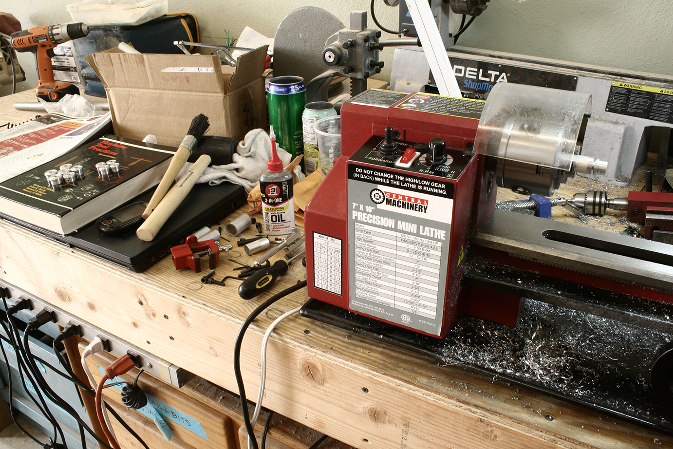

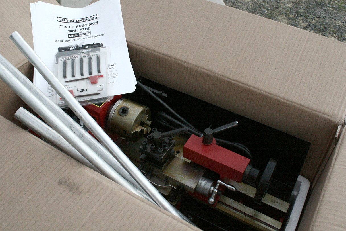

Time to kick things up a notch... bam! Me and my new lathe have some plans tonight.

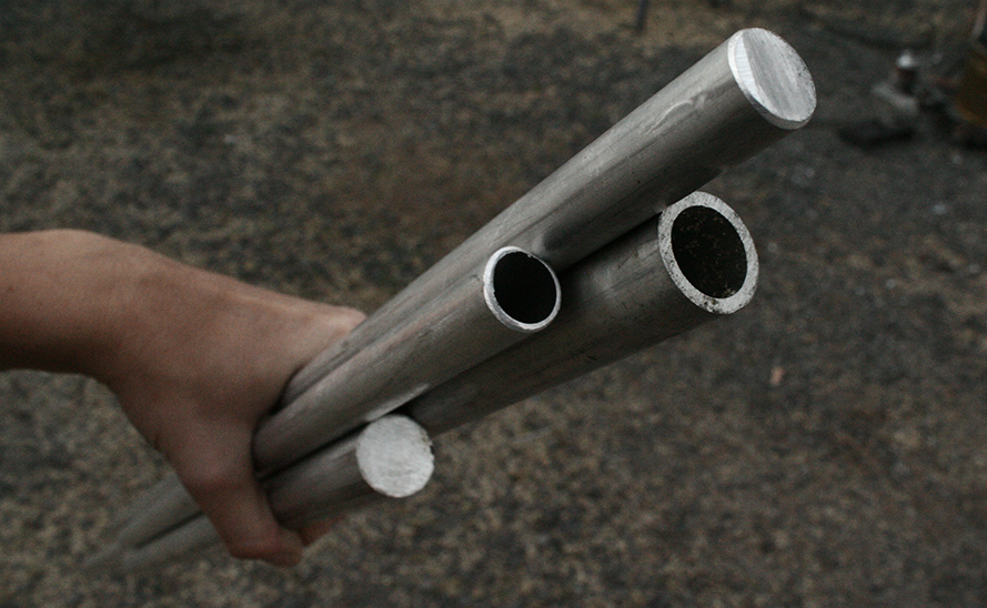

25mm and 18mm tube/bar stock ready to go.

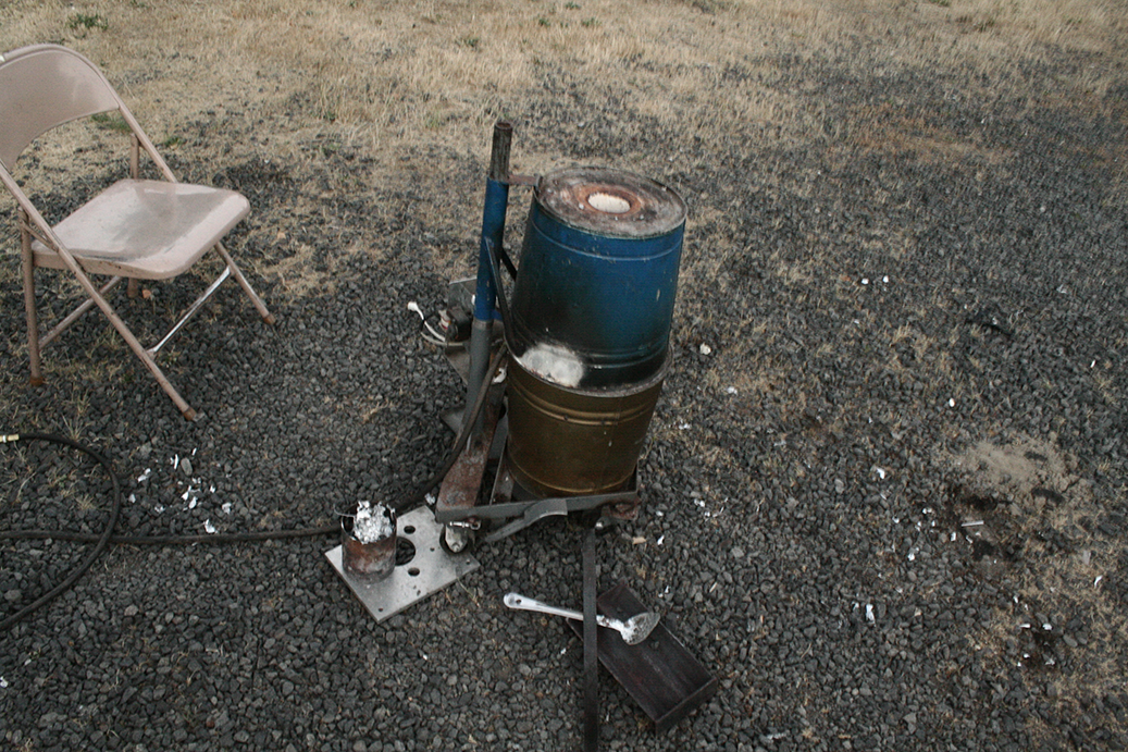

Let's spin us some pistons! Next up, getting silicone to make wax positives of all the parts, which are then put into plaster for investment casting out of Alum.

First piston completed, but poorly. Going to keep re-doing until it's perfect, then order more alum stock and continue with the rest.
That piston wasn't good:eek? With that amount of quality making the suit, it's going to be the bomb for sure:cool...as for the spacer mount, this looks like something coming from a motorcycle.

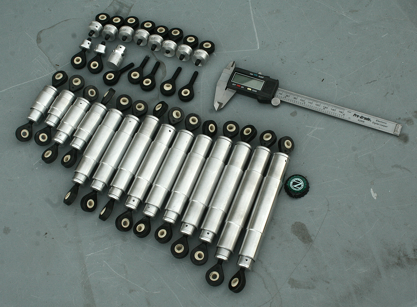

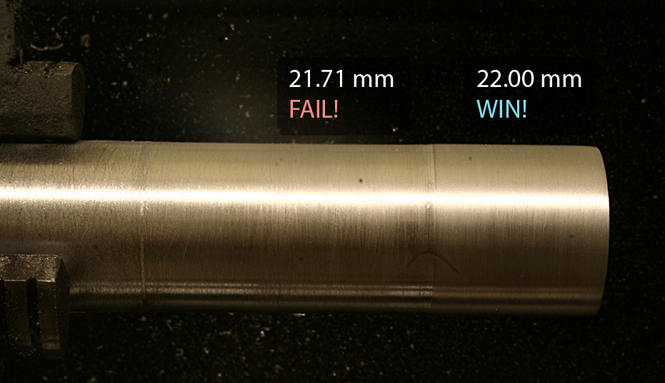

Thanks for continued encouragement! I spent today working precisely on the problem of tolerances. After hours of trial and error, I found that I can only be happy with an error I can't measure with the most precise instrument I have (< 0.01 mm):
First I decided I can live with .1 mm tolerance, but after being able to see the difference from the distance of 2 meters, I decided the awareness of this will drive me insane.
So anyway, today was a low point in my beginning experience as a metal worker, but I will get more comfortable with the dials and it won't take me .5 hr per millimeter going forward :)

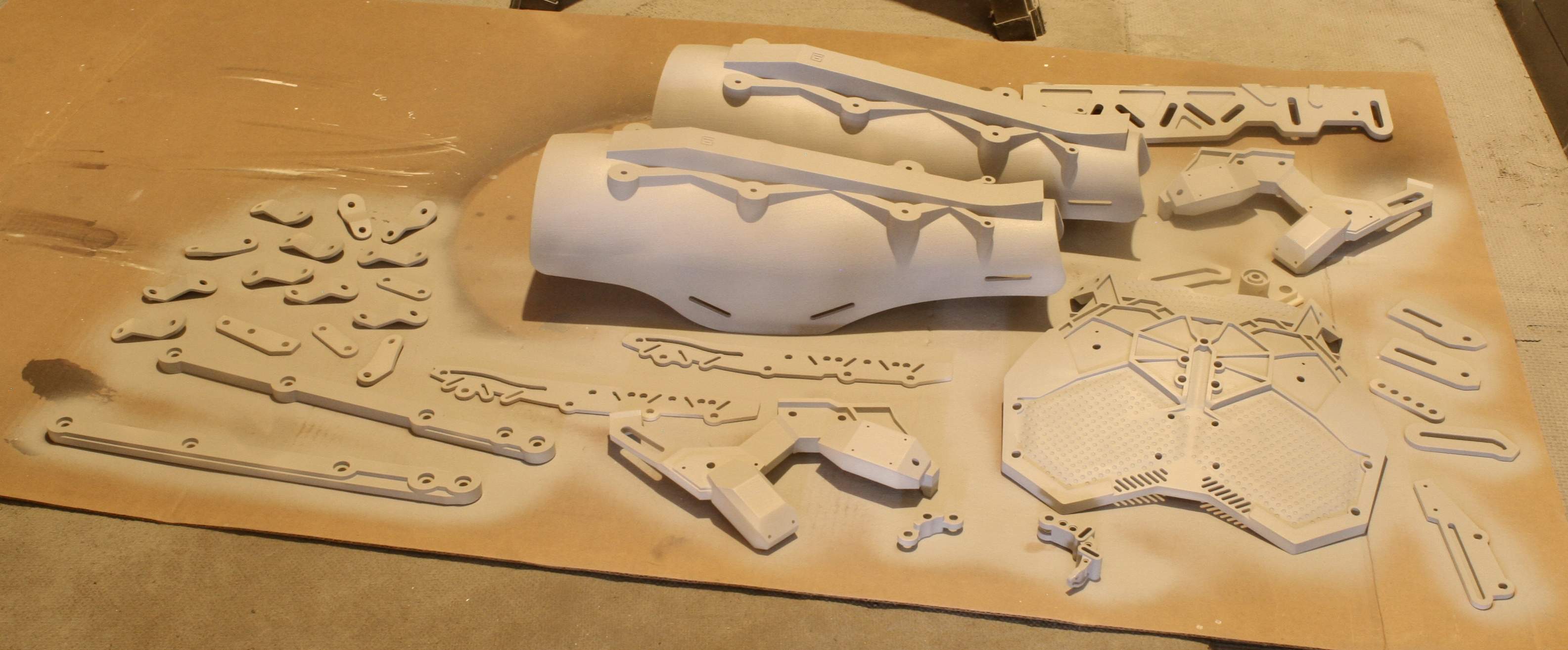

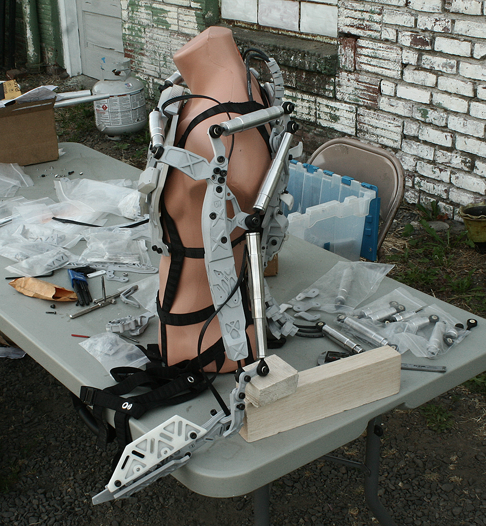

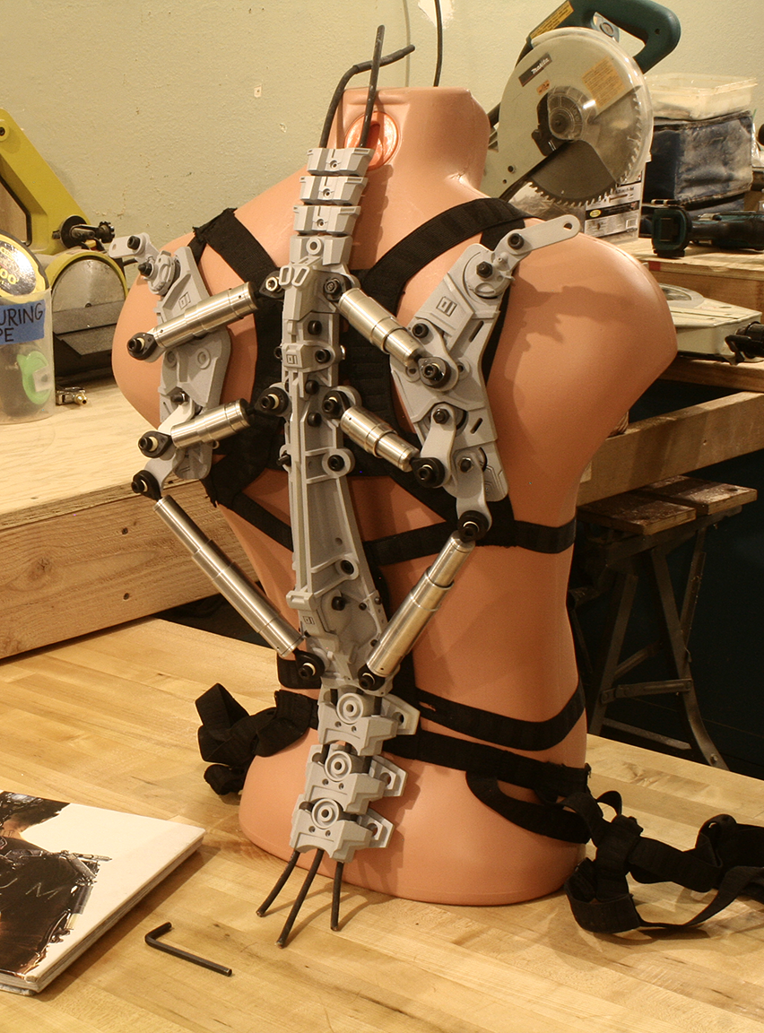

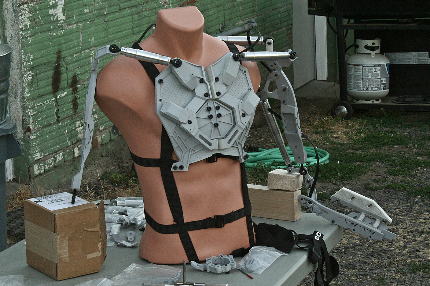

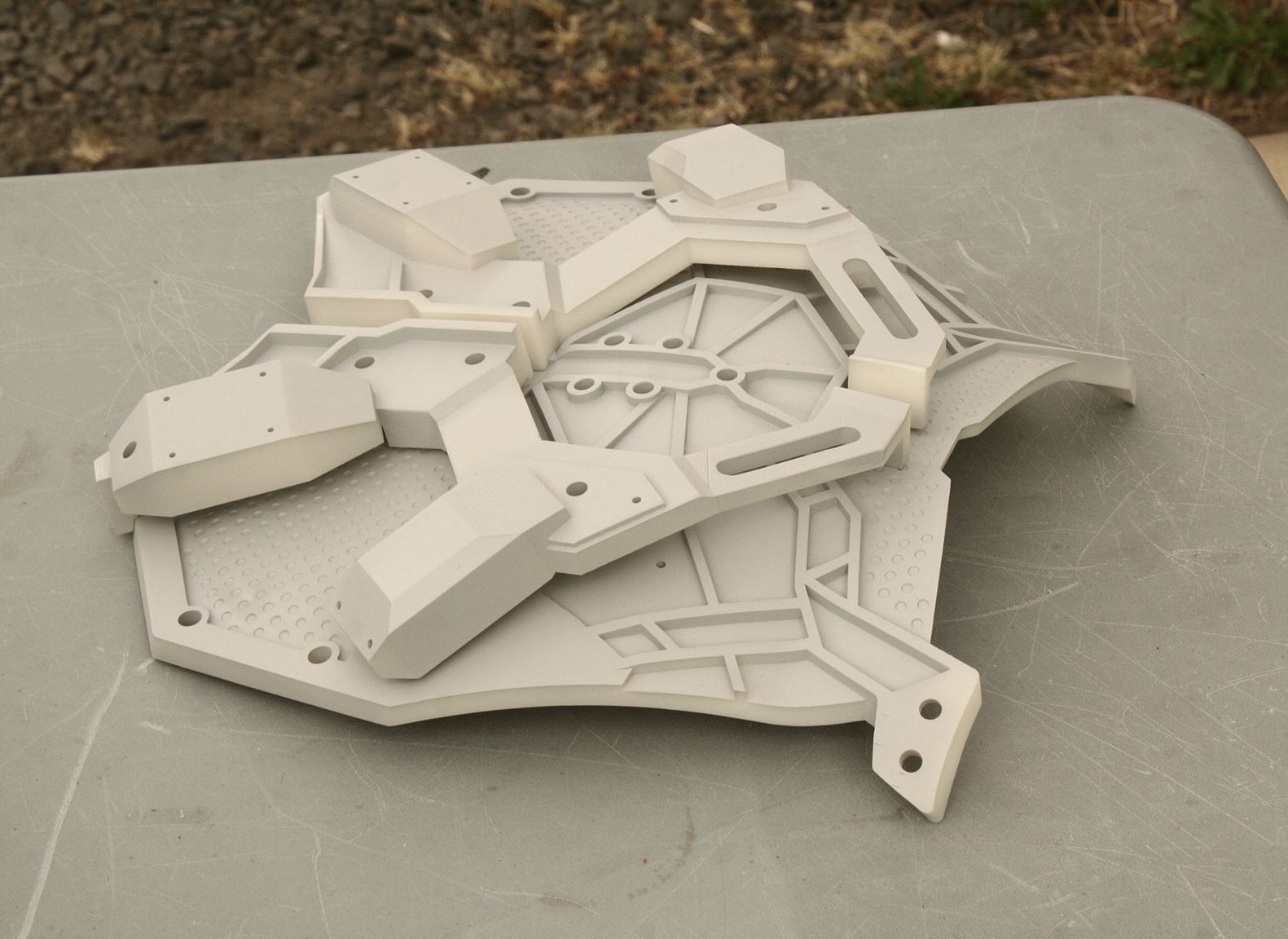

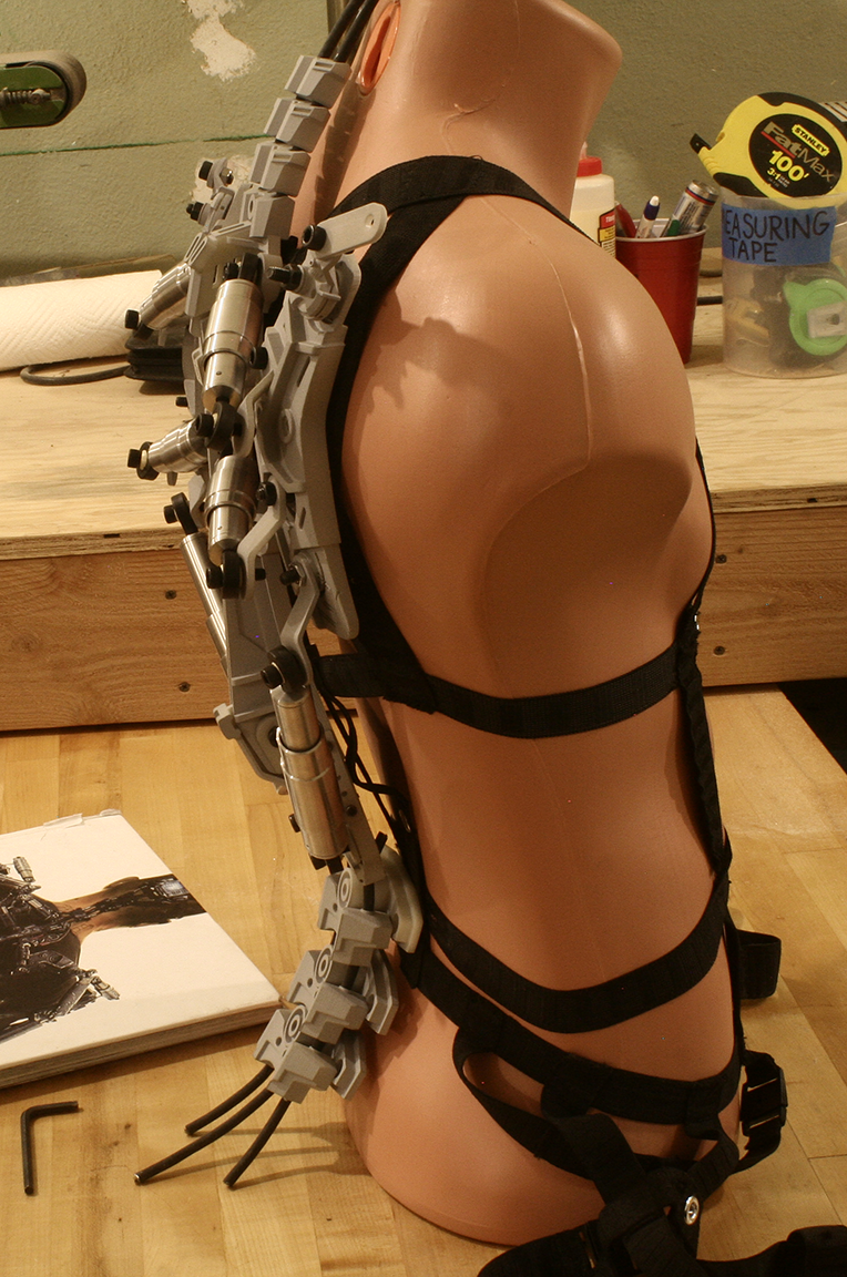

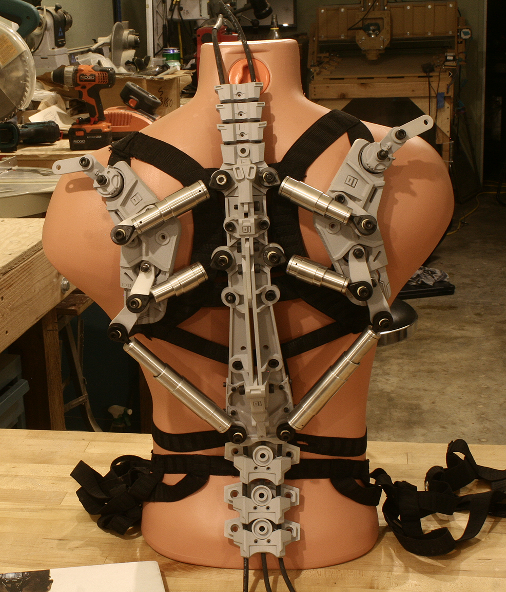

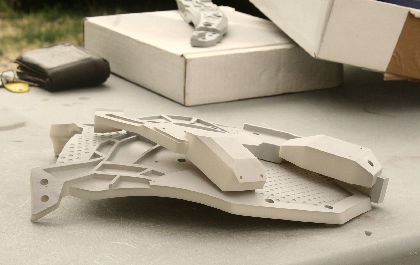

Received nearly last batch (forgot to order two small parts & some "custom" pieces that didn't appear in the movie).

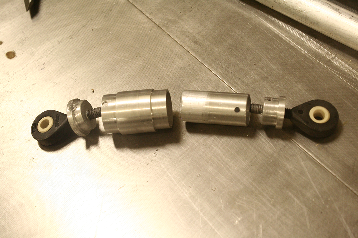

Got a cut-off tool and drill chuck for the lathe. Immediately broke everything (tool post went in the part) and rebuilt it with a help of a friend here at the hackerspace, going to spin some stuff today hopefully. Anyone attempting same... Drip-lubricate anything you cut on a lathe!
Thanks! First batch (3 back pairs) on track for Friday.
Took a long time to get started as there was a lot of waste, including mangled pieces, off-center drills, drill bits broken and stuck in pieces, and other calamities.

This is starting to look amazing. As always with 3d builds the time spent developing the assets PAYS OFF. :thumbsup

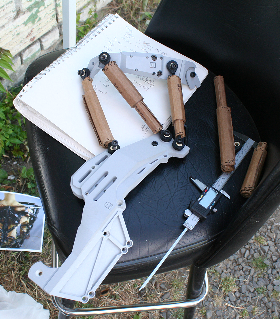

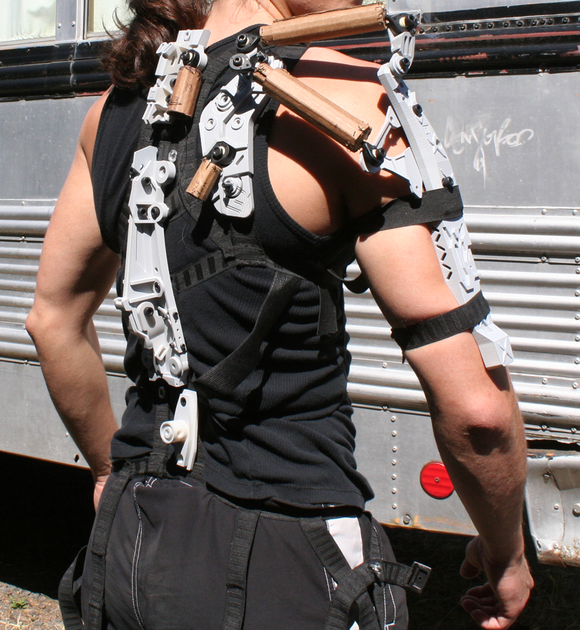

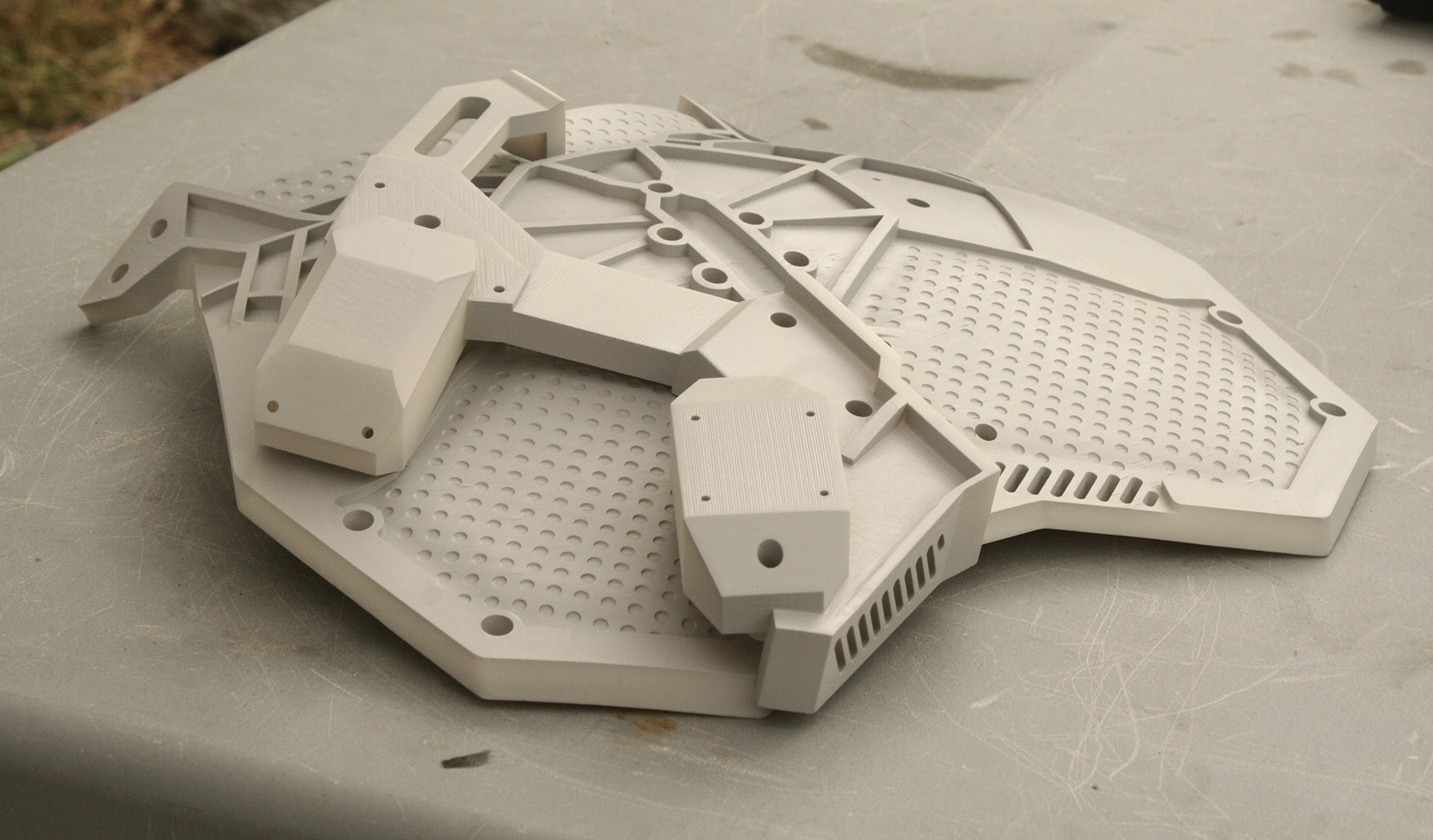

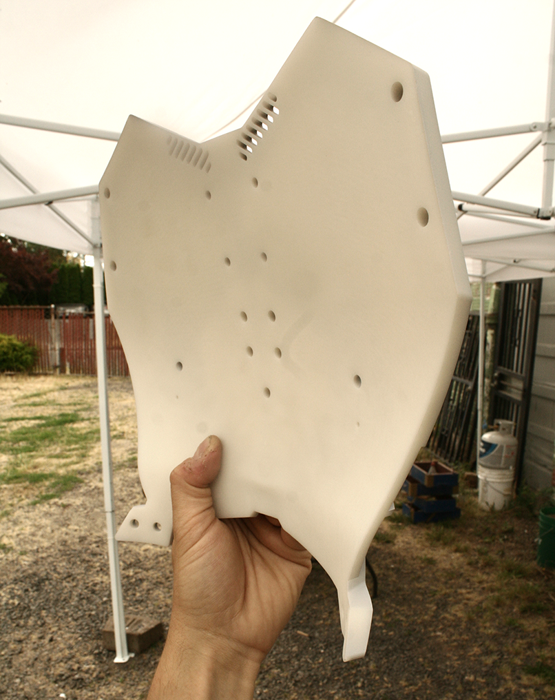

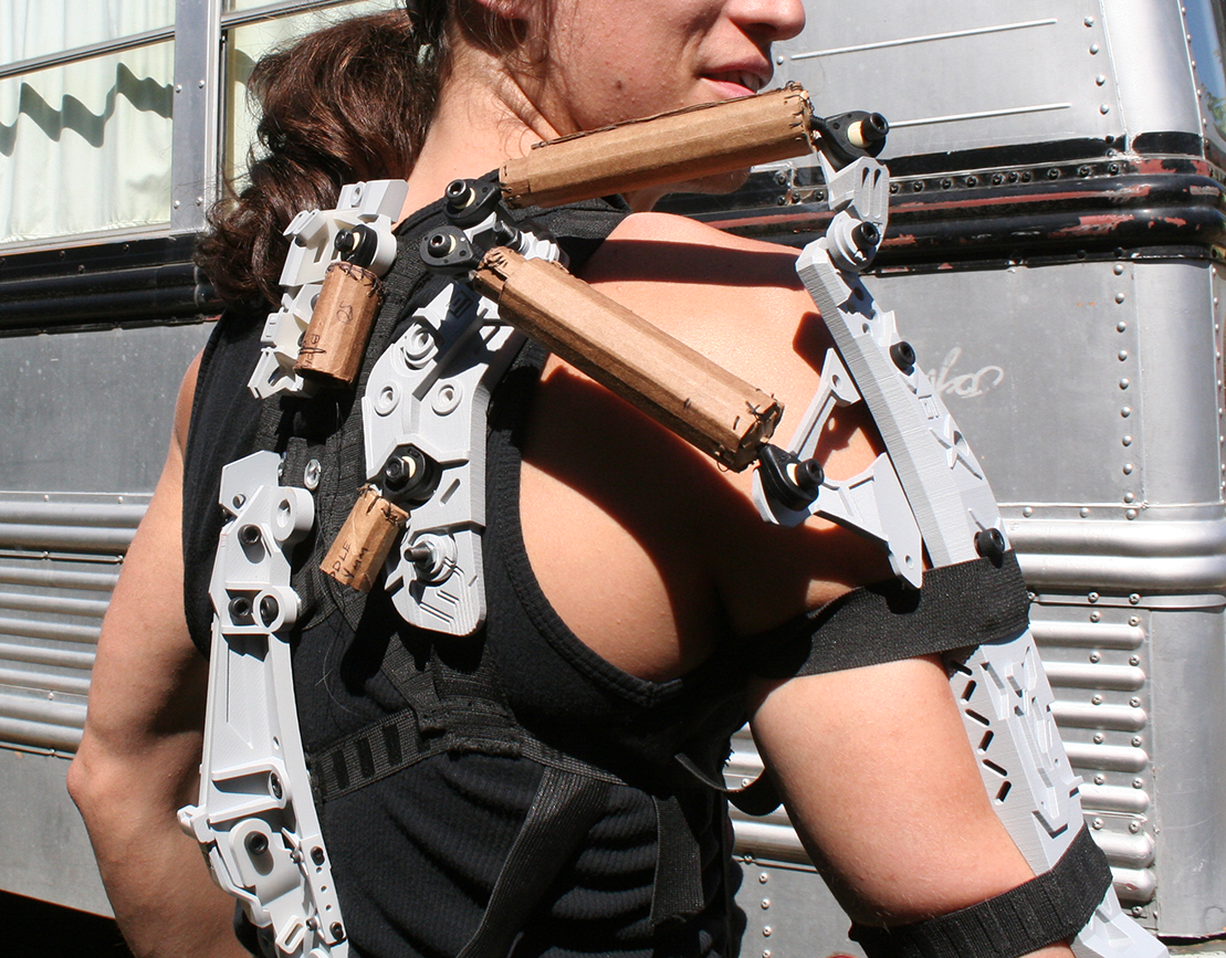

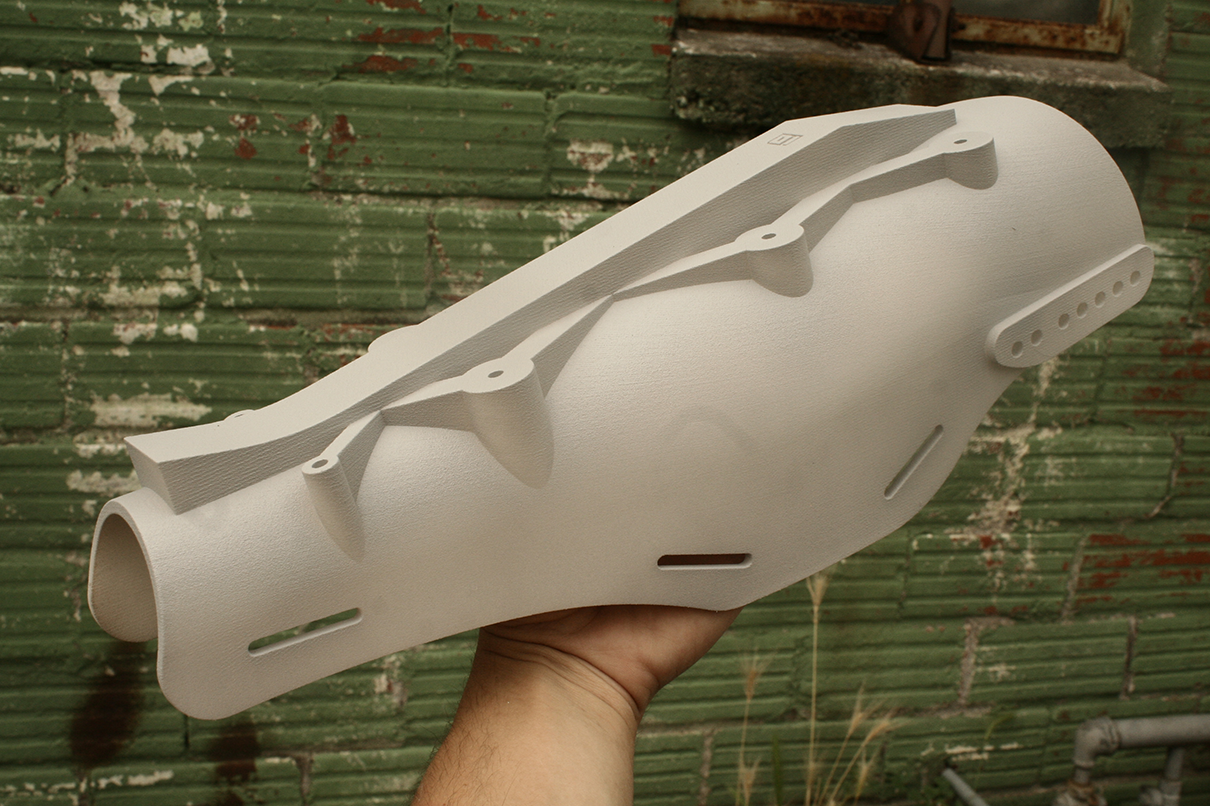

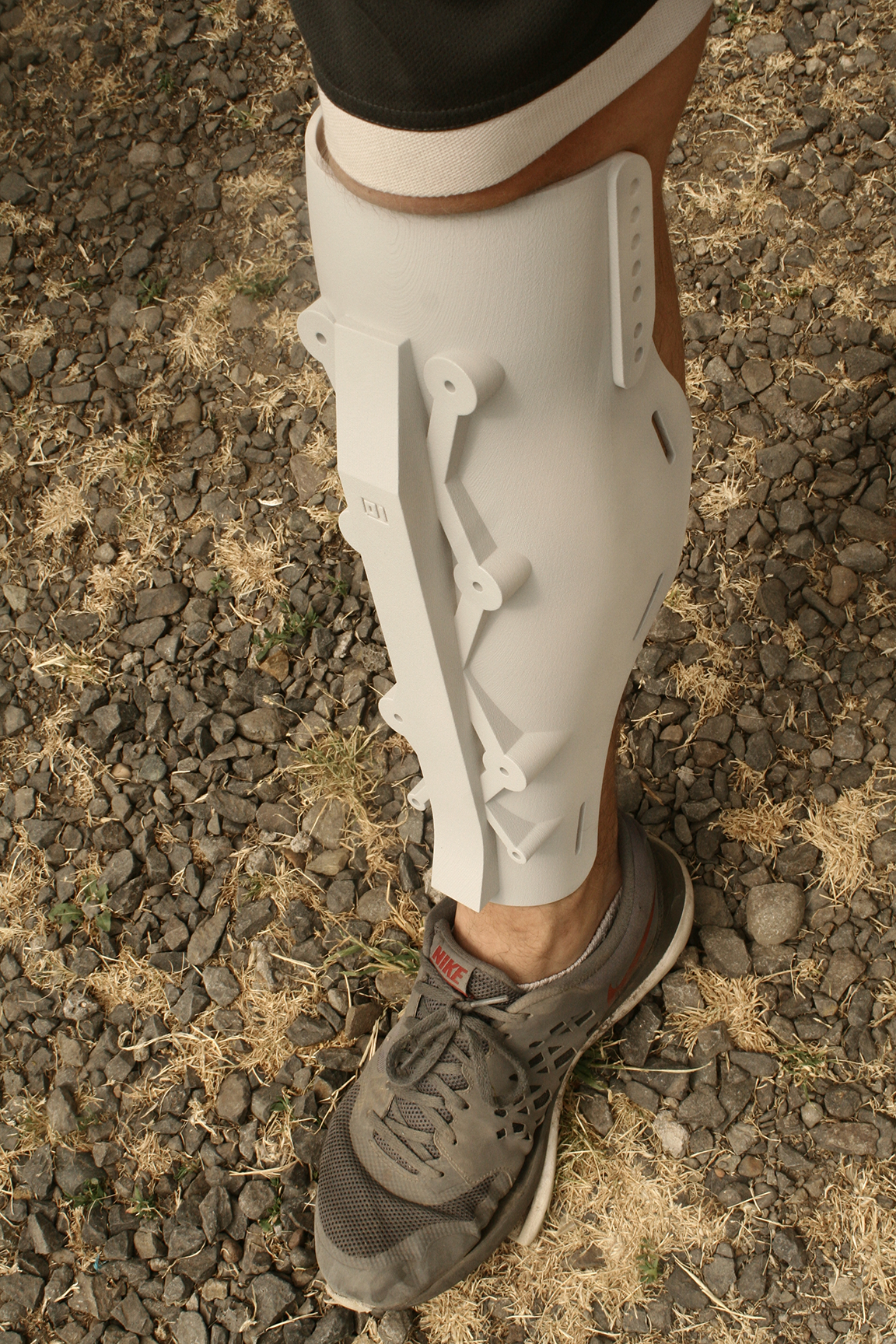

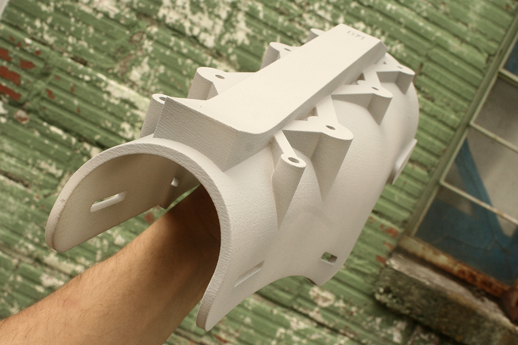

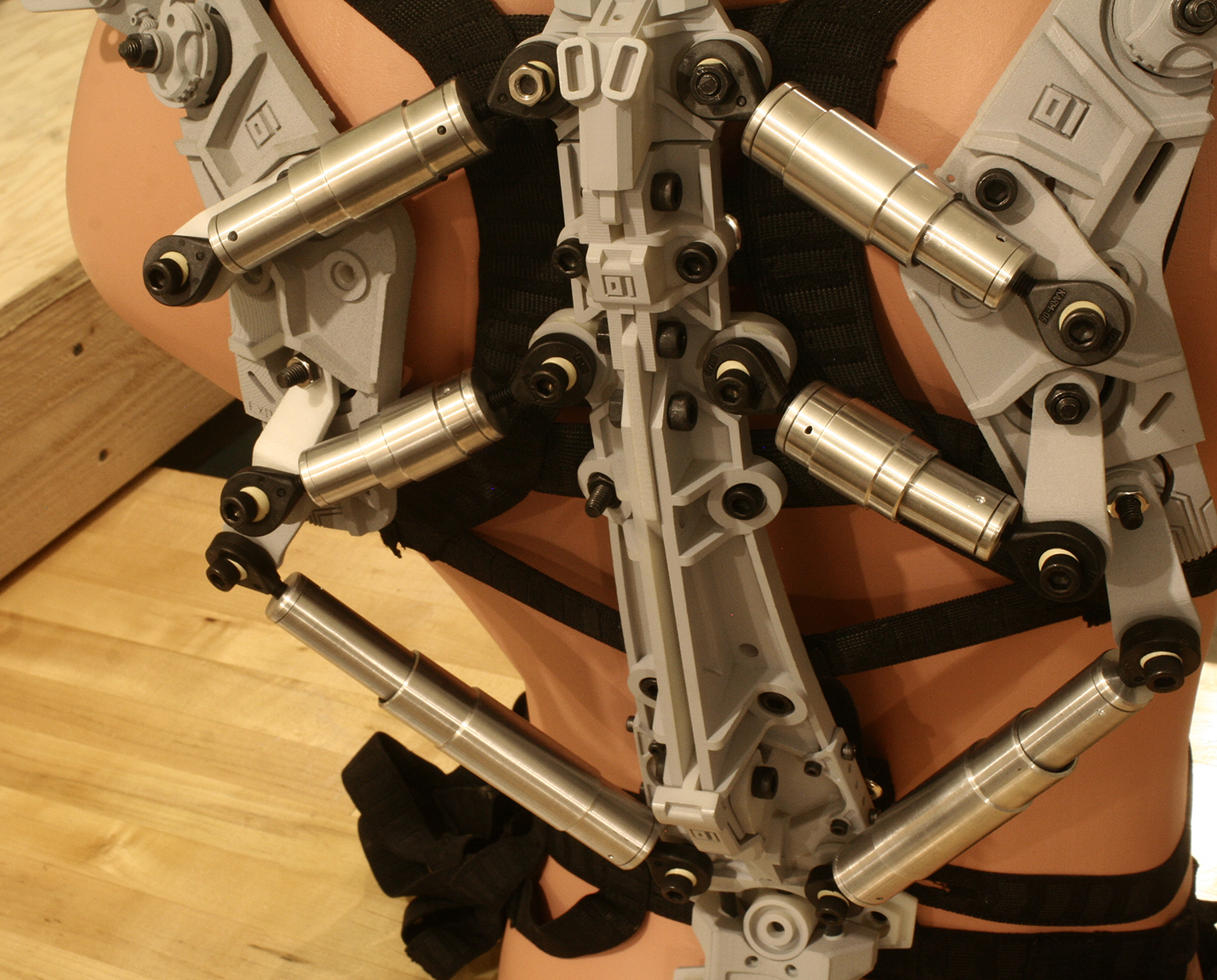

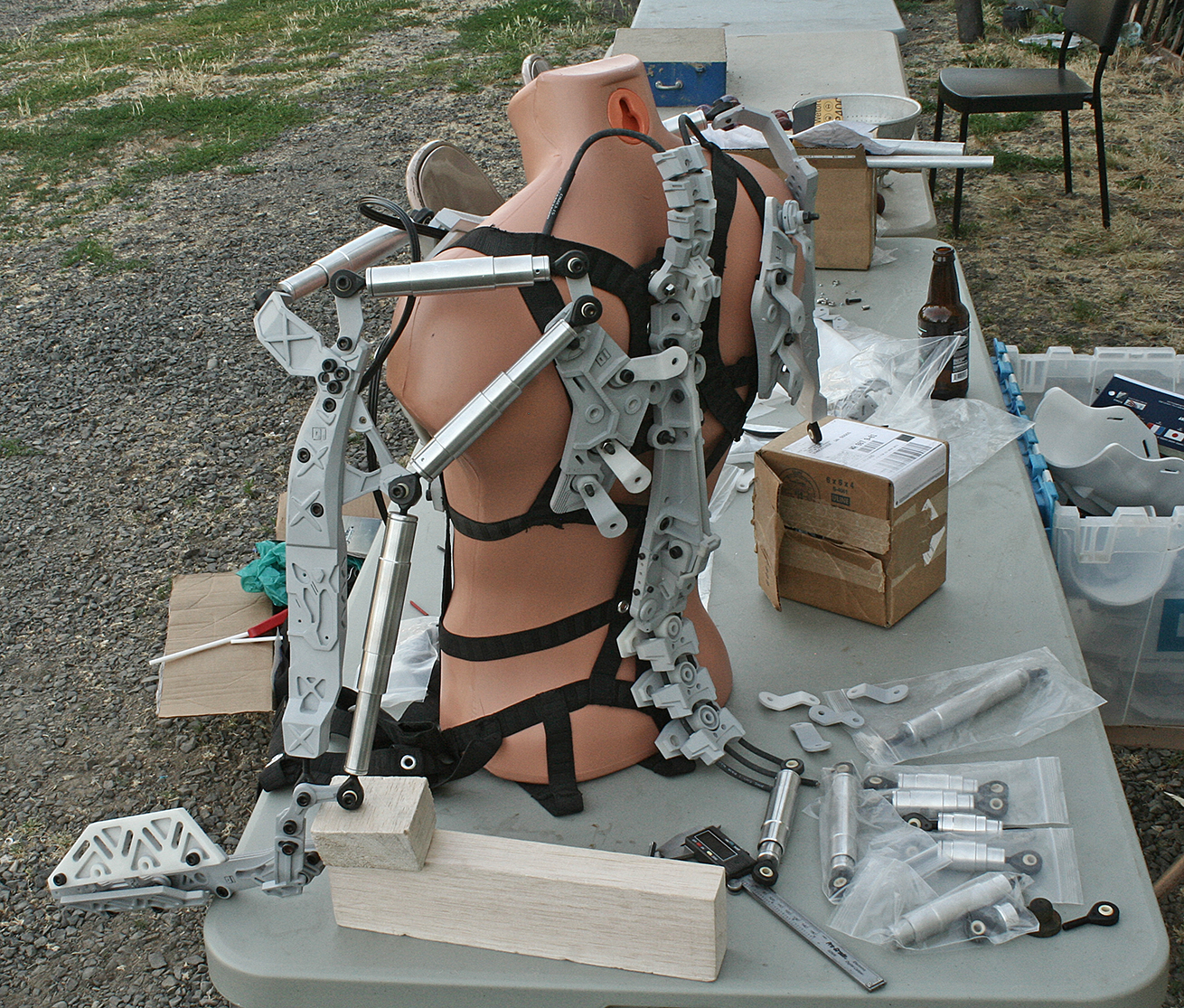

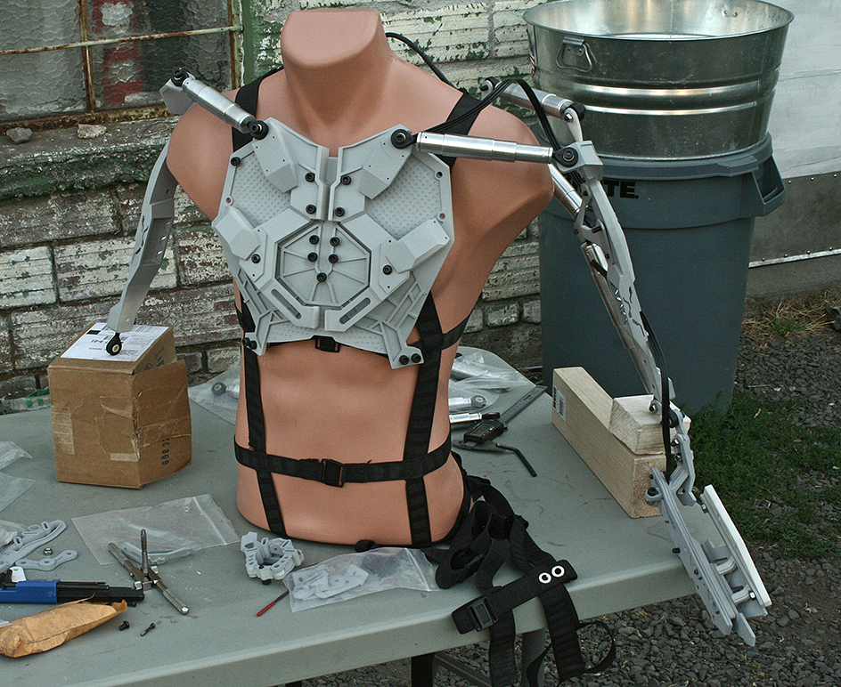

Question: I've noticed that some of the attachments to the pistons (arm to forearm in particular) seems fragile (I'm thinking overall movement here). Did you test those in particular, or will they be made in an other type of material?
Hey, thanks! The only component receiving significant stress is the rotating shoulder connector, but all of the critical parts are made of Nylon-12 which has excellent elongation on break (easy to bend, resistant to fracture). The left shoulder connector has a very thin support mount for the pistons - I increased that to 4mm but only for the right shoulder connector, since I ran out of budget on re-printing parts with mistakes.
