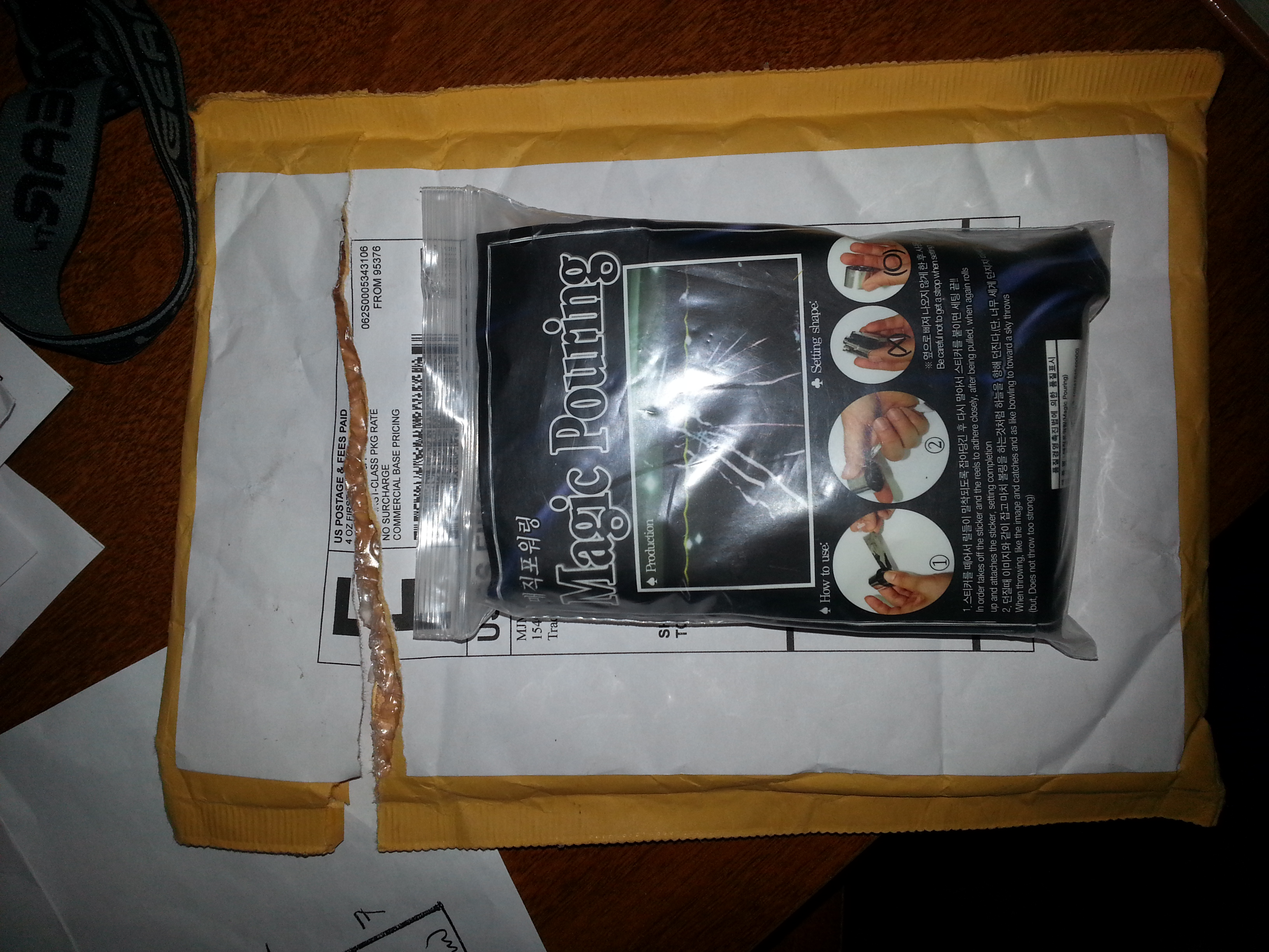

FINALY my pour streamers came in... I have put together a make shift barrel for the streamers to fit in and connect to my co2 tubing. Just have to wait for the epoxy to dry to do the first test shot.
Ok the make shift barrel i made last night did not work it was two lage and alowed the co2 to escape without much force behind the streamers.... so i unrolled the steamer until i hit the seven individual roles and then I inserted them one at a time into the previous barrel made of pvc. this worked much better. still have some tweaking to do. on the video i shot you did not see all of the streamers unravel as i shot them out of frame. :( but it did rather well. they ended up hitting the garage door so i speculate that in an open aria i could get them to shoot out 20 to 25 feet. this is my video followed by a stock video from the manufacturer.
I Need to know from you RPF individuals do the silver streamers take away from the Venom feel because they are not black. that is my only fear with proceeding forward with this particular material.
