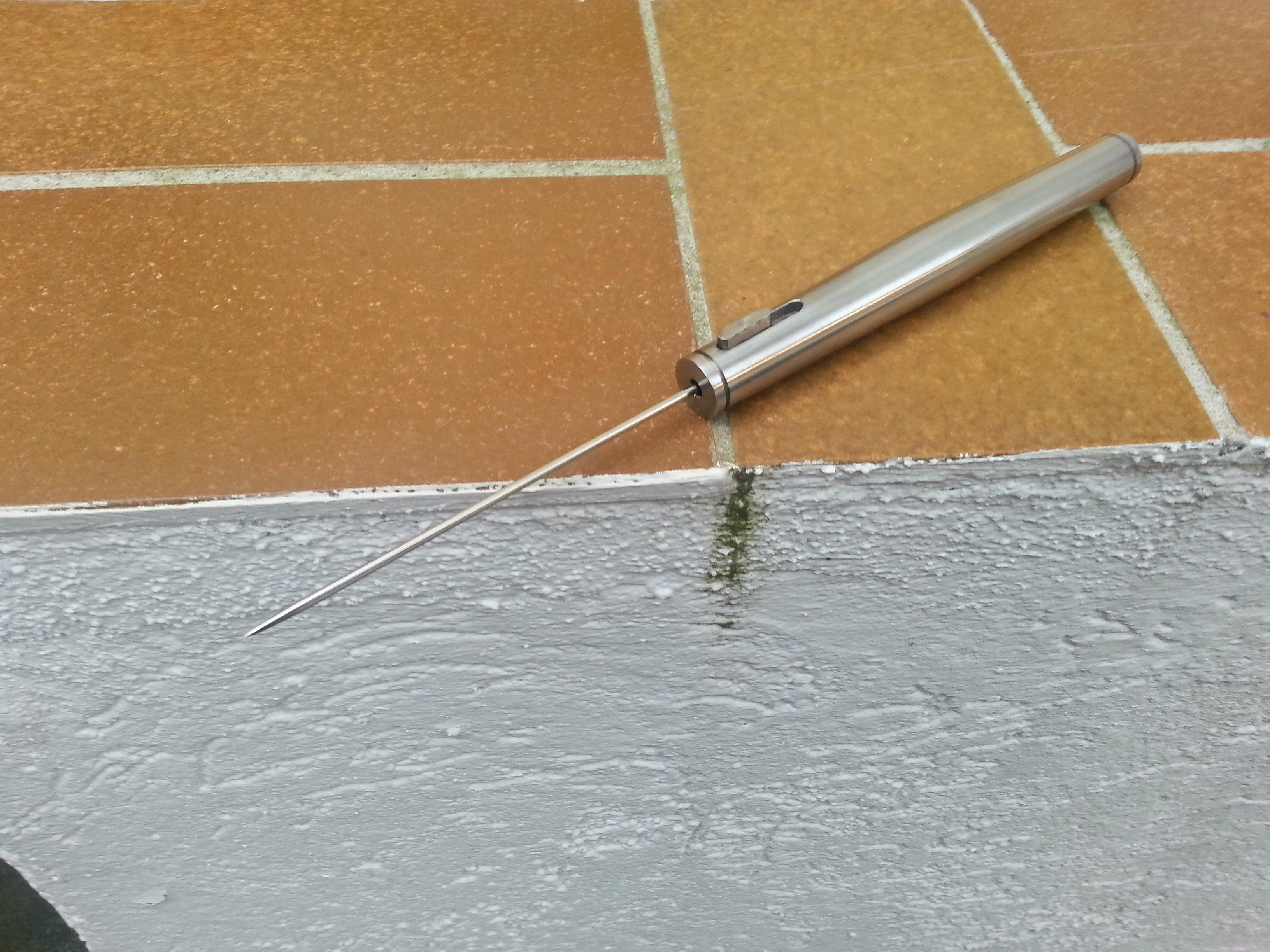

I am currently building a fully functioning X-files alien stiletto. It is double action out the front, spring operated. For safety and legal reasons, I have designed two safeties into this project. The first is a weakened carbon fiber blade, that will break with enough force applied. It requires only a few pounds to do this. Secondly, I have designed a fail safe in the secondary lock, that if the blade is not defeated, it will automatically return inside the handle to prevent injury. Now that the legal stuff is out of the way...

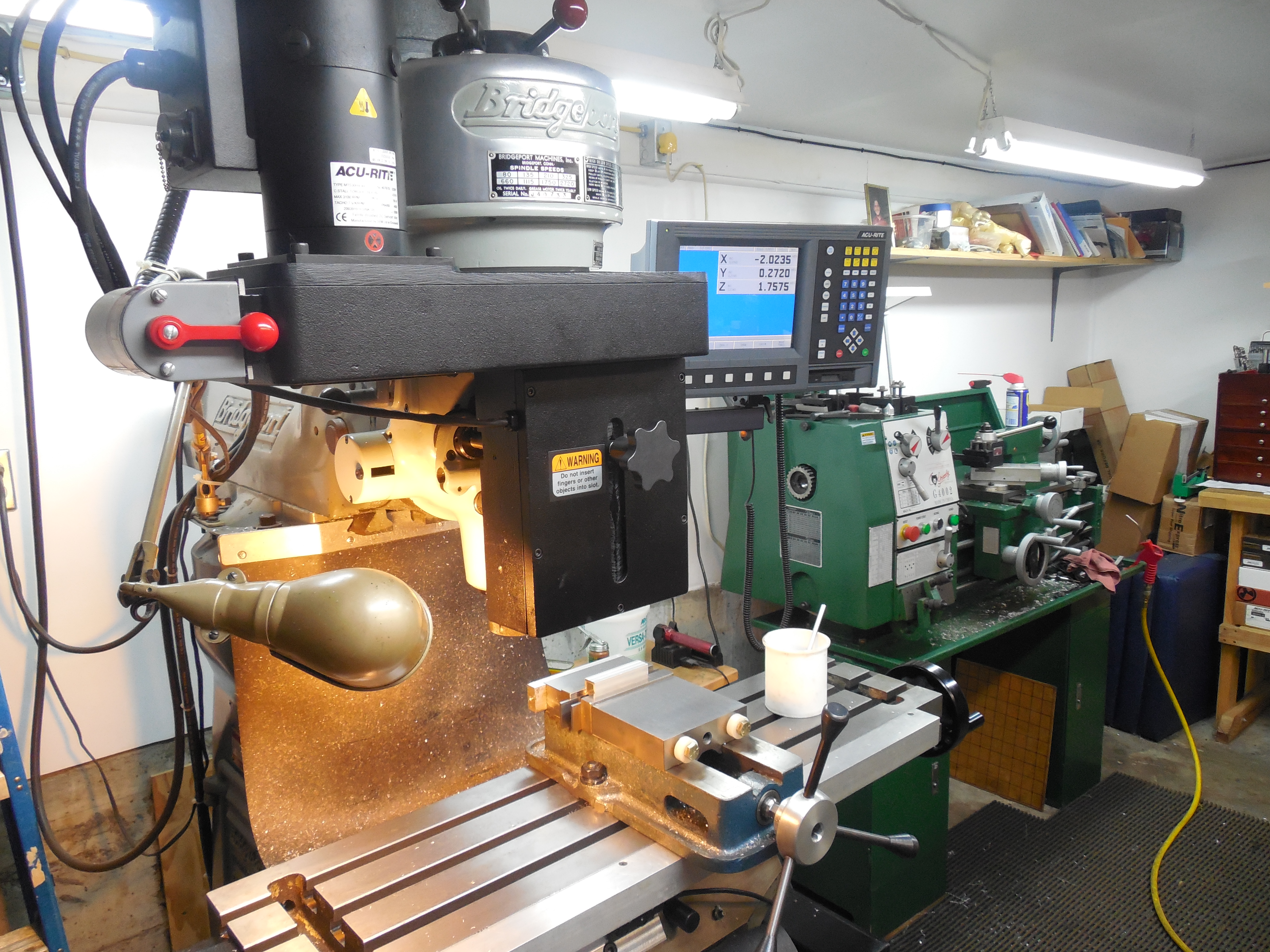

To start with here are the machines I am using: a Bridgeport Mill with Acu-rite control center and a Grizzly lathe.

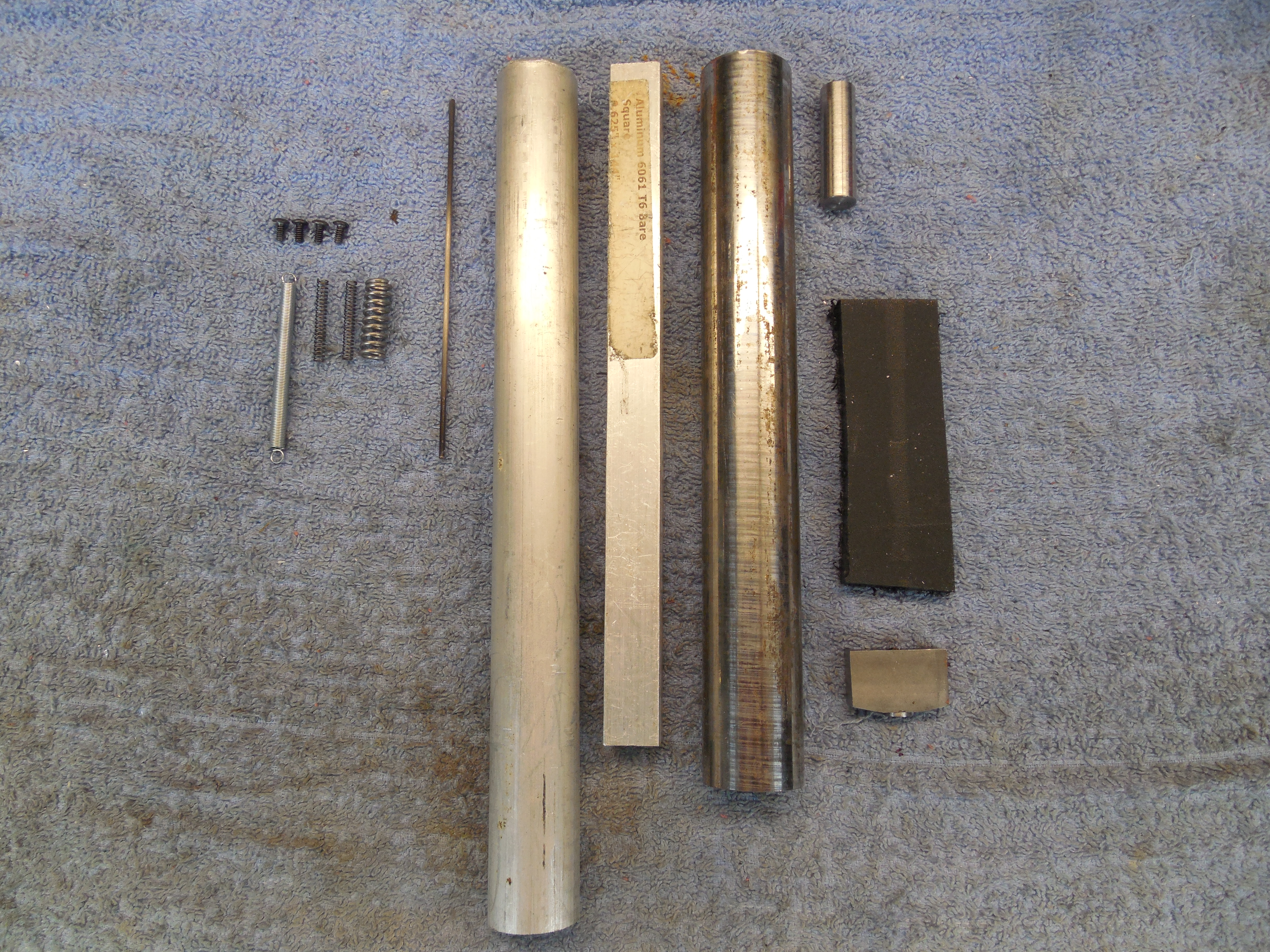

The materials: Starting from the left, 4 small screws that I have to turn down, 4 springs of various size, a .070" X 5" carbon fiber rod, 1" X 10" 6061 round aluminum bar, 5/8" X 8" 6061 square aluminum bar, 1 1/8" X 8 1/2" 8620 round steel bar, 7/16" X 1 1/2" 4140 round steel bar, 1/4" X 1 1/4" X 3 1/2" random plastic and a 1/2" X 1/2" X 1" 4140 flat steel bar.

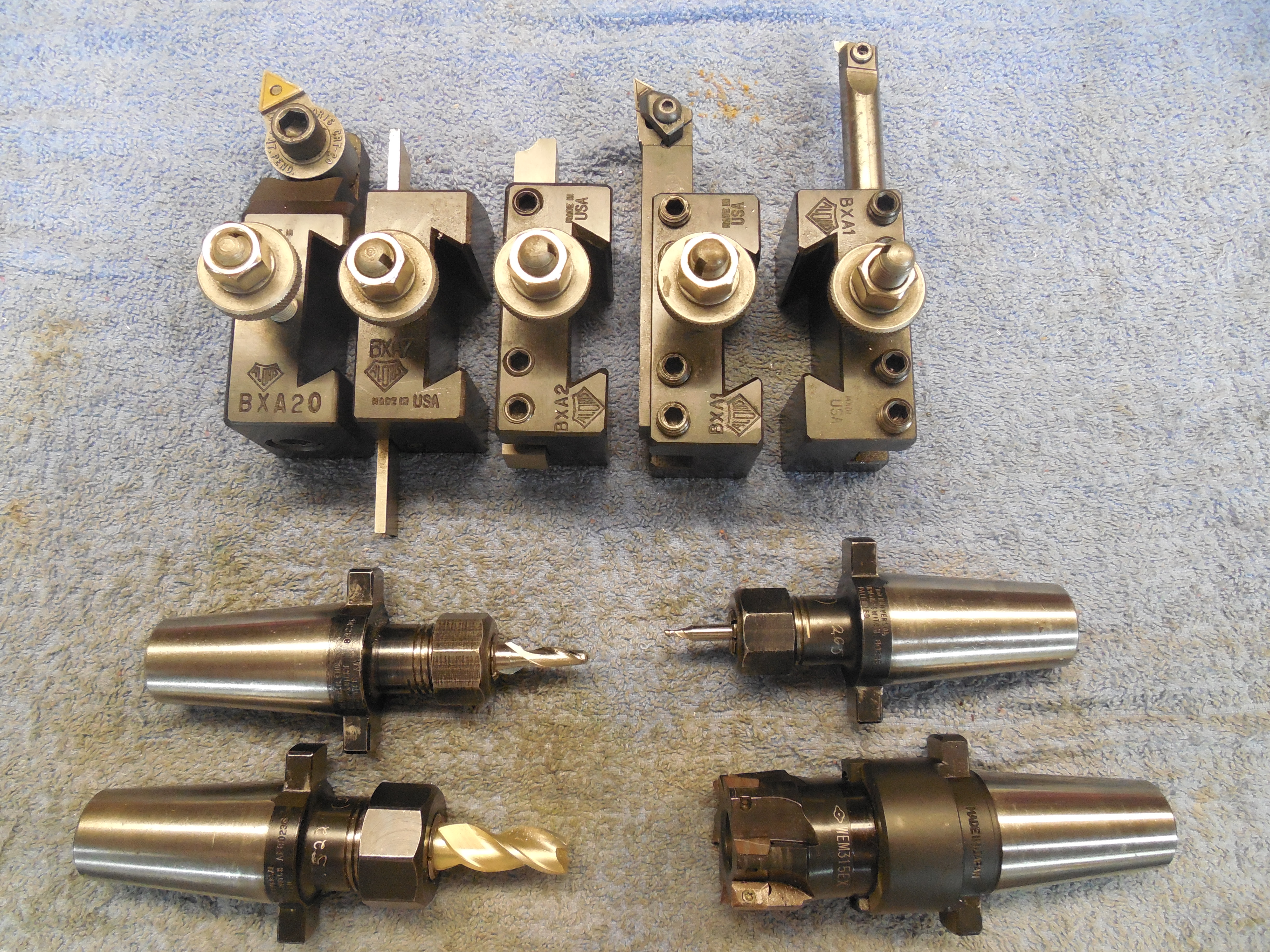

Lathe tools from top left to right: Adjustable angle tool, cut-off tool, custom ground radius tool, 30 degree tool, 1/2" boring bar. Milling tools from bottom left to right: 2 flute 1/4" ball end mill, 3 flute 7/16" end mill, 2 flute 3/32" end mill and my 1 1/2" fly cutter.

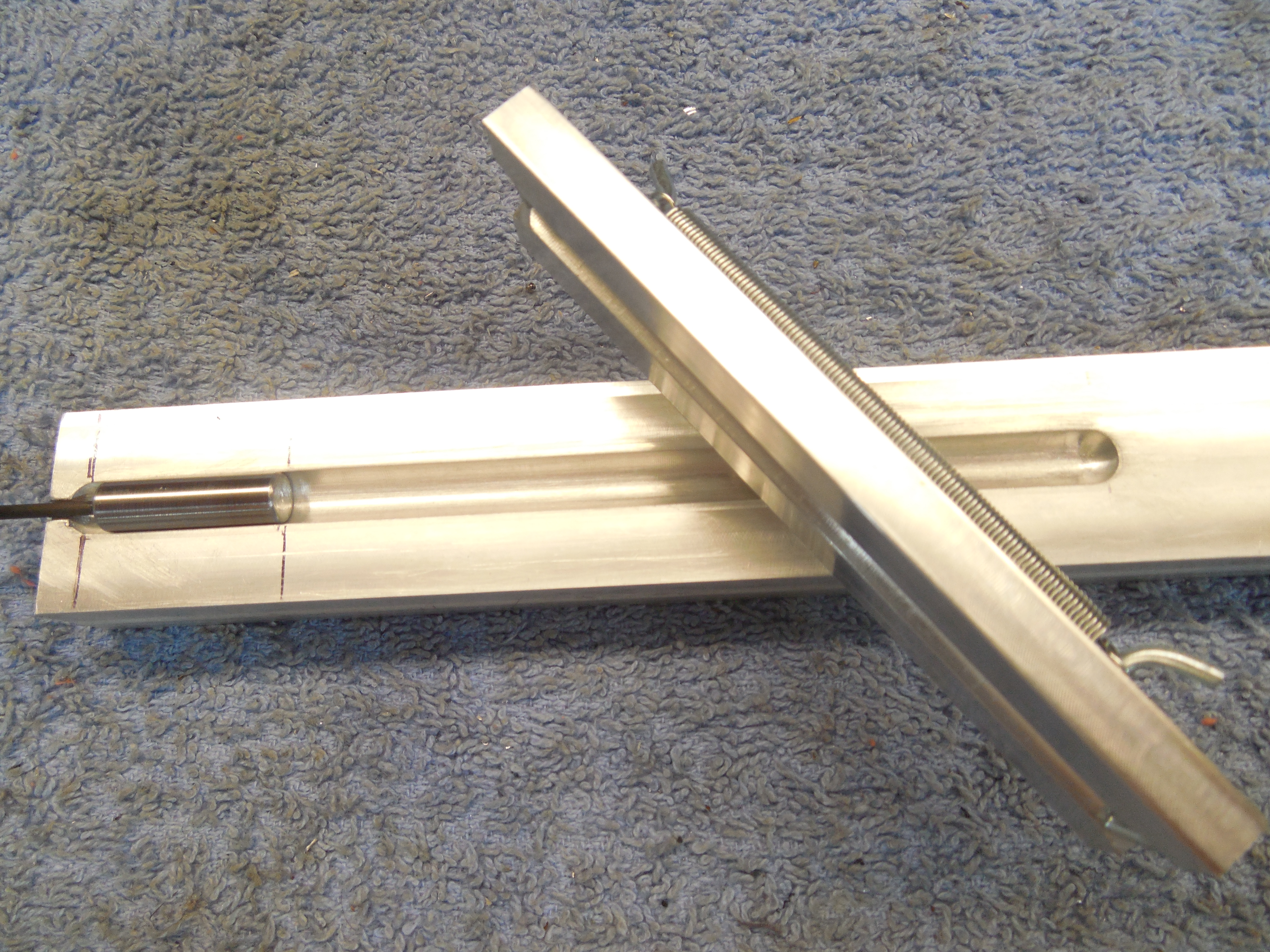

Finally I have my mockup. This is obviously very rough and was only used to proof my concept, it is also much larger and without the safeties of what I will be doing. However, this is the only way to show the process from the inside. The piece on top, is actually on it's side and turned 45 degrees so you can see the channel. If you look closely you can see the spring on the backside. This piece I am calling the "Carriage". The piece laying down, with the channel facing up, I call the "Frame". At the very left of the picture you can see my carbon fiber "Blade" is set into a steel "Blade Holder", this is actually the final "Blade Holder" as the first two iterations I used brass, which galled too easily and kept getting stuck, and a 7075 aluminum "Blade Holder", also galled, thus my settling on the 4140 steel.
Finally I am not sure how the internal parts will hold up to repeated use, so I may change them after this project is complete and I do some wear testing. Why don't I just change the material now you ask? There are a few reasons. The harder a material is, the longer it takes to machine to the final dimensions, it also wears on tool bits more, weighs more and finally costs more.

The spring isn't under tension until you move the switch. Then a moment is created, wherein the spring is pulling against the blade and once the internal lock is defeated, it pops forward, or backward, depending on which way you are pushing the switch. Thanks Stieller and Sean.

Well with the new understanding that there is no tension on the spring until the switch is moved. this would be my stab In the dark. on the back of the spike part should be a locking notch for lack of a better term. and inside the body at both front and back there should be two locking lever's. when closed you move the switch forward to put tension on the spring and at the same time the back locking lever Is being raised out of the notch on the spike. when released the spring tension throw's the spike foreword to engage into the front locking notch and releasing spring tension. and moving the switch backward achieves the same in revers...
Let me know If I came anywhere close to getting that right...LOL
Nailed it! I have had to make an internal frame, since I don't have the room inside that a regular otf knife would have. I also have placed the blade in between frame and carriage. You will see all of this as I go along, then at the end I will do a video showing the functioning without the outside tube and then fully assembled.
