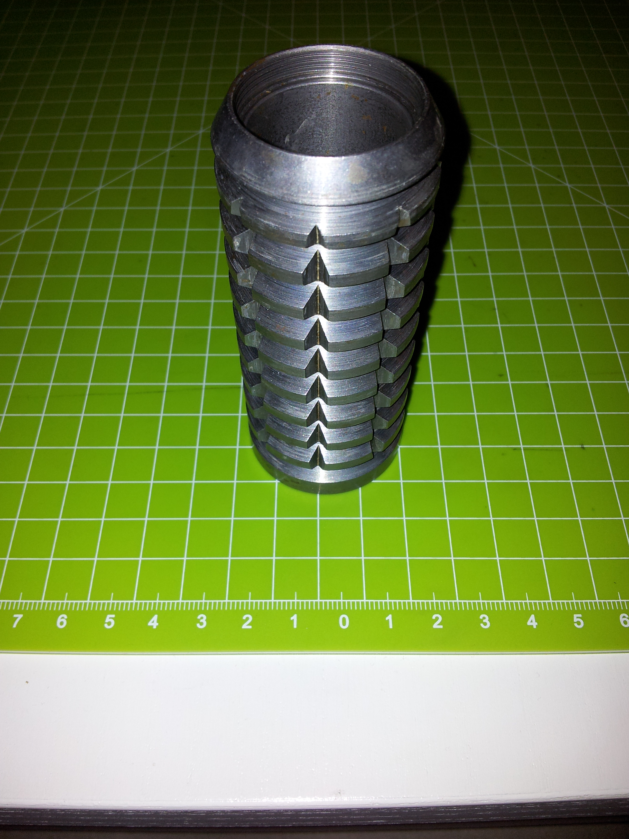

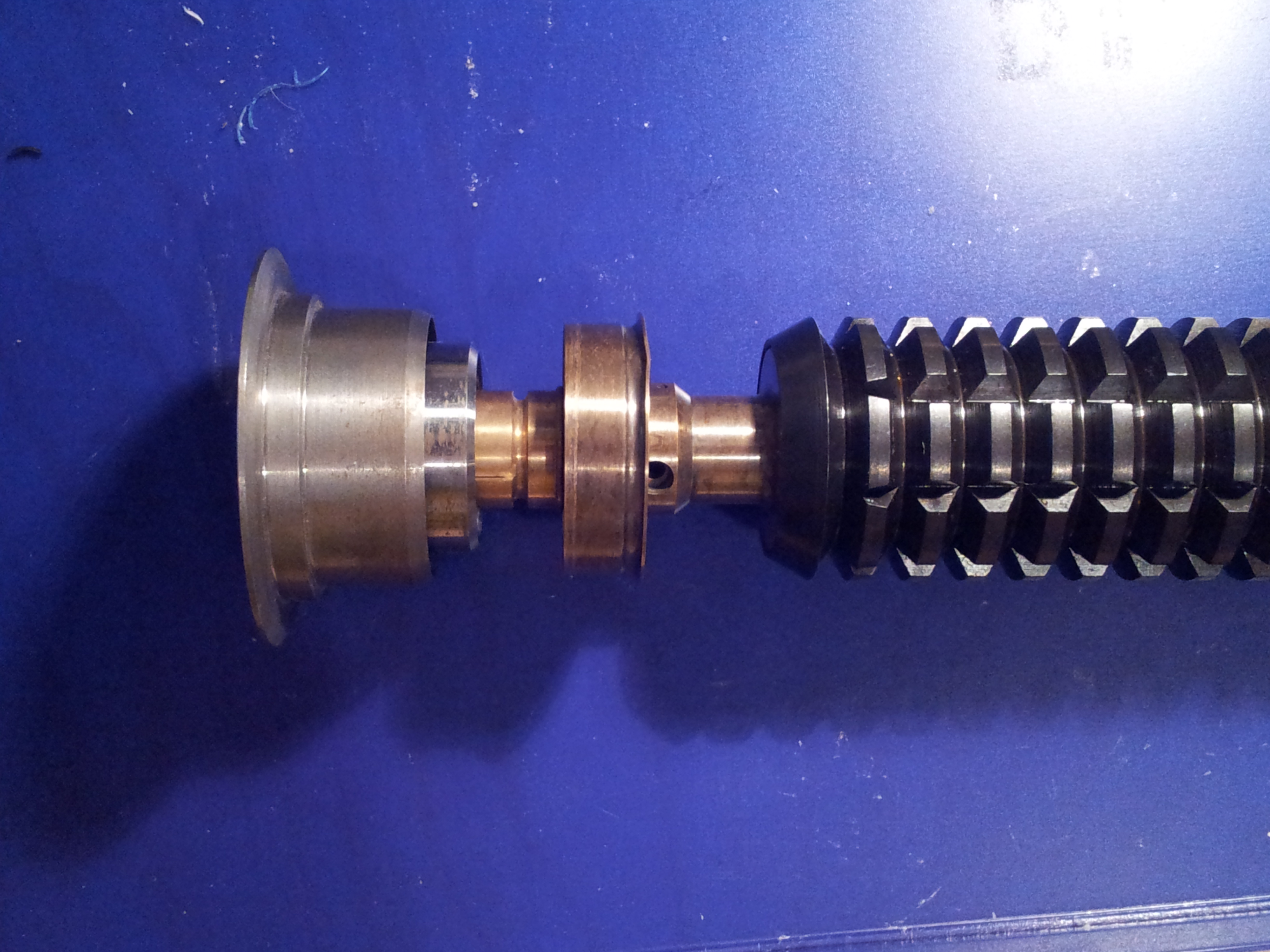

I'll start with a grenade part and a booster from Russ. (I know, accuracy. But there are so many oppinions about that and for me it's fine this way. And the parts where available ;) )

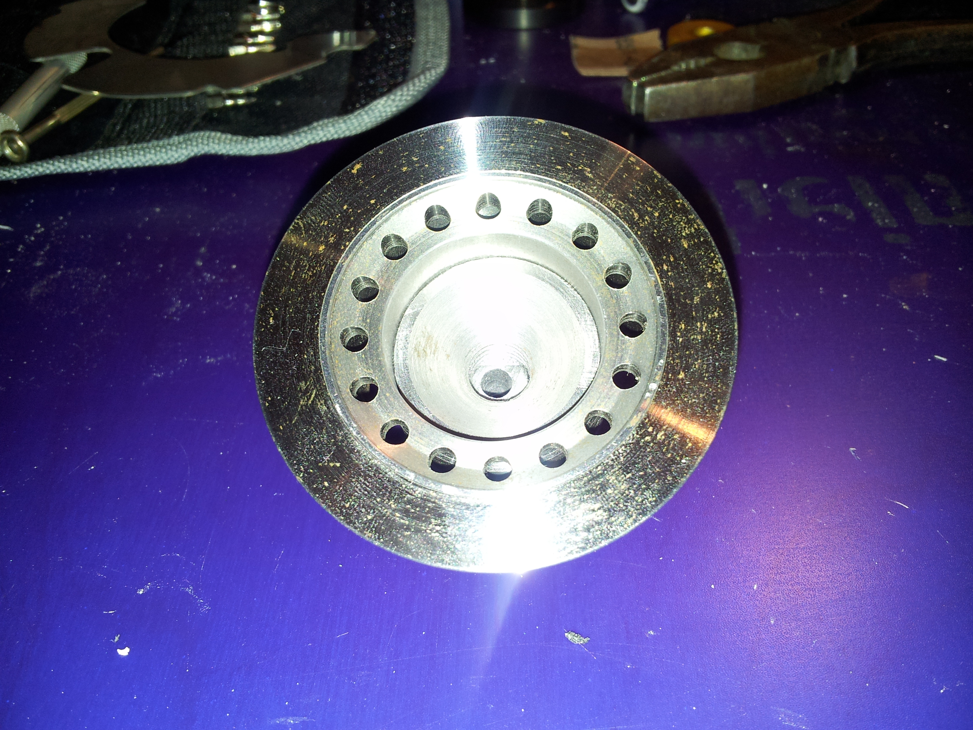

The grenade part I started with wasn't weathered or colored.
I thought about paint or some gun blue coloring kits, but decided to do the burnishing all alone. I study chemistry, so there is nothing hard about it.
If you want to do it yourself, you need chemical gloves and some laboratory glass bowls
I used 1000 ml destilled water, 600 g sodium hydroxide, 10 g sodium sulfate and 10 g sodium sulfite. Because of the sodium hydroxide you can heat the water to 170-180 °C.
Don't heat over 180 °C because your steel parts will become brown instead of black.
Plunge the steel part in this solution for 15 minutes. Then wash the solution off with destilled water and wipe the steel part clean.
Repeat this once again.
After wiping the steel clean you have to dry it, clean it from flash rust und oil or wax it.
You will get some realy nice black steel parts.

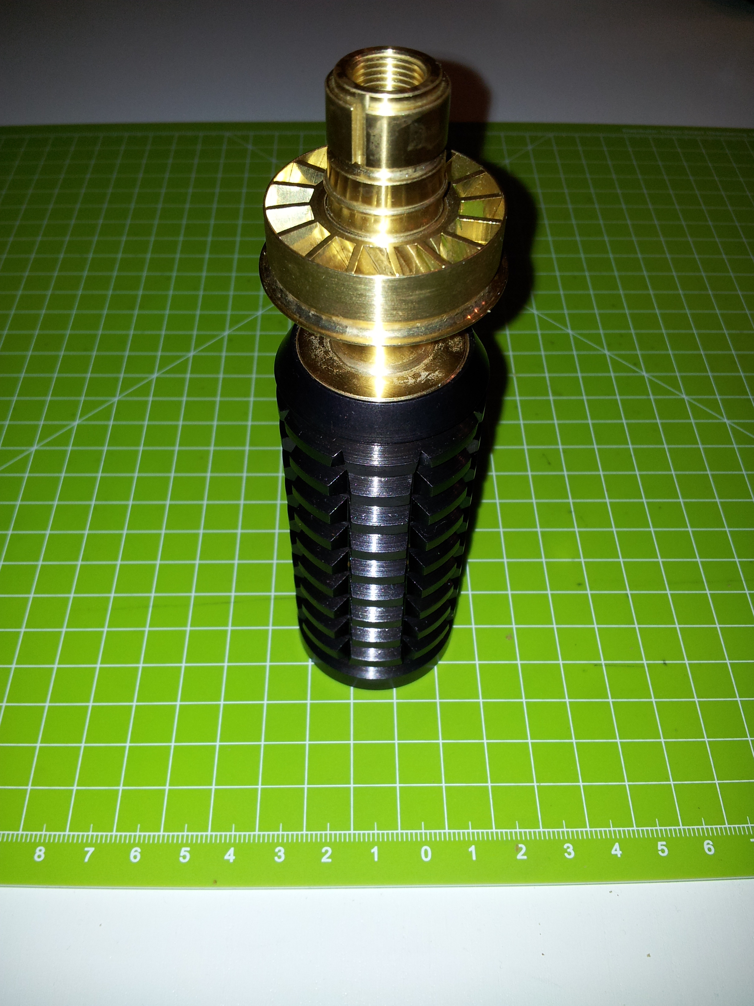

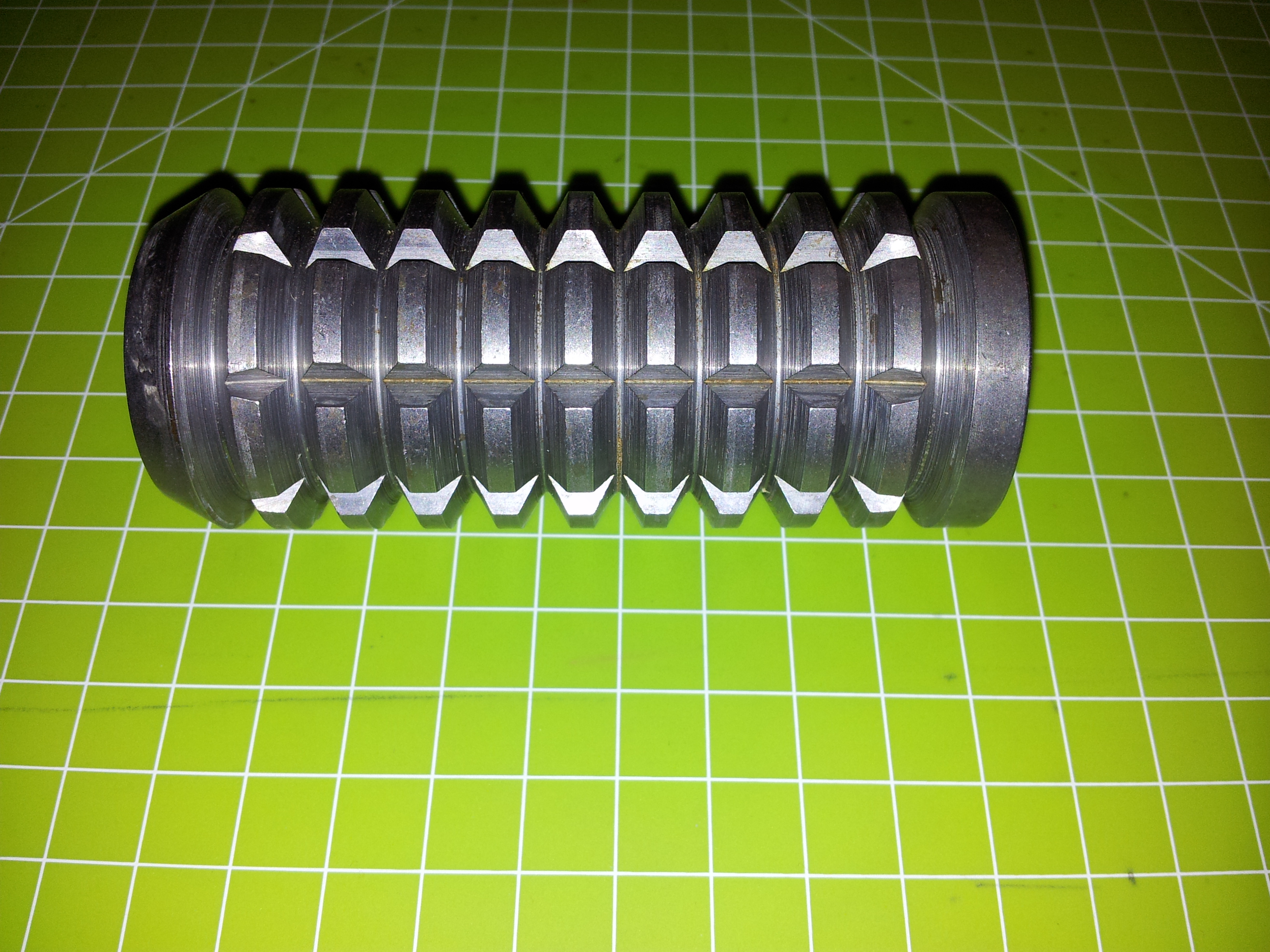

This is what I got.

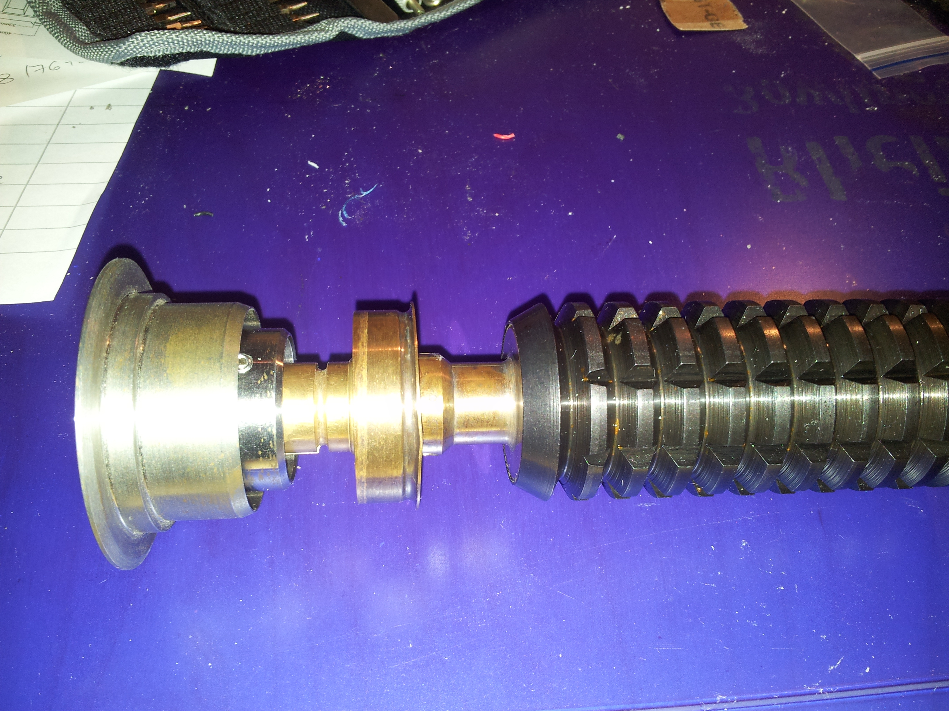

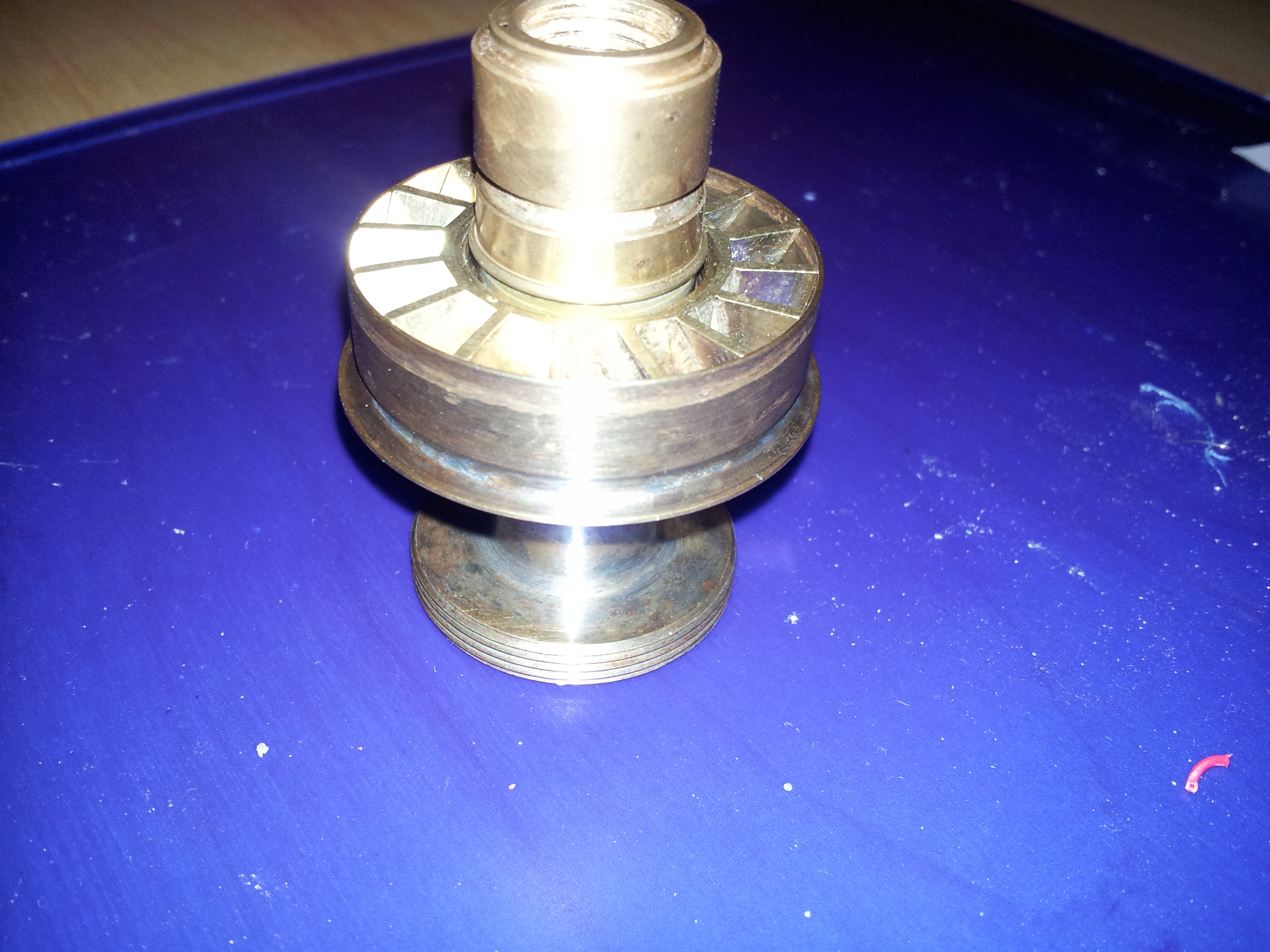

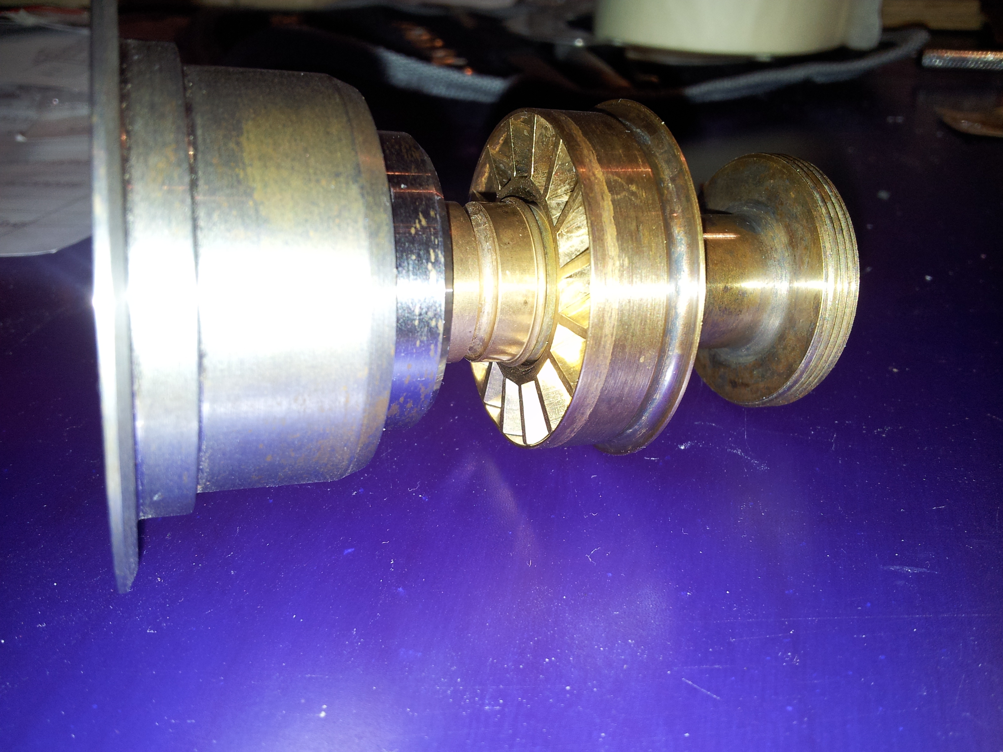

Next, I will weather the brass wind vane, I think it's a little bit too shiny.
If there is any progress I'll inform you and will post some pics.

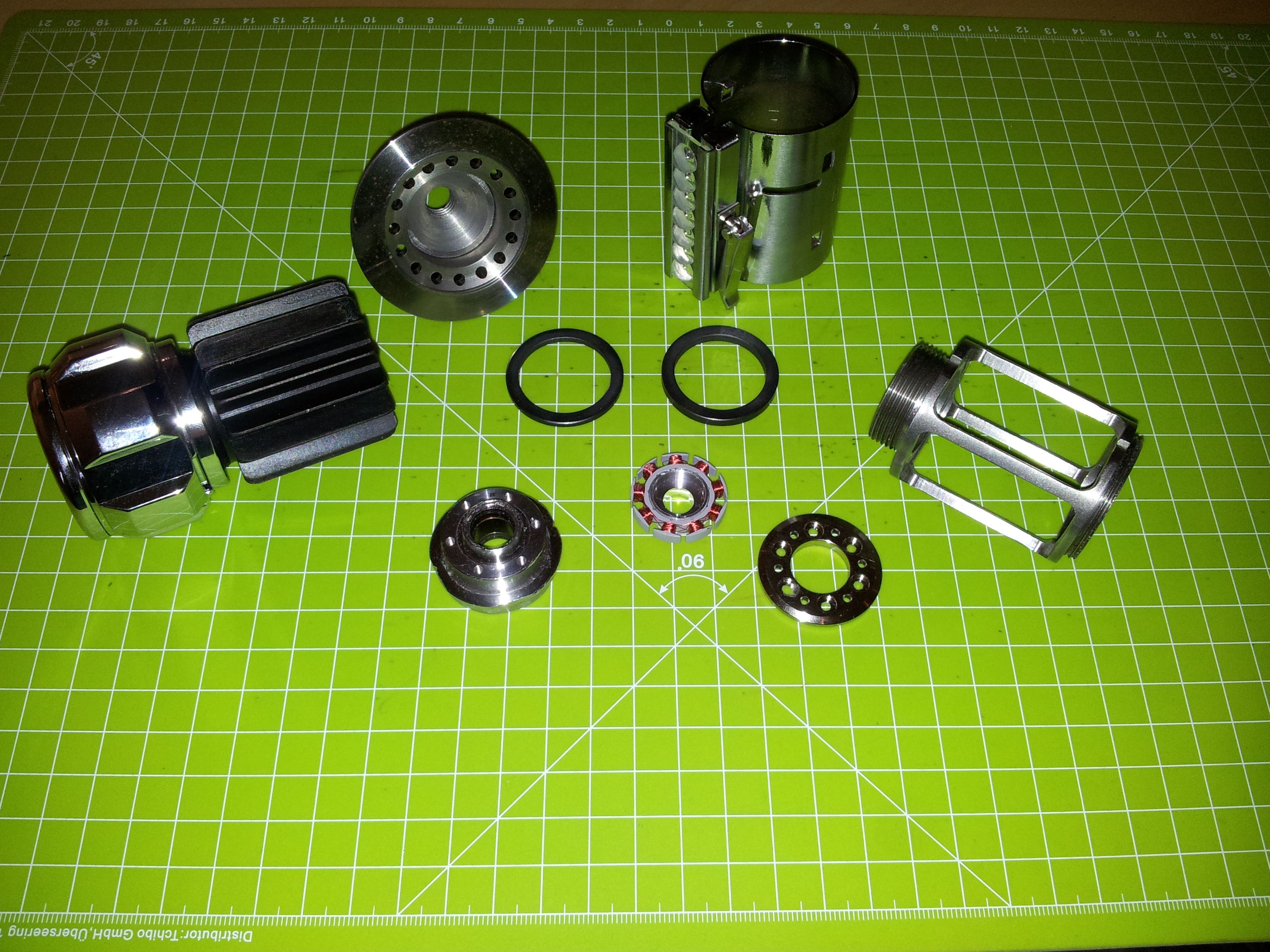

Here is a picture from everything I have now. Just to show how it could be if I’d assemble everything right now.
I used the hot salt-bluing solution from above to blacken the booster.
Then I went into weathering the windvane. It was too shiny, too golden. So I weathered it with a 10 % sodium sulfide solution. I’m really happy how it turned out. It’s not too dark but it isn’t too shiny either.
Some pictures of the windvane assembled to the grenade part and the emitter.

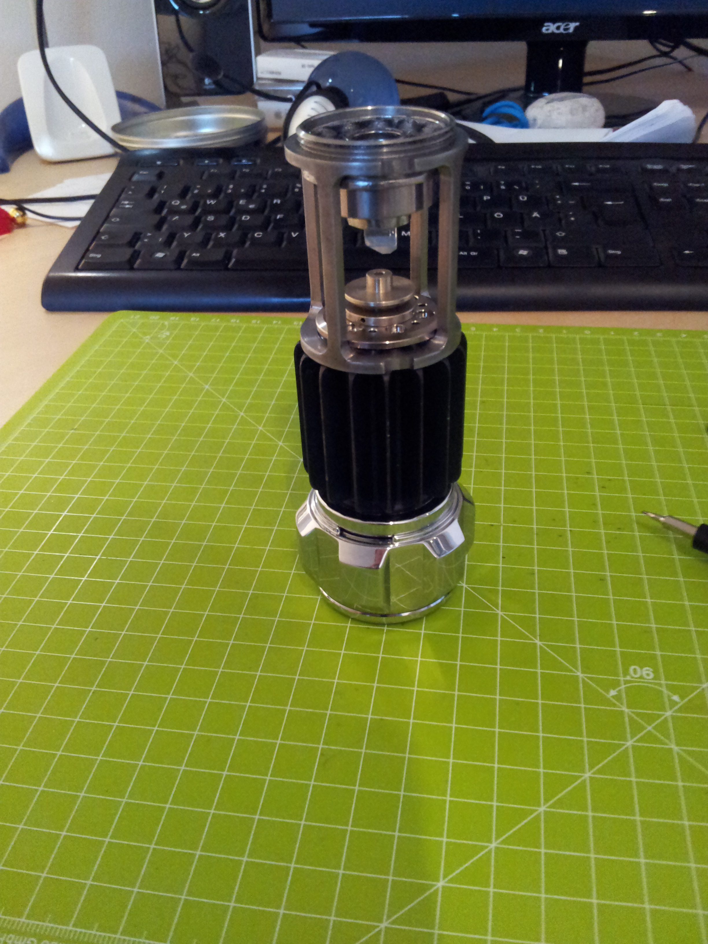

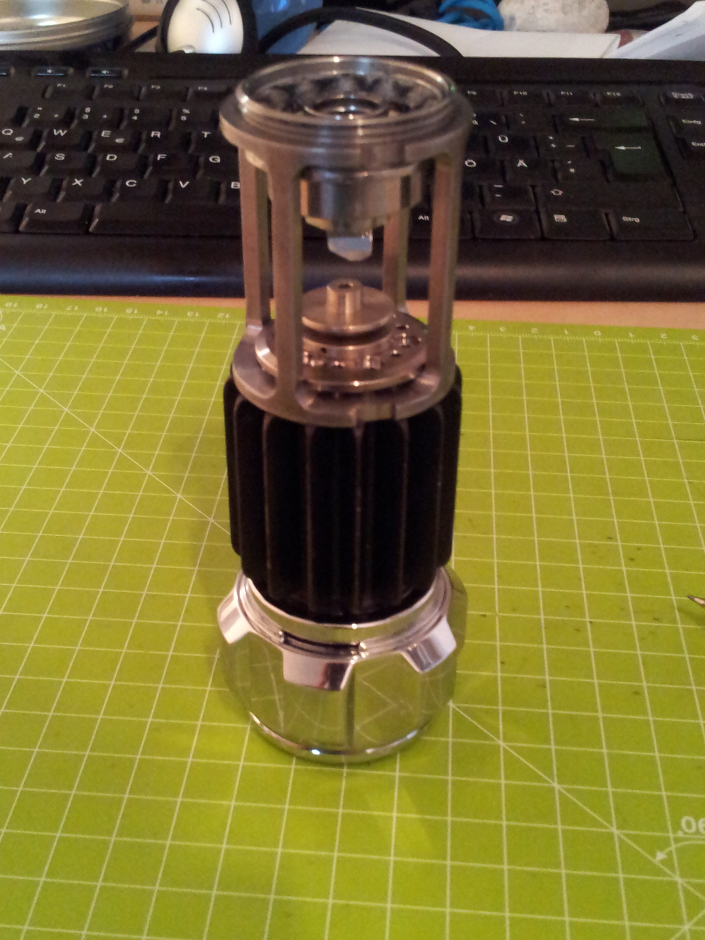

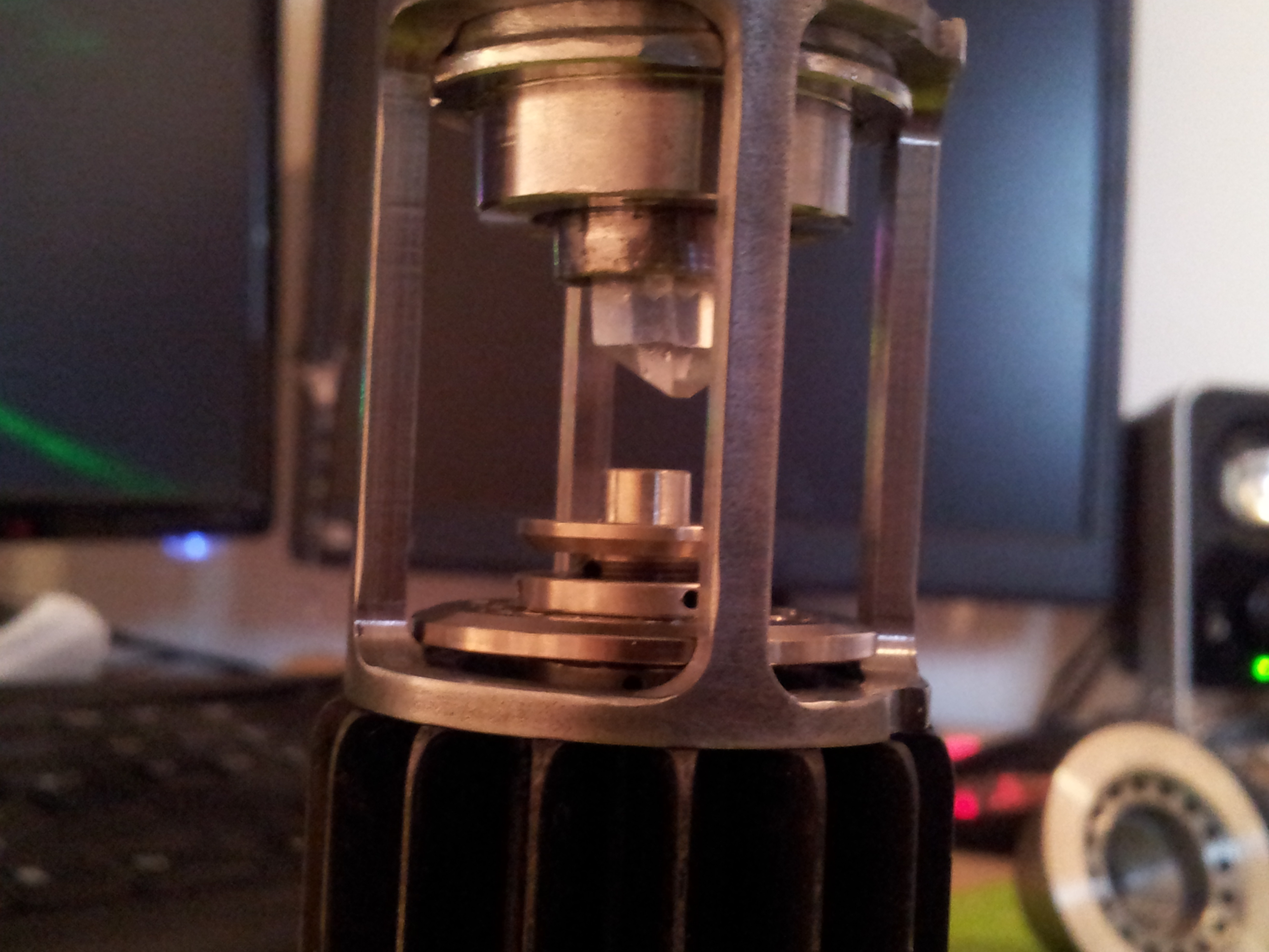

At this point I thought about the crystal chamber and how I could manage to build one.
I disassembled a computer hard drive to see if there were some parts I could use. And as many people before I found that the plate holder could be used as a nice crystal holder.

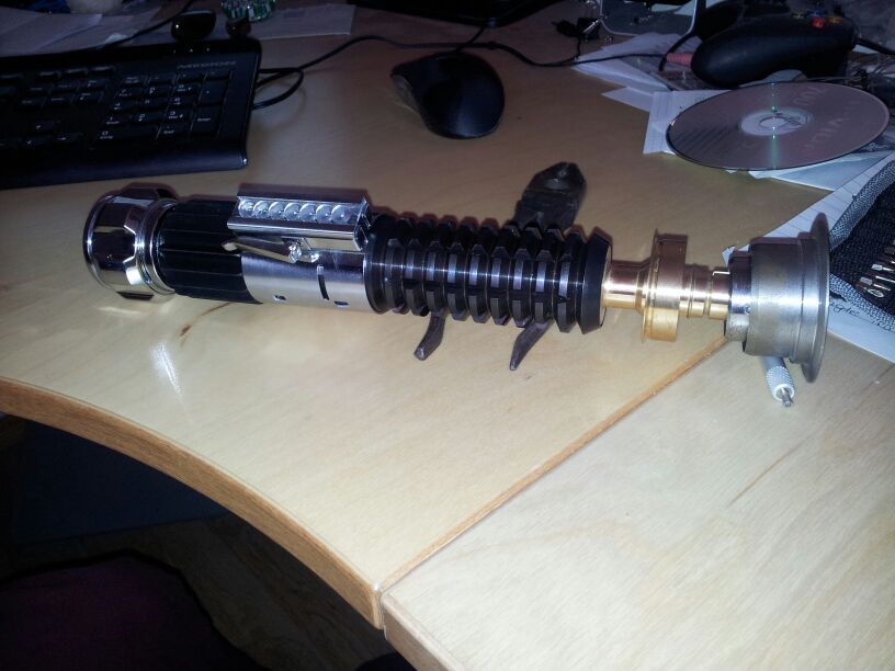

I assembled the lower half of the saber (the threads of romans pommel and clamp spacer fit the booster threads just fine) and fitted the plate holder together with other parts and a crystal into the hollow clamp spacer.
Some pictures to show you how it may look.
Feel free to comment and tell me your opinion.

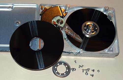

so where does one find that 'plateholder' part in old PC hardware exactly or did you add other parts to complete the crystal chamber perhaps?
I took the parts out of a harddrive. It is a so called plateholder. This thing is holding the memorydiscs and includes an electromotor.
You can disassemble everything and will get the parts you can see in the picture below. I pulled out the electromotor and got a hollow plate/crystalholder.
Lots of people had used the innards of an old computer to build crystalchambers. When I disassembled the harddrive I just understand it.
