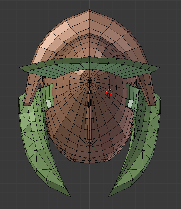

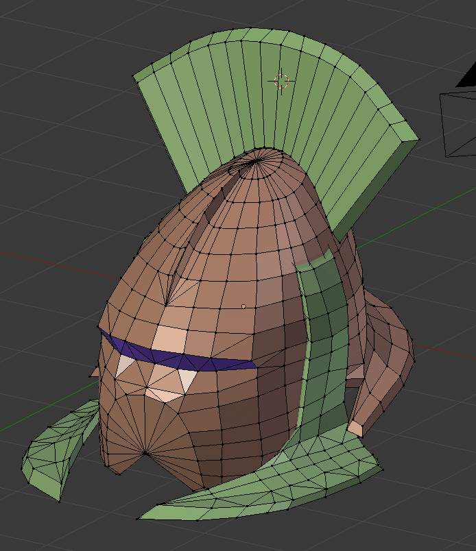

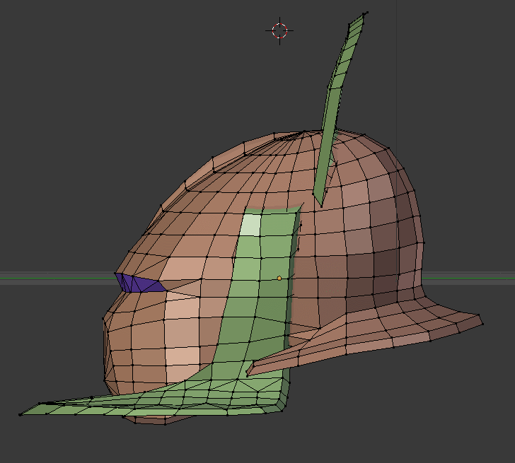

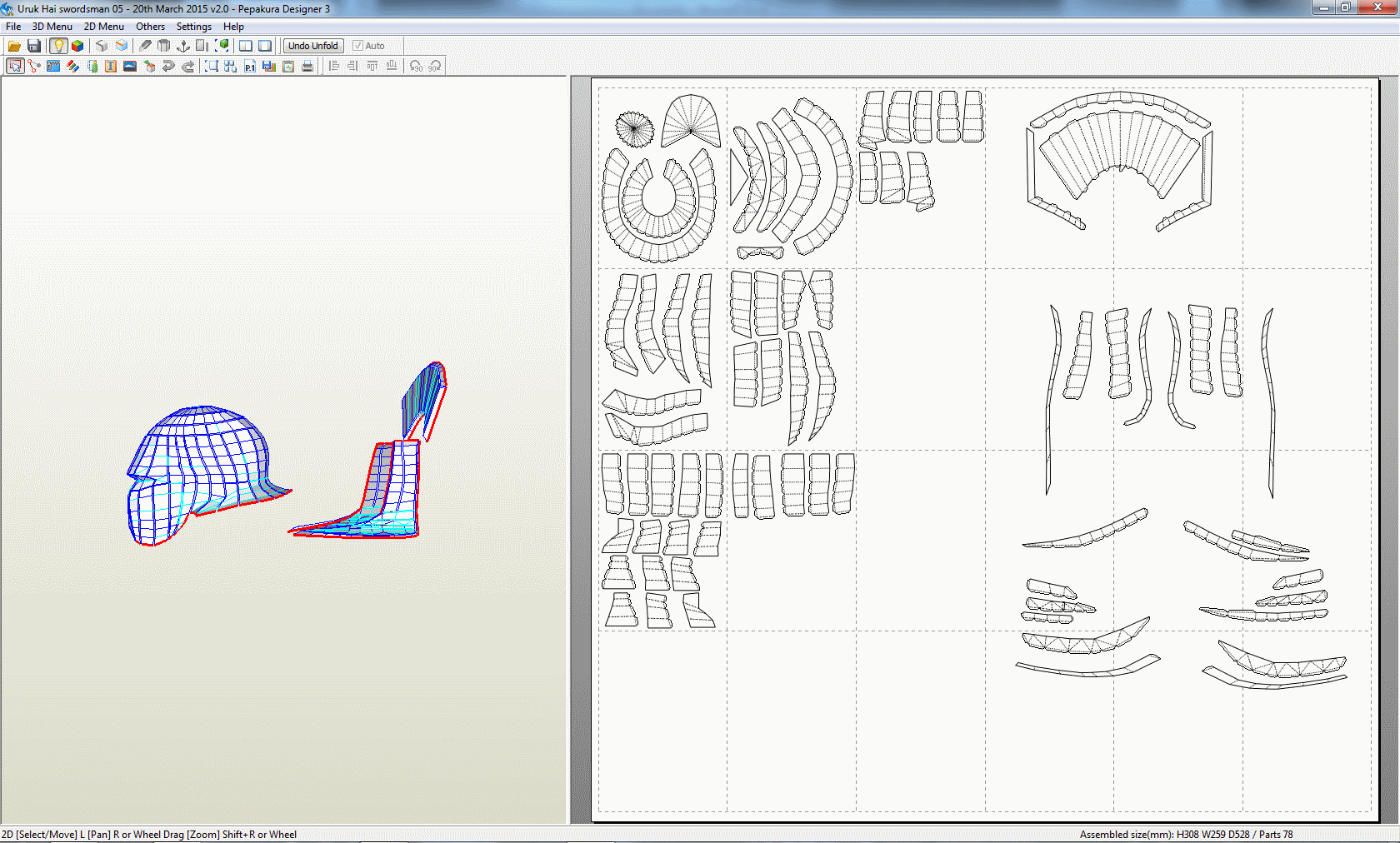

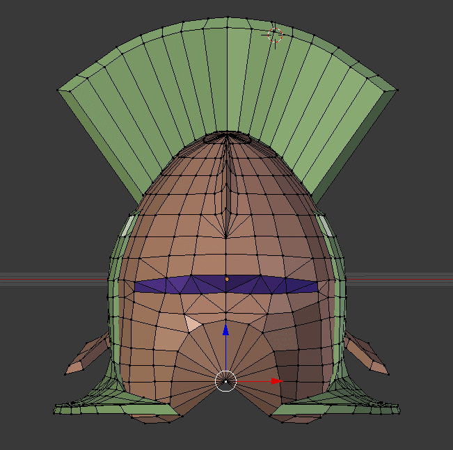

Here's my first shot at making an Uruk Hai infantry helmet - the one they call the Swordsman in the Lord of the Rings book 'Weapons and Warfare'.
I adapted my Berserker helmet, and elongated the back crown of the hear to match the profiles of the various screen caps and pictures I found. It's all closed in so that Rondo can be slushed around inside before laying the fibreglass. I find it easier to have the eyes closed in and dremeled out after the glass is cured.
It's scaled as close as I could make it to the Berserker helmet, and it should fit most people. Or uruks.
The edges around the side plates and the crest are simply there to let the pep keep its shape while setting, and they can be dremeled off later.

As usual, feedback is appreciated, and I hope that this will be a useful file. The file is totally my own work, but I'm turning it loose onto the Net for free, so feel free to share it with whoever.

Cheers, guys. I've got the first build in the shed, with a coat of resin on, just waiting for my weird way of finishing - wax the inside when it's been stiffened with resin, slush some rondo all over the inside, fibreglass inside the rondo, apply another slush of rondo inside to smooth out any rough bits, then finish by peeling off the stiffened card from the outside prior to sanding and painting.
One thing I can see is that the rear part of the crown needs to be enlarged a little for a more roomy fit. When I get a chance I'll redo the mesh and post a Mk 2 version.

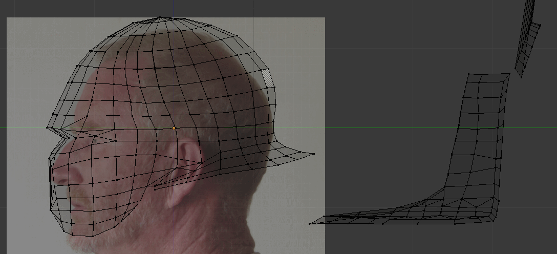

Hi Rupp - you've guilt-tripped me into finishing it! :D
http://www.4shared.com/file/2wTtcIlpce/Uruk_Hai_swordsman_05_-_20th_M.html
The pics are with the mesh re-shaped over my old dome, and the size is based on the width of the previous one, which should be fairly close for most people. Good luck, apologies for the quick and rough unfold, and please post any build pics - I'd really enjoy seeing some!
