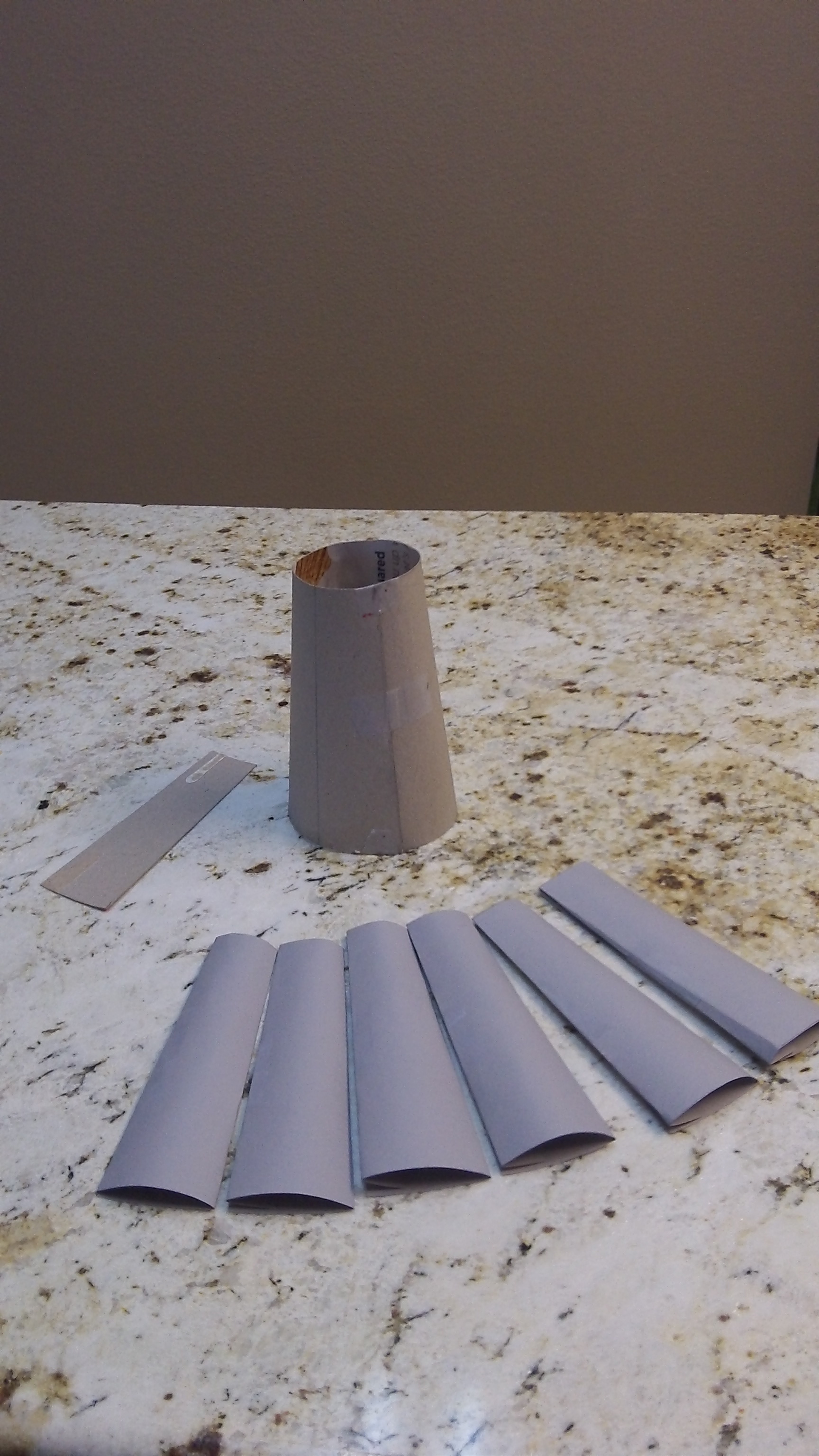

Eventually, I'd like to do a Spider-Girl suit— however, the options are kind of limited on that front, so for the moment I decided to try working on the web shooters. My thoughts are to do them as bracers, using Sintra as the base, with molded plastic (such as InstaMorph) for the 'cartridge' pieces.
Since I'll have to wait for the actual supplies to arrive, I decided to play around with cardboard and card stock in the meantime, to make a mock up and work out the sizing.
The edges (on wrist and forearm) weren't trimmed because I'm more concerned with width and spacing right now. The wider end of the cartridge pieces came out a little too wide, but otherwise I think it looks promising. Next thing I'll probably fiddle with while I'm waiting is a design for the trigger mechanism. What do you guys think?

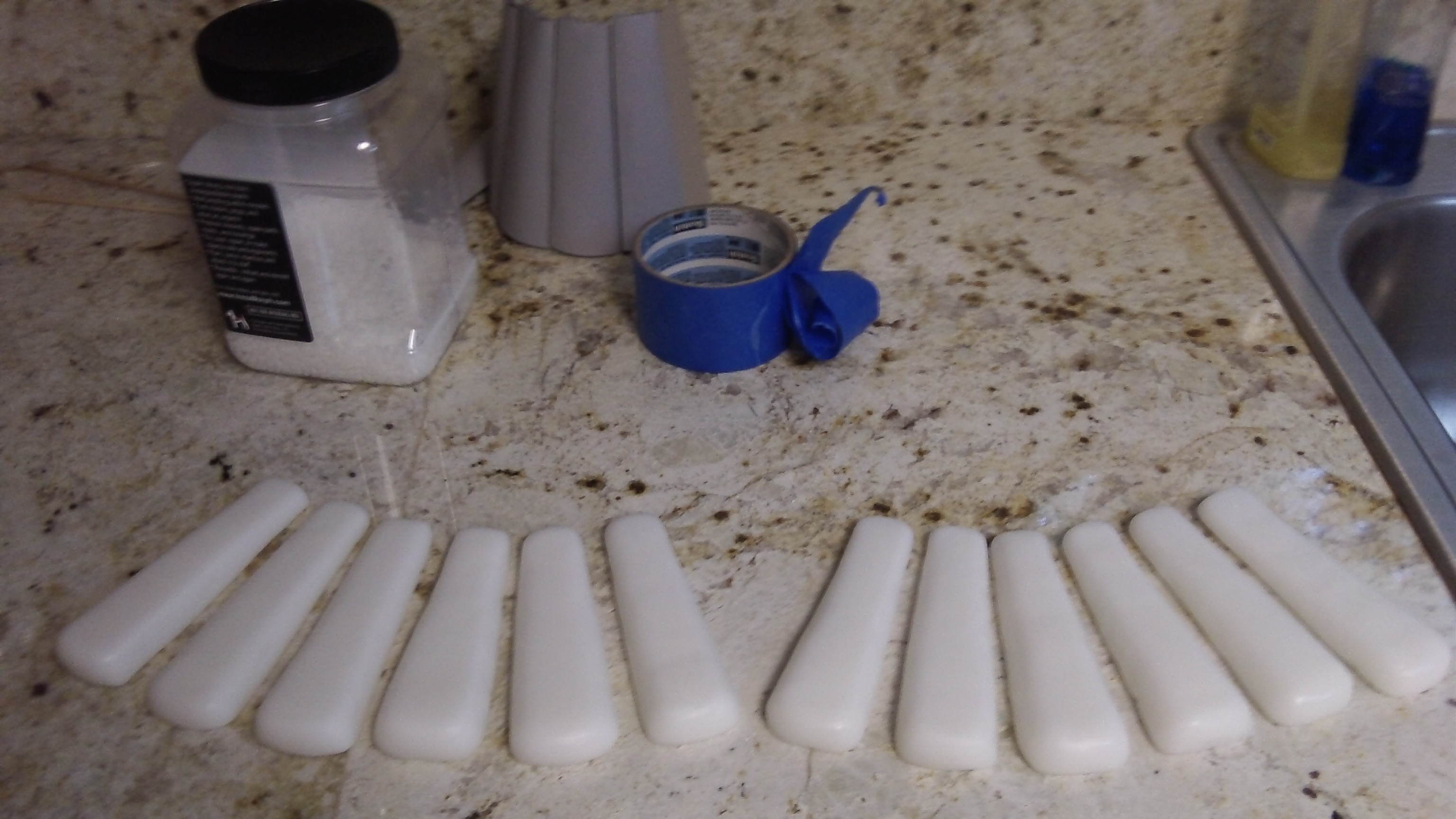

Here we go! All twelve molded pieces. They came out a little flatter than my mock up, but still have pretty nicely curved edges, so I'm happy with them.
If I were to do it again, I think I would try to make a wood form and shape the plastic over that, to create more of a shell— that'd make it lighter, leave space to work with for mounting, and hopefully make them more uniform. For uniformity, resin casting would probably be ideal, but... The trick is getting them to an exact shape and size where they will fit together and fit my arm. I don't want to cast six pieces only to find that they were a little off and have them go to waste, so... for now, sticking with InstaMorph!

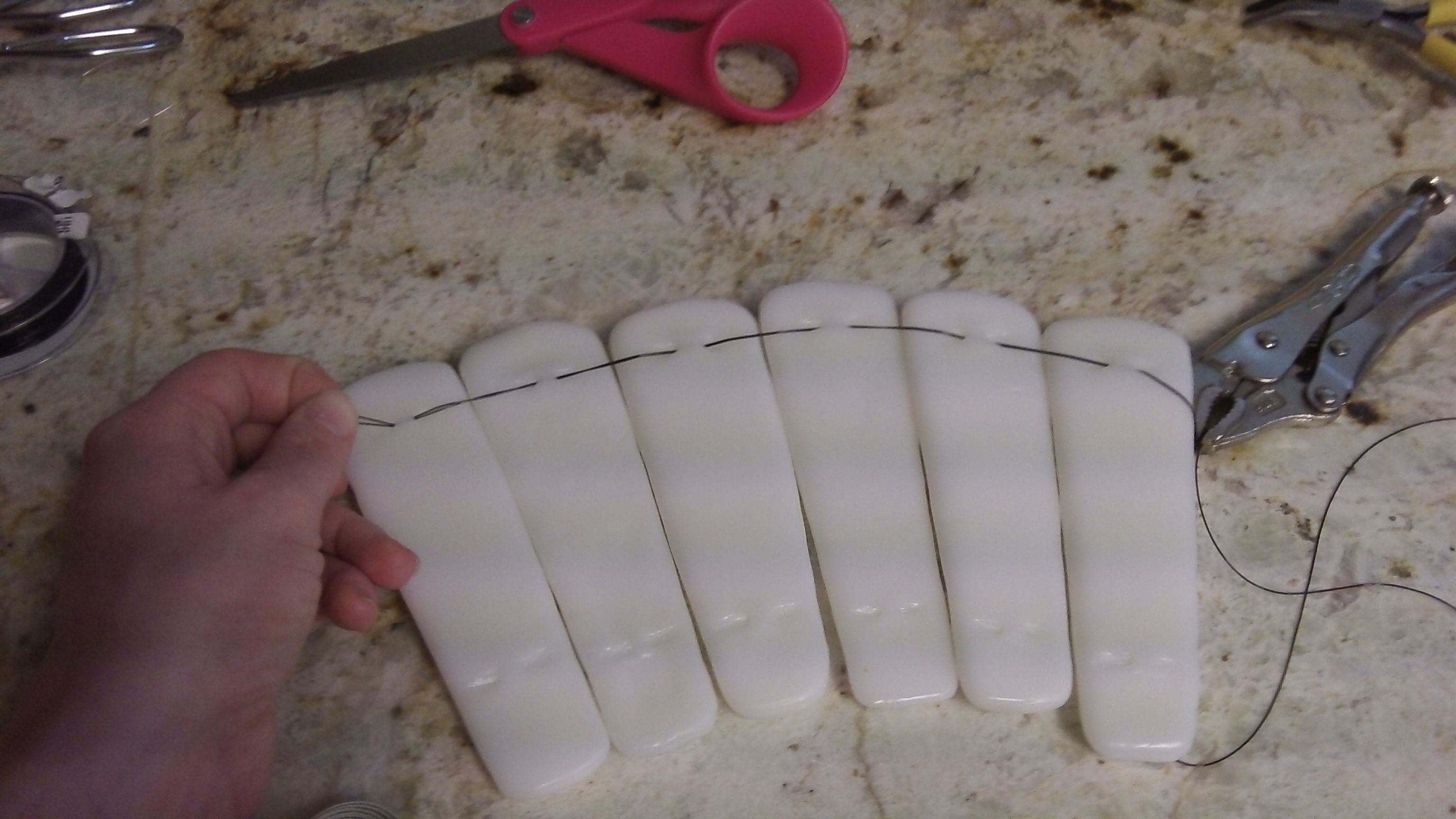

Threading the elastic through (0.5mm black elastic thread); went with four strands in each one. This was the single most PITA moment so far, requiring an extra set of hands and much cursing. For the next time, I will be lacing the same piece of elastic through four times instead of four separate pieces.

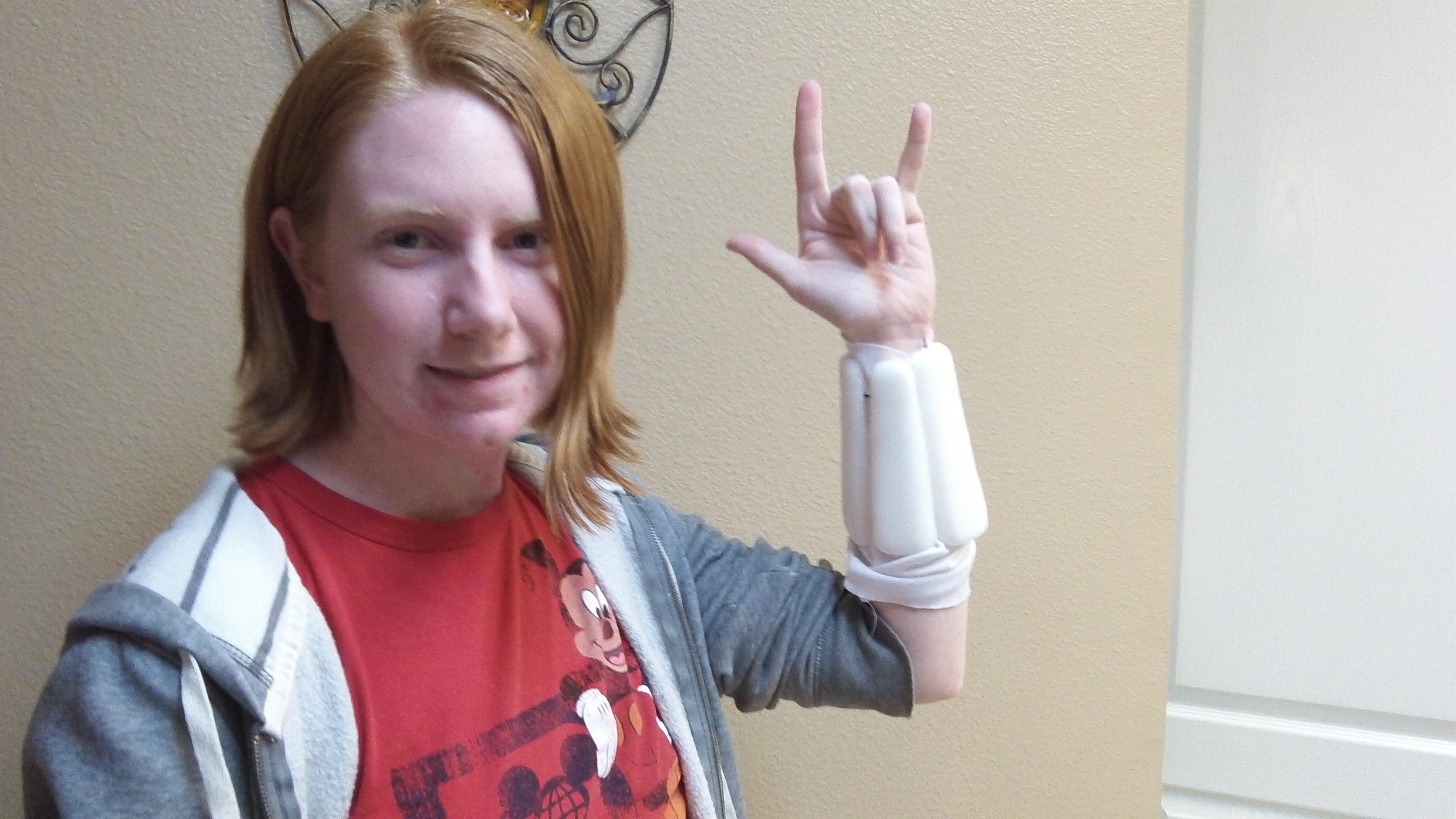

For the curious, that's a spare piece of lycra from my last project that I used to test how it would feel over the costume. Turns out I made the bands a little too tight, and since I will feasibly be wearing these for a couple of hours (and I would like to keep circulation in my hands), they got snipped shortly thereafter. It all works out, though, since I forgot to paint the first set before threading them. Besides loosening them up a smidge, they are actually really comfortable— they sit well and the weight isn't a problem.

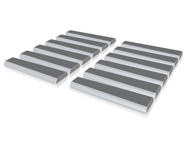

Got a little crafty with Autodesk 123D Design tonight! First time doing this so its a bit crude.Posted the project on shapeways: Ben Reilly Web Shooter by gcnywaldork on Shapeways.
However, it would cost $67.54 to have the full set of 12 printed there "White Strong & Flexible Plastic" :unsure
Might want to find somebody local to print it for a more reasonable price.
This is awesome! I'm happy more women are getting into making spidey stuff! Can't wait to see how this progresses! :)
Thanks! I made some edits:
  1. Only 1 mm thick now.
  2. Includes a bar on the back side that a strap or cuff of some kind can be looped through.
Making it thinner brought the price on Shapeways down to $49.44 USD for the "White Strong & Flexible Plastic" (the cheapest material).

Sorry I'm a little slow on this measurements— I was out hiking. :) Anyhow, mine are approx. 2.5 cm wide at the narrow end, ~4 to 4.2 cm on the wide end; 13 cm long; ~0.75 cm thick on the narrow end, and ~1 to 1.2 cm thick on the wide end. (Variations of course, because of the hand molded nature).
Now, my wrist is about 14-15 cm circumference, and my forearm is about 21-22 cm. The wide ends sit pretty well when they're on— just a hair of a gap, but I want that for mobility. There's a slightly larger gap between the narrow ends, because it adds up to pretty much the exact circumference of my wrist. I'd make those ends just a little wider if I had it to do again. As you can see in the picture, though, it doesn't show too badly.
Depending on how the strap/cuff that you plan on using sits, you might need to account for that in the circumference of your arm.

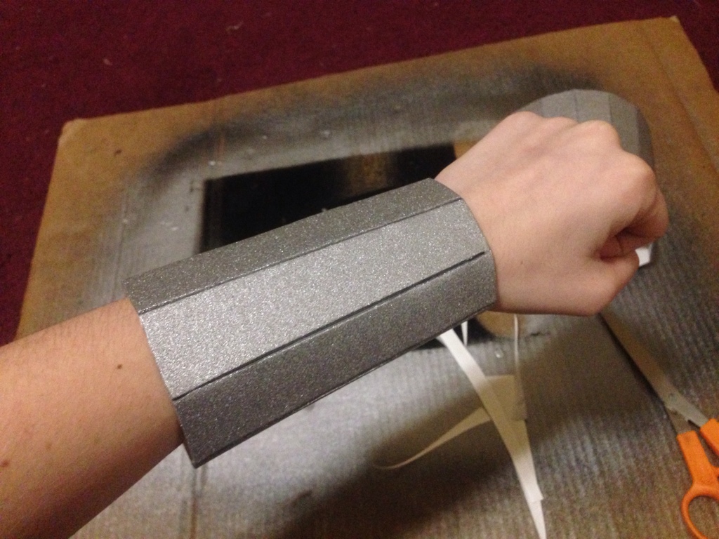

Just thought that I would add in what I ended up doing for mine!
Just some craft foam glued on top of card stock, then spray painted in a metallic silver :) Right now it opens on one seem with an overlap to I just tape them shut with double sided tape.
