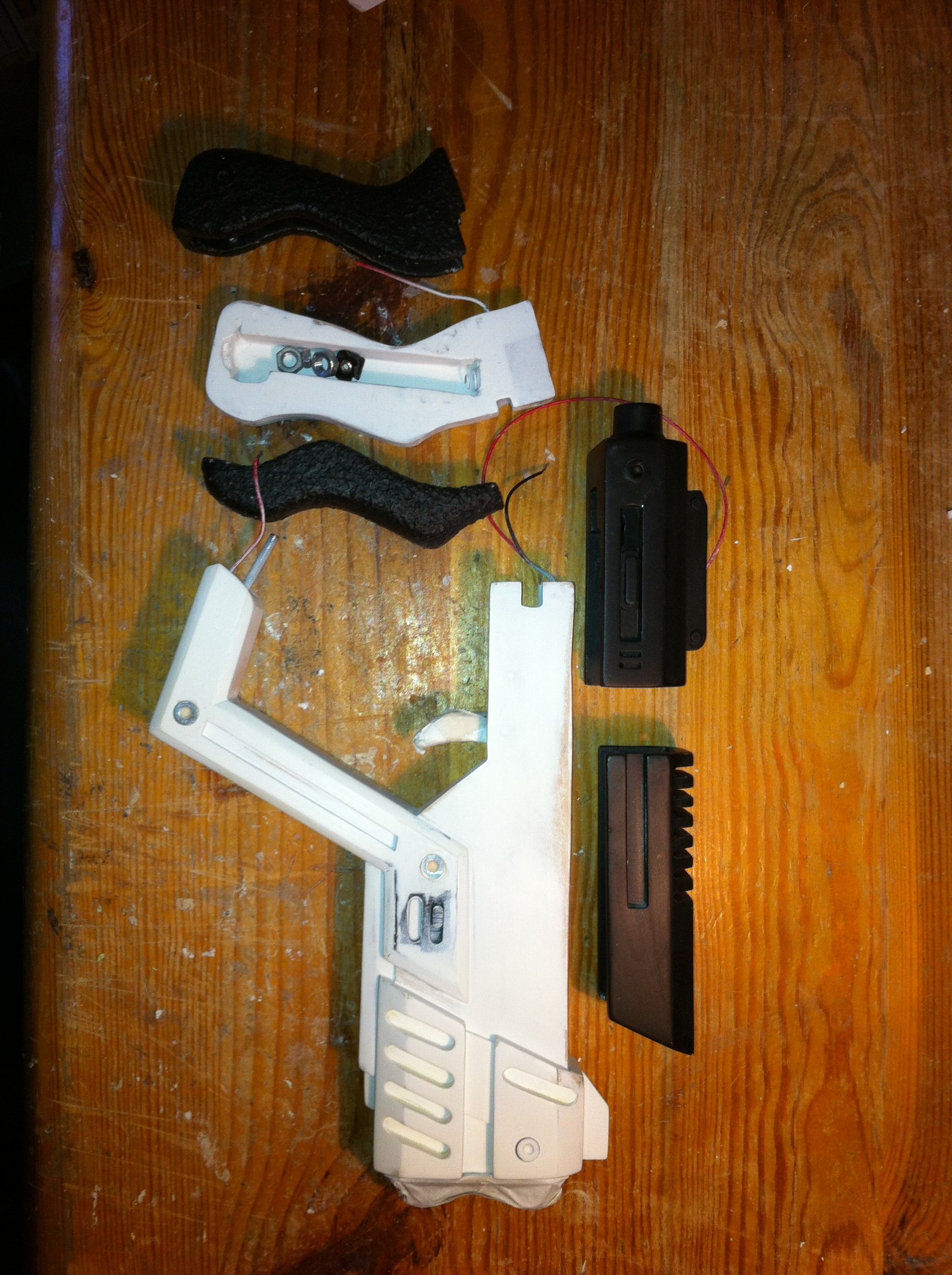

The piece is made of MDF and styrene, and features a working trigger, “safety” indicator light when turned on (the switch under “Lock”), and muzzle flash. The back of the grip is held in place with rare earth magnets and slides off to reveal the battery compartment.

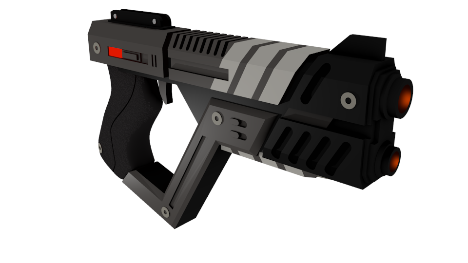

I’ve been into 3D modelling as a hobby for years, so my first step was to gather reference images and build a 3D model of the gun (I use Blender 3D). From this model, I generated blueprints and set to work building the piece. I built the gun as separate components which attached to a layered MDF core that houses the spring mechanism for the trigger, as well as the wiring. For inset areas, I cut out the MDF and glued in a piece of thinner styrene. Most of the piece was cut with a handsaw, and any holes (such as the “heat vents”) were drilled in. I spent lots of time cleaning and filling any mistakes I made while cutting.

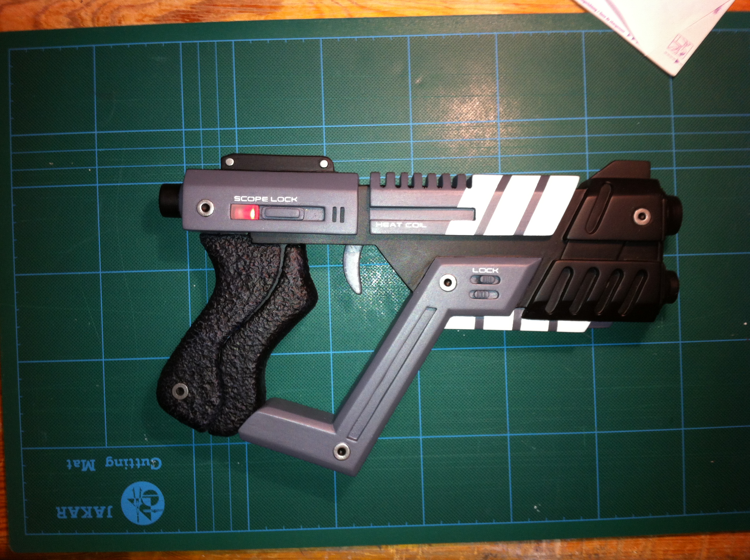

I invested in a Dremel half-way through the project which made the shaping of the grip much easier. Once I was pleased with its shape, I sprayed it with Rustoleum Stone Textured Paint and undercoated it black. After lots of sanding and priming, the gun was assembled, undercoated and painted. Here it is prior to weathering:

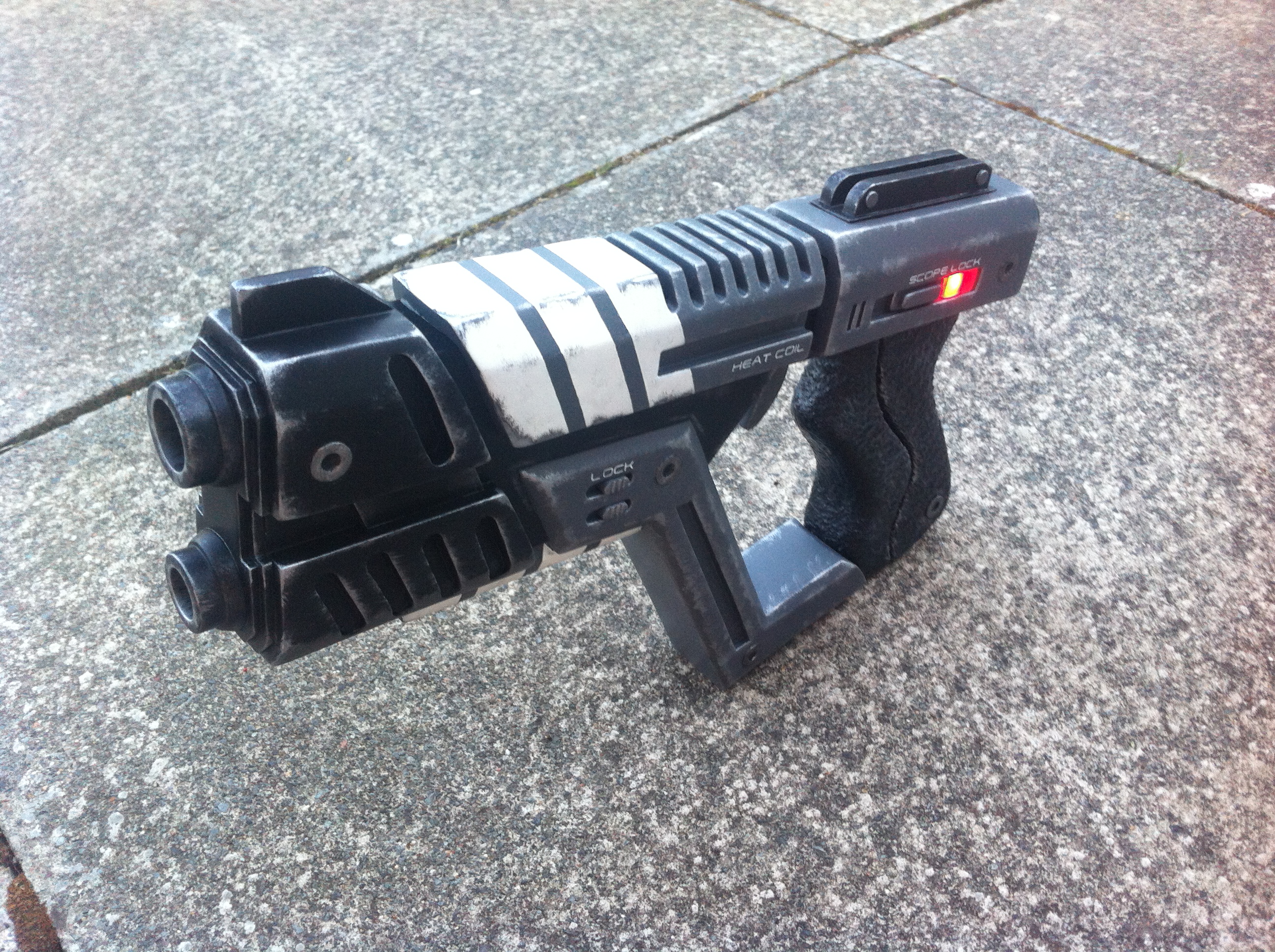

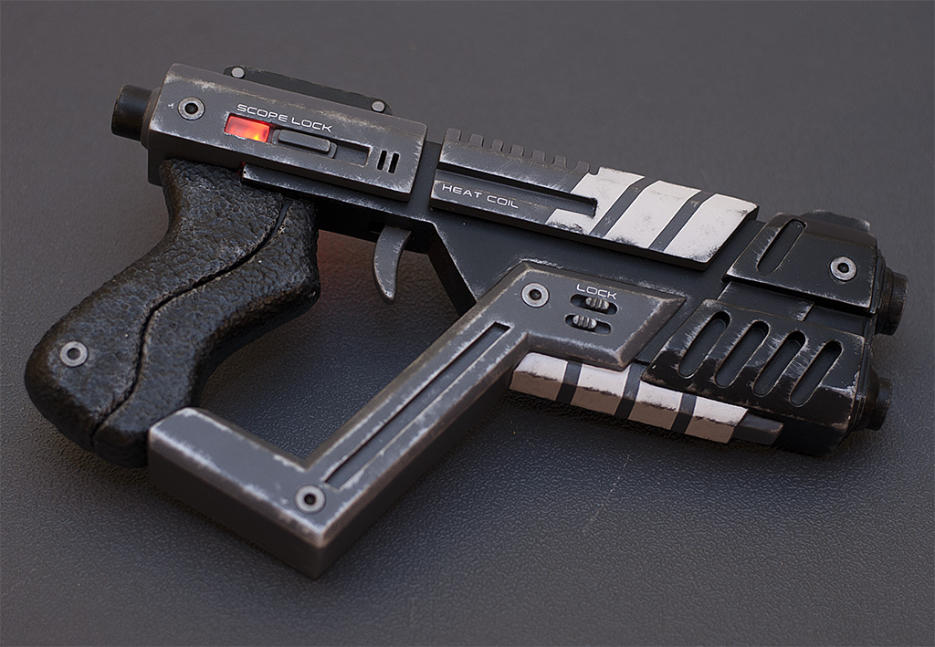

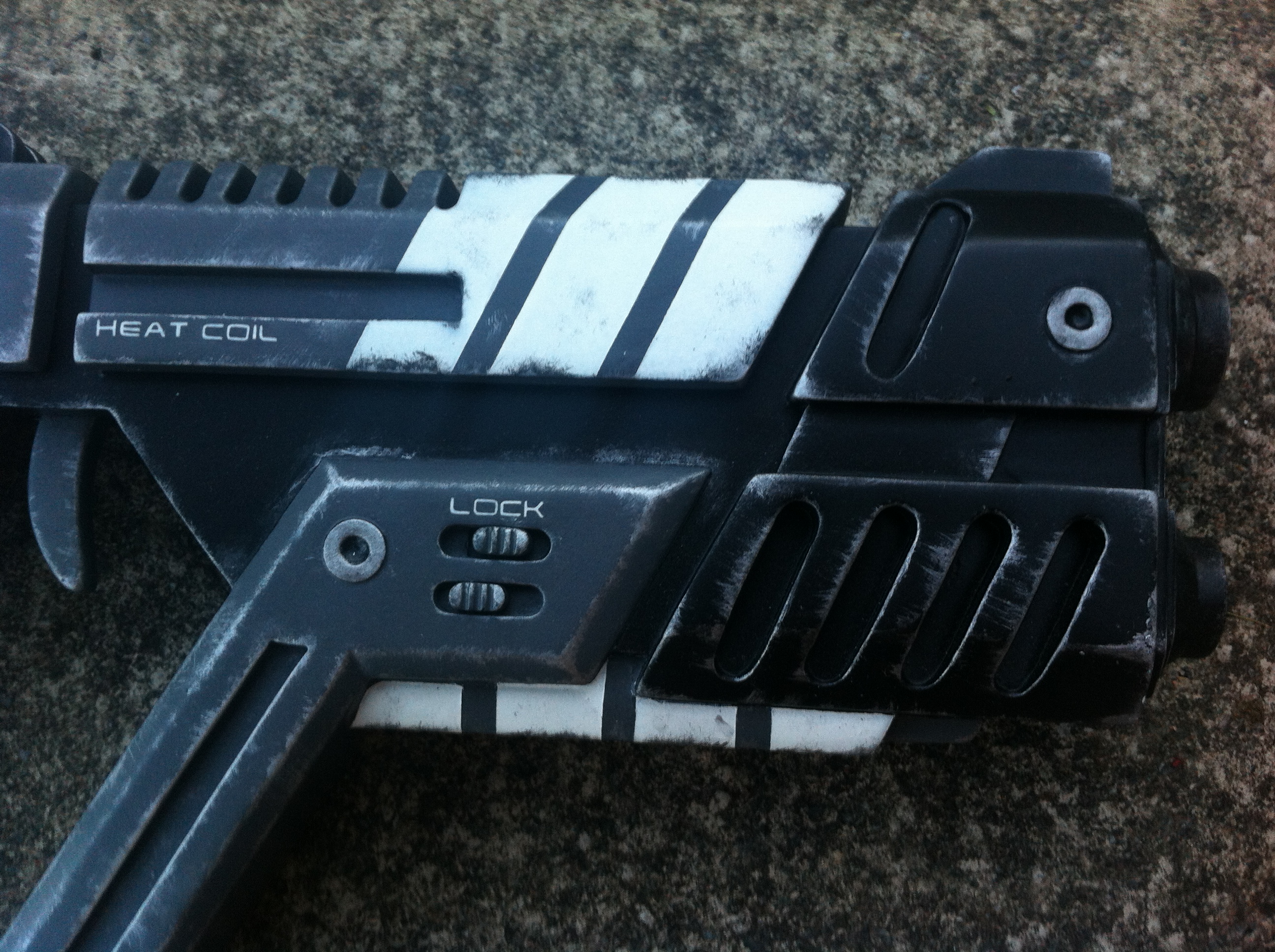

The finished piece:
