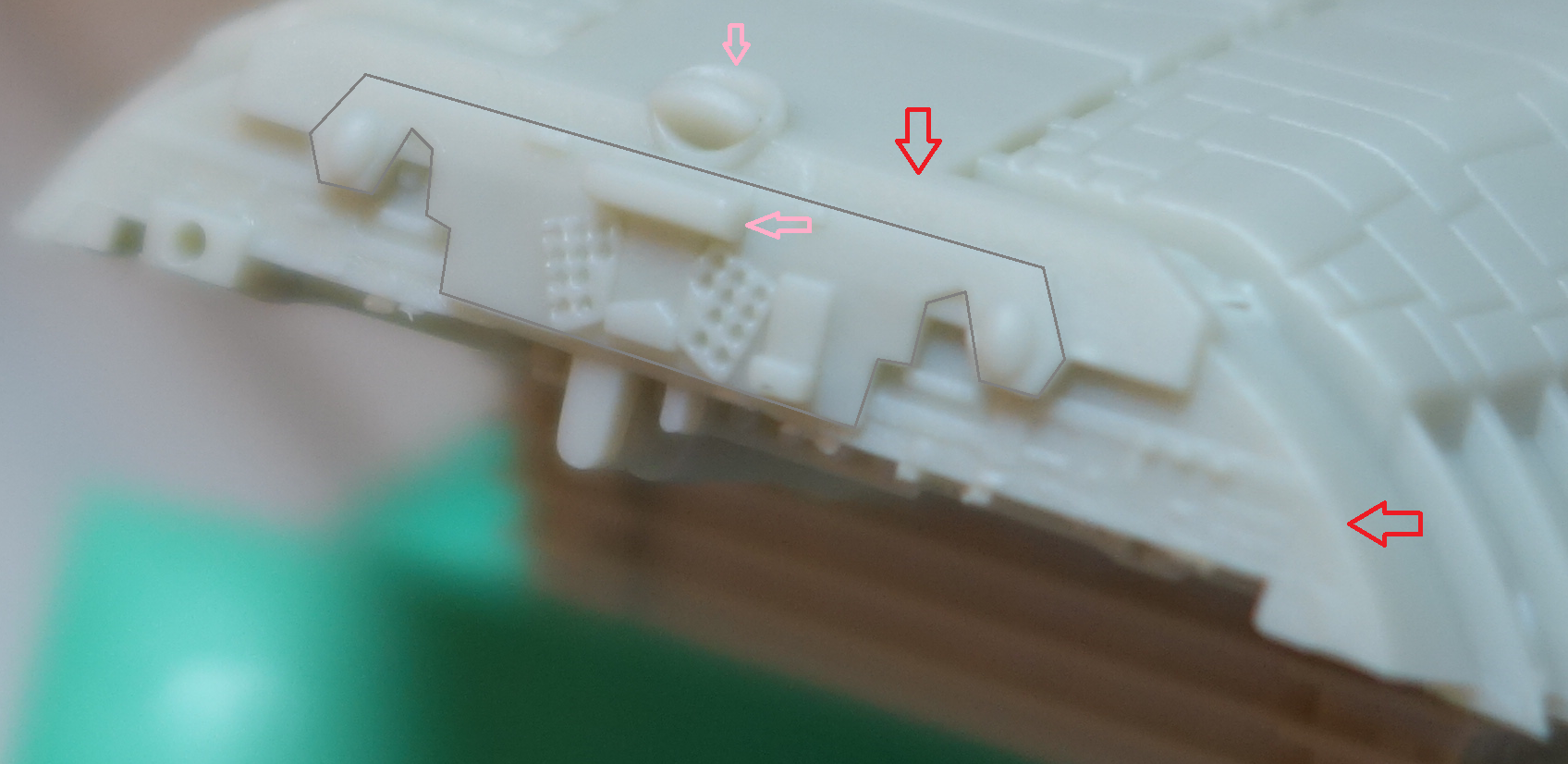

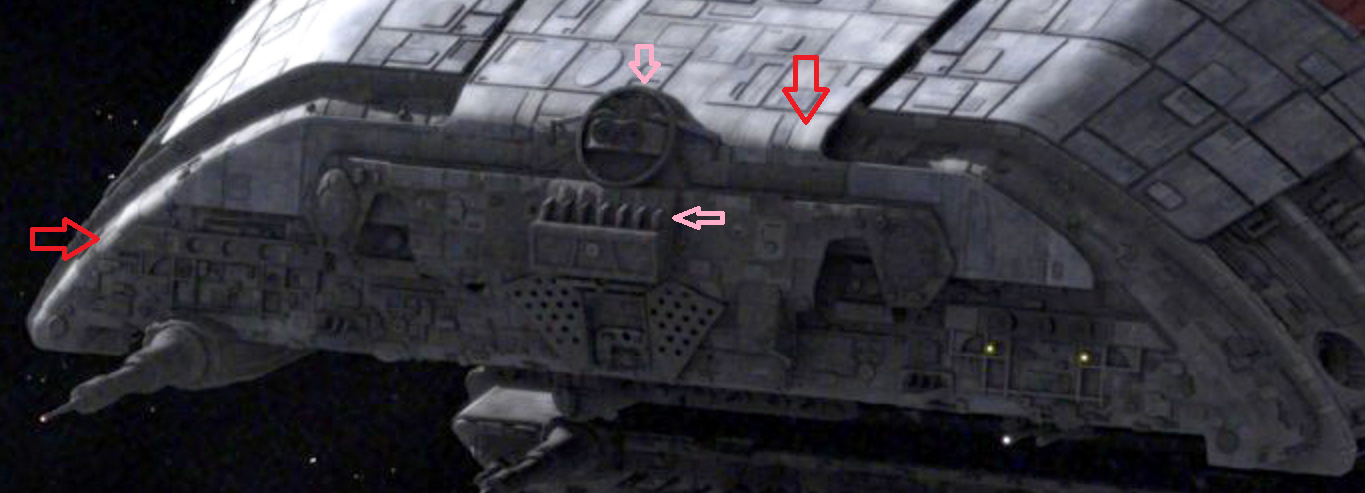

I started work on creating correct landing bay arms, the detail is more or less correct but it is too 2D for my tastes. I also noticed that the nose section is a bit off...
The overall detail needs to be a little bit sharper and look less molded, but the biggest problem is that the armor plate that curves from the top around to the front is wrong. To correct this I may have to move the whole nose a bit down to create the curve. Also the side hull after the last rib where it curves around to the front is too sharp.

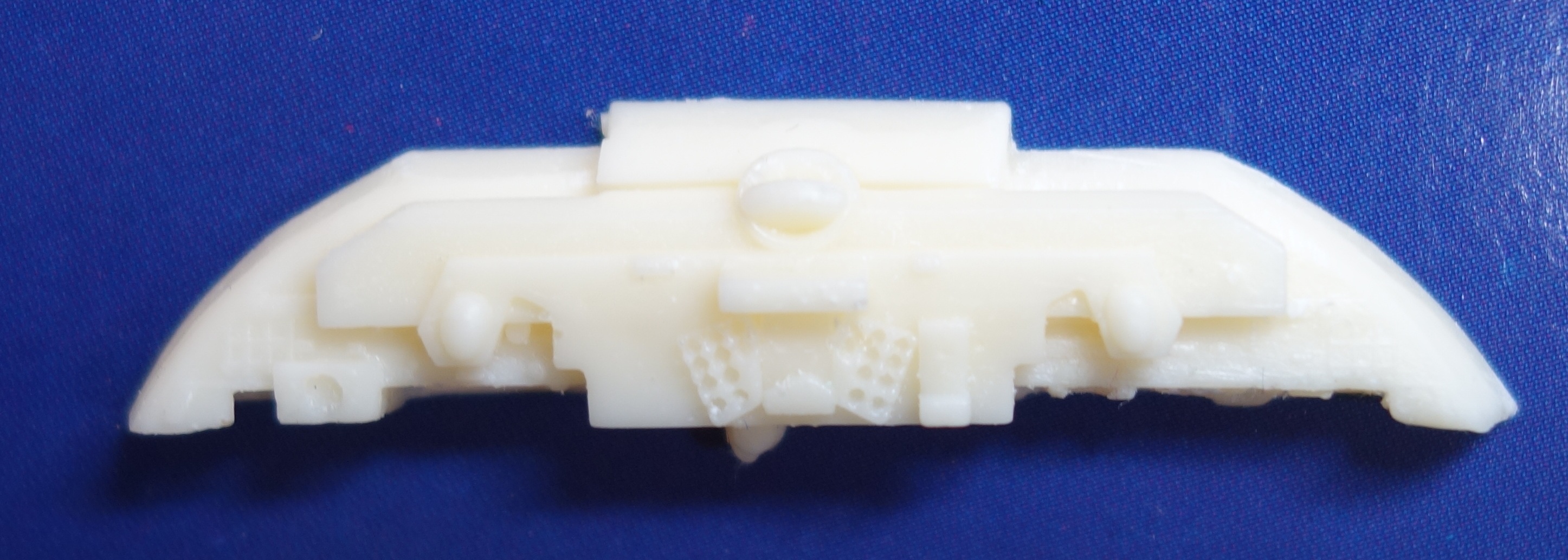

Update

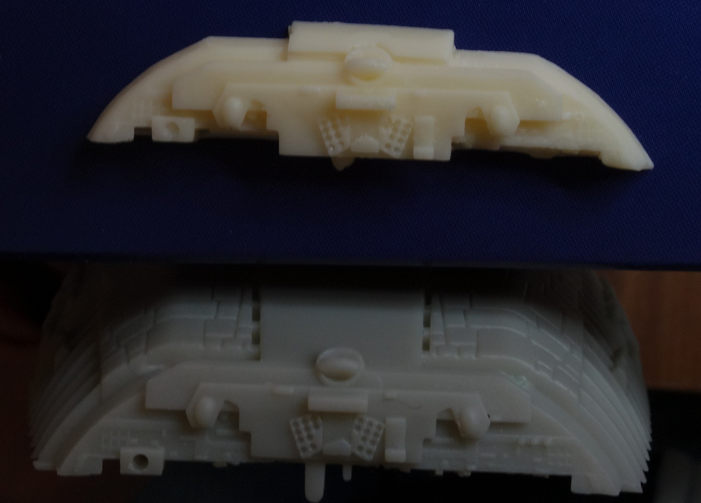

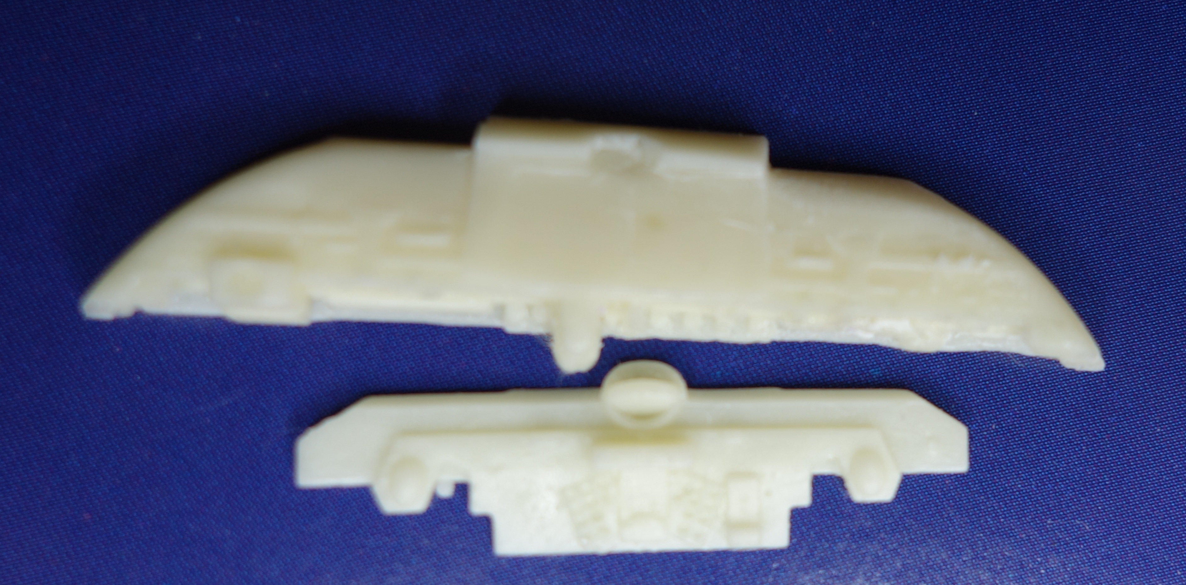

I have been working on correcting the nose section, after a couple tries, I now have a version that I like.
The smaller piece is now a couple centimeters lower than it was on the original kit. The sharp corners of the hull as well as the armor segment that are supposed to curve down have been corrected. Here it still looks a little rough but once it is mounted in its place on the kit, all the cracks and curvatures will be filled and sanded to provide the look that will be very similar to the screen version.
The detail will also be spruced up, the round thingy at the top will be replaced with a bit of brass tubing as well as the rectangular box below it is off from the screen version ie. too big and missing the fins at the top. All these things will also be done later, I have learned that doing too much of this fine detail stuff in the begining tends to make for double work as something is always breaking off.

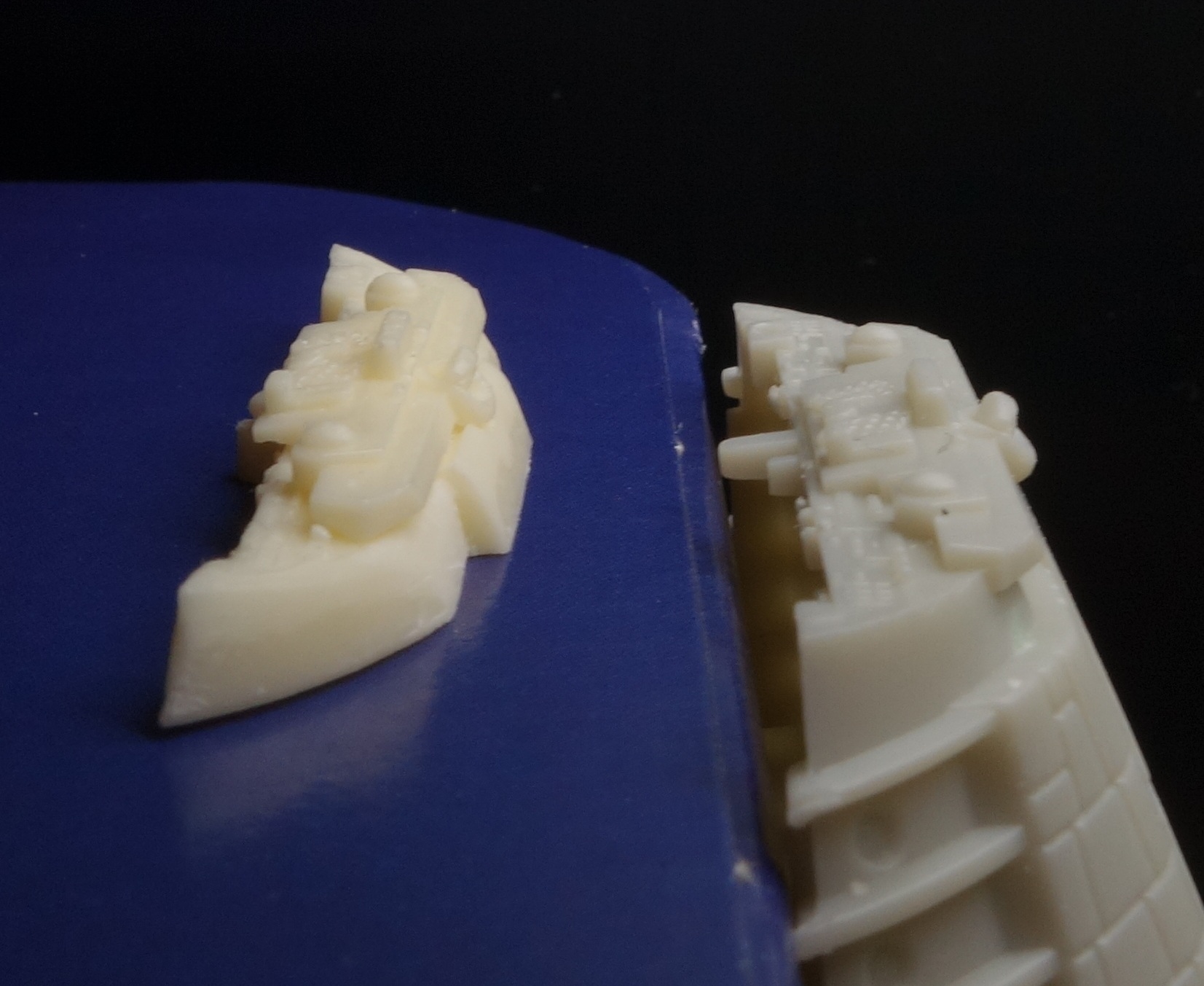

Here is a comparison to how it looks on the kit:

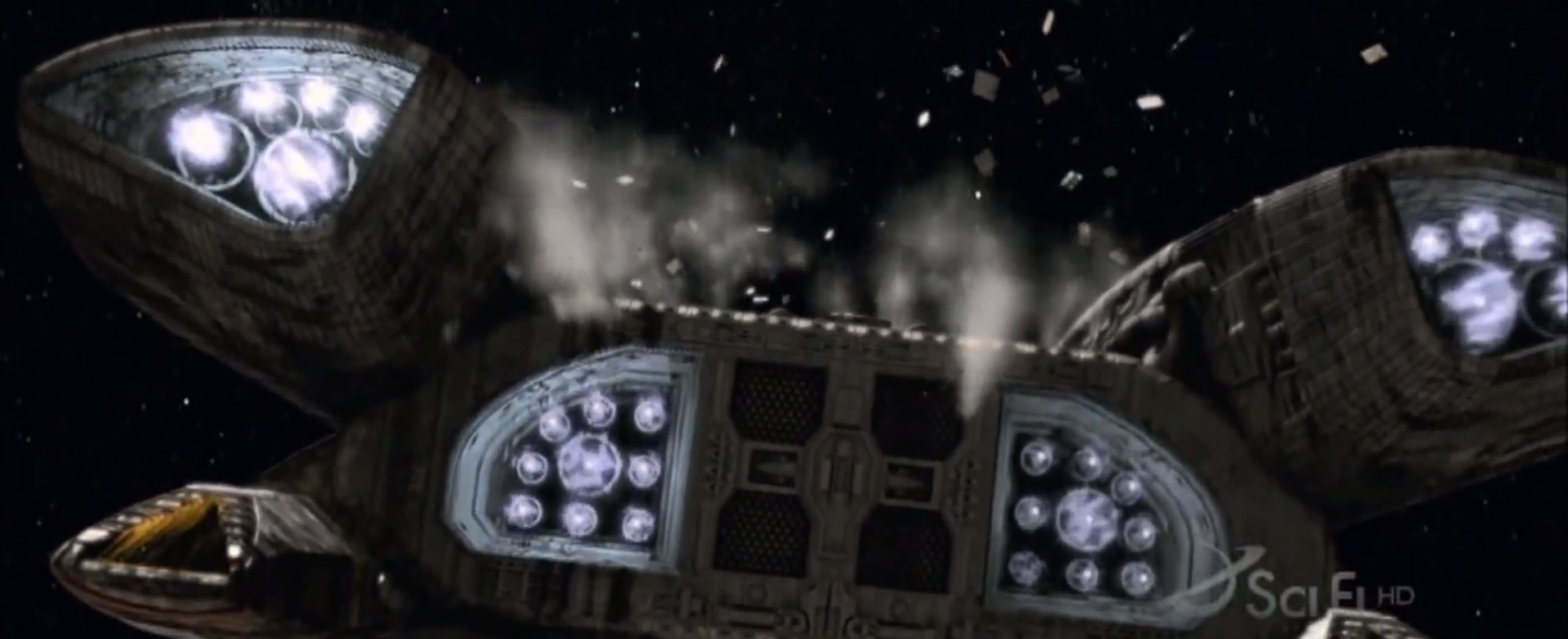

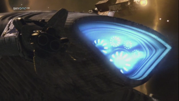

I found a nice engine shot after the Galactica breaks away from the colony ship (after ramming it). I haven't watched the episode yet but I belive the engines are supposed to be down and they are trying to start them. So I am not sure if this is just how it looks when the engines are not at full brightness.
I do like this look and it should not be too hard to rig up some LEDs to get a good simulation of it, lighted circles and all.
UPDATE: After further research I believe this engine configuration with multiple nozzles is seen exclusively in the Colony episodes, I am guessing they pimped up the engine CGI soley for these closeups. All previous shots are a singular engine nozzle as seen here in the Zoic picture:

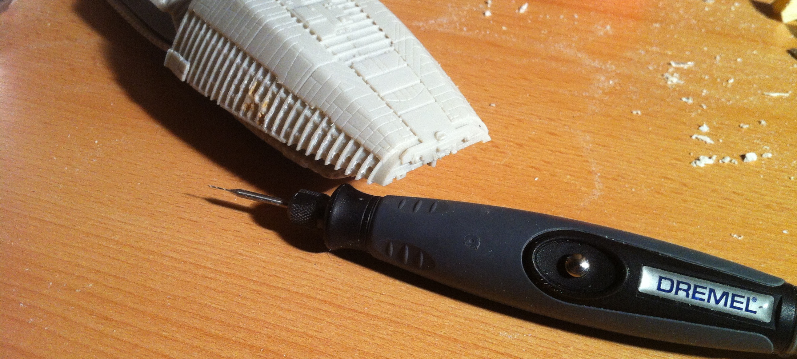

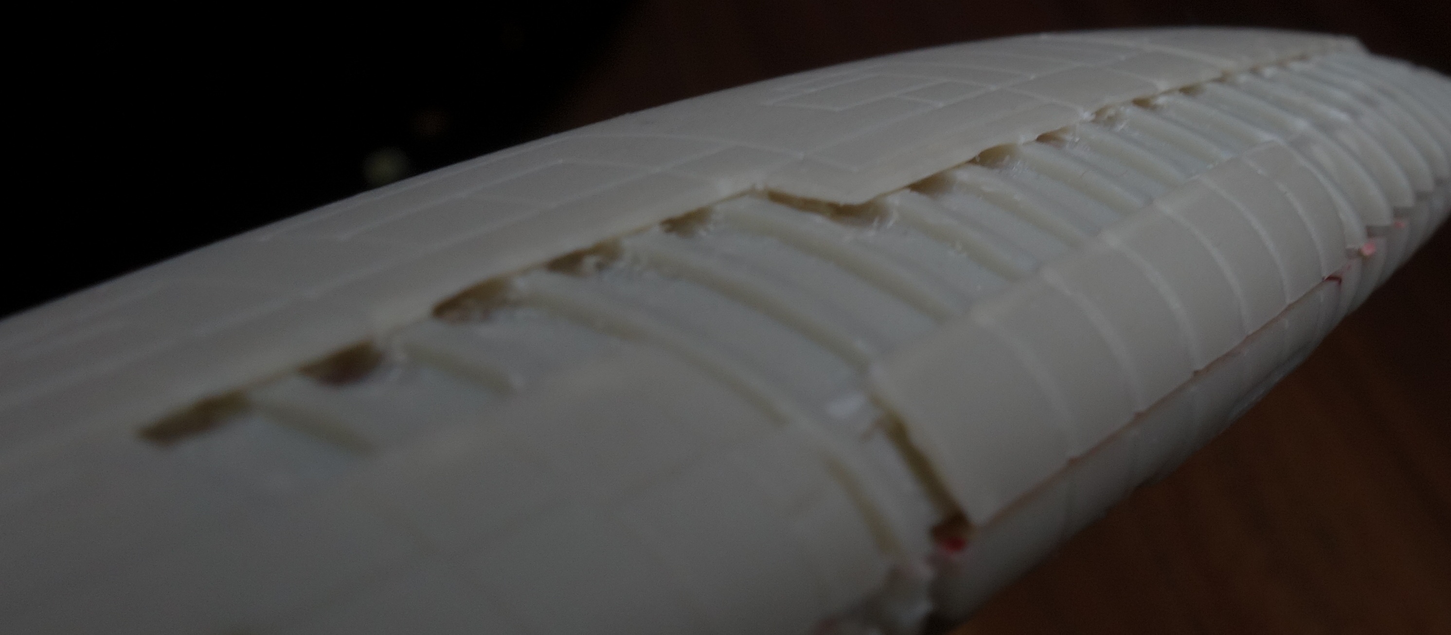

After a bit of trial and error, I found a method that works pretty good for hollowing out the armor plating. This pertains to the plating on the engine nacelles, but I am assuming at this point that this process will work on most or all other parts of the ship. The pictures below are before the Bondo clean-up, but none the less, you can see that the hollowing out turned out quite well.
  1. Using a small Dremel drill bit, go back and forth, covering the entire area that you want to hollow out. Don't drill holes or stay in one area longer than others otherwise the result will not be as smooth and the chances of breaking your drill bit is higher. I tried to go a little deeper as necessary in order make clean-up a little easier, but in areas like in the second picture above the angle just does not allow you enough space to go very deep (without damaging the armor plating on the other side of the opening).
  2. After I was done with the drill, the openings already looked fairly decent and a guy could stop here and consider it a job well done, but I wanted to clean it up further and make sure all edges are sharp and straight. For this I took a chisel exacto blade and cut it so that it would fit between the ribs. after that it was a relative easy process to chisel away at everything that did not belong. Here you will also need a pointed tip exacto blade to cap the trimmings as far back as you can get them, so it is best to have two exactos to avoide switching blades every 10 seconds. [UPDATE: Instead of using the chisel exacto blade I am using a chisel from Micro Tools (see my post below), this works MUCH better and MUCH cleaner.]
  3. Next, I wanted to further enhance the illusion that the armor is a separate unit. Using the chisel exacto blade again, I made a cut exactly where the armor meets the rib with as flat an angle as I could manage and then cut again at about a 45° angle until a sliver of plastic could be removed.
  4. I found out too late, it is better to drill away somewhat less than necessary on the inner hull and use the chisel exacto blade to get a clean removal of the rest. The last clean-up step is to Bondo in any areas that were cut too deeply and to create a smooth hull surface. To apply and work the Bondo I took a wooden mixing stick and cut it to fit between the ribs and sanded it to a flat wedge.

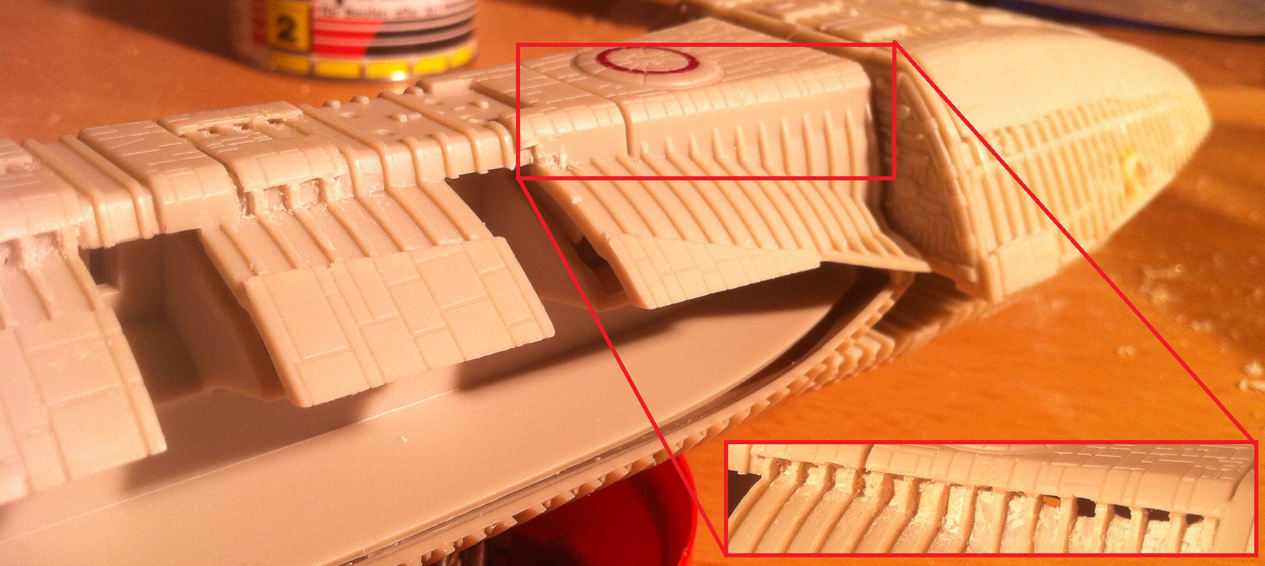

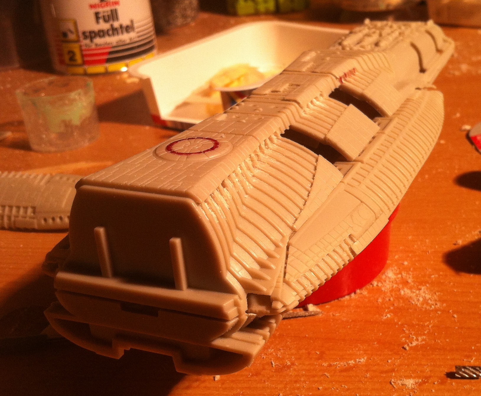

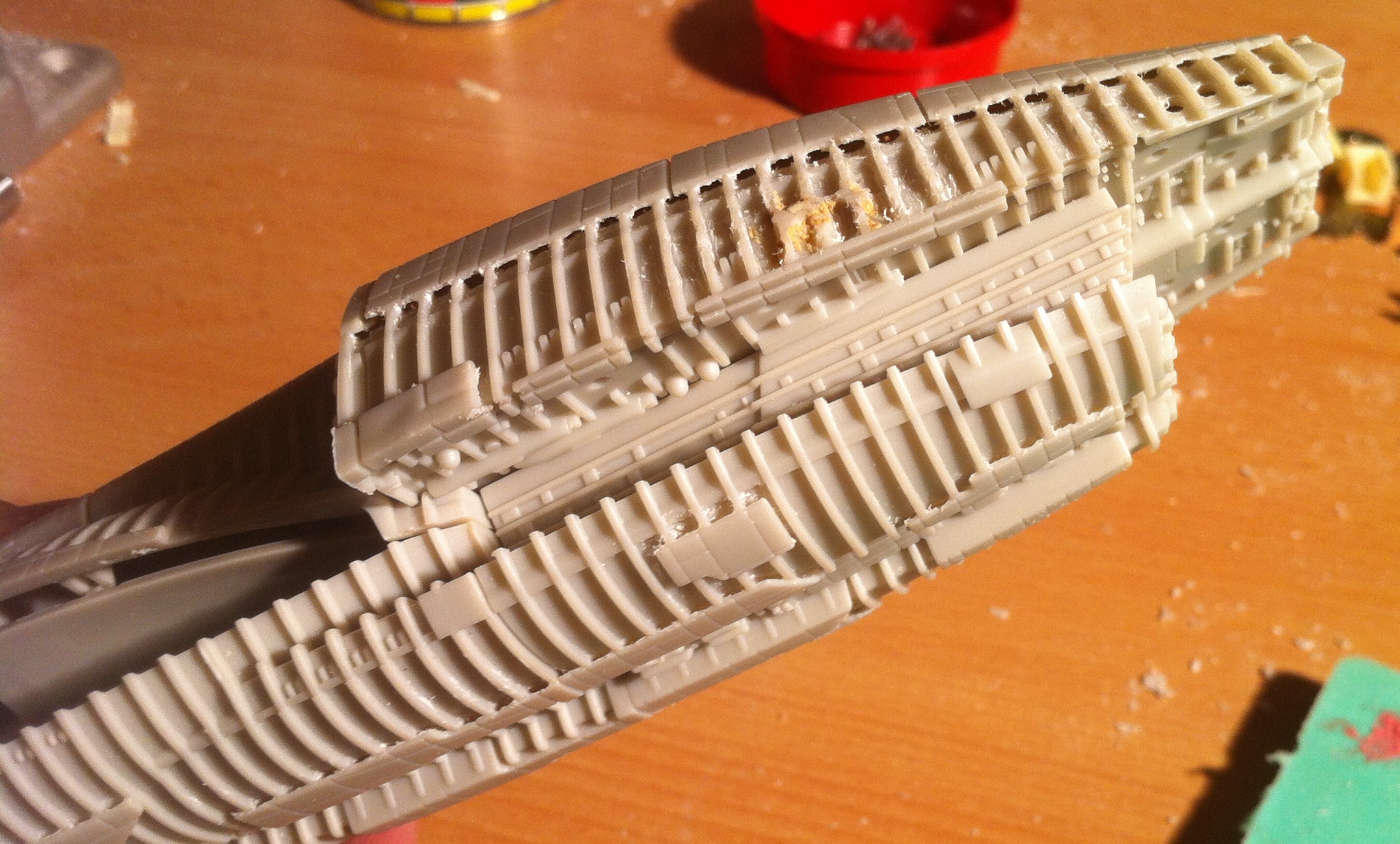

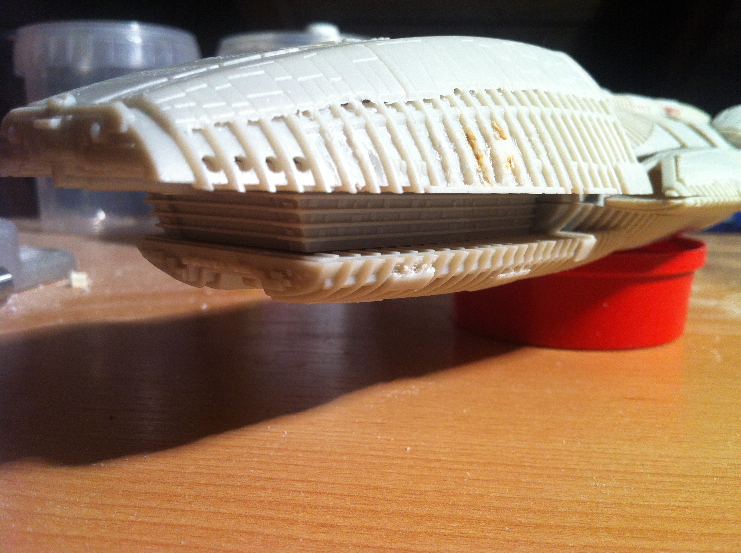

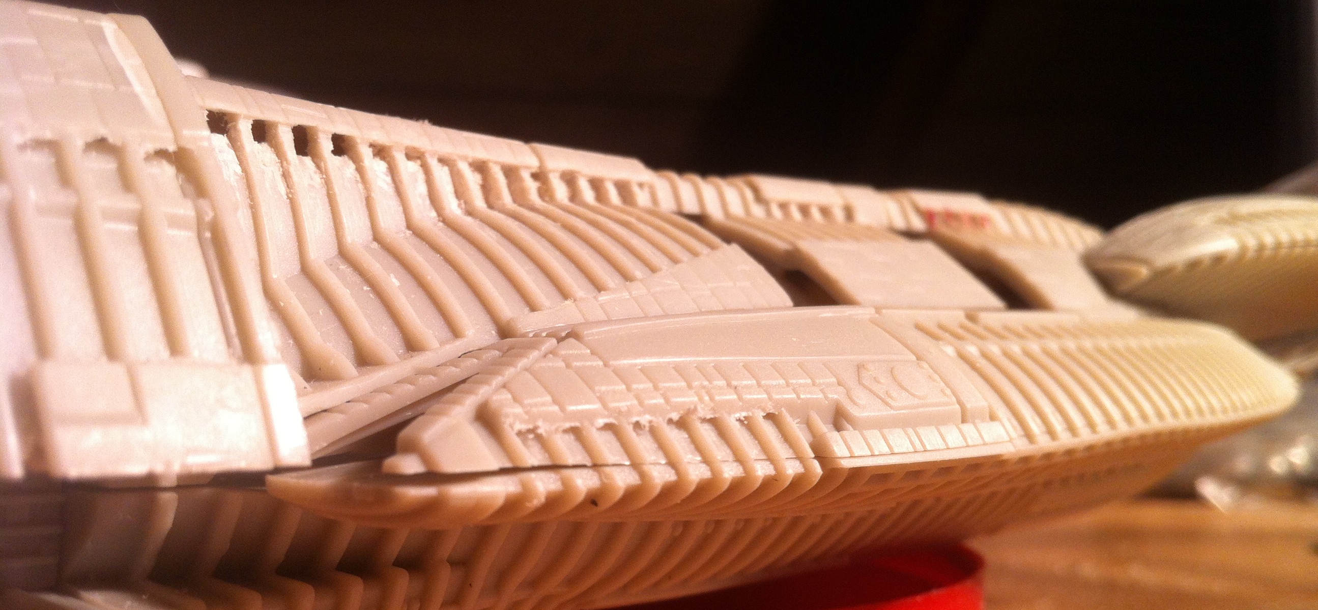

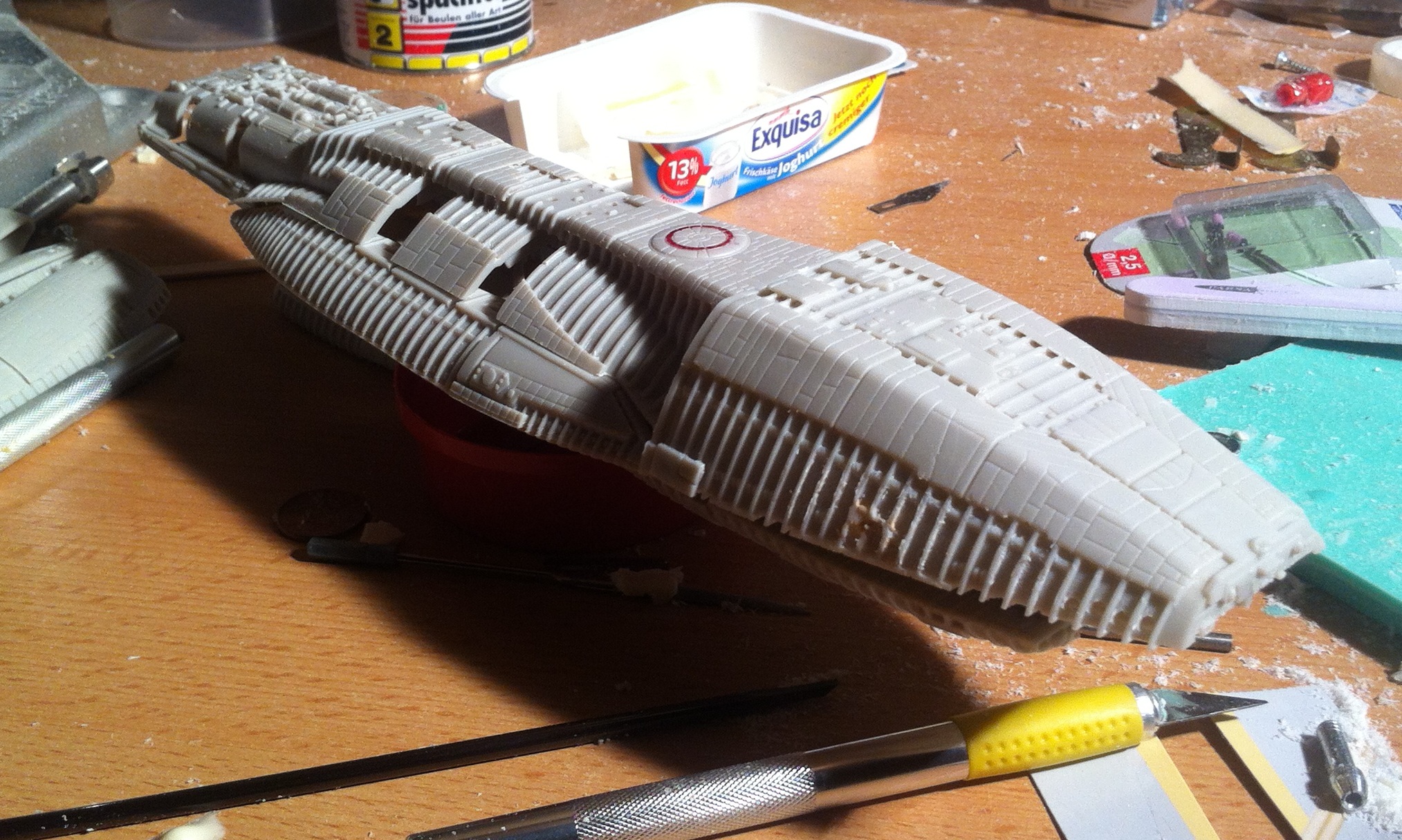

Ok, I am almost done with hollowing out under the armor plating. Had I known how much work this was going to be, I am not quite sure if I would have started this or not. :)
I still need to do a lot of cleaning up but here are a couple shots of the work that has been done so far...

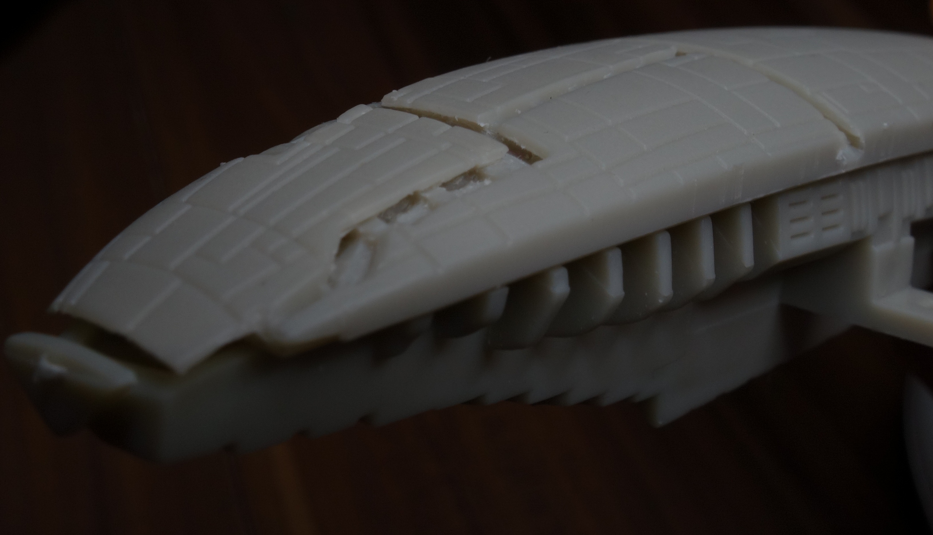

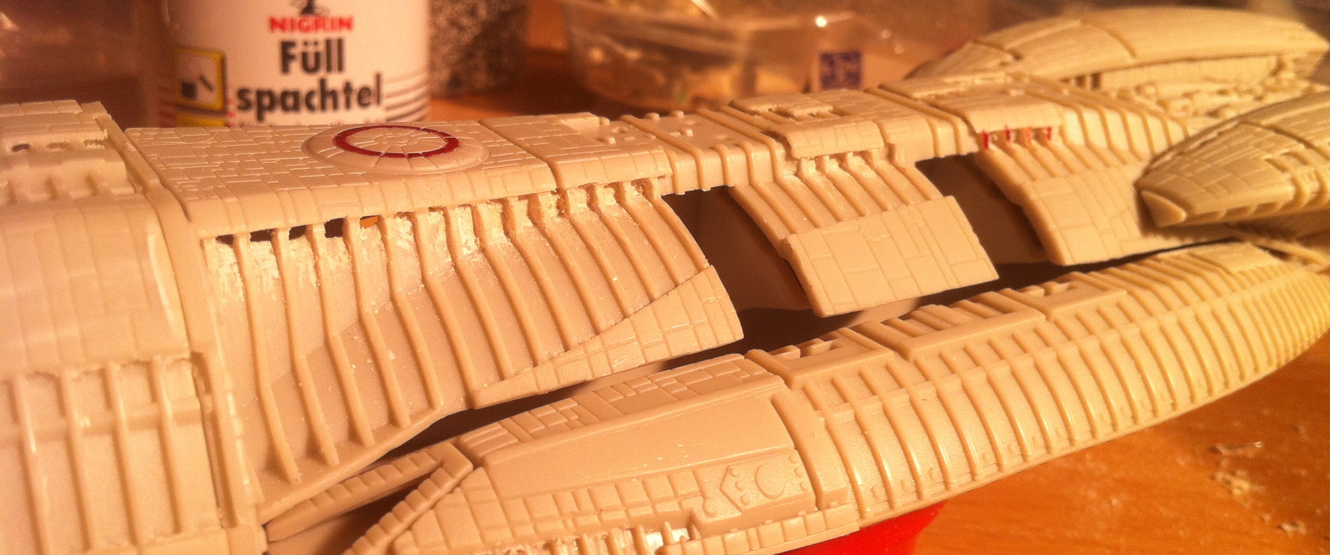

I think the hardest part was carving out between the ribs on the neck....

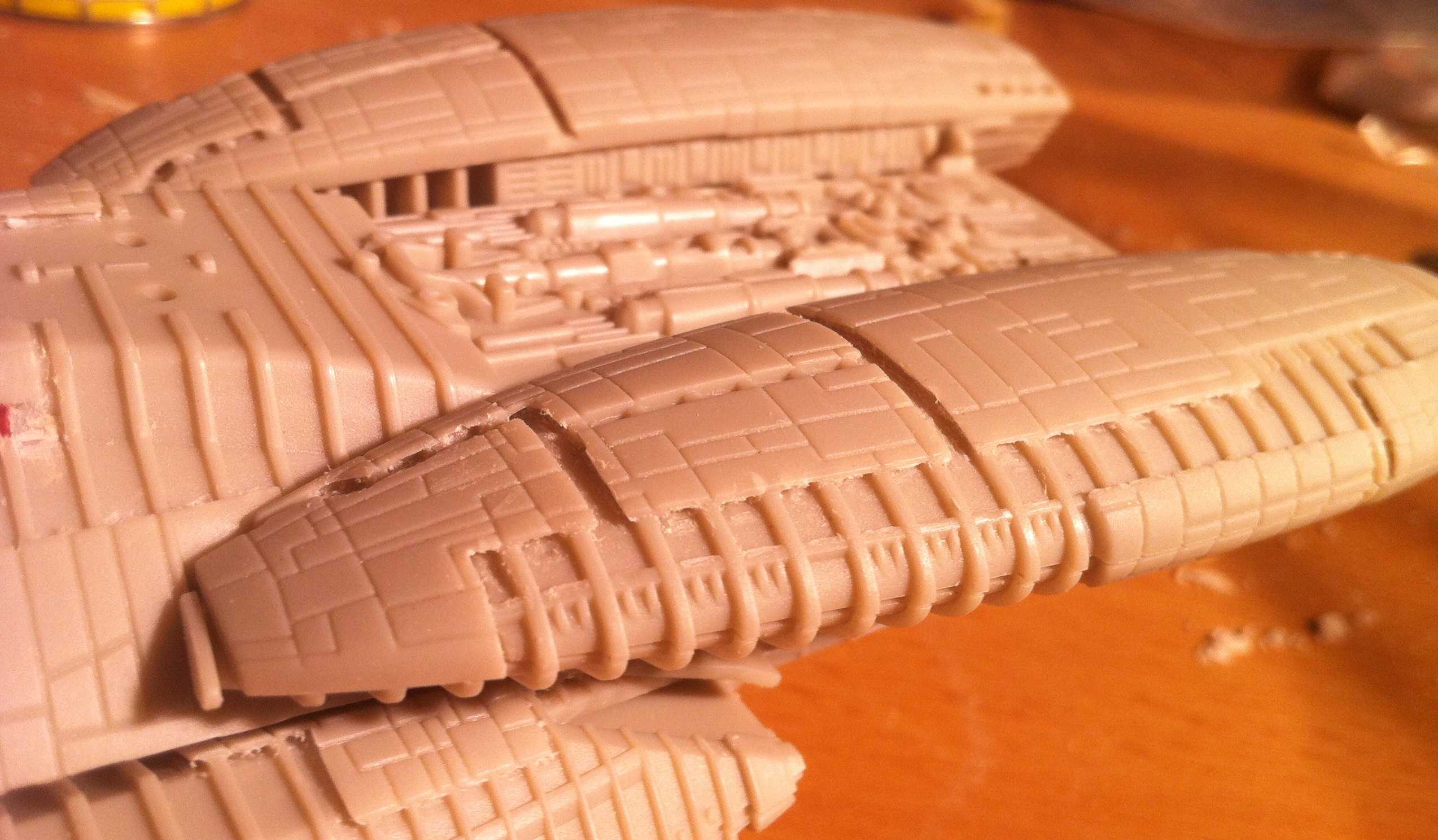

Here is another shot of both upper engine pods...

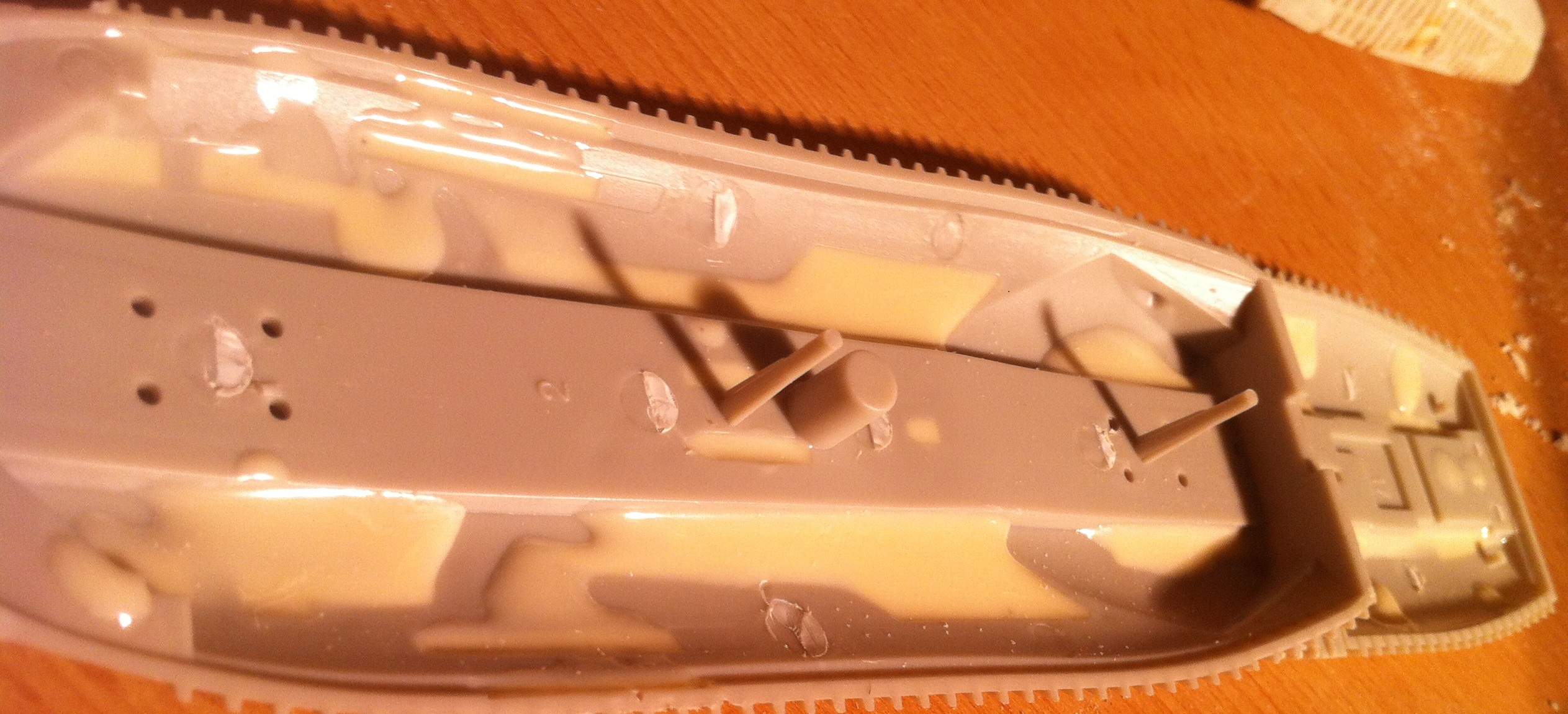

In quite a few places, carving out the armor plates would weaken the structural integrity. To aviod breaking a piece in two, I filled many of the parts with resin to add stability...
All of the hollowing out was done with a 0.5mm drill bit and steady nerves. :) For those of you who do not know, that is the extension attachment for Dremel. I can really really really recommend it to anyone who has or wants to work with a Dremel (or an other brand equivilant). It is light, it allows you to get a shallow angle and just makes life so much more easier.

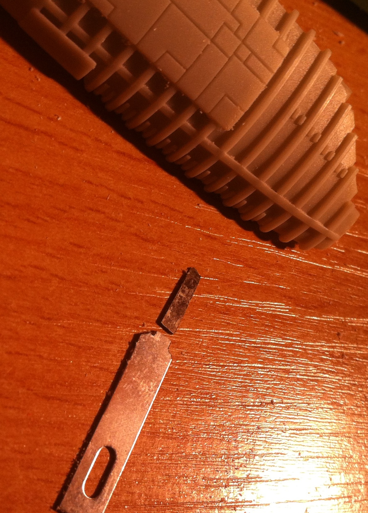

To clean up between the ribs after drilling them out, I cut a flat exacto blade so that it was just wide enough to fit between the ribs. This was working very well until it broke.
Well that is all for now, I still have a couple armor plates to do and of course the right side of the neck needs to be carved out (as soon as I get around to fashioning a new exacto blade to replace the one that broke), but all in all, the worst is done with. The next steps will be to get a lighting plan done and code a micro-controller to do everything that I want to be done. I haven't made it back state-side yet, so I am still missing the photo-etch and decals, so I am in no hurry to get too far.
Thanks for tuning in.

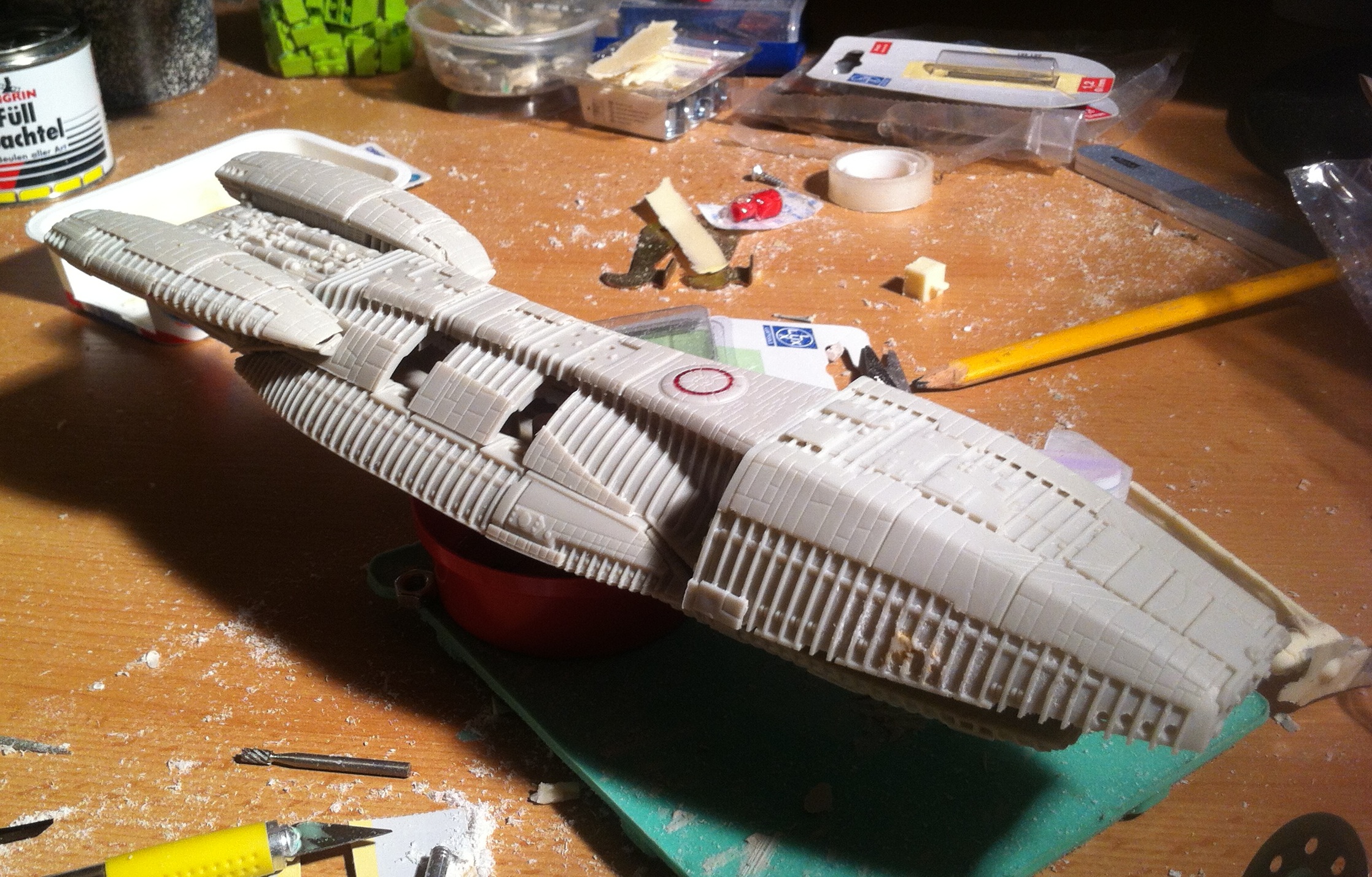

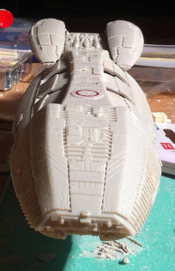

Believe it or not, I finally got all the armor plating hollowed out. I broke a total of 12 drill bits getting it done but she is looking so much more realistic, it was worth every cent.
More out of curiosity as anything else, I bought a micro chisel recently, which turned out to be a hole in one. It is just a bit smaller than the space between the ribs and sharp as heck. I works beautiful for cleaning up the cut under the armor as well as getting rid of the rounded corners. It is the F2 from Master Tools and I bought it for about 6 Euros. I believe there is another company called Micro Tools out there that makes an even better version, but I could not find it here in europe.

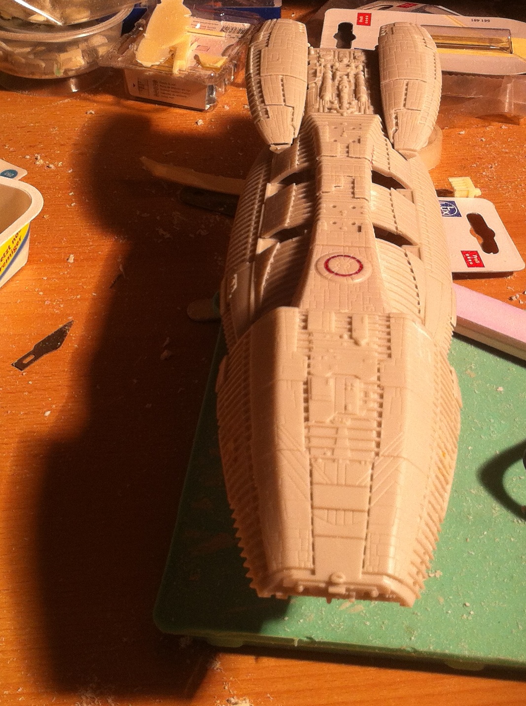

I was also able to sand out the landing bay alcoves so that the bays can actually fit inside the hull. Here are some more pics:
