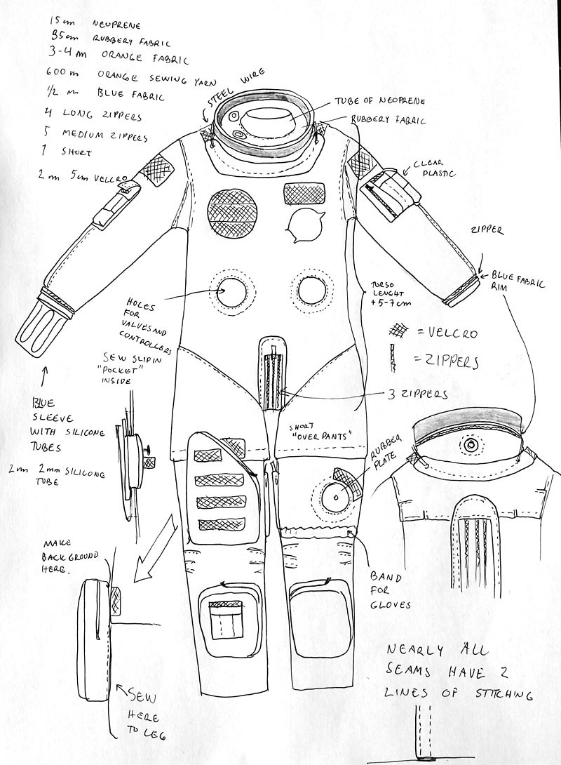

These line drawings should have all major parts and seams visible.

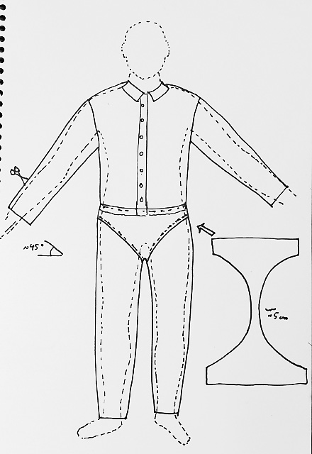

You can make basic pattern from oversized pants and shirt + piece of fabric. More detailed instructions in my blog.
