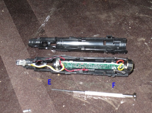

E&F) Pop open the black plastic case to gently remove the electronics (remove tape at E & pop open clip at F). Don't loose springs at F.
