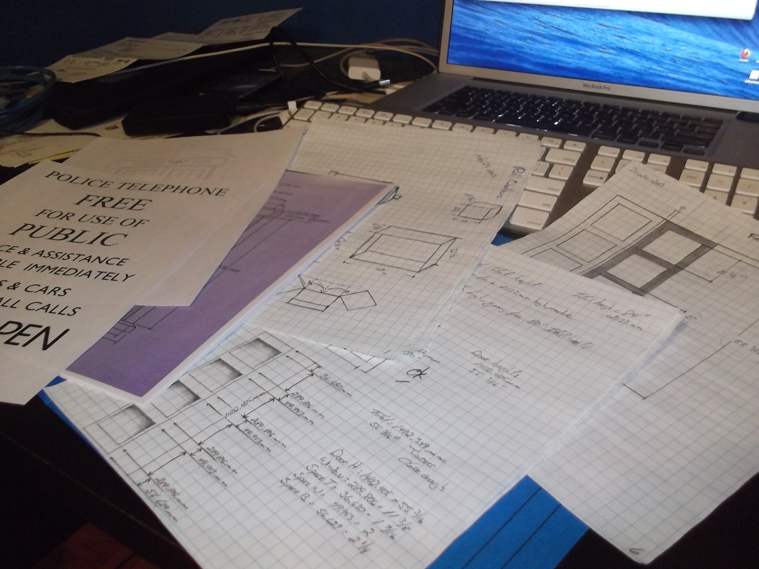

I've included some rough (really rough) sketches and basic math formulas in what one would call "bad hand writing". So far I've got the
dimensions of the two front doors & windows. Not much to see, but I've got about 7 pages of math and little drawings. Didn't see the point
of picturing it all.
It's a start right?
Cheers.

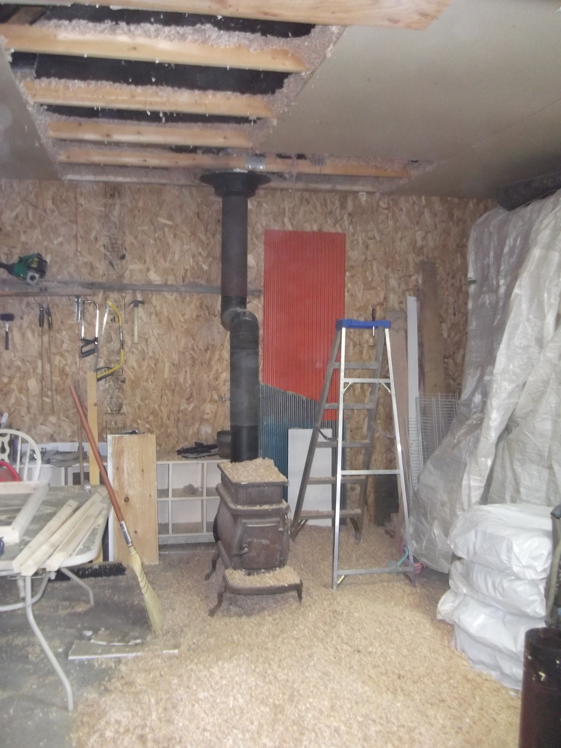

I've hit a snag in the garage. Figured I'd get setup for some heating. So I checked to make sure everything is safe for me to use the wood stove. Well apparently the previous owner decided to be cheap and used wood chips to insulate the garage. Just happy the city inspector didn't go in my garage...
So I need to get that fixed.
At least I got my base assembled and I started the sanding. Had to use a bit of plastic wood... wondering if I should just redo. Happy with the result so far, but should I push my luck and try to make a better one.
Well wish me luck. Shouldn't take too long to fix the ceiling. Than again, I still have to paint my wife's office (I hate painting).

Well another quick update. Had 3 days off, which gave me enough time to get things settled in the garage (I've got heating!).
The good news, the ceiling is properly insulated and I now have a good table for my saw. Bad news is, I'll have to redo my base.

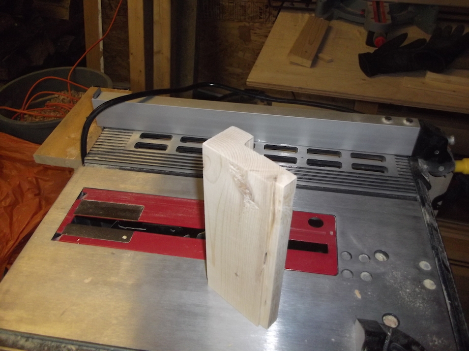

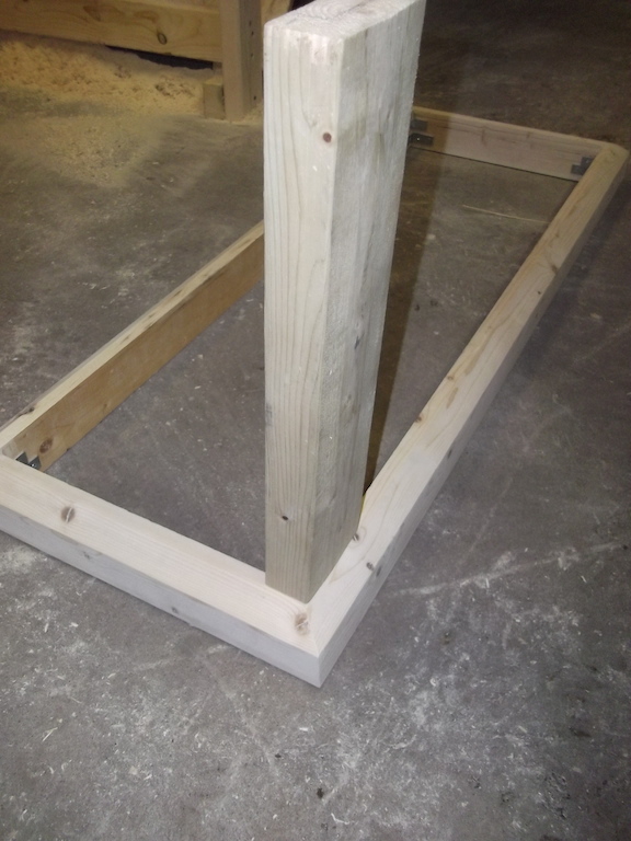

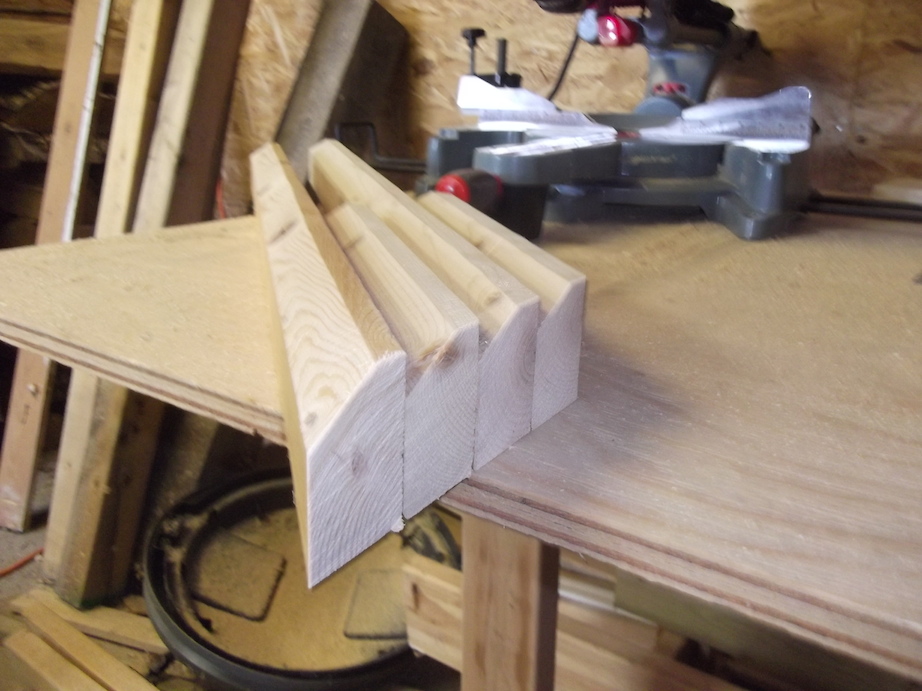

So yesterday I started a corner post. First thing I did, which will now be my ritual before doing anything, was a rough cut template.
From the dimensions, the corners would need to be 3 1/4" on the long side and 1 1/2 on the short one (it's rectangle not square).
After a bit of thinking and looking closely at the piece I intended to use I came up with this:
Doing the template also helps on how to get the proper cuts...

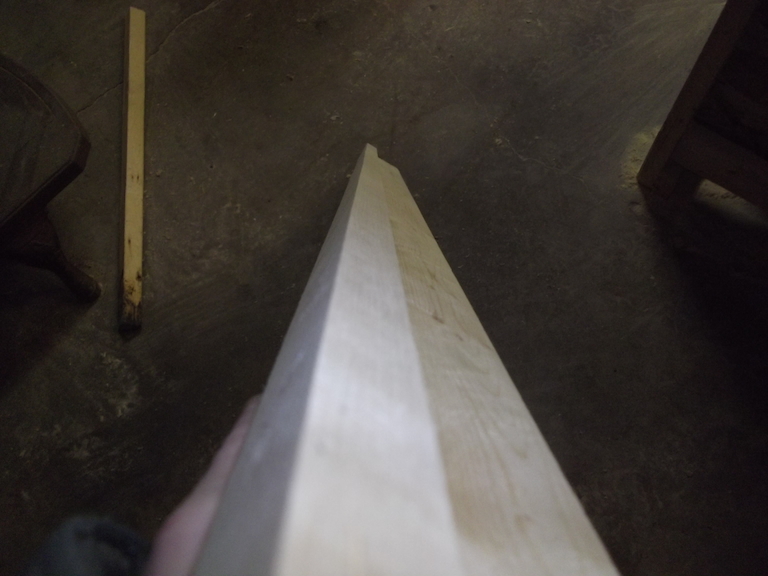

It's a 2"x6" cut down to size, not bad me figures. Taking it slower, I figured I could do all the corner posts this way.
So I took a full length 8' piece nicer 2"x6", planned and cut to my desired dimensions (3 1/4" & 1 1/2"). Was rather proud of myself,
seeing this is the first time I've ever done this kind of work.

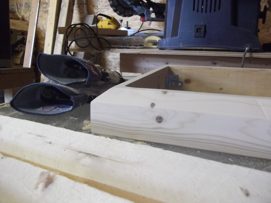

And now the moment the bad news struck. I couldn't figure out how to attach this properly to my base. I had factored in an extra 2" in
the post's total length to screw in the base. But it's so thin there wouldn't be strong enough, there's just not enough material...

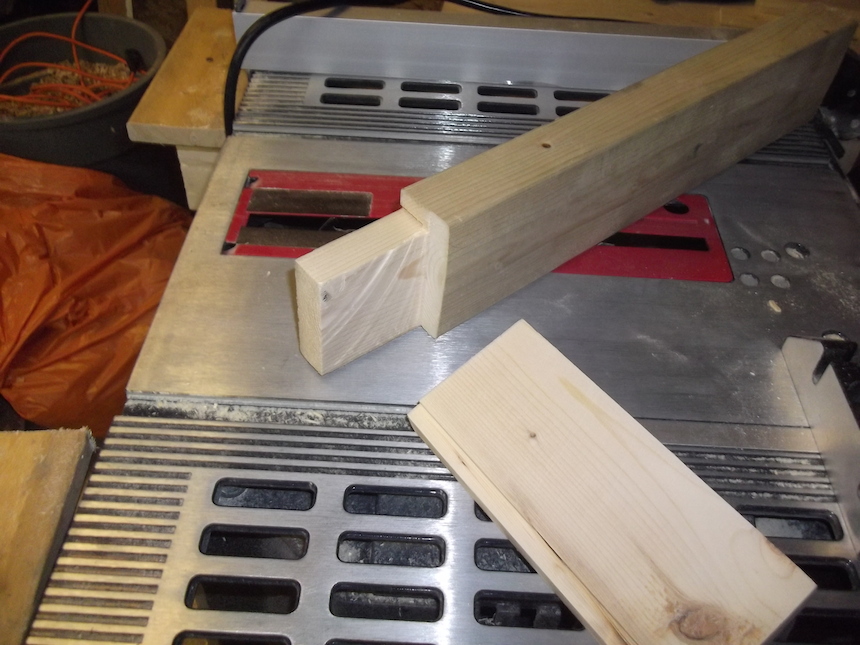

Walked over to my neighbor's for some help and advice (A very nice man I must add). Showed him what I had done so far, explained
what it needed to be and do etc.
And after a few hits and misses he came up with a simple 2"x4" cut with a lip to it fits over my base.
And placed on the base:
Which is pretty much what I need\want..
The down side, the added material left for strength reduces my shelf depth from 11 3/8" to just over 10 inches. Not much considering
it won't be a big bookcase to begin with. My neighbor suggested I redo the base, "You can use the base you have, but if you want to
do it right redo the sides. Making furniture is not easy..." Words of wisdom.

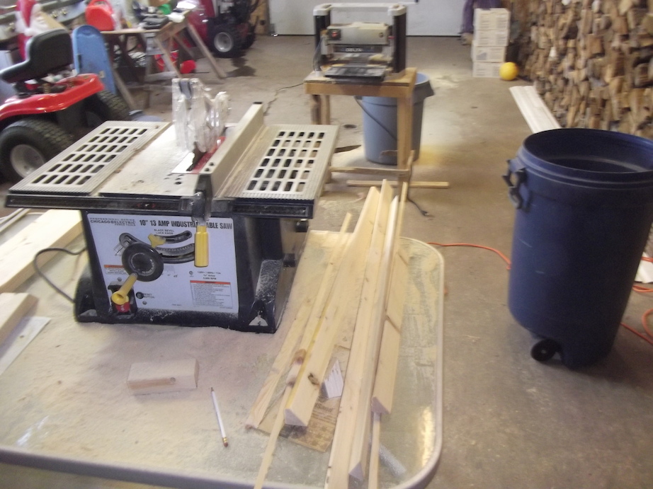

The lessons learned however made up for the disappointment in having to back track. I gained experience with the table saw (or bench saw).
Neighbor showed me some neat little tricks, seeing I don't have a dado blade. And I got a better understanding of the overall project, giving
me hope I can do this.
Another good side effect, with the sides being a bit longer, the detailing will be more visible.
I've discovered, using the scaled down dimensions I'll be losing lots of little details (like that trim\cut down the sides posts). So since this
is not an accurate replica, I'll be exaggerating just enough to see them.

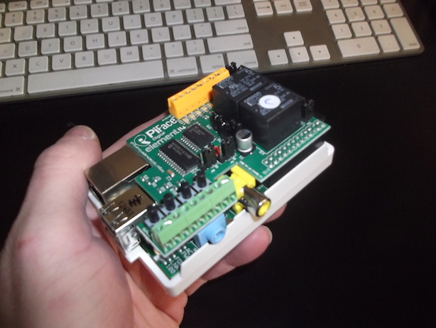

Finally received the stuff for my the sound\light control, it's called a PiFACE. A digital interface for the Raspberry Pi mini computer. It sits
right on top of the RPi, connects into the GPIO pins and comes equipped with 2 10A-250V AC relay switches. And since this is all tied into
the RPi, with a bit of Python coding getting some sound and a light (or series of LEDs, heck even a blender) to turn on on cue shouldn't be
difficult.
The PiFace is like 35$-ish... and comes assembled. Had I purchased the relays, a small bread board, wires to and from the RPi would've been
cheaper yes.. but for about 10$ more I'm saving on the hassle of assembly. And it all fits into a nice little package.

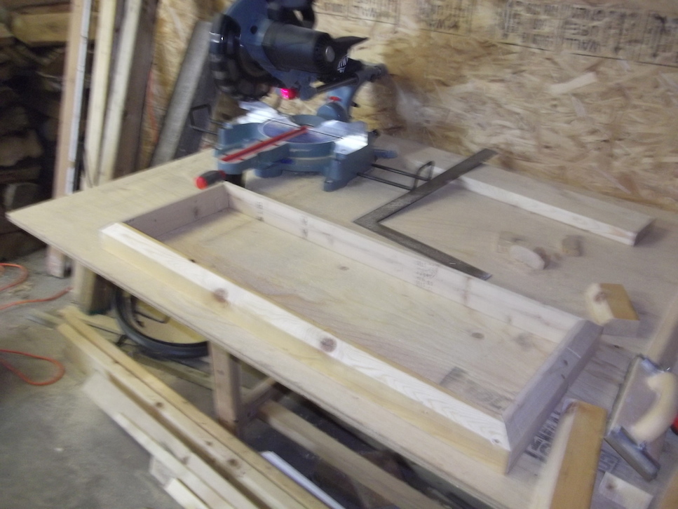

Been awhile, but with current work load, bad\extremely cold weather and of course the holiday season its been hard to get anything done on this project. It's not a race so I don't mind.
I have 3 of the 4 corner posts done. Sorry no pictures as it would be rather "boring". I took the time I wasn't able to heat the garage adequately to setup my RPi with the magnetic switch. I was surprised and a bit disappointed.. after an hour everything worked. I say this as I thought it would've taken me a bit more time to code everything. There is however much room for improvement. Still, the the switch is separated (door opening) my relay closes the circuit (nothing plugged in yet but there is a light showing it's closed) and a randomly chosen MP3 file plays. Door closes sound stops and of course the light "would" turn off. Funny...
Seeing that I started this thread, and don't want to leave it hanging for months on end, I thought it best to update it. A little progress, but why not. I've learned much and getting better with the tools (and heating my garage). The wife was nice enough to get me a clock :) Now I won't be late for work...
