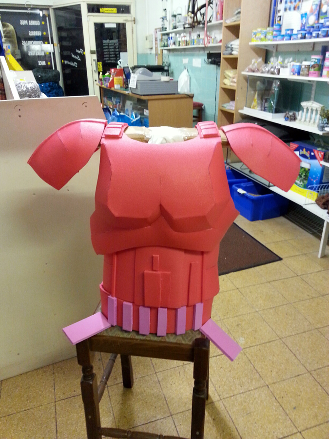

I started with the chest and back, then the abs, the belt, the shoulders and that is as far as I got yesterday, I decided to take a alternate approach to the pep file for the belt, rather than building the blocks out of the thinner foam I have a bunch of thick foam from my Ironman build so used that for the blocks, I also added in the shoulder straps using some thin foam I have left over from my Ironman gloves.
So that's the progress from day so far, I'm going to get on and hopefully have another update later I will need to order some black webbing and clips so the chest and back armour don't bend like they do now when worn.

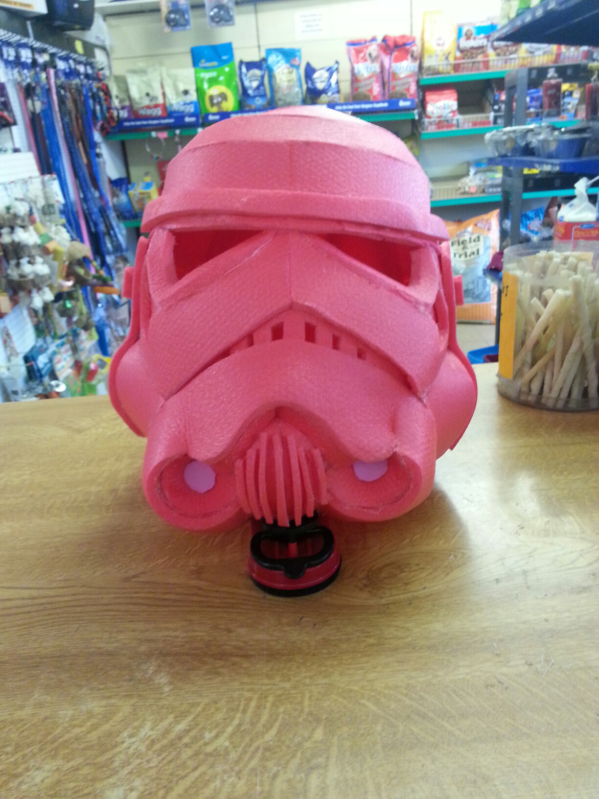

And the helmet is finished (I'm going to attach the mics once those and the helmet are painted), I'm reasonably happy with it, ideally I would like to try and pic up a cheap casted helmet if possible as I can always display it alongside my Sideshow 1/4 Stormtrooper when I'm done but for now this one will do.
Other than attaching the clips and velcro the building side of this project is complete.

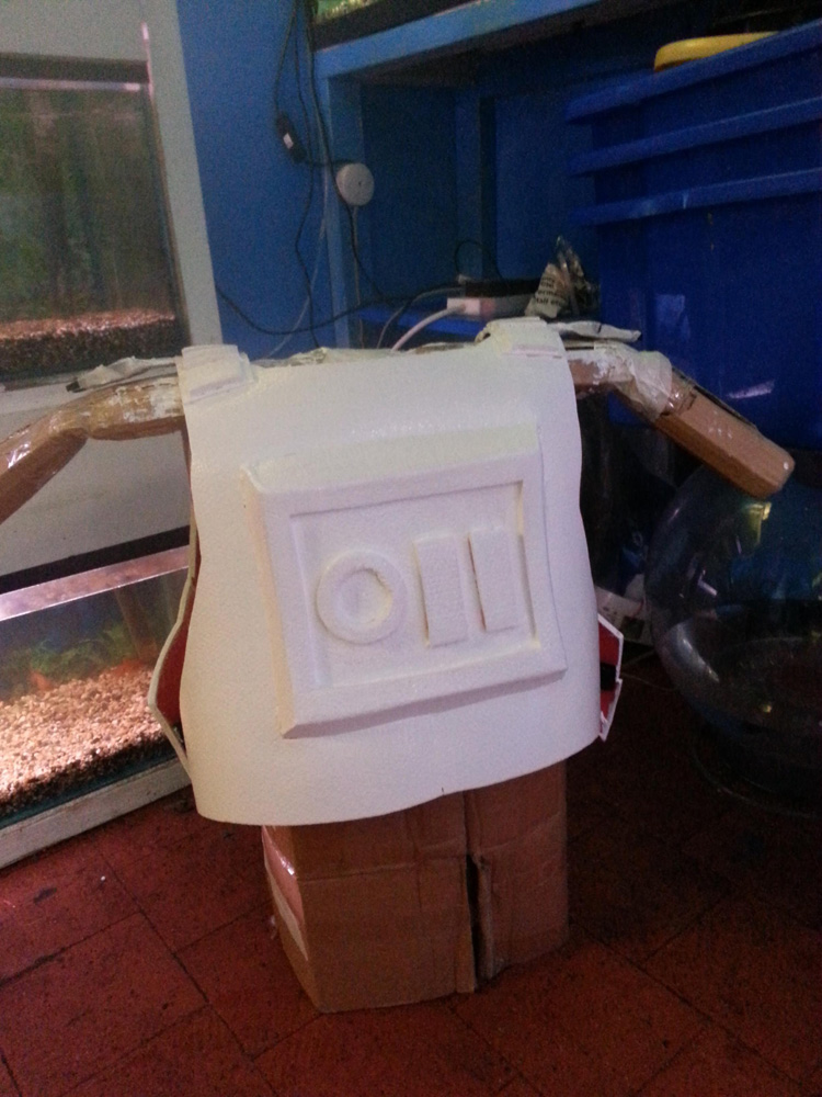

So Painting didn't get as far along as I wanted, actual work took longer than I anticipated and my clips and webbing arrived so I decided to get these all in place so I could test fit a few pieces before painting.

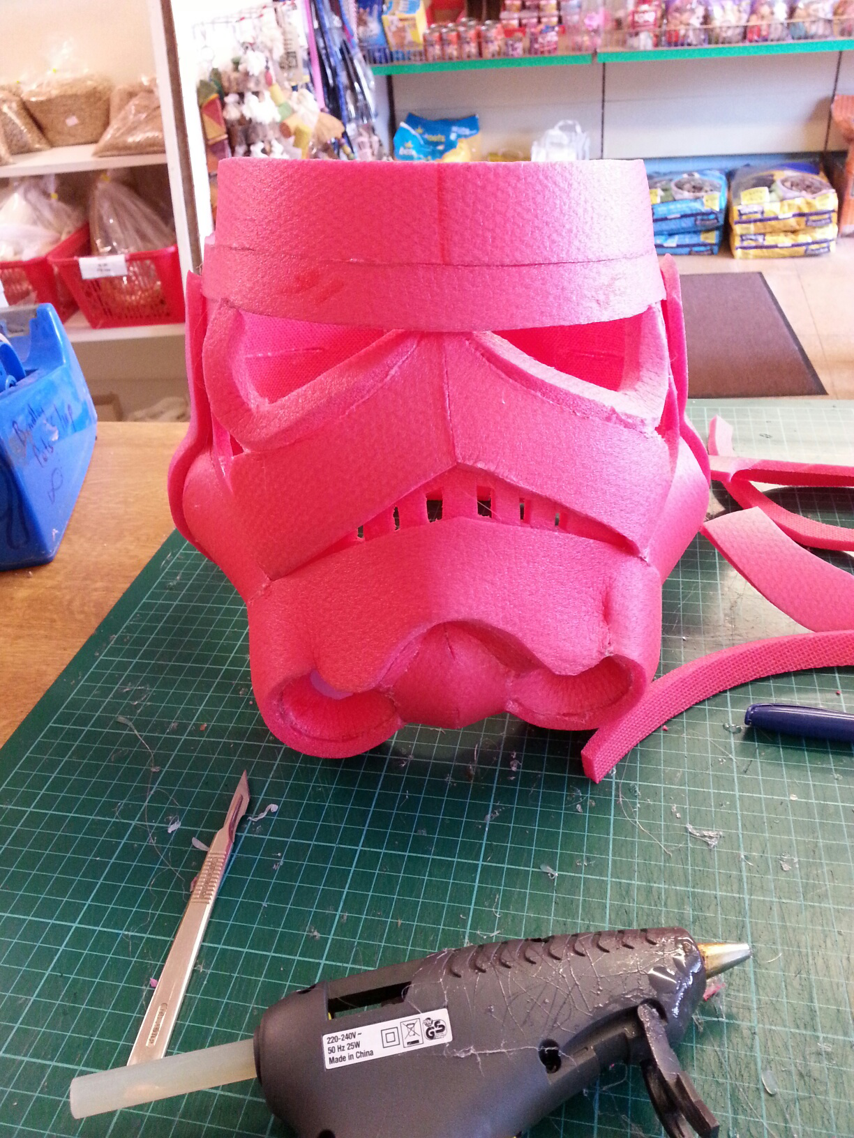

I was then looking at the pictures I took of the helmet and I really wasn't happy with how the bottom of the helmet wasn't centred or the mouth piece so I decided to cut it and adjust it and removed the whole mouth piece.
I've left the mouth piece off this time done it as one solid piece with groves in it which looks much better, I will paint this black separately and glue it on when the helmet is painted.
As you can see the helmet looks much better now
And here's a few pieces in place with the clips on the shoulders etc.

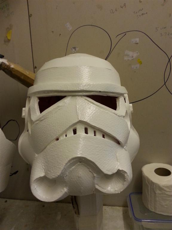

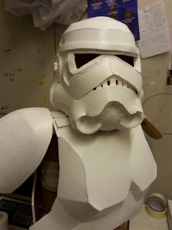

And here is the helmet and torso after a couple of coats of paint.

I've not really had any issues with brush marks the helmet and torso have had 4 coats now the texture has gone a little but not a lot.
This was after 3 coats:
This is after 4, you can see the texture is gradually going.
