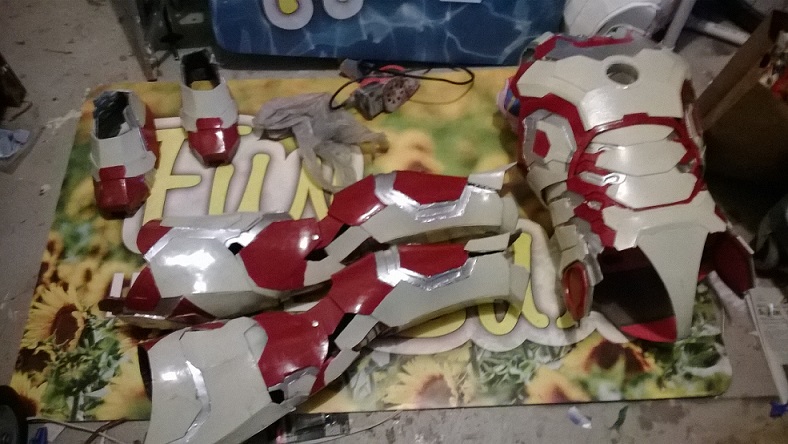

Xrobots method is the best, and a gallon kit of smooth-cast should be more than enough to do a whole suit. Leave key areas un hardened for flexibility, It is what I did for my Fallout Power Armor, and my Iron Man mk 42 suit.

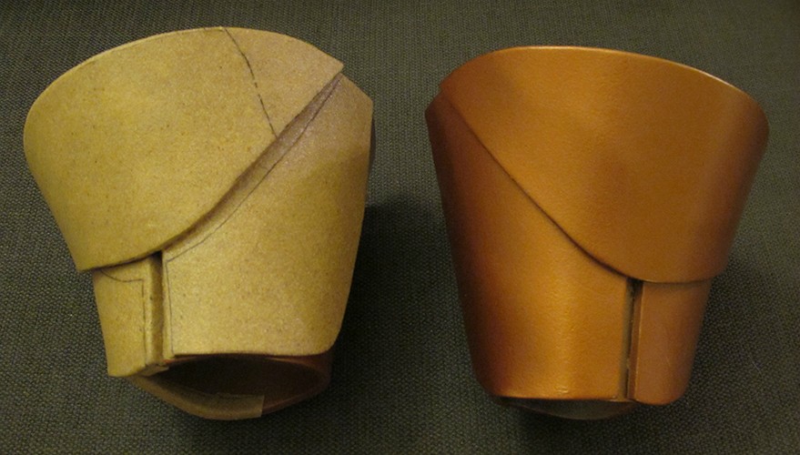

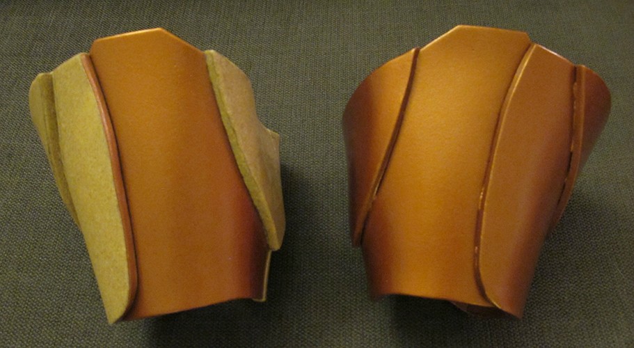

Ooh! Ooh! I have a great solution! Have you heard of Worbla? If you're not strapped for cash it works perfectly to make foam hard and smooth. Worbla is a thermoplastic that comes in sheets. One side is more adhesive than the other. Heat it with a heat gun and it becomes super malleable, to the point where you can even use it like clay! It forms a super strong bond with itself, and you can reheat it as many times as you want. It's super easy to work with and emits no fumes. When heated it stretches and does compound curves very well, and you can squish the seams together so they become almost invisible. The surface of the Worbla is sorta rough but that can easily be fixed with several liberal coats of gesso (and I'm guessing also bondo, haven't tried this myself yet), and then some sanding. The final product is very rigid and durable. I covered a piece of 5mm foam armor with it and you can't bend it at all! I curved the Worbla over the edges to the inside slightly which provides more structural support. I would imagine that not doing that would make the armor slightly bendy depending on the shape of it. Worbla on its own is still quite flexible.
Here are some pics of my armor. They were already plastidipped and painted but the paint was cracking so I'm covering them in Worbla and will re-paint. Since I took these pics I have finished covering that one that's partially done, gesso'd it, and sanded it (going to fix some areas with bondo).
The Worbla also allows you to shape the foam in ways you couldn't easily otherwise. Note the indent in the side of the Worbla-covered one in the bottom two pictures. After applying the Worbla I reheated it and bent that part inward to allow it to better sit against my body (these are upper arm armors so they hit my ribcage).

Elmer's Glue All glue works pretty good. My Mark 42 looks and feels like plastic. I only used 2-3 layers...
