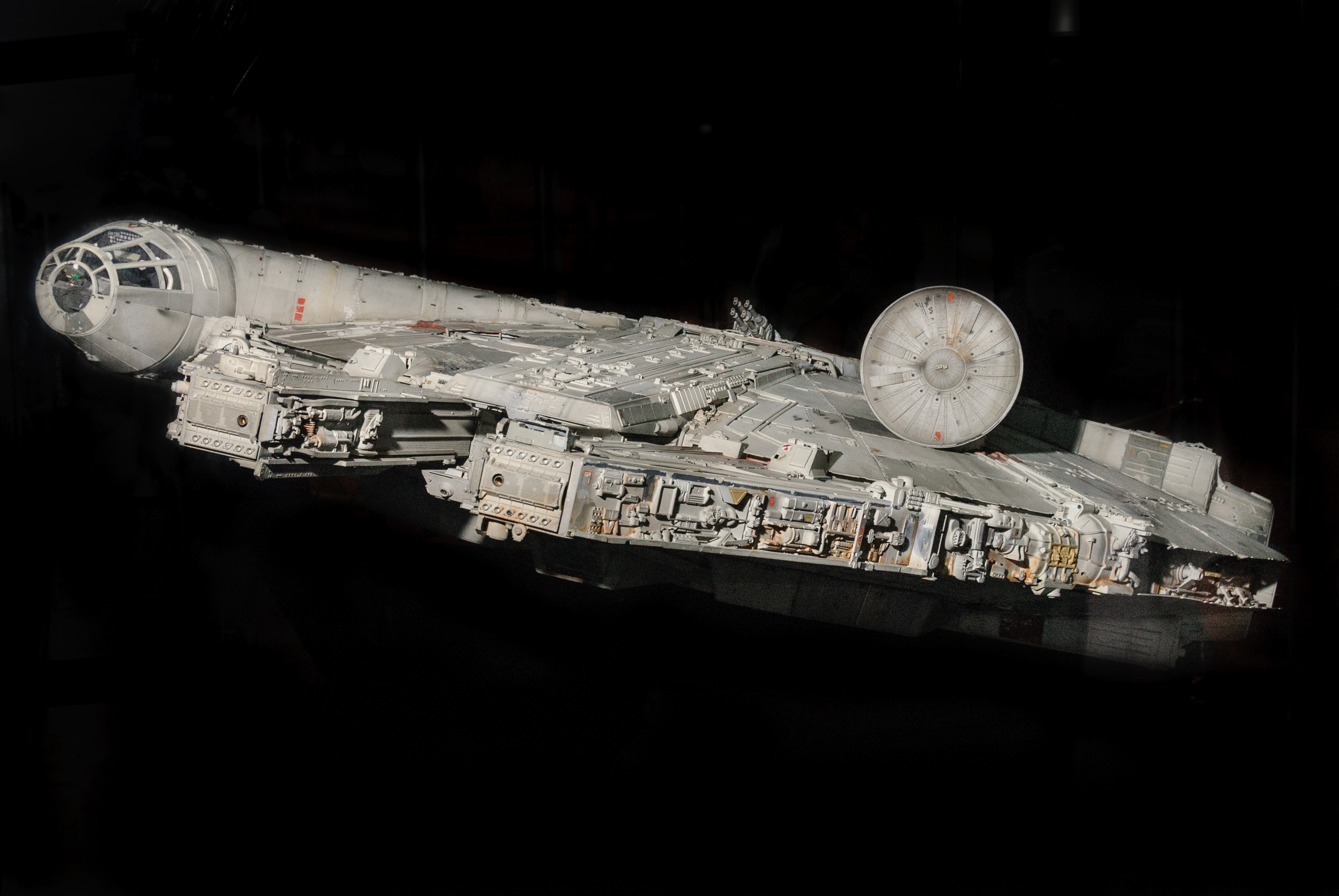

Jaitea - Nice color correction! A curves adjustment layer or...?
Regards,
Andre
Nope, just a simple duplicate of layer....up the brightness & fix contrast on top layer then rub out the blown out areas to reveal the original in bottom layer

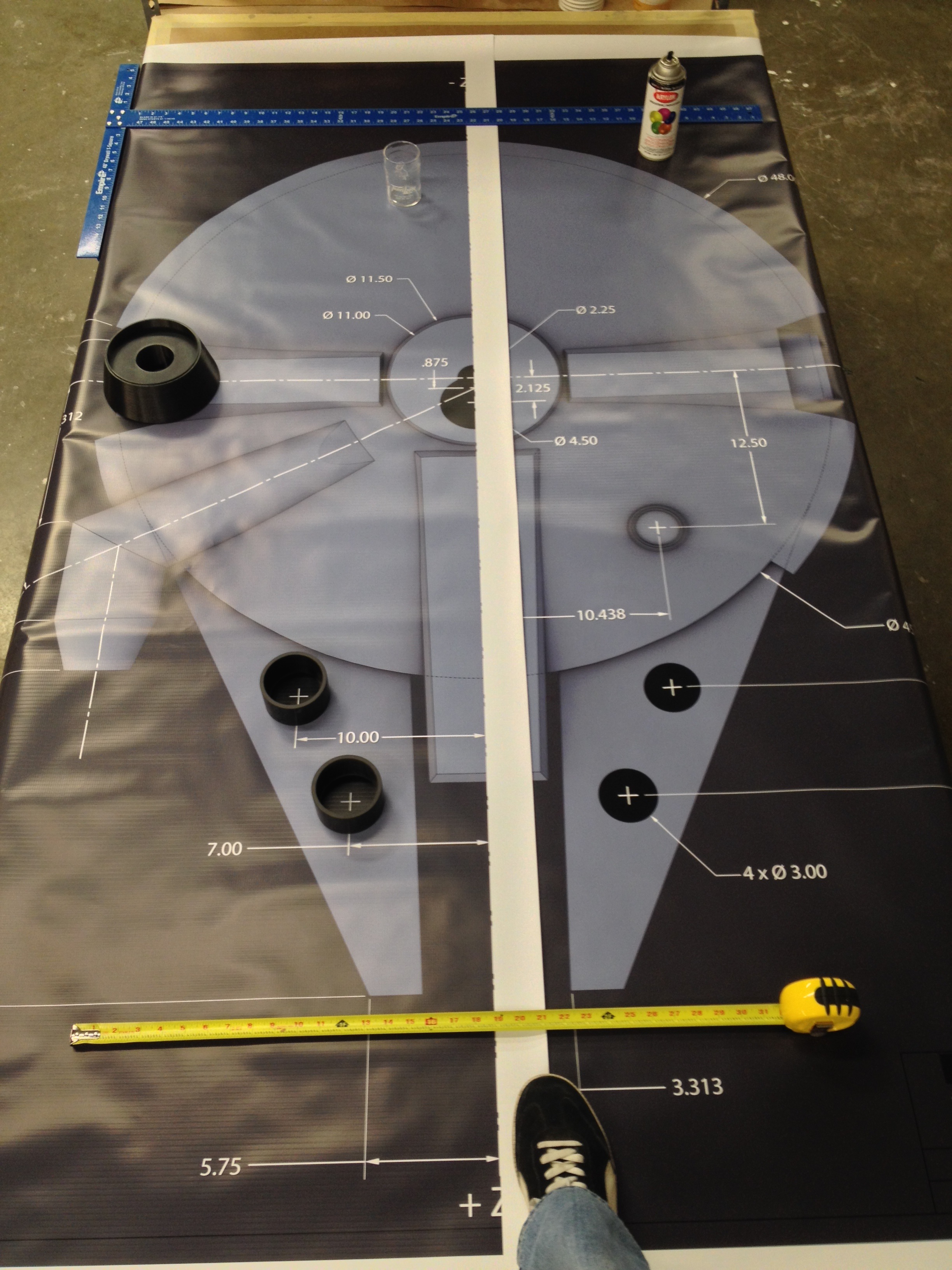

Ok, been away awhile. Work got a little crazy at the end of the current studio project...
But below, a quick peek at the current printed blueprints (1 inch = 1 inch) - - - and they are huge.
So big I had to have them printed in two halves (the white border is excess "bleed" that will get cut away when the two halves are brought together). To lay them both out and see the whole full size model, one needs a minimum 4' x 8' flat surface. (That's my right foot at the bottom of frame hovering just above the prints).
Next up over the next few weeks: Proposed bottom rear landing gear box blueprint dimensions and the start of donor kit parts hung off my real-world mockup to confirm the overall blueprint dimensions.
