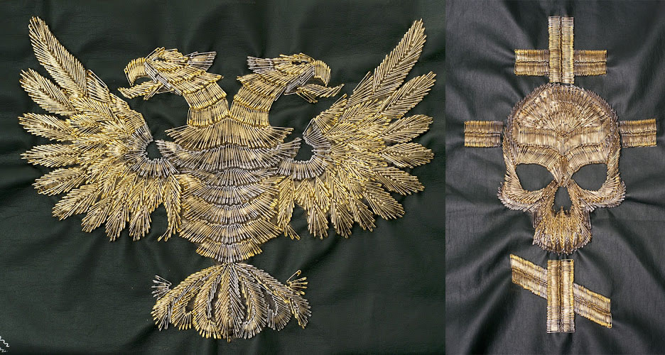

The backs have two different patterns. Sasha's coat is a two headed eagle, while Aleksis's is a skull and cross. Both are made out of what must be thousands of gold safety pins.

I free-handed a stencil for the back, and used more of that trusty gold spraypaint. I did the same thing with the Russian "Cherno Alpha" on the sleeve, but kept the paint light for a worn & faded look.
