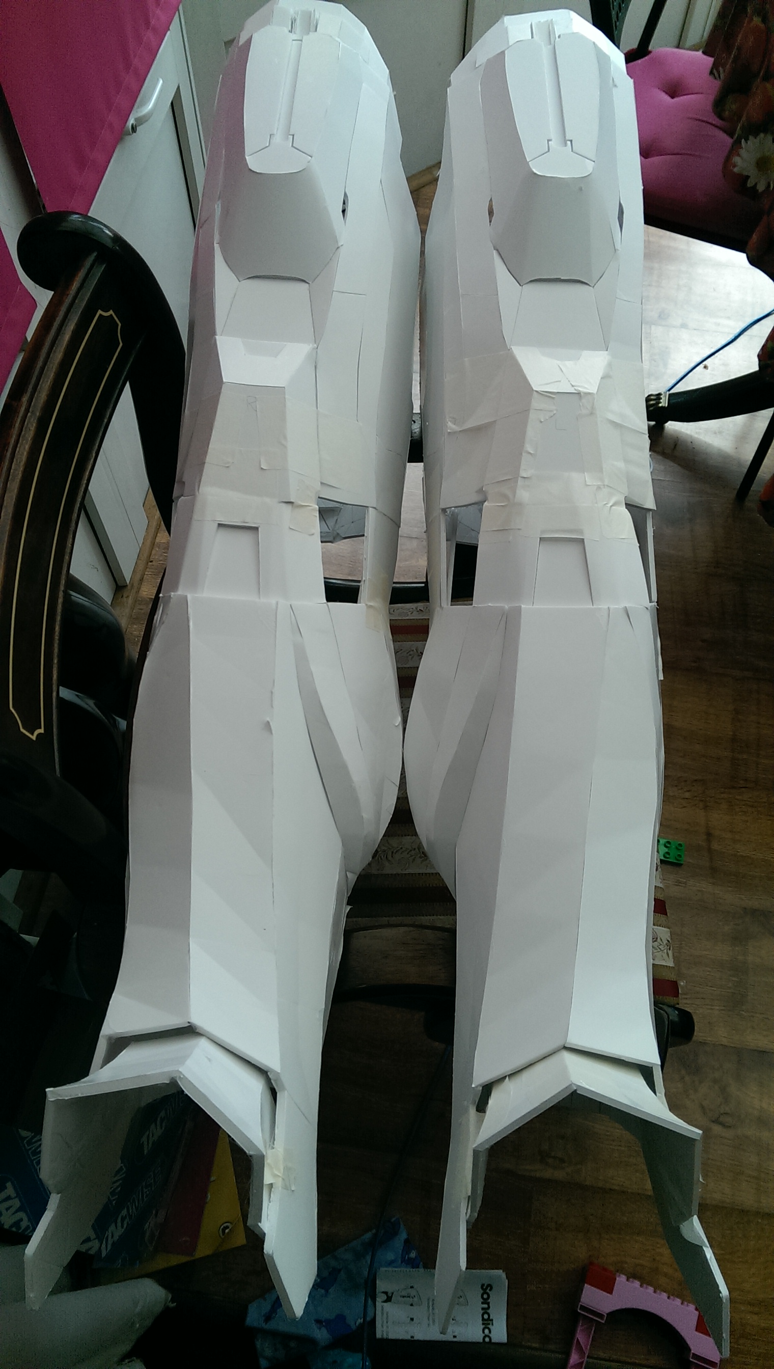

Legs are done, and are drying from their first layer of fibreglass. Have used Mat for most of the main structure, and will use cloth around the edges to hopefully reduce the chances of getting stabbed.

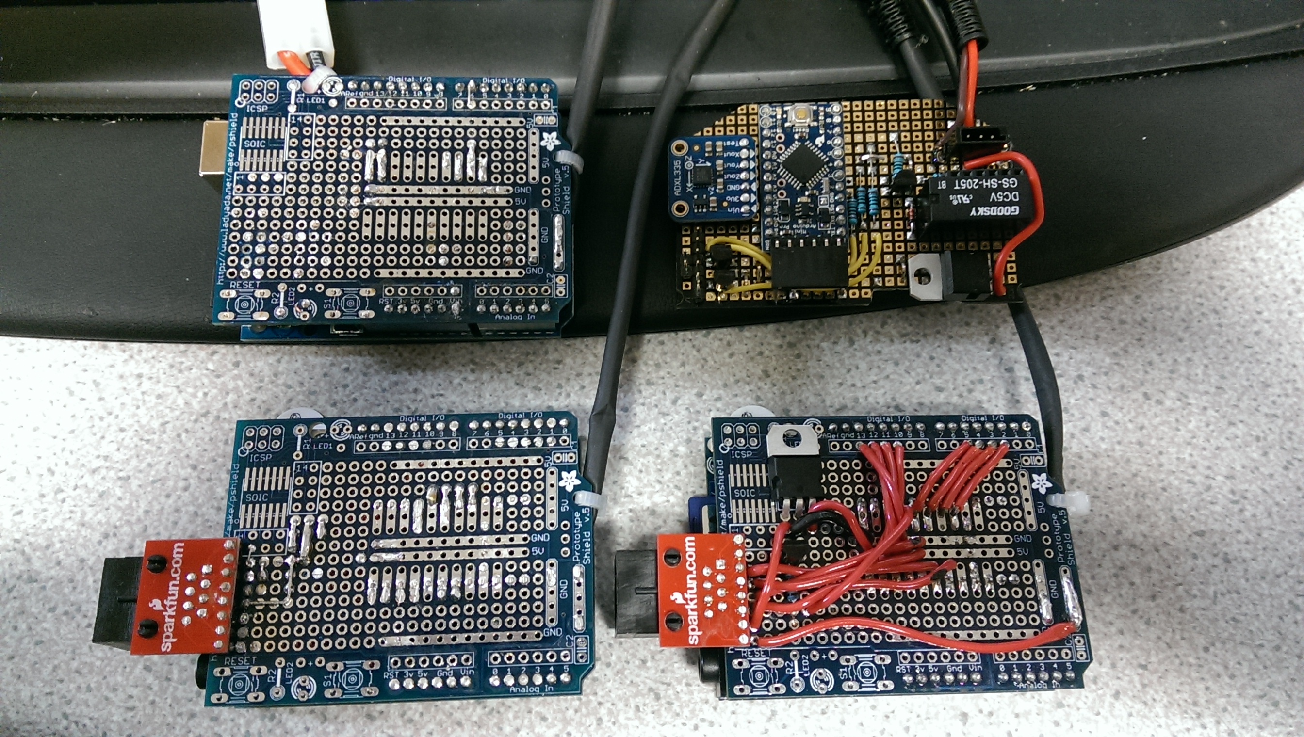

And the four suit control systems are pretty much done;

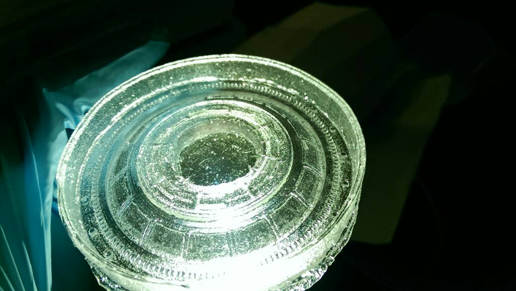

Top left is the chest repulsor controller. I was going to run out of battery pretty quick with the lamp I've got, but an arduino running a fade loop between medium-high brightness more than tripled my runtime.
Top right is the helmet controller. This has an adxl335 to detect helmet angle, and open/close the faceplate and power up/down the eyes as required. It also powers the helmet camera. I would have liked to power up/down the camera and goggles from this board, but I ran out of time.
The bottom two are my hand repulsor controllers. Again I have an adxl335 accelerometer mounted to the back of each hand lamp (see below) which measures my hand angle to determine whether to power up, power down, or fire.
The hand controllers and batteries should be mounted in my back, with cables running down my arms. The chest system will be mounted directly in my chest, and the helmet should hopefully be a completely self contained unit.

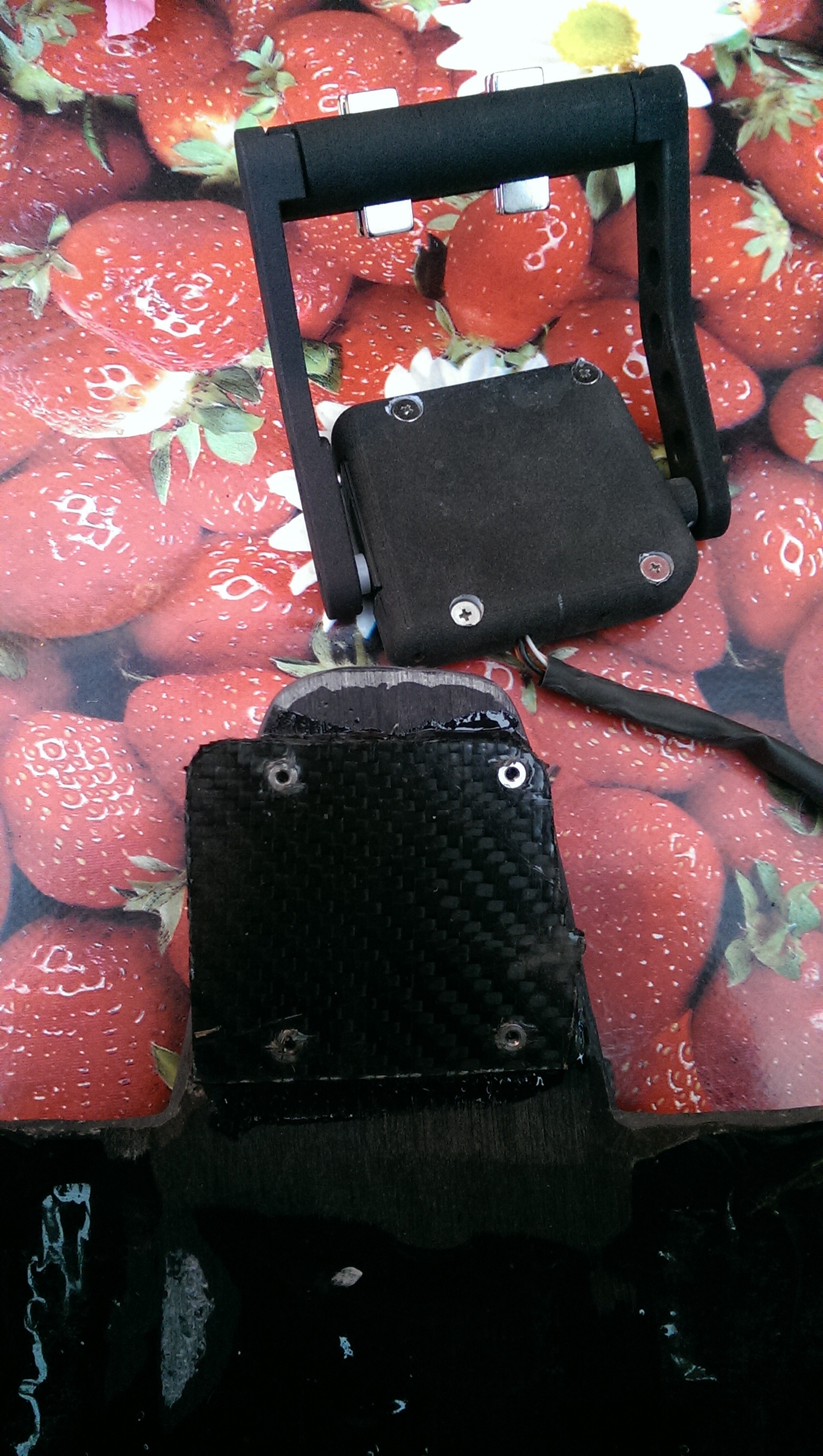

Made up a small cf plate to mount the servo mechanism to. That way I can remove all the bits that don't need painting prior to paint.
I've also glued a couple of stupidly strong magnets to the mechanism to hang the faceplate from.

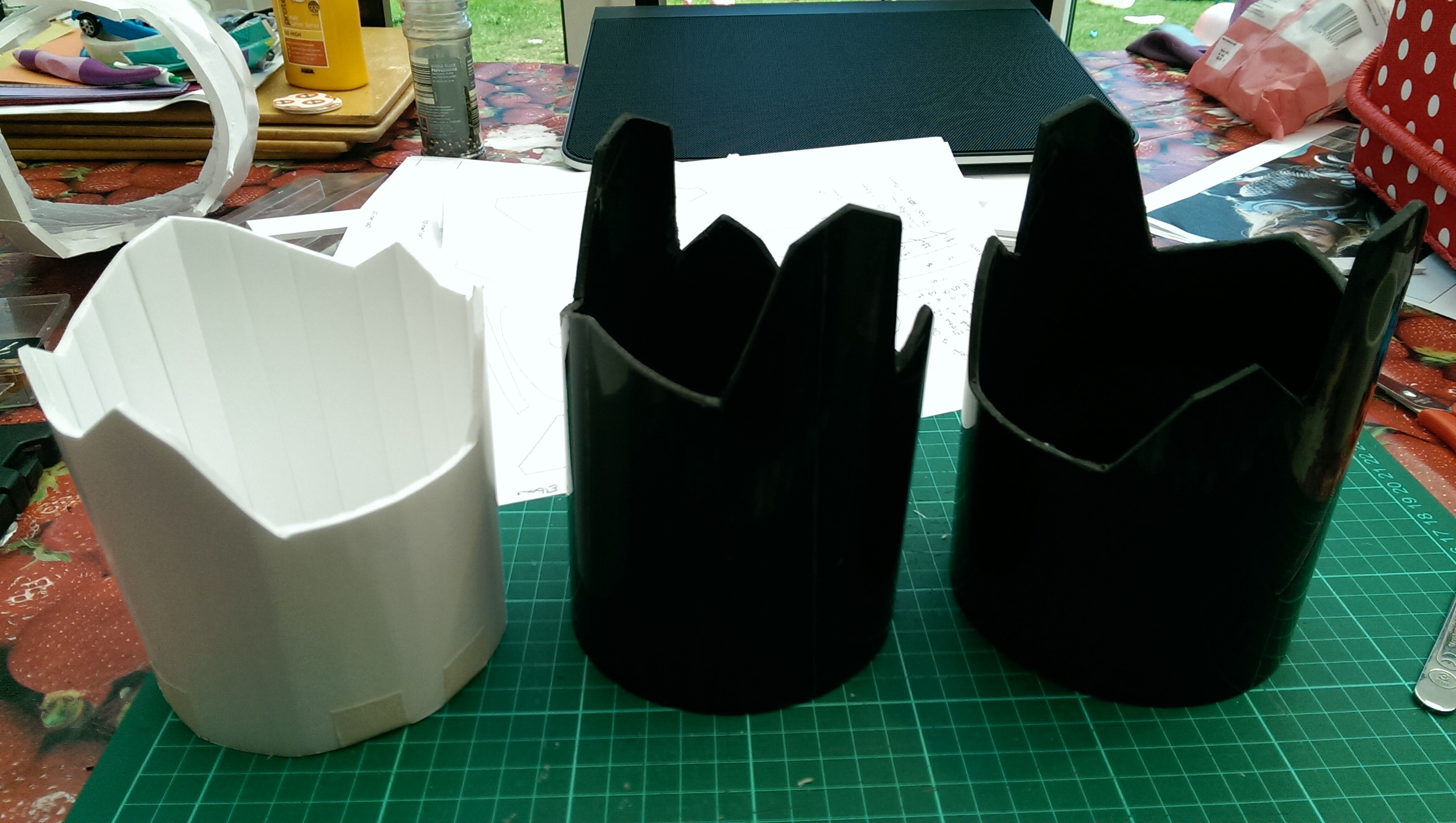

Pep upper forearm on the left. PVC waste pipe on the right......
They don't taper in, but neither do my arms, so they'll do.
