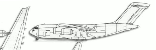

looking at side views of a C-17 vs The Bus it looks like the top deck of The Bus follows the same basic profile as the top of the C-17 but the cockpit is moved forward and down which means the bottom of the fuselage is flatter.

Something I found that looks interesting...
http://2.bp.blogspot.com/-aWsdZ7bngaU/Uk8Cs4t-kbI/AAAAAAAAn5Q/Ni3McD4HItw/s640/aviondeshield.png

roughly lining up views of C17 and The Bus schematics - it's clear the schematic is based on similar views of a C17. Whether the CGI model follows the same lines will have to wait for someone to find orthographic plan and elevations of the actual CG model
But, assuming the animated gifs show up, the tail and wings can be made to line up - which leaves the cockpit and nose of the Bus forward and down a bit relative to a C17.

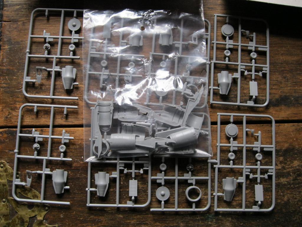

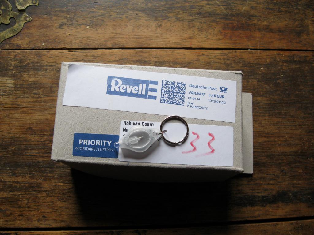

I already have two C-17 kits, and yesterday I got a small package from Revell Germany...
I used the contact form on their site to contact Revell's Excellent "Abteilung X" (their spare-parts department), explained what I was planning to do and asked them if I could get/buy some extra parts, a.i. the complete set of parts for the four engines...
Score! All(!!) the parts for the four engines! I'm planning to cheat and build one Bus, but make the engines in such a way I can swap them out between normal and hover mode. I've done similar using small magnets on fighter-bombers to swap load-outs. And... yeah... I'm nuts... gonna try and light the hover-engines with 0603 SMD LEDs. Which means making an electrical connection in a 1/144 scale pylon as well. Crazy, but do-able.

FYI, don't rack your brain on getting it correct against the "blueprint". That thing is wrong on many levels when compared to the screen used aircraft.
Tell me about it.
Just tried to whip up a 3D version based on it, body came out too thin, wings too big.
I just wish there was a site for the FX from the show with a decent set of orthos on.

I feel you man... Initially, I had an interesting time trying to figure it out. Here's a quick chop I did based off the blueprint. Forward section was stretched and the rear wings were added accordingly.
When compared to the screen aircraft, the rear wings are too far back.
