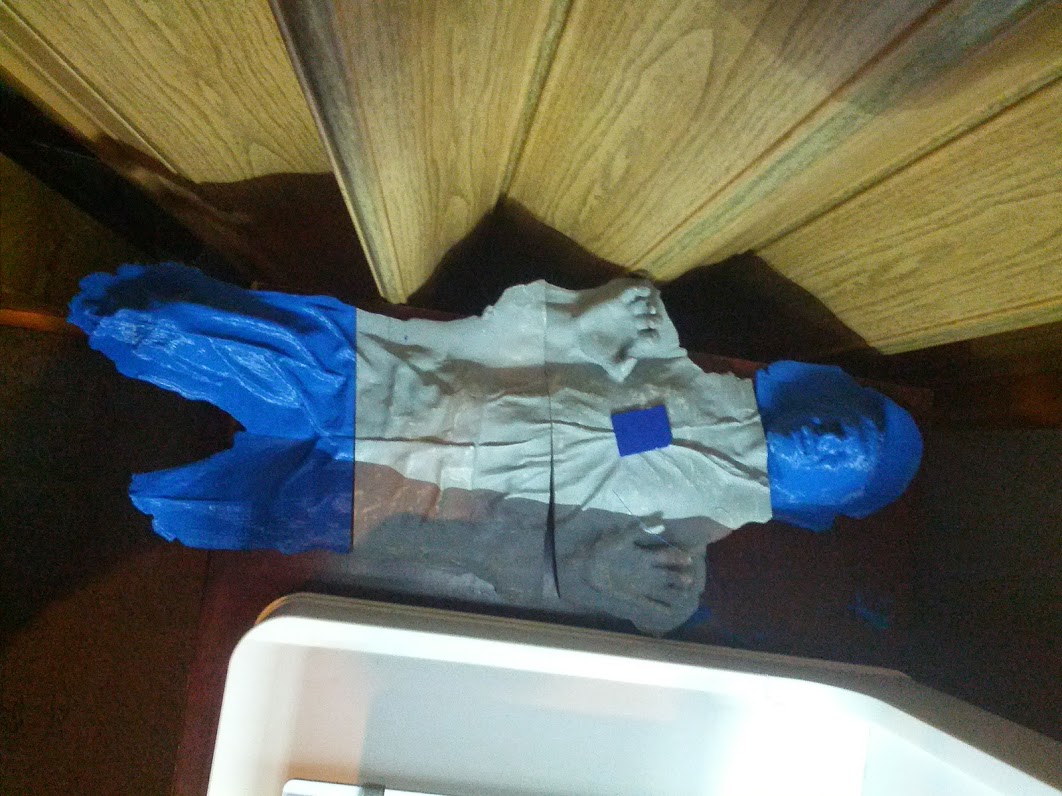

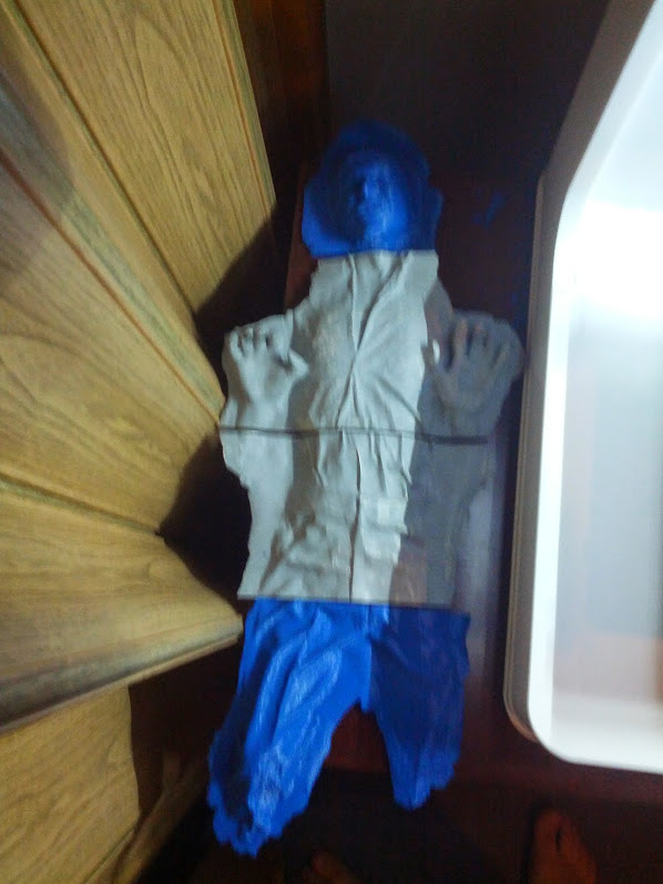

I first sliced the scan into 3d printer-bite sized pieces,
and added support using Meshmixer's new autogenerative support feature
and I've started printing them out
and removed the snap-off supports
The waist section is printing out now, and after that just the head, toes, and legs!

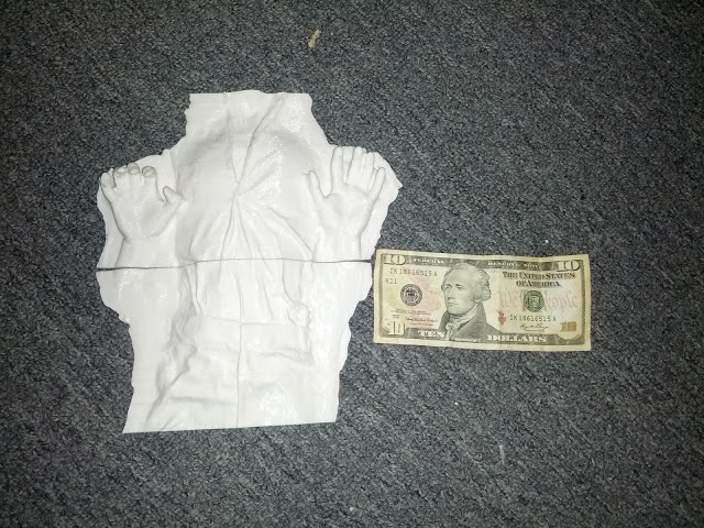

Haha. The bill is in there as a scaling reference. This is just a build thread. I'm making this on a home FDM style 3d printer.

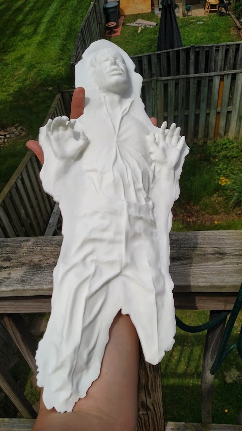

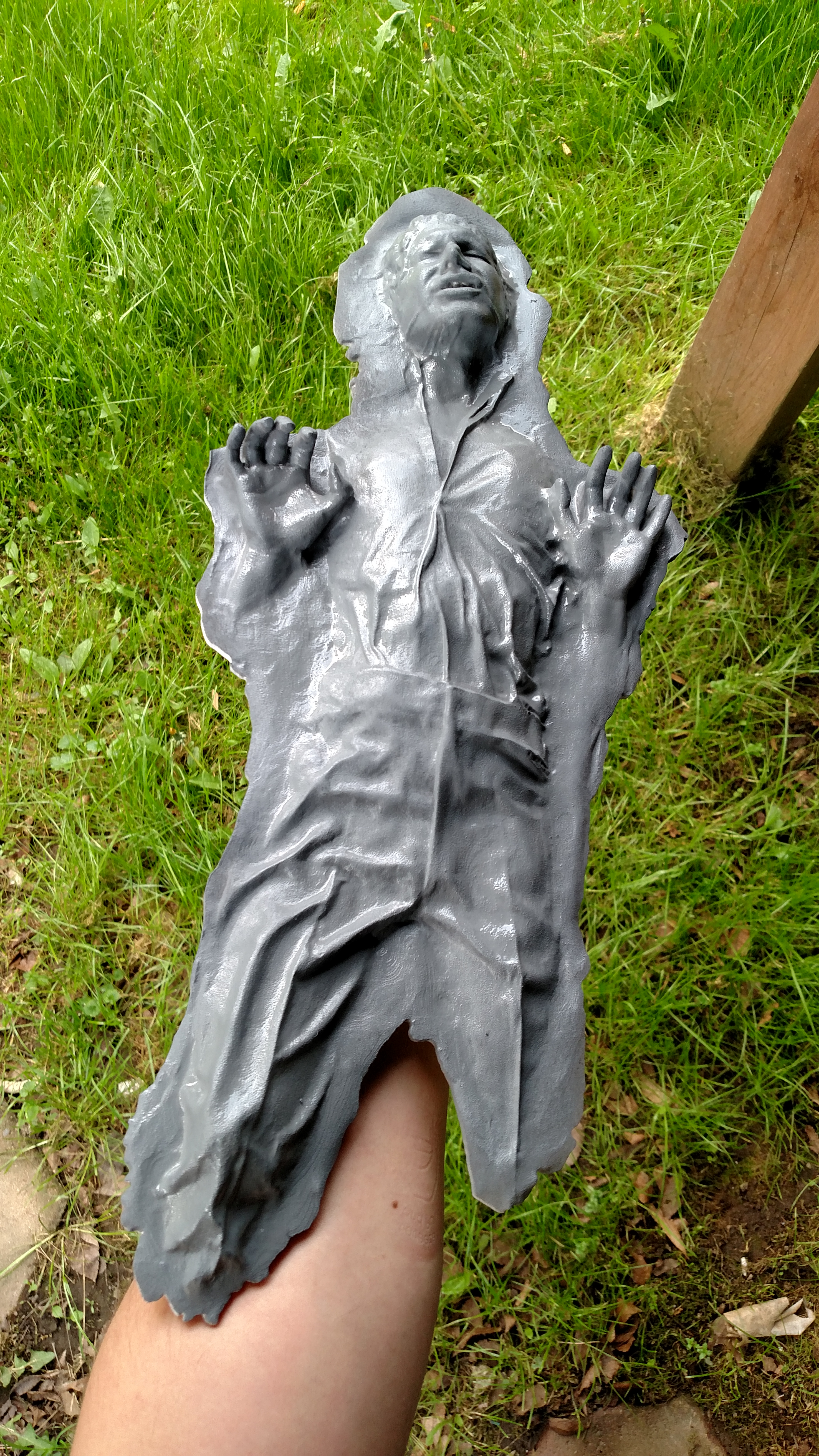

It's here! Check out this print!
I used laser sintering 3D printer to have it made in nylon with very high detail.

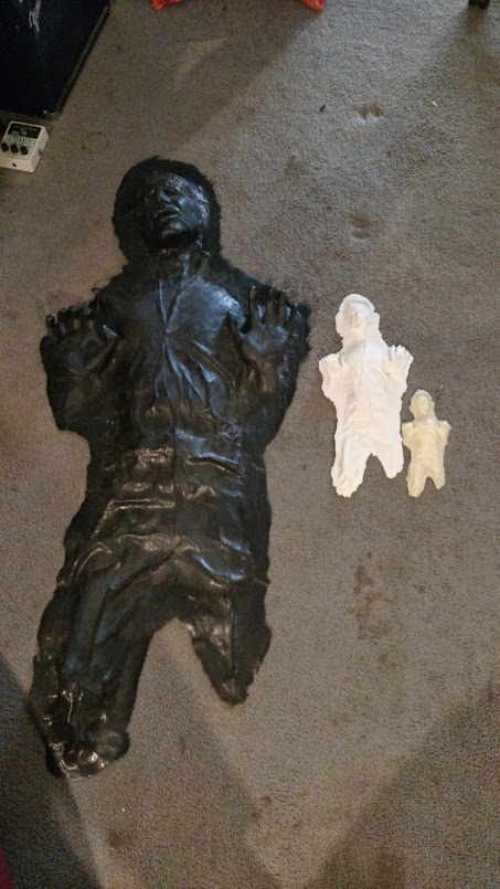

between a 1:1 and a 1:6 for scale
I had the toes done too but I don't have a picture of it with me. The next step is to finish the sanding to hide the build lines in the low sloped areas where they're slightly visible still. I'll be lasercutting a box for it using the same fullsize CNC files, modified for scale and for the lasercutter. Since it's smaller I'll be able to fit the whole front edge panel on one sheet.

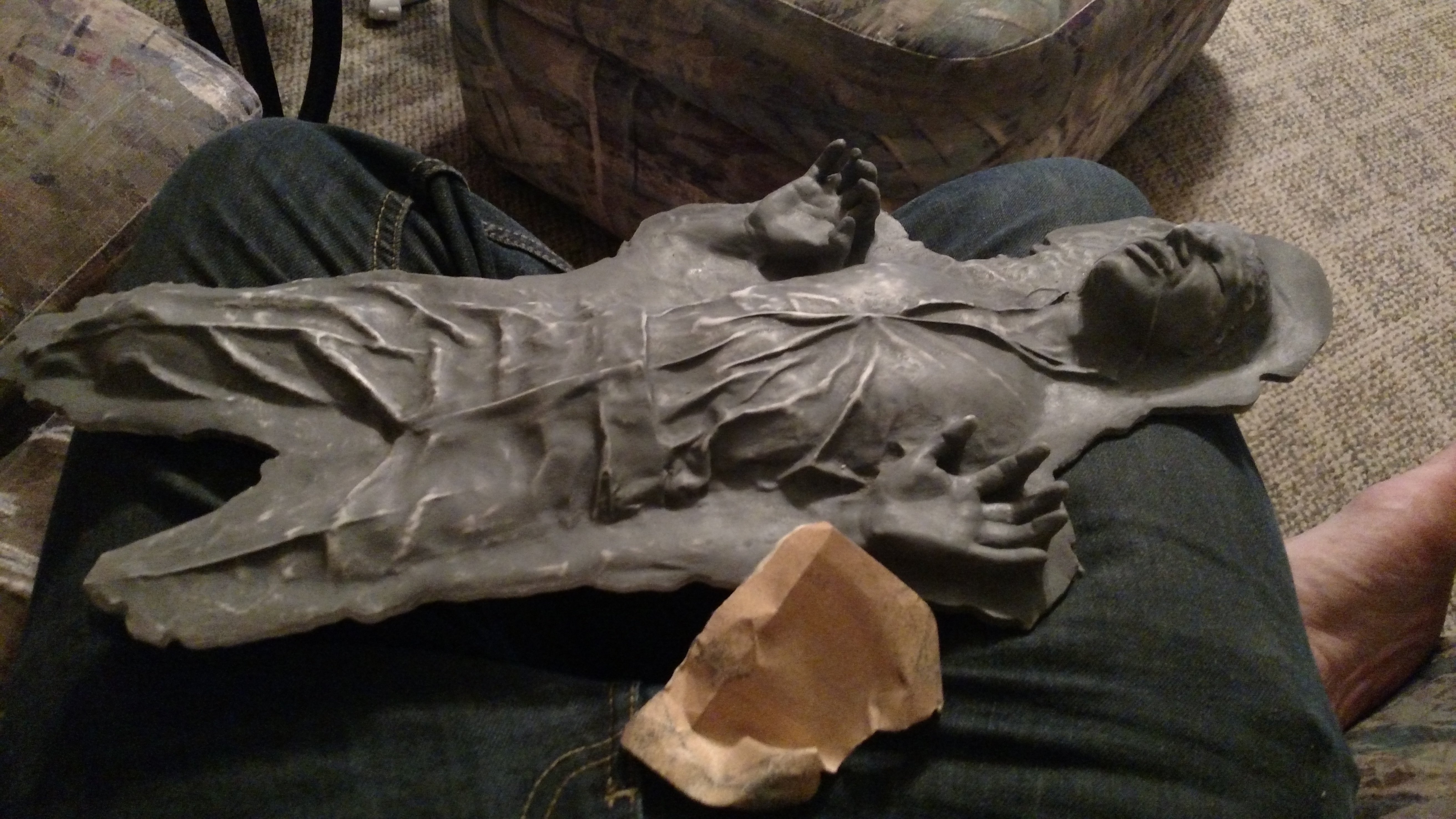

I've got some 1:6 still. I'm gonna make the 1:3 mold this month
