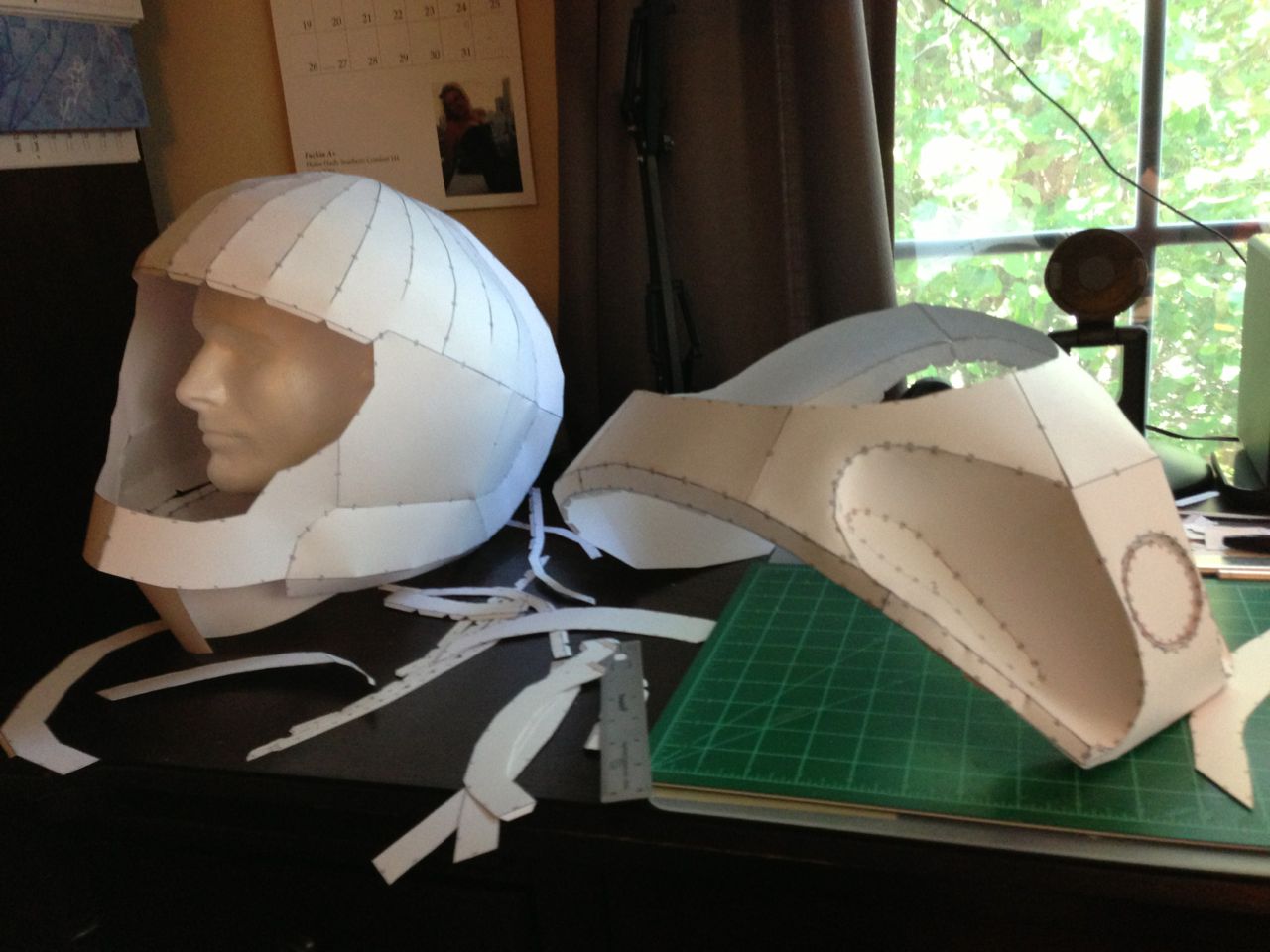

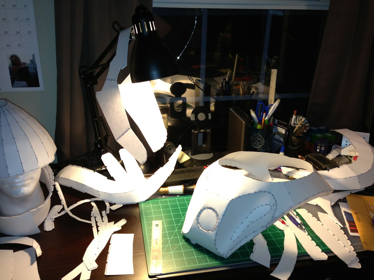

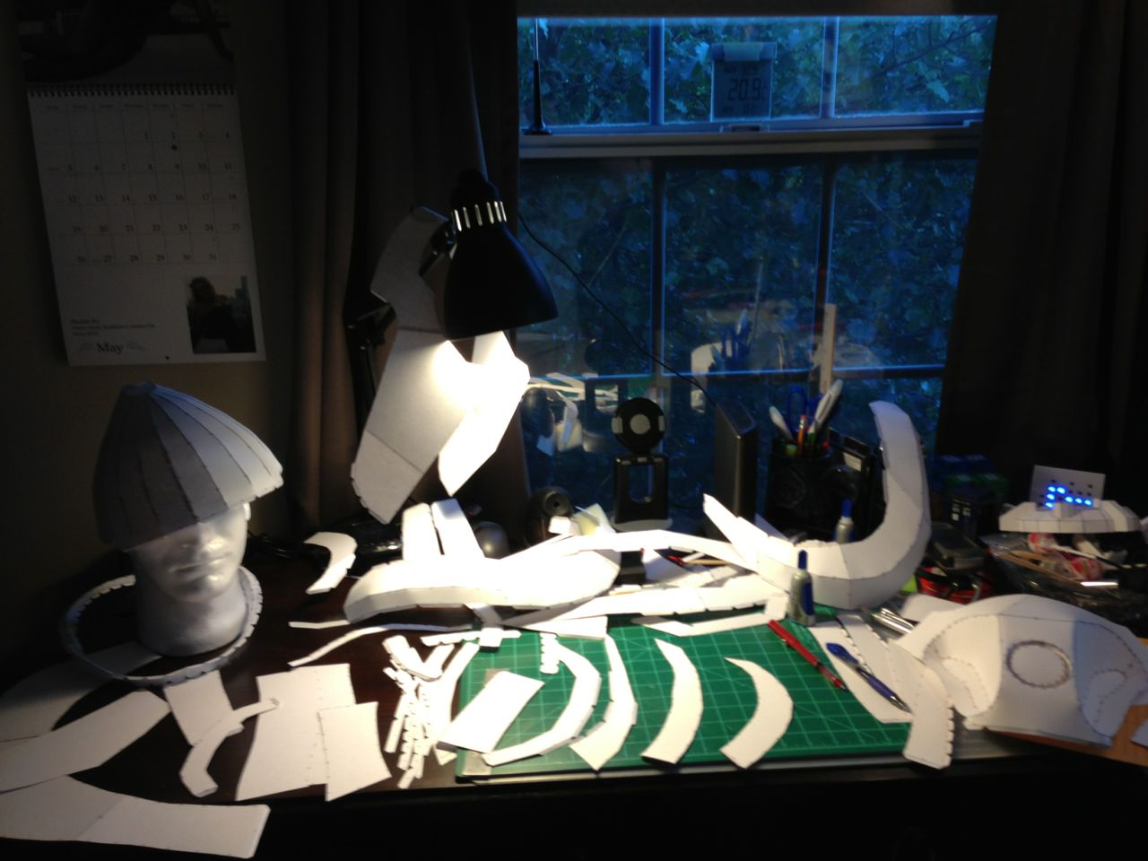

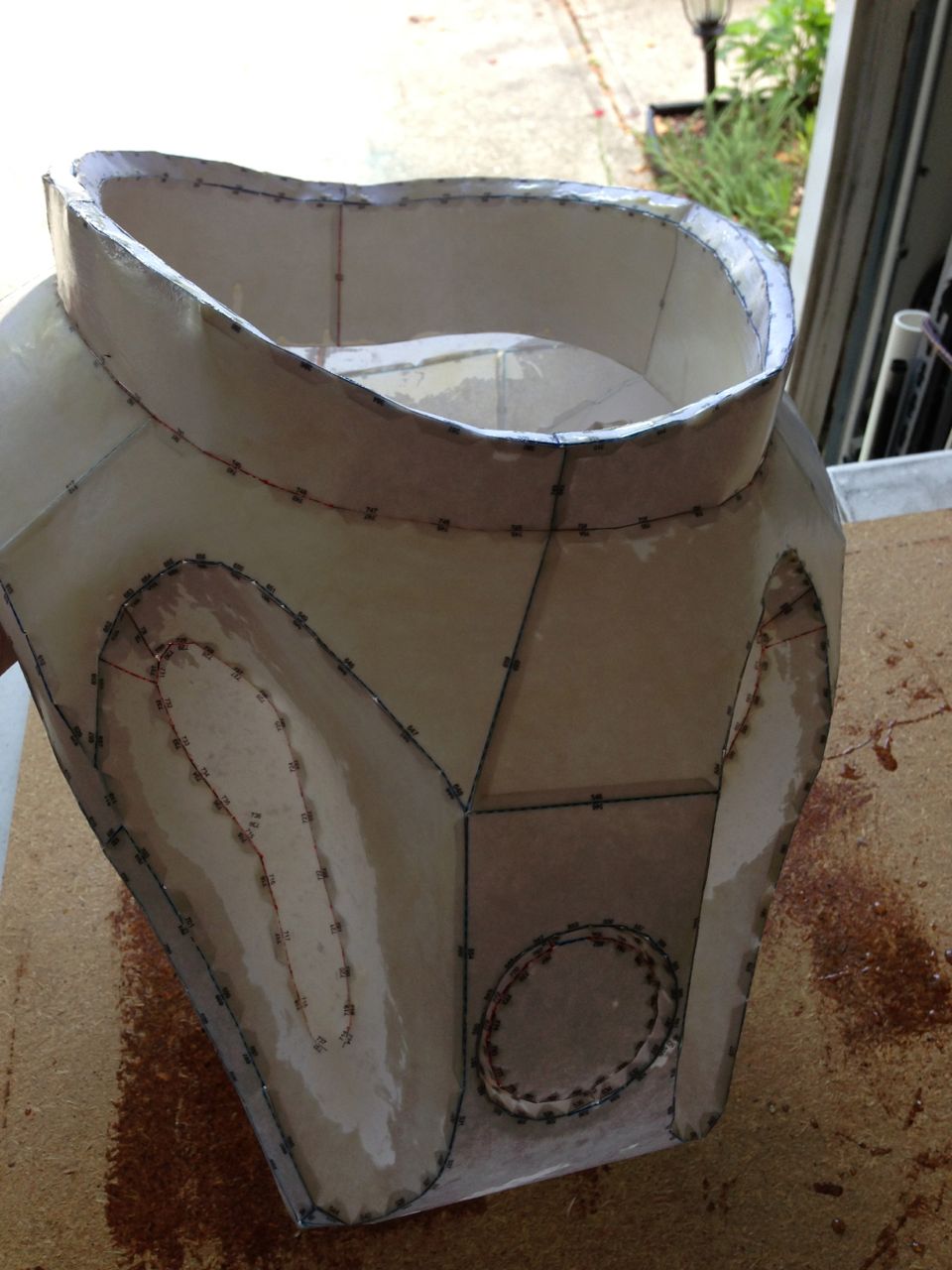

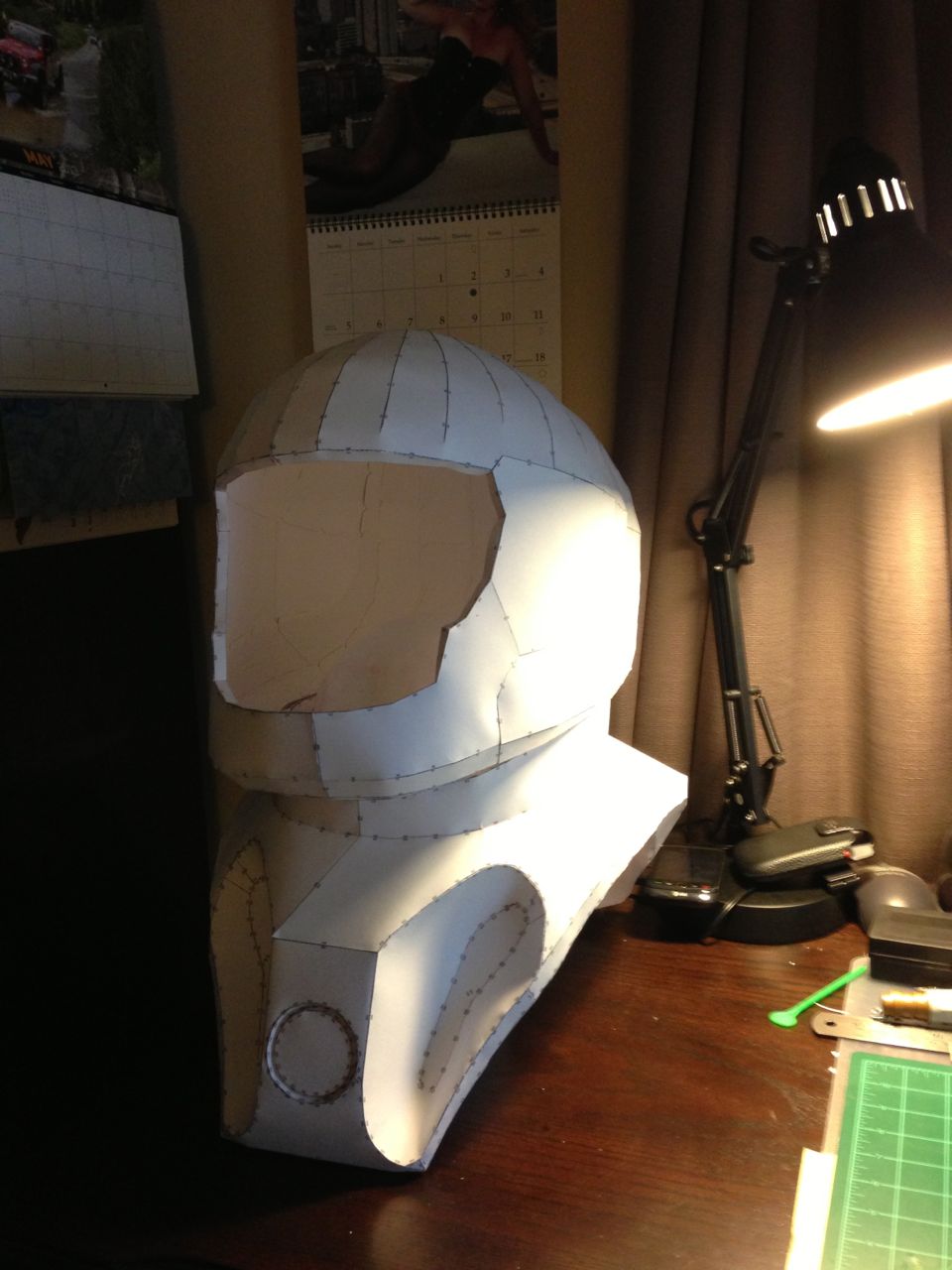

The printed plans resulted in 36 pages. I used 100# card stock. After many many hours of cutting out pieces I was finally able to start assembling.
I used SuperGlue for my assembly and in hind sight that probably wasn't the best idea. I'll probably use low-temp hot glue in the future.

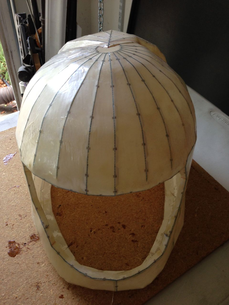

Once I had the pepakura model made it was time to move on to the resin and fiberglass phase

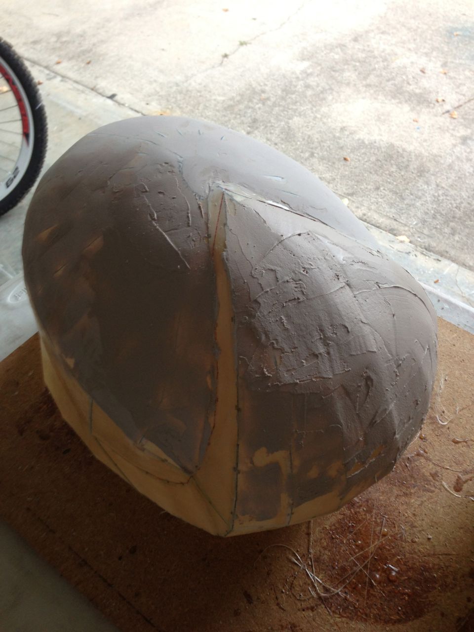

Next was the Bondo Phase. I've never worked with Bondo before so it was definitely interesting. My initial application leaves a LOT to be desired but the sander helped clean up my messy work.

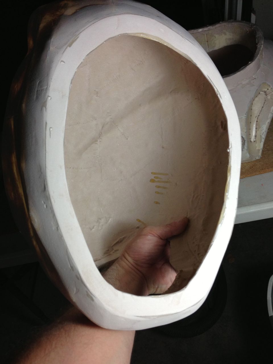

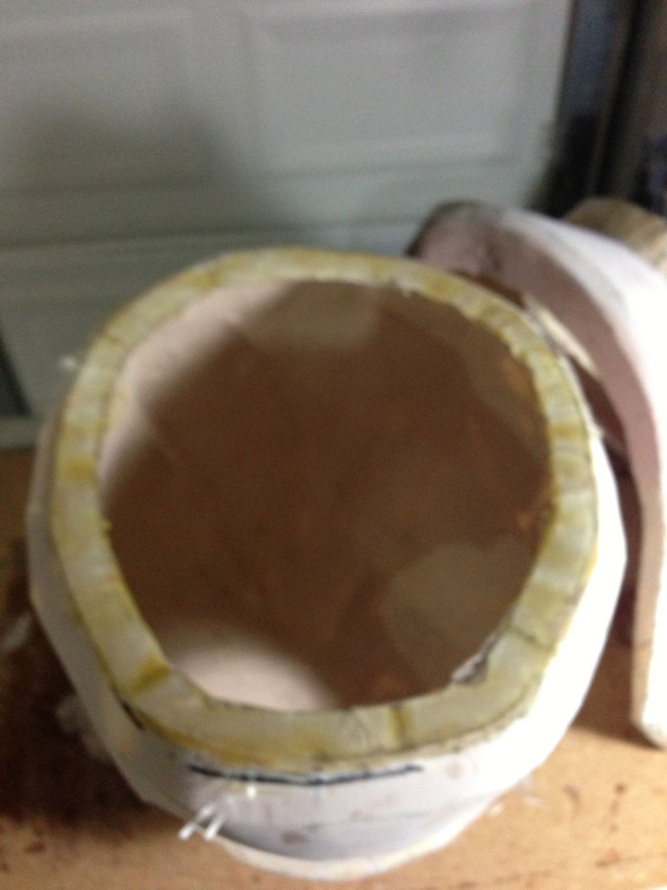

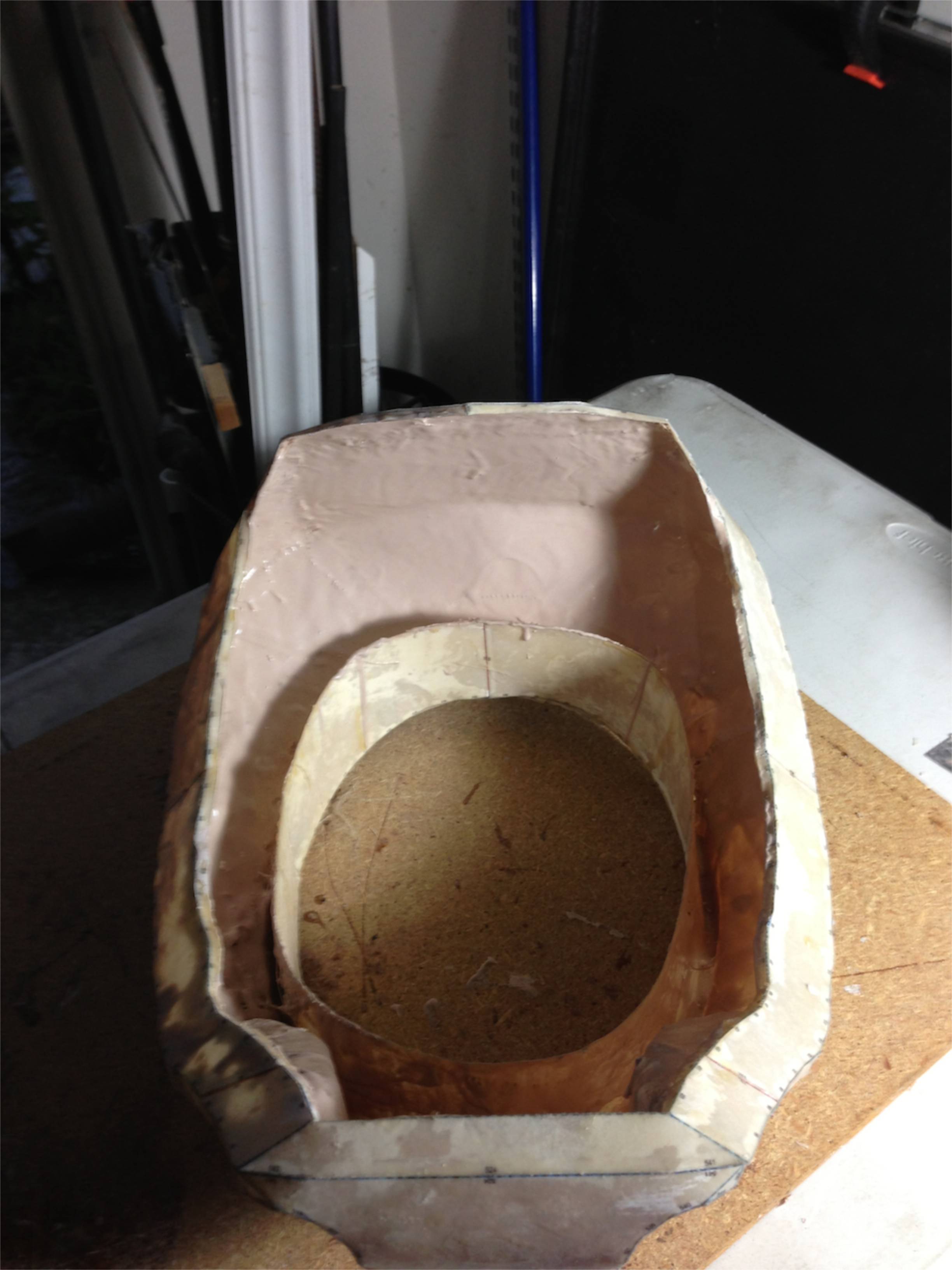

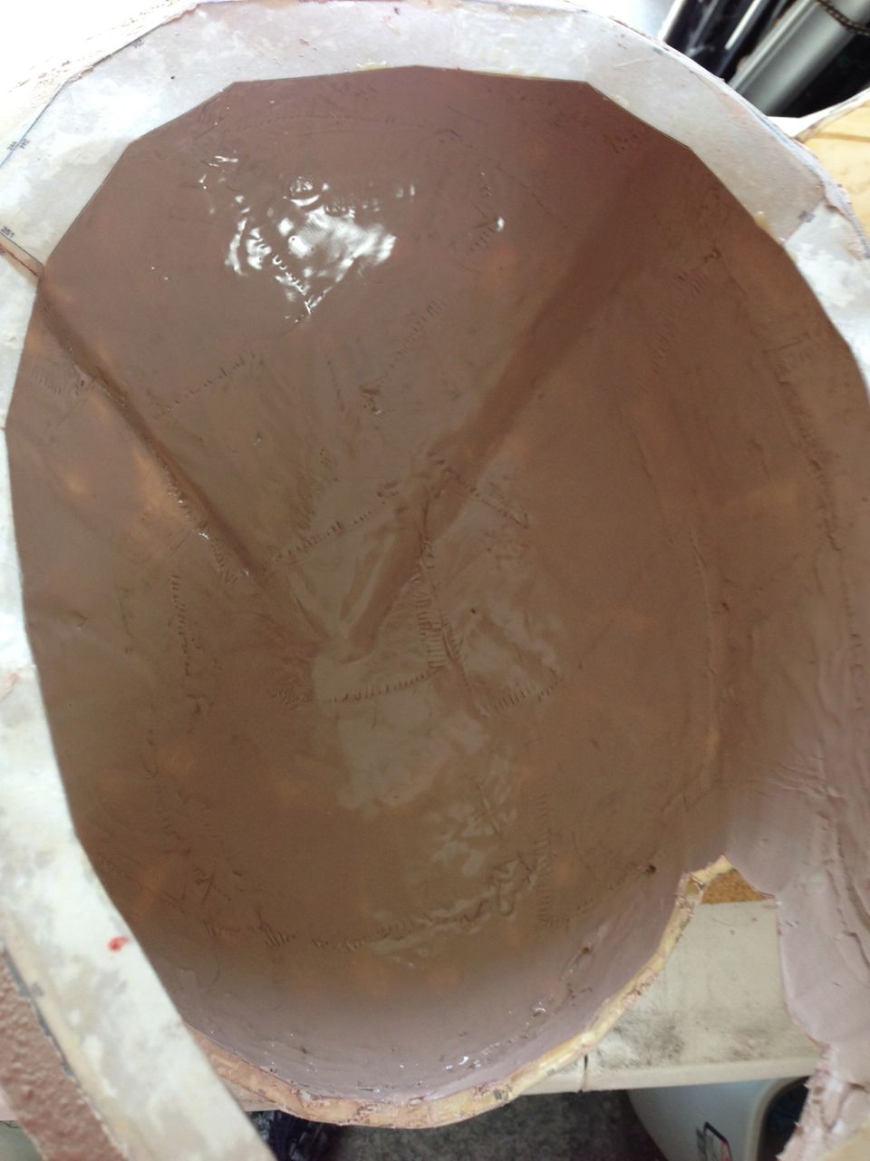

I then moved on to Rondo the insides of both pieces. I'm not sure if I should have Rondo'd first or Fiberglassed first. I did a layer of Resin, then Fiberglassed and then Rondo'd the inside.

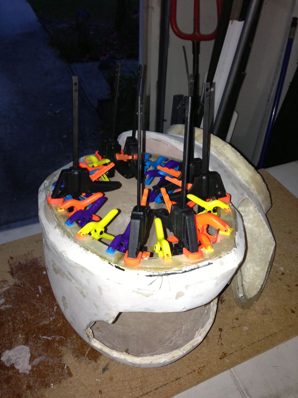

The bottom of the Helmet was rather weak so I got a piece of plexiglass and cut a rim out and then used Resin to secure it to the Helmet base.

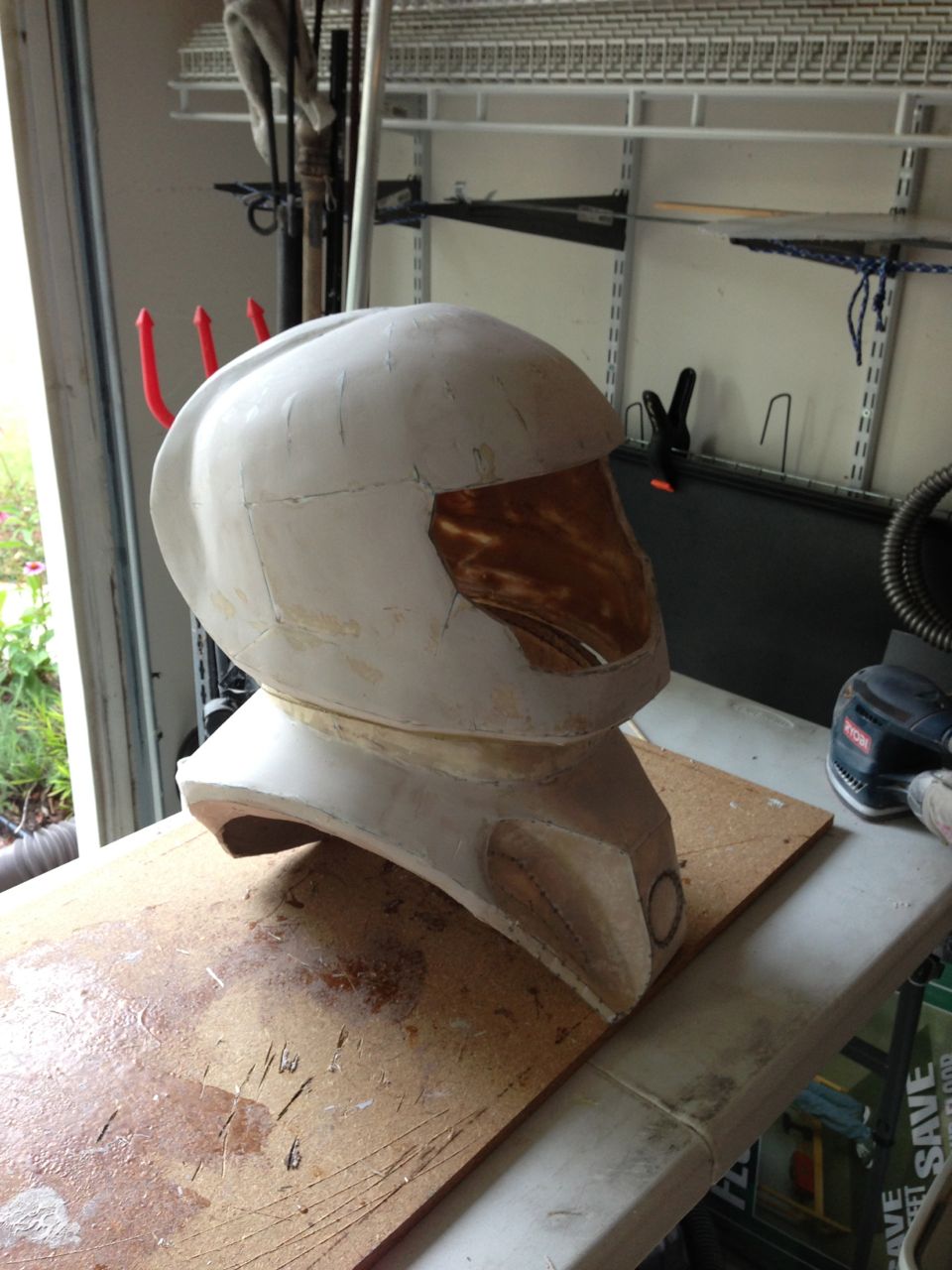

Outside of both pieces was a few layers of Resin followed by Bondo and TONS of sanding and reapplying.

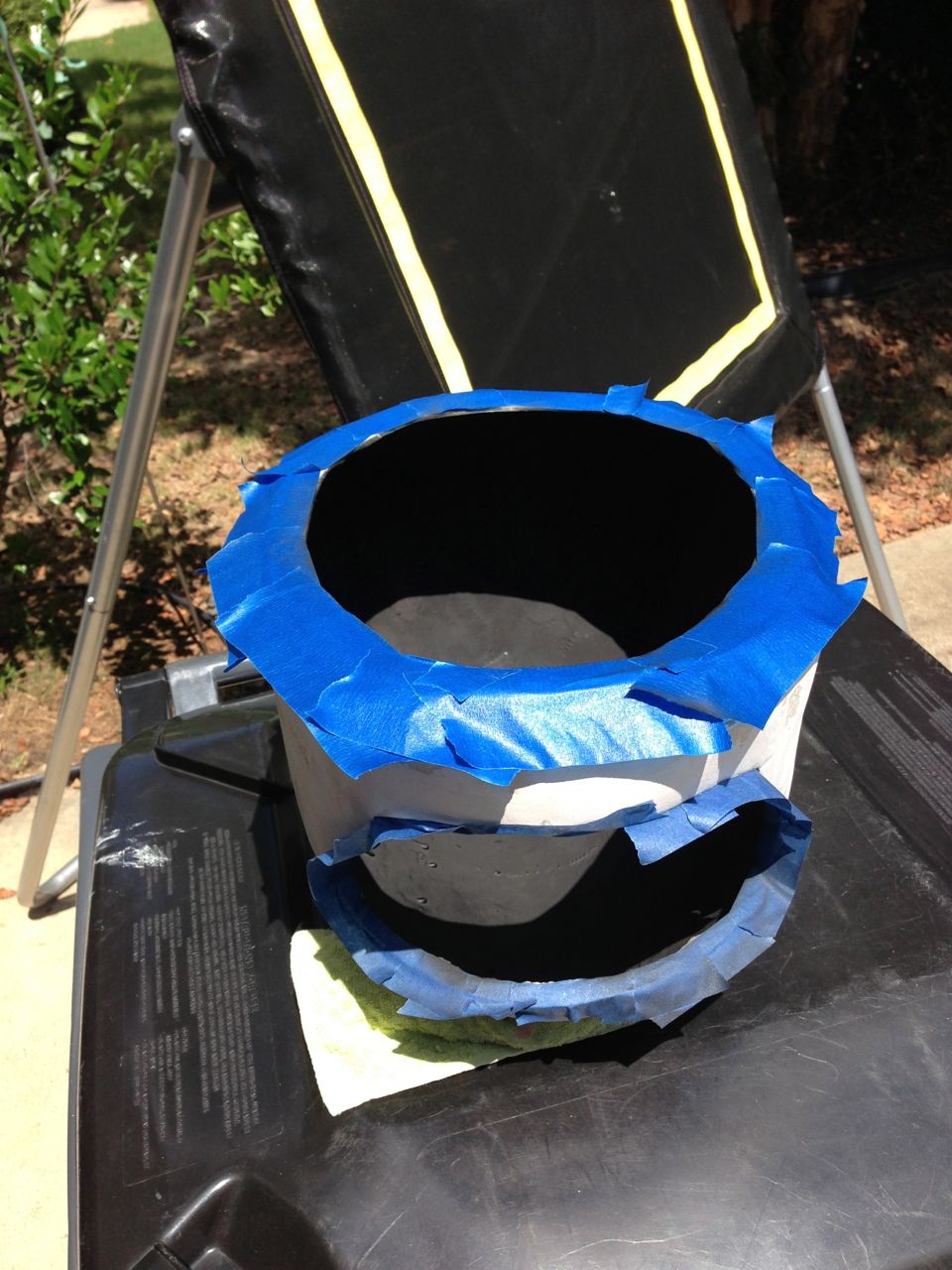

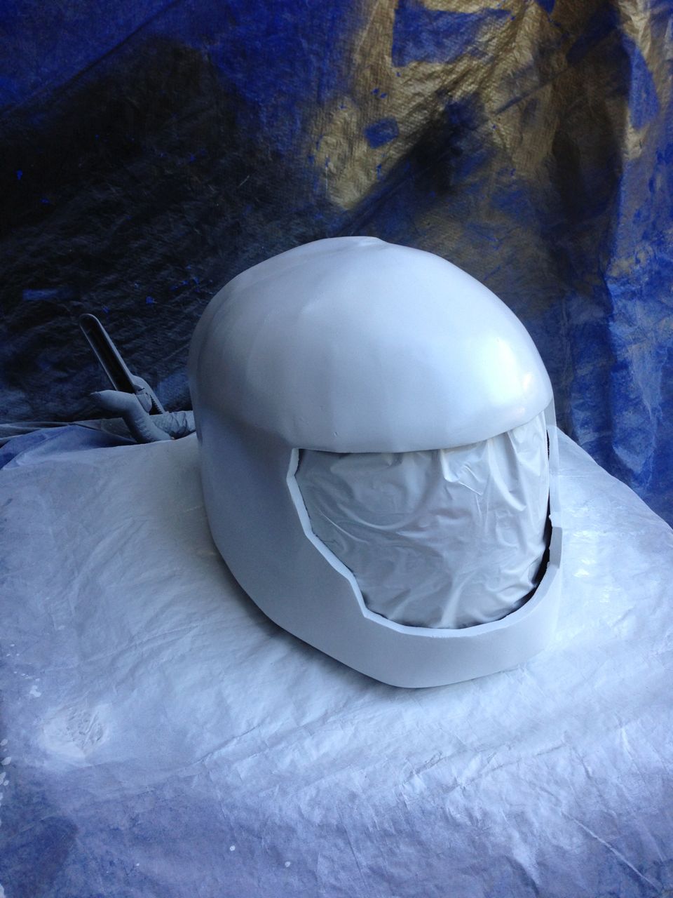

Once I had it "good enough" (DragonCon was looming closer and closer) It was time to paint. The inside of the helm got a Flat Black and the outside got Gloss White

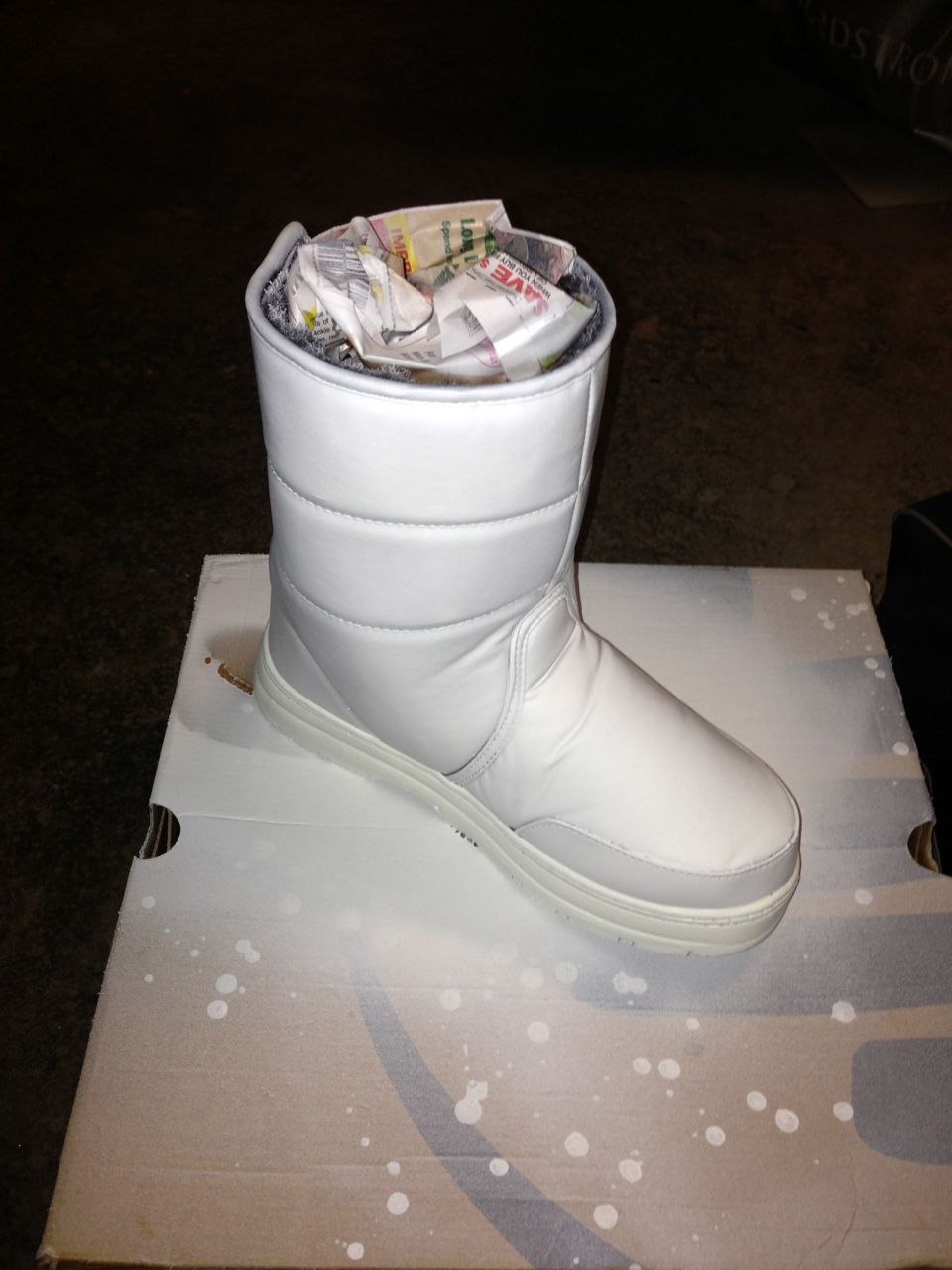

I ordered a pair of Kamik Men's Lunar Insulated Boots for $29.96 but they only came in Black. A few coats of White PlastiDip and they became perfect. My lovely wife Jessica helped with all the painting.

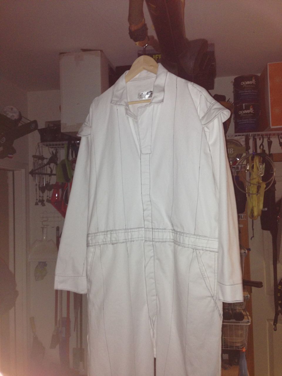

I didn't have the budget for the Sparco Formula-1 Racing Suit that they used in the episode so I searched for something that could pass for it with some modification. I found a candidate at All Seasons Uniforms Men's 100% Cotton White Coverall
Again, my lovely wife to the rescue. She removed the pockets and crafted up some shoulder pieces to mimic the suit used on screen. She then used Fine Tipped Sharpies to color all the thread lines and then add more in the open areas to match what we saw in the pics I found.

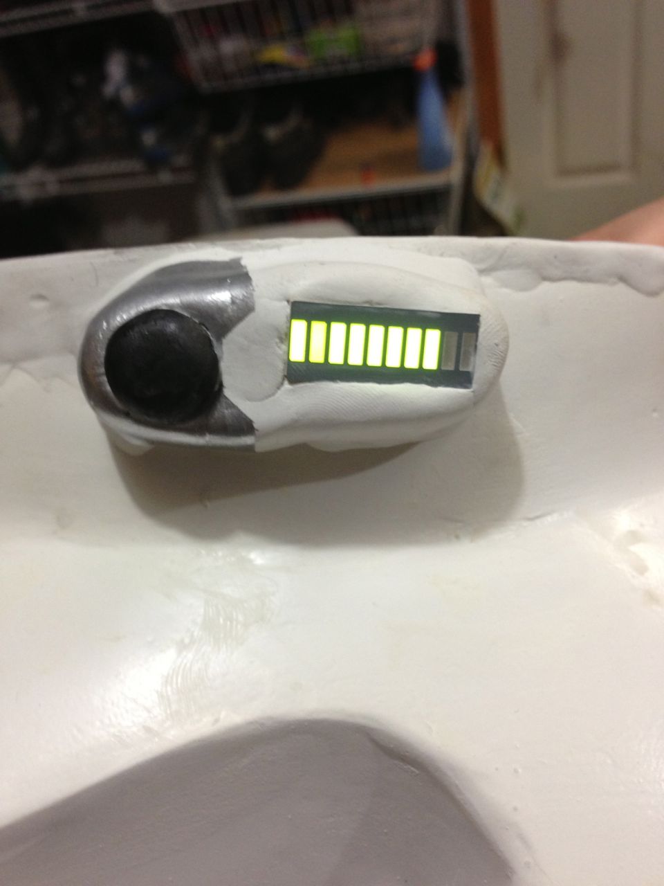

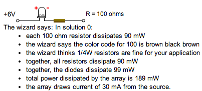

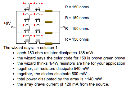

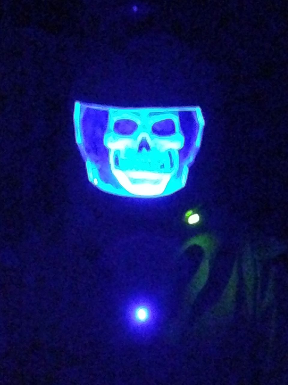

I had one blue LED (had one in my scrap pile) in the collar circle using 6V source and a 10 bar Green LED at the neck using a 9V source. *The Helmet used a 12V Blue LED flexible Bar*powered by an A23 12V battery.

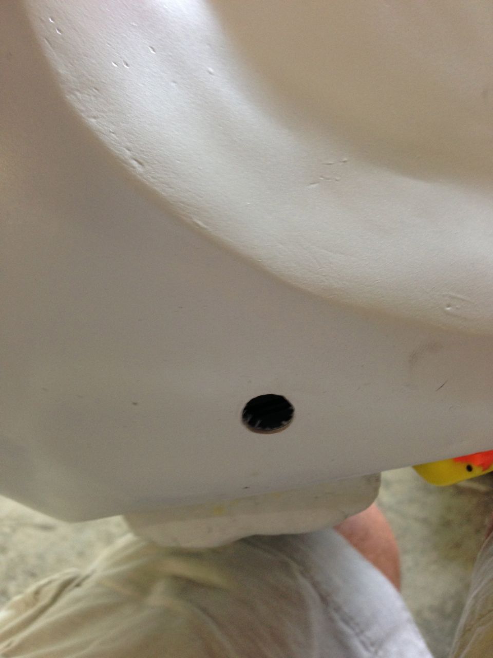

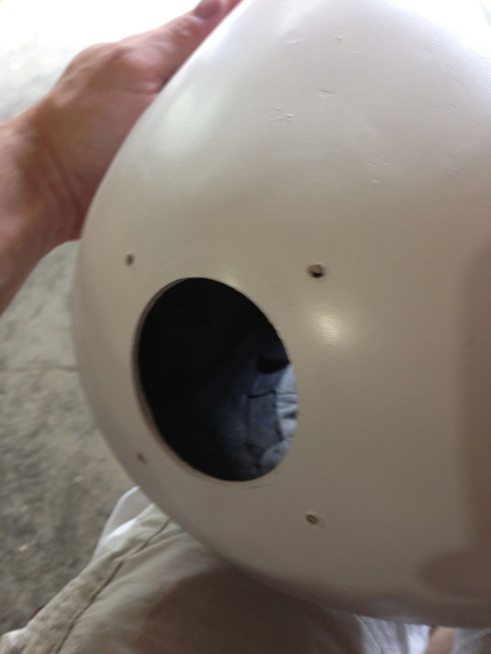

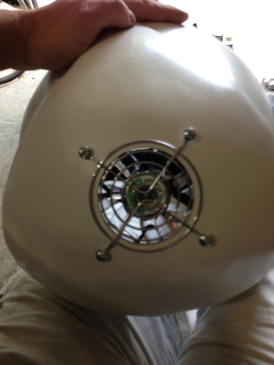

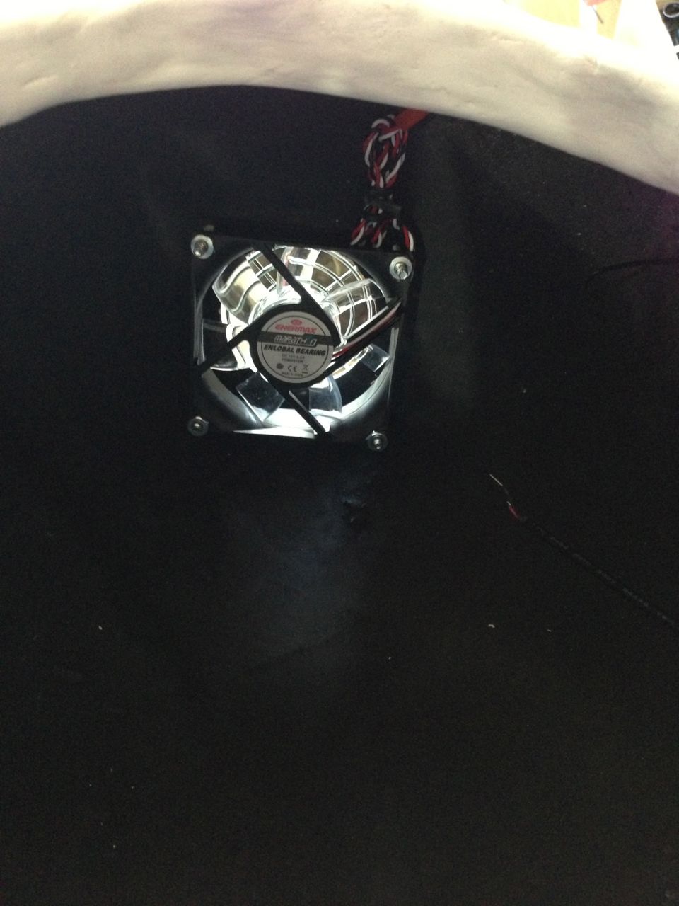

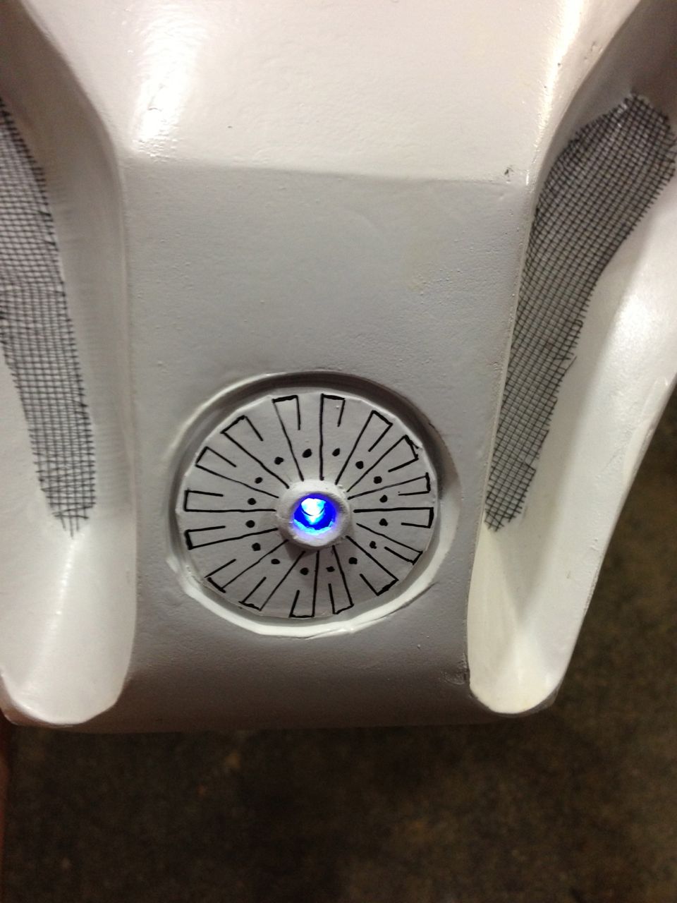

I used a dremel to make the small holes and a 2.5in hole saw to cut the fan opening. The fan was run off of a 9V battery (I REALLY need to investigate a better cooling solution) 9V on a 12V fan just kept the condensation from forming but did little to cool.

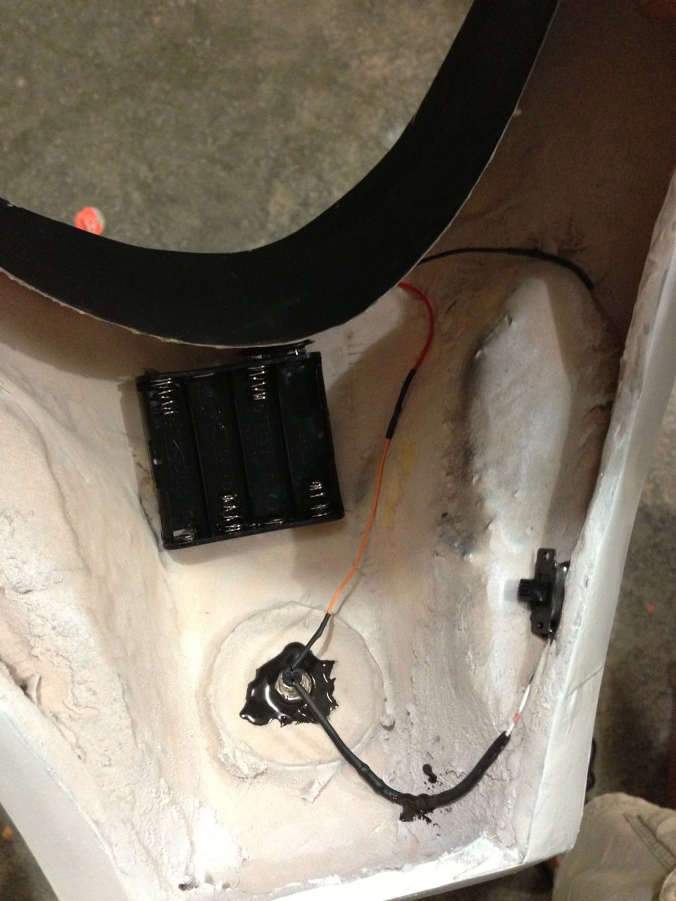

The Blue LED Bar light inside the helm for the face was just an A23 battery holder I hacked together and a switch on the outside of the helm to match the screen used helm.

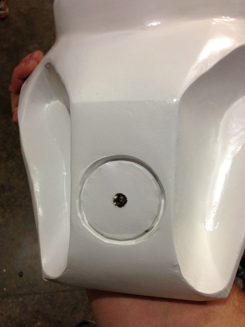

The Front Blue LED was cut into place with a dremel then wired up with a 6V source as indicated in the schematic above.
The Green Bar LED at the neck of the collar was switched with a micro switch inside the bottom of the collar and then held in place via Magic Sculpt. It was very last minute and done quickly. I'll definitely be using a dremel to clean this up and clean it up a bit.

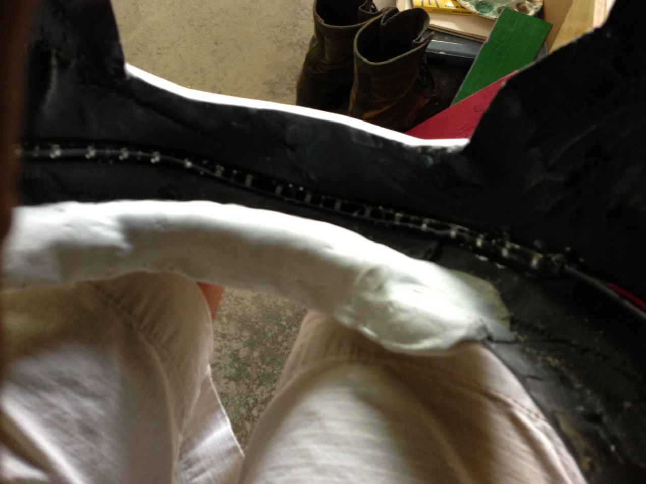

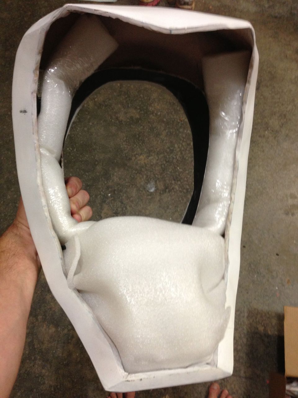

I didn't like the way the collar was sitting on me so I added some last minute foam padding to help it keep the Helmet more level to the ground
