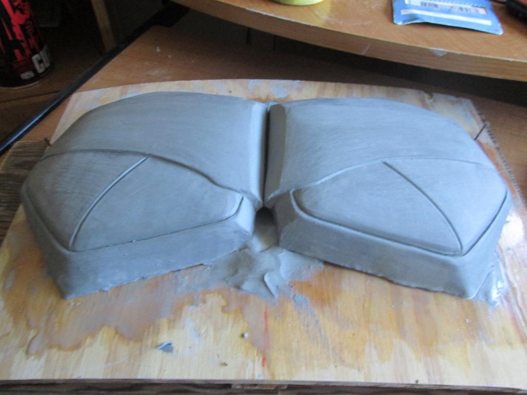

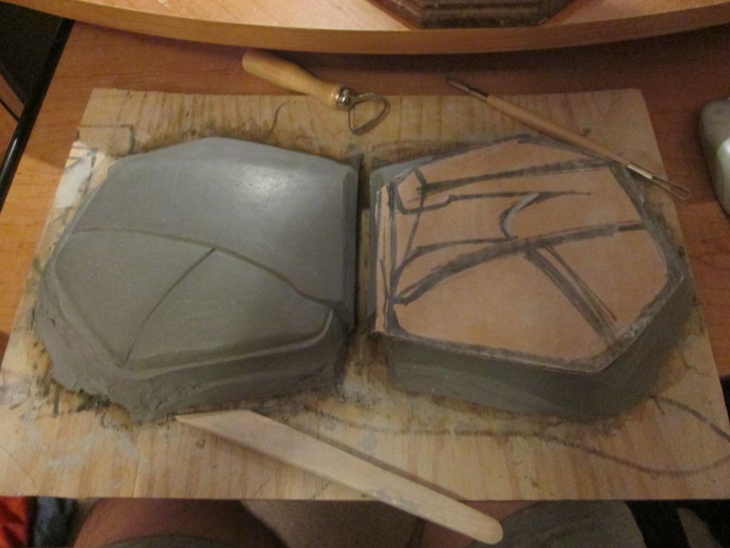

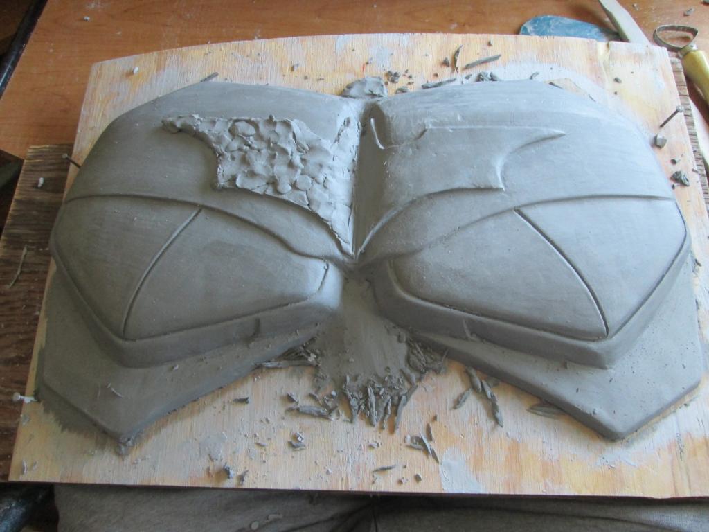

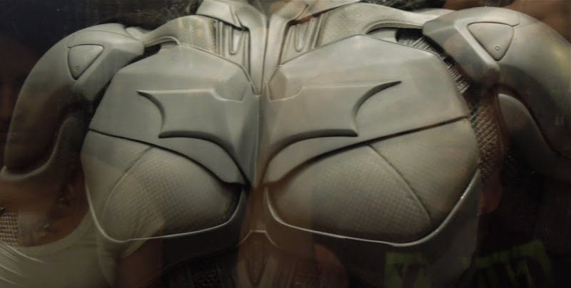

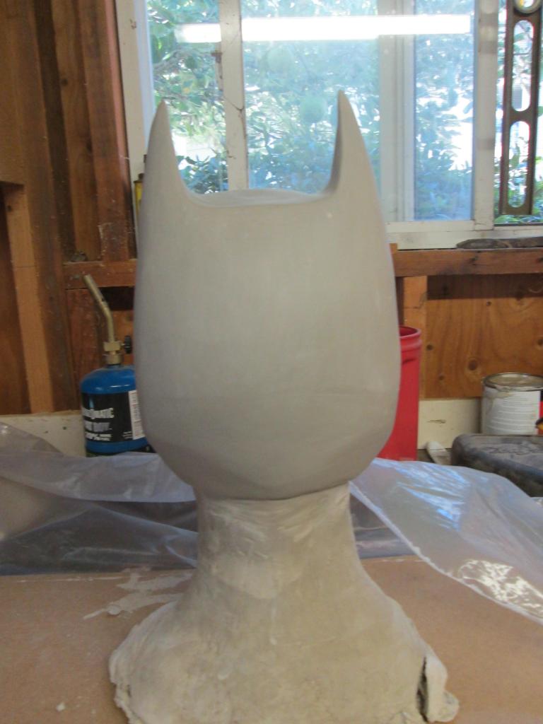

Here is the part I am working on now... The chest plate:
I wasn't really sure which way to go with this, I've seen people do carboard, foam, and I've also seen rubber casts available for purchase. I decided not to go with a rubber cast because it always seems to look kind of floppy. I also learned from an ironman helmet I am also working on that cured bondo is not fun to work with LOL. so I decided to shy away from a carboard one. In the end I decided to do another clay sculpt and attempt to make a fiberglass mold off of that which I will use to cast a fiberglass part. This should give me a nice hard chest plate in the exact form of my sculpt.

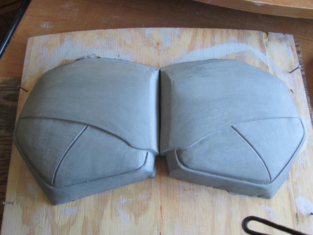

Right now I'm in the process of molding the chest plate so I should have pics of that up in a couple days! I think I am going to try and lay in some real carbon fiber for the lower inlays:

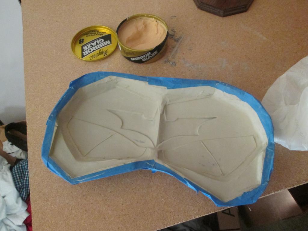

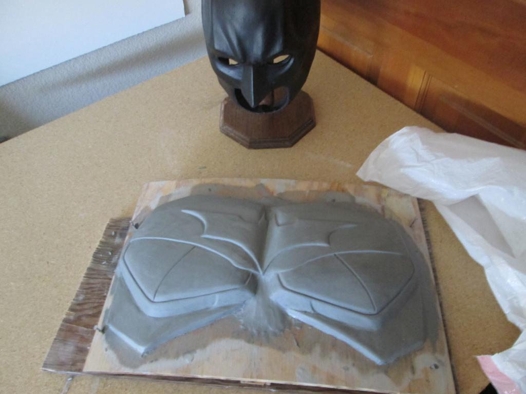

Ok so I got the mold made and I also made my first cast!
For the mold I made a pseudo gelcoat using rondo, brushed it over the sculpture, and then glassed over it for support.
Here is the first pull: Ideally I would have used a clear gelcoat which would have given me a perfect surface, but I didnt have any though, so there are a few air bubbles I will have to fill in. I do think the carbon fiber turned out really nice, It made all the work of making a mold worthwhile!

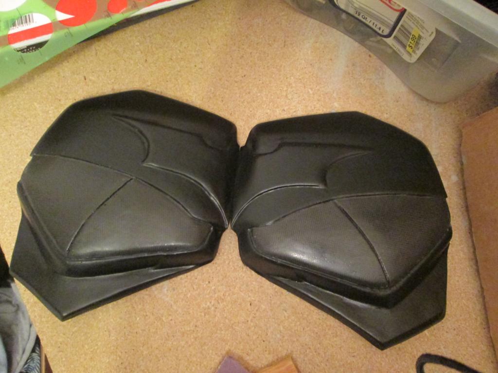

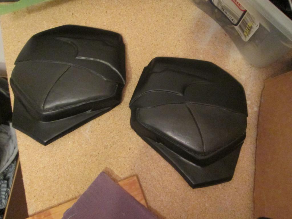

Re: TDK Full Batsuit Build [Pic Heavy]
Thanks!
I got the cast all trimmed up, filled, and painted: The cast was actually too stiff and flat to fit around my chest comfortably, so I cut the piece in half which I will later mount to some foam so that I still have hard plates, but it will be able to flex a bit in the middle.

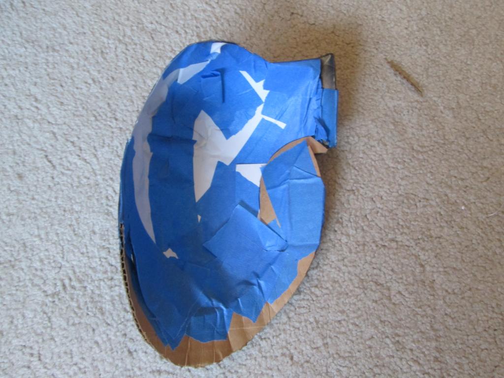

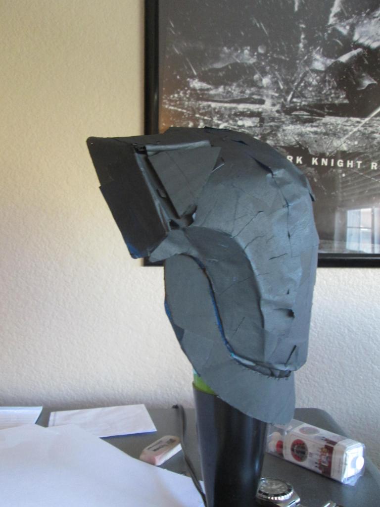

Started on the shoulders:
This is what i have so far, I tried some of the pepakura files available but I just dont like dealing with all the detail for something that is going to be covered in bondo, plus I was having issues with the sizing. So I built this up with paper, masking tape, and cardboard. I painted It black to get a good Idea of what the final product will look like. Later I am going to cut it up into templates, make the left and right shoulders, and then do the normal fiberglass, bondo, and painting.
