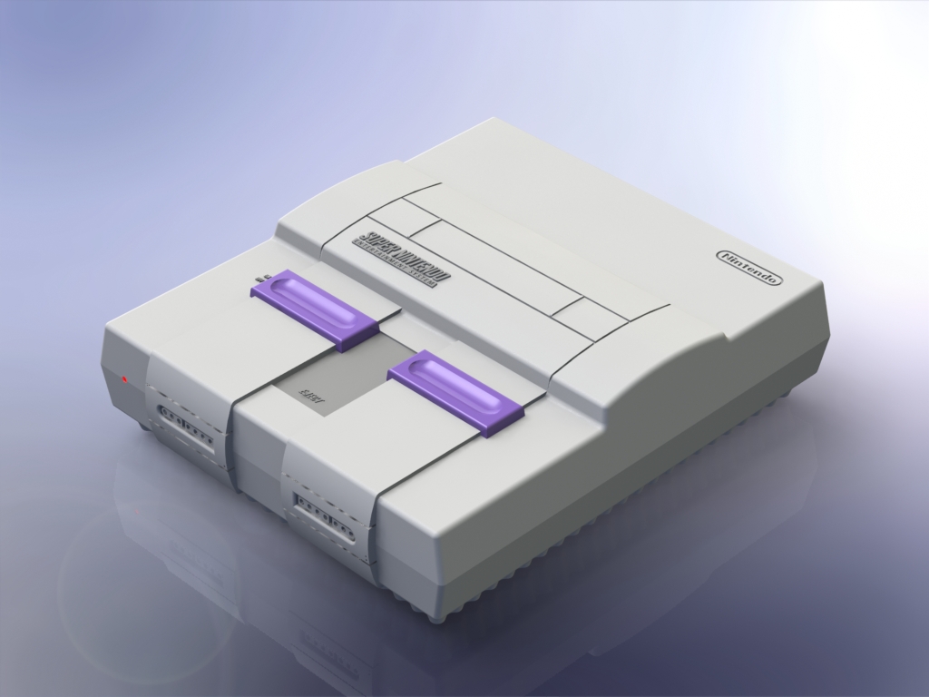

So my original project wasn't very successful. At the 1:10 scale, they just weren't strong enough to handle the assembly process, and the material was far too expensive for the size. So I'm trying my hand at re-modelling them all in SolidWorks much more accurately and printing them at 1:5 scale instead of 1:10 scale, in a less expensive, more durable material. I've already ordered a print of the first console I re-designed - here's a render of the good old NES, with materials!
The model is in 4 parts (top of case, bottom of case, front black detail section and rear black detail section. They're designed separate to make assembly and painting easier, and to allow the main model to be hollow and cut back on printing costs. No glue should be needed, as the parts are designed to fit snug into place, but I'll know for sure when I get my first order.
Very cool. 1:10 was so small!
WAY too small. I was really just pushing the limits of how small I could make them, and since the material I printed them in was pretty pricey, I wanted to cut back on material costs. This size should be perfect for both the material and ease of finishing.
Just finished another model - Super Nintendo!
