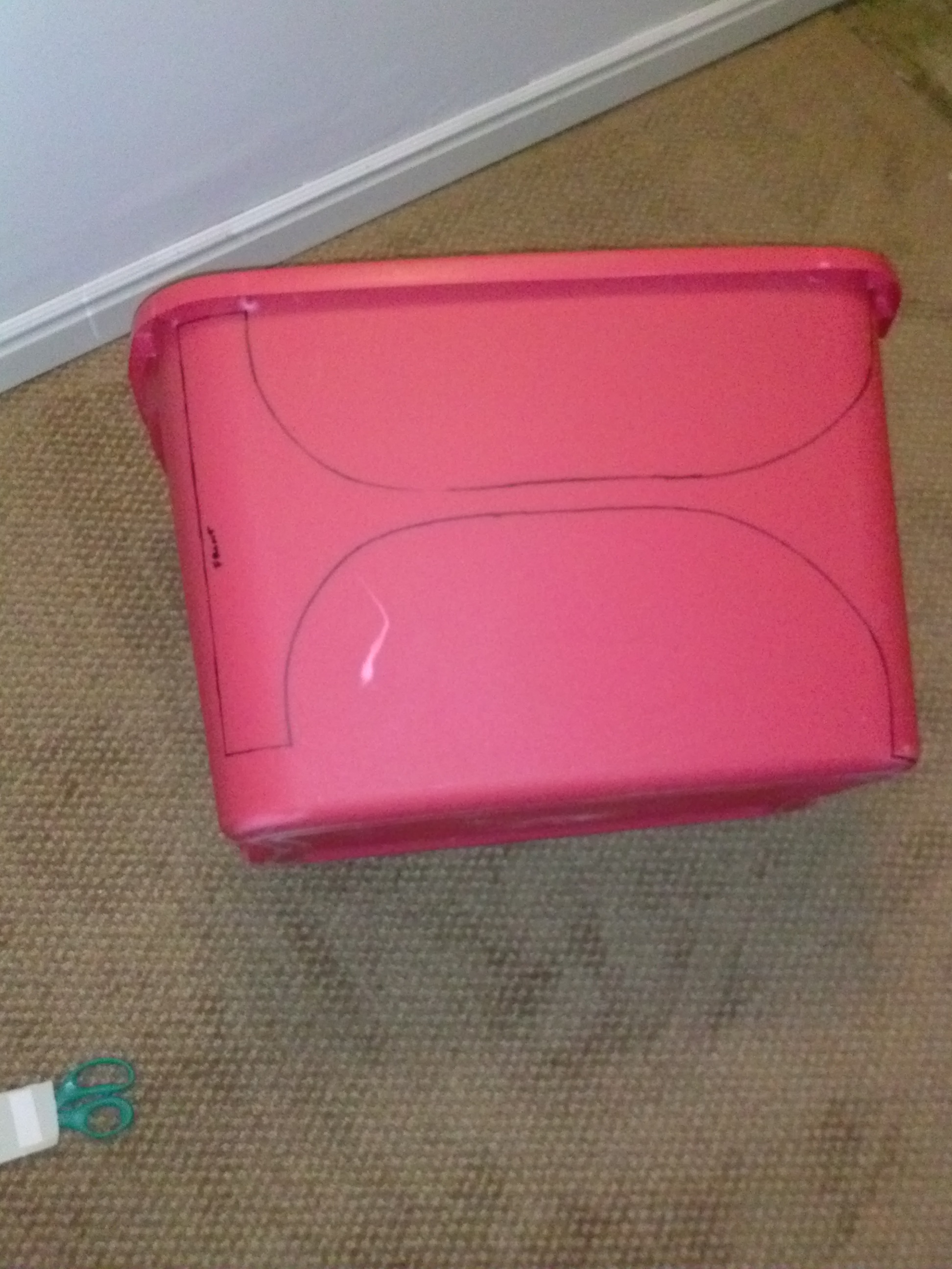

Here is what we cut our plastic pieces from. As you can see, I have traced what her cod (aka underwear) will look like. Once I cut it out, I placed it into the oven for about 1-2 min and then removed it, shaped it to fit my wife, and then ran cold water over it so that it would retain the new shape.

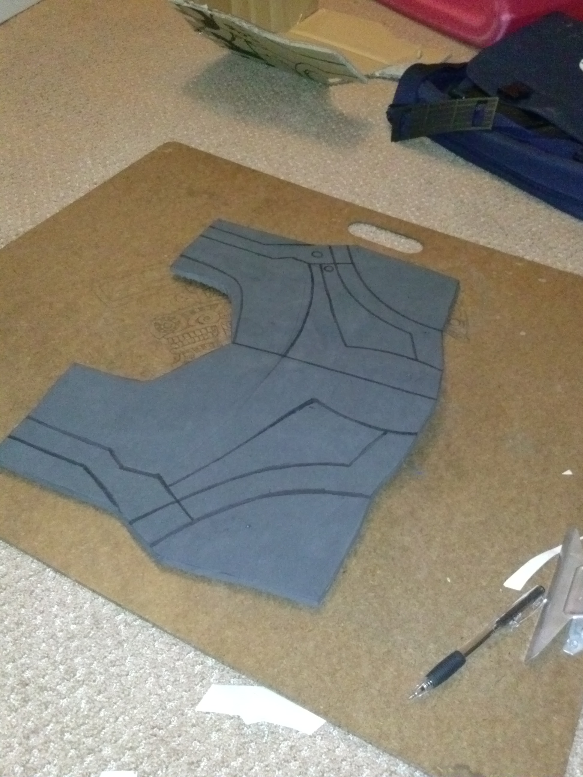

Here is what the chest piece was looking like when I first started to put it together.

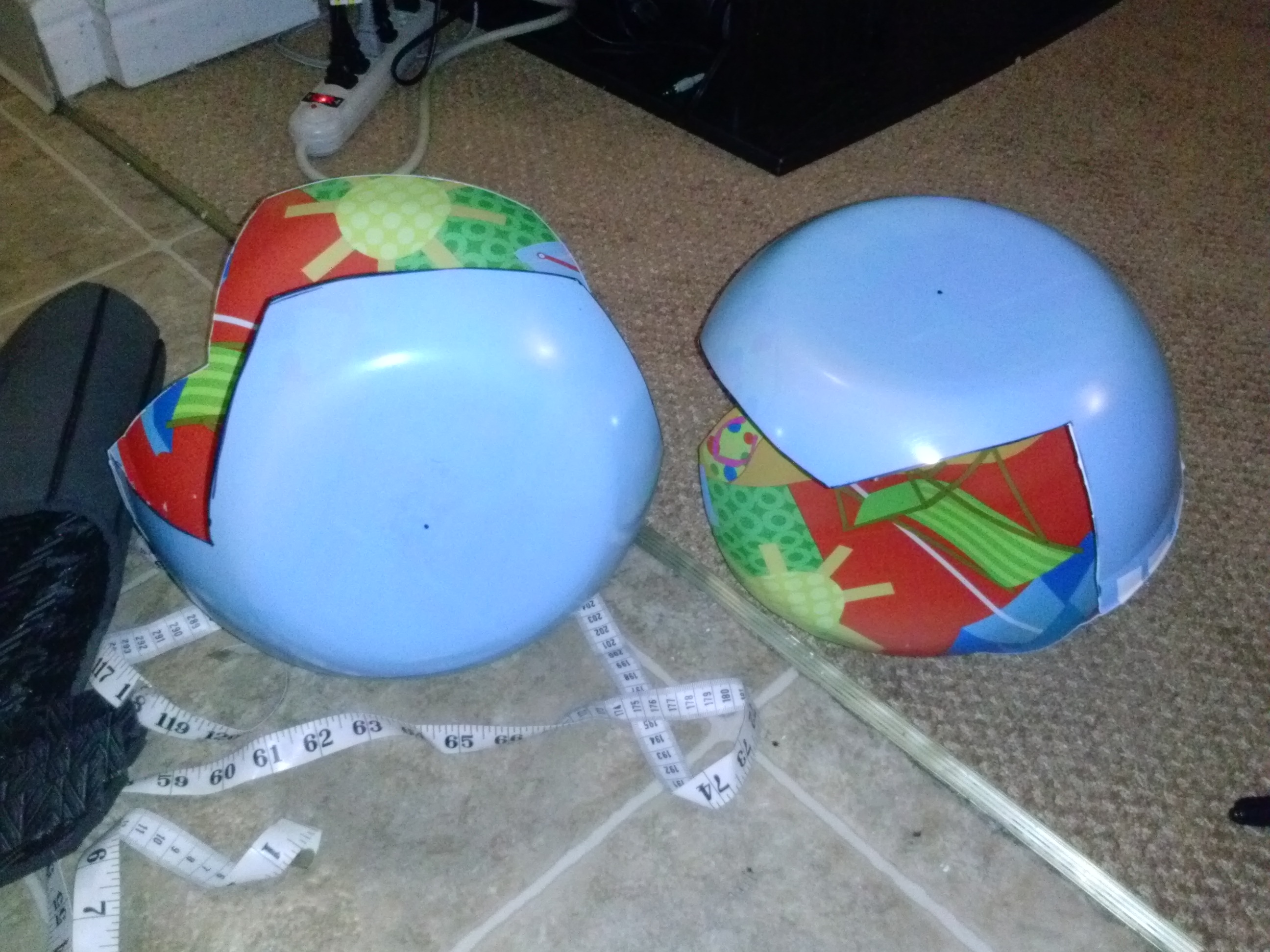

Here are the shoulder pieces (paldrons?). They cheapest thing available, aside from paper mache (which, as you can see, we also attempted but failed at), were these plastic bowls from Dollar Tree. Once we cut them a bit, they turned out to be just what we needed.

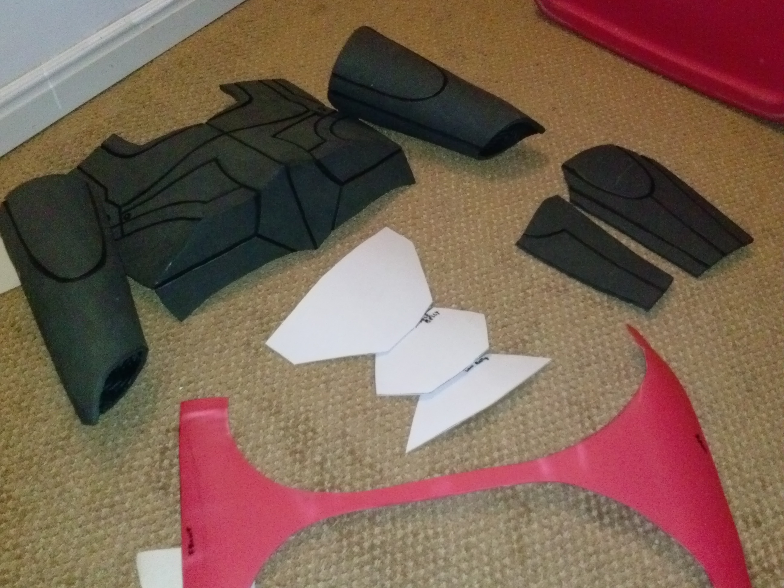

Here is another picture of the chest piece (upper and lower), both upper arms, lower left arm (not yet assembled), belly plates, and plastic undies.
I know there should be some Papercraft files floating around the net if you want better references for the suit, but so far its looking good.

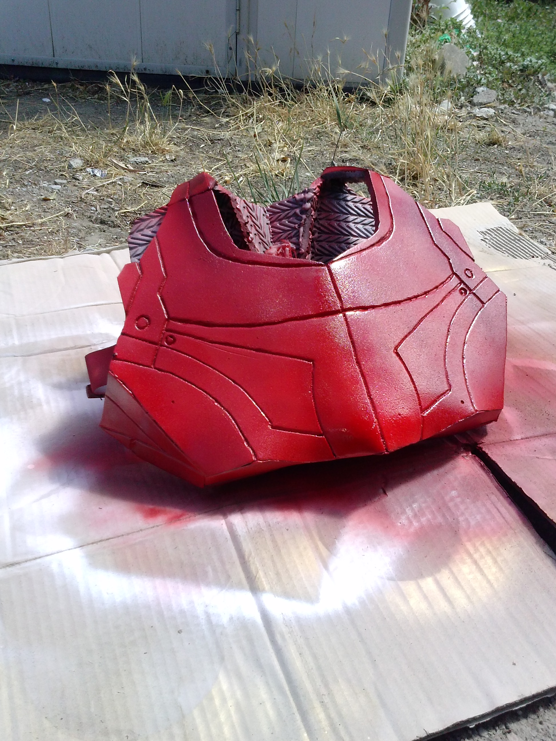

After plastidipping the foam, we sprayed a white enamel spray paint over the foam so that the colors we chose for the suit wouldn't come out dark as a result of the gray foam.
Here is what the upper-back was looking like while we were spray painting it.

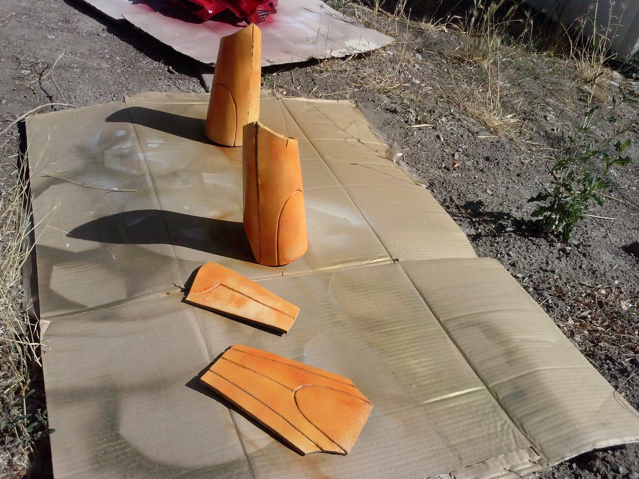

Here is the first coat of orange that we used on the arms. (For some reason the orange came out blotchy :( .)

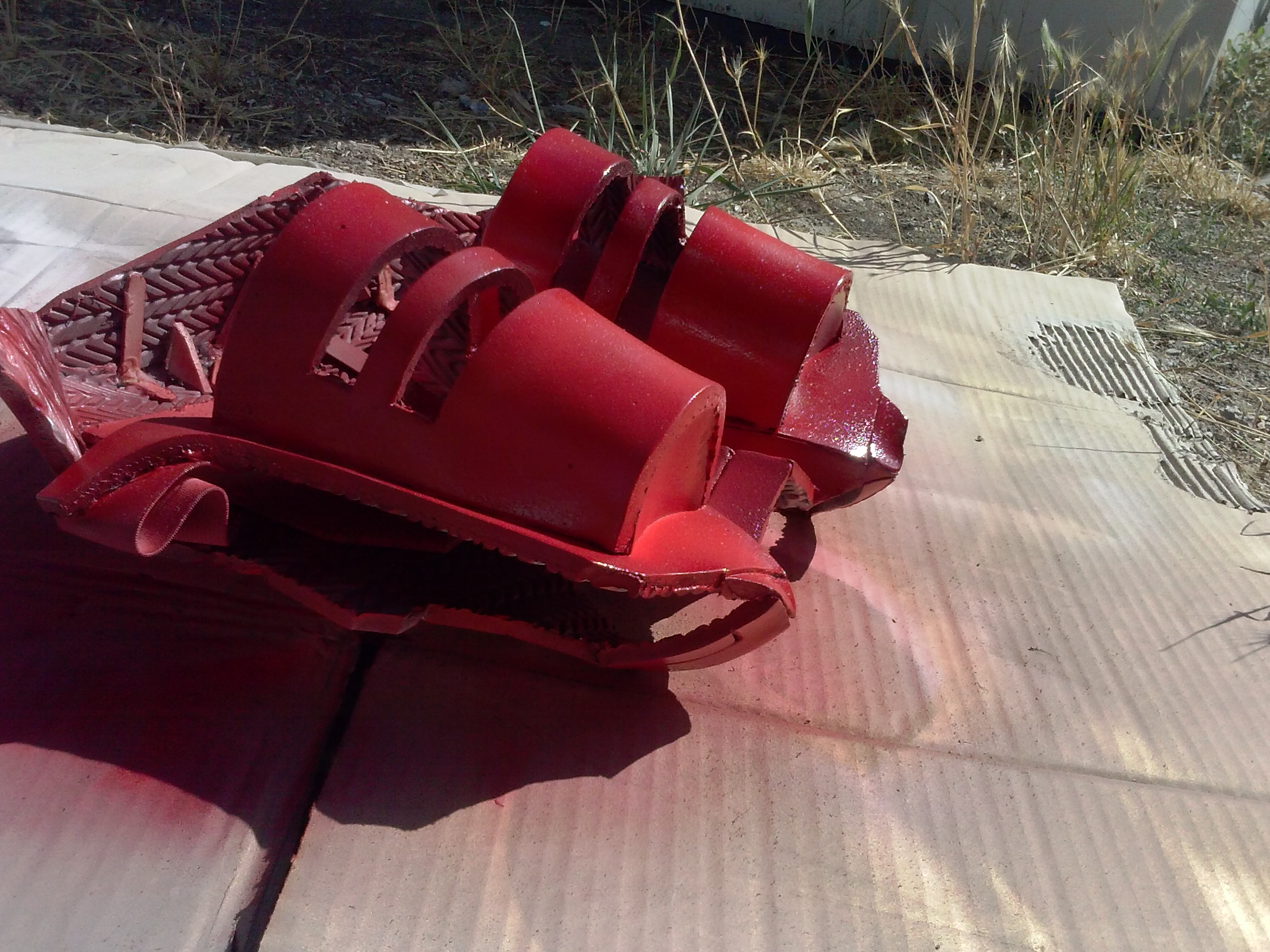

Here is a layout of the various aerosols we used. We started with a coat of plastidip ($5.00), then white enamel ($1.00), then either gold ($3.50), red ($8.50), or orange ($8.40) depending on the piece.
Here is the front of the chest while we were painting it.
Here is the side of the chest while we were painting it.

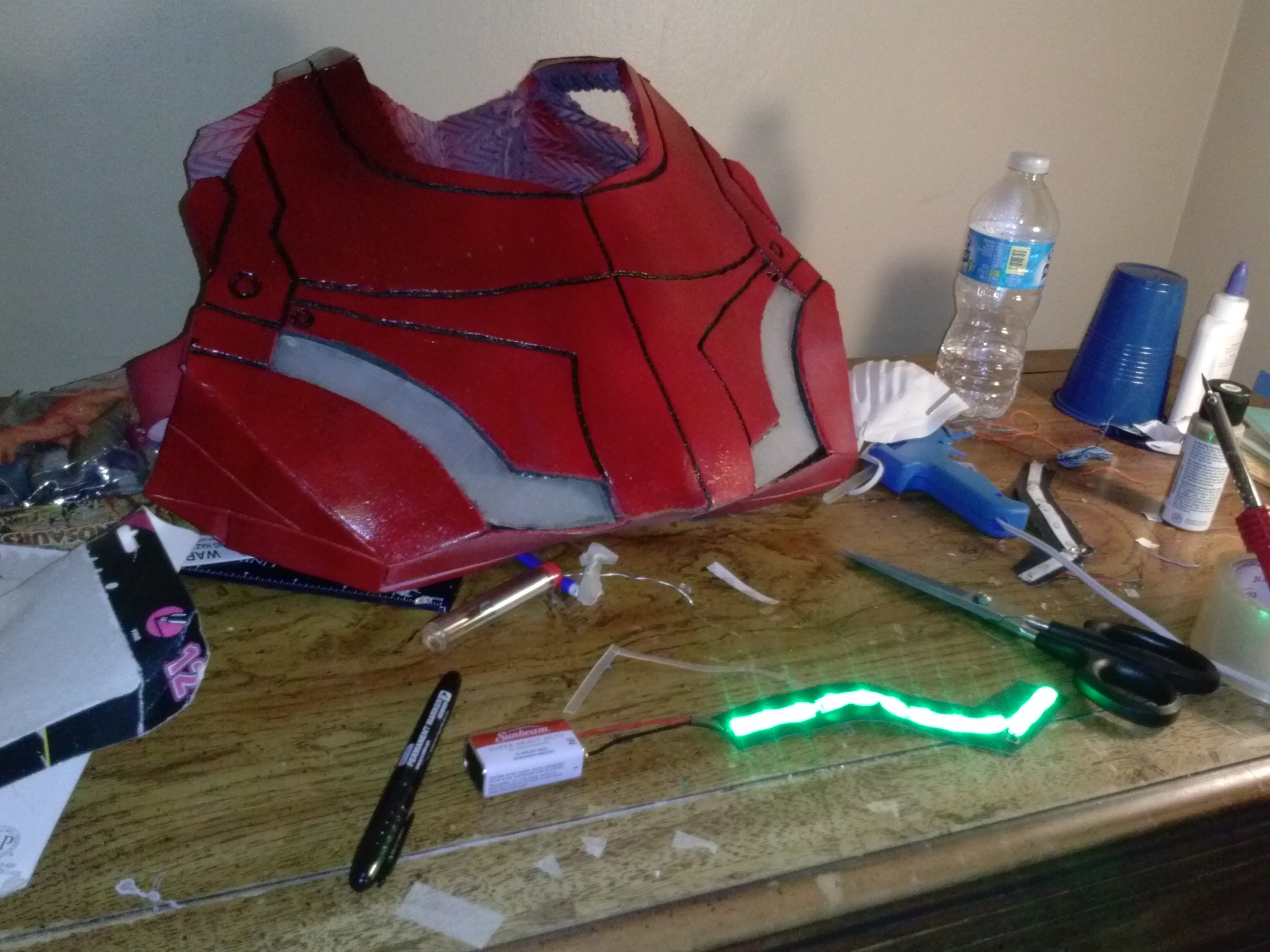

Here is what the chest looked like once I cut the holes out for the green lights to go into.
Here is what one side of the light fixture looks like that I will place into the chest. We bought a few yards of green led strips. They are nice because we can use them in the chest, helmet, and shoulders :).

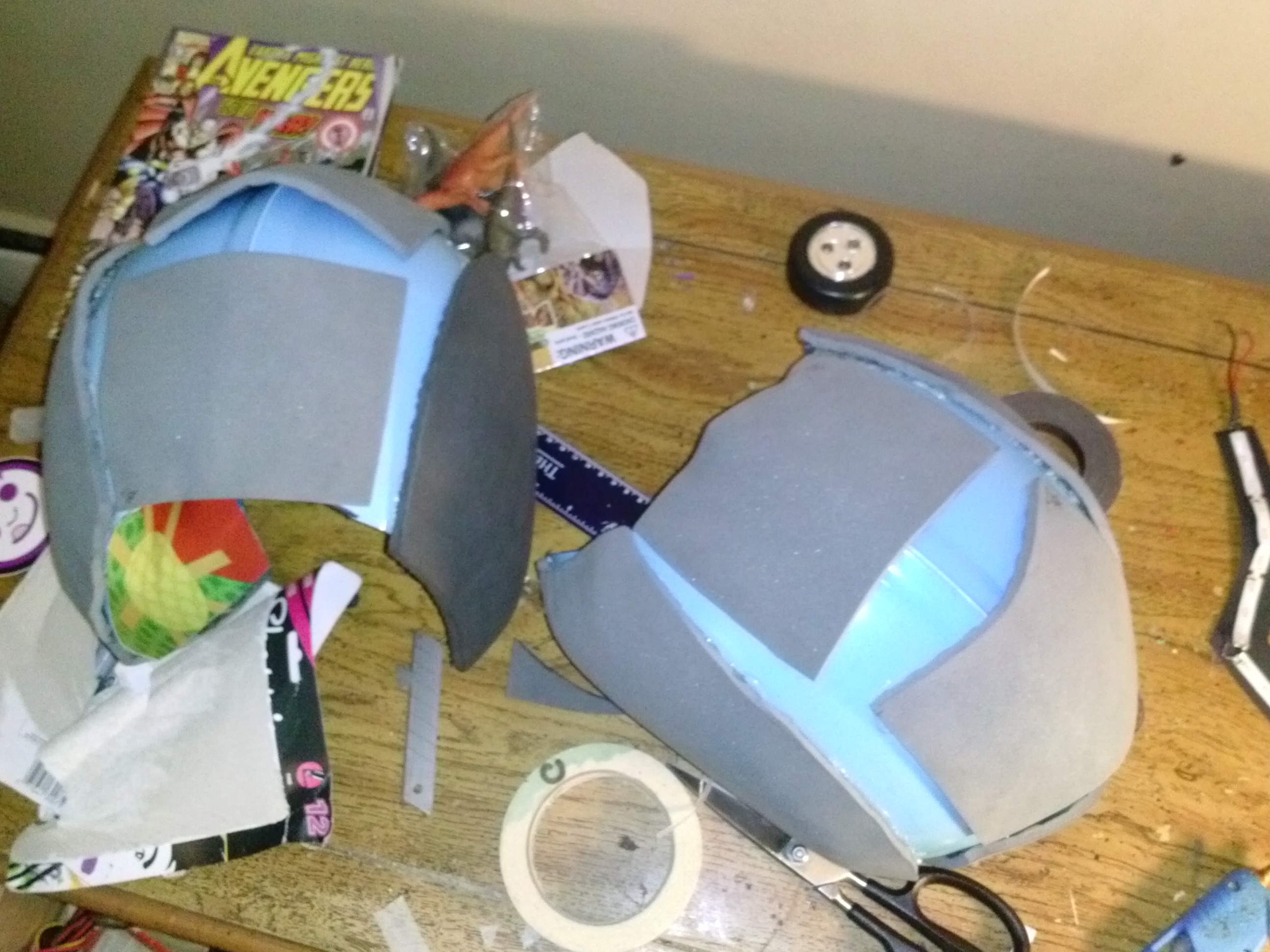

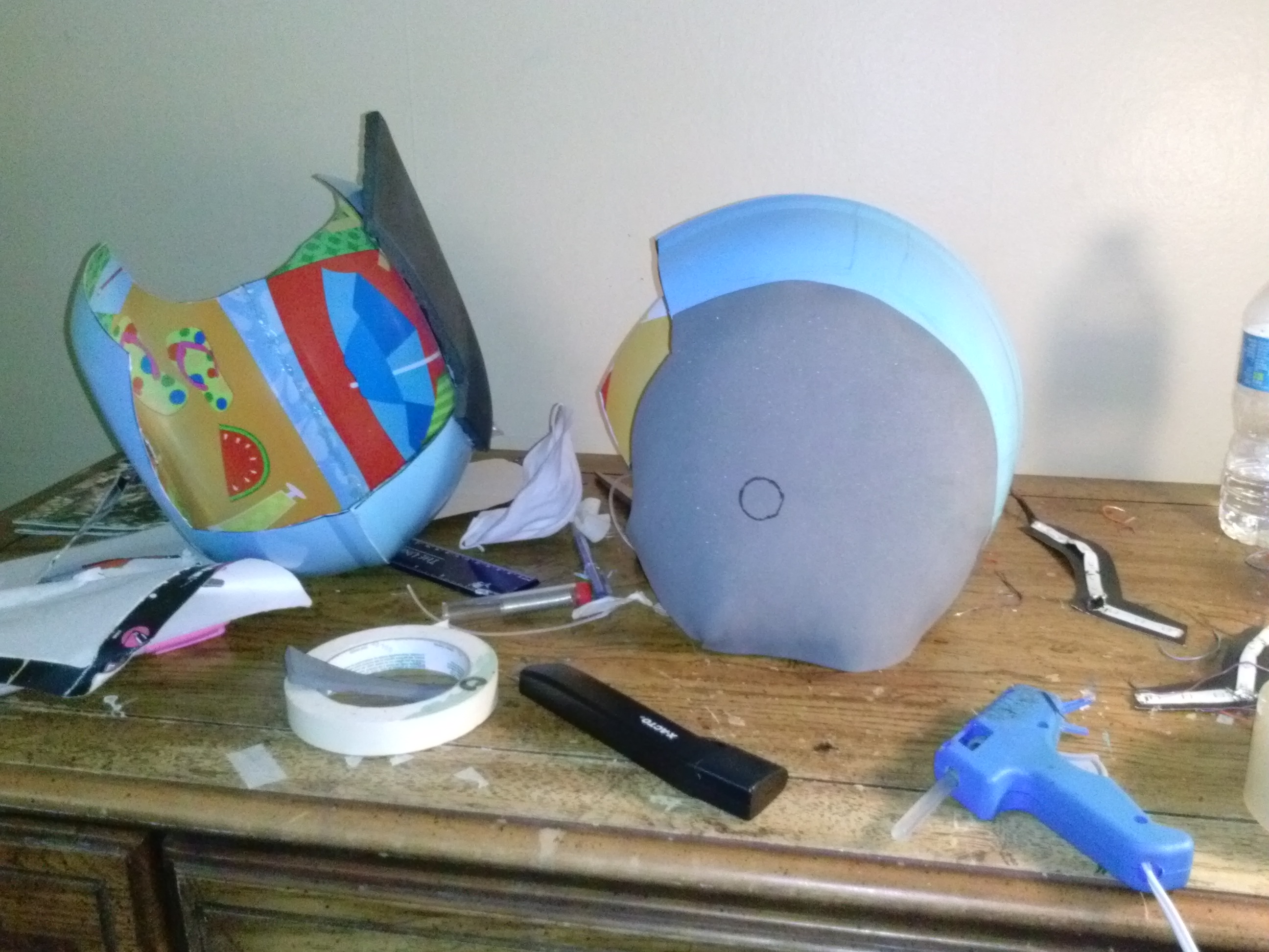

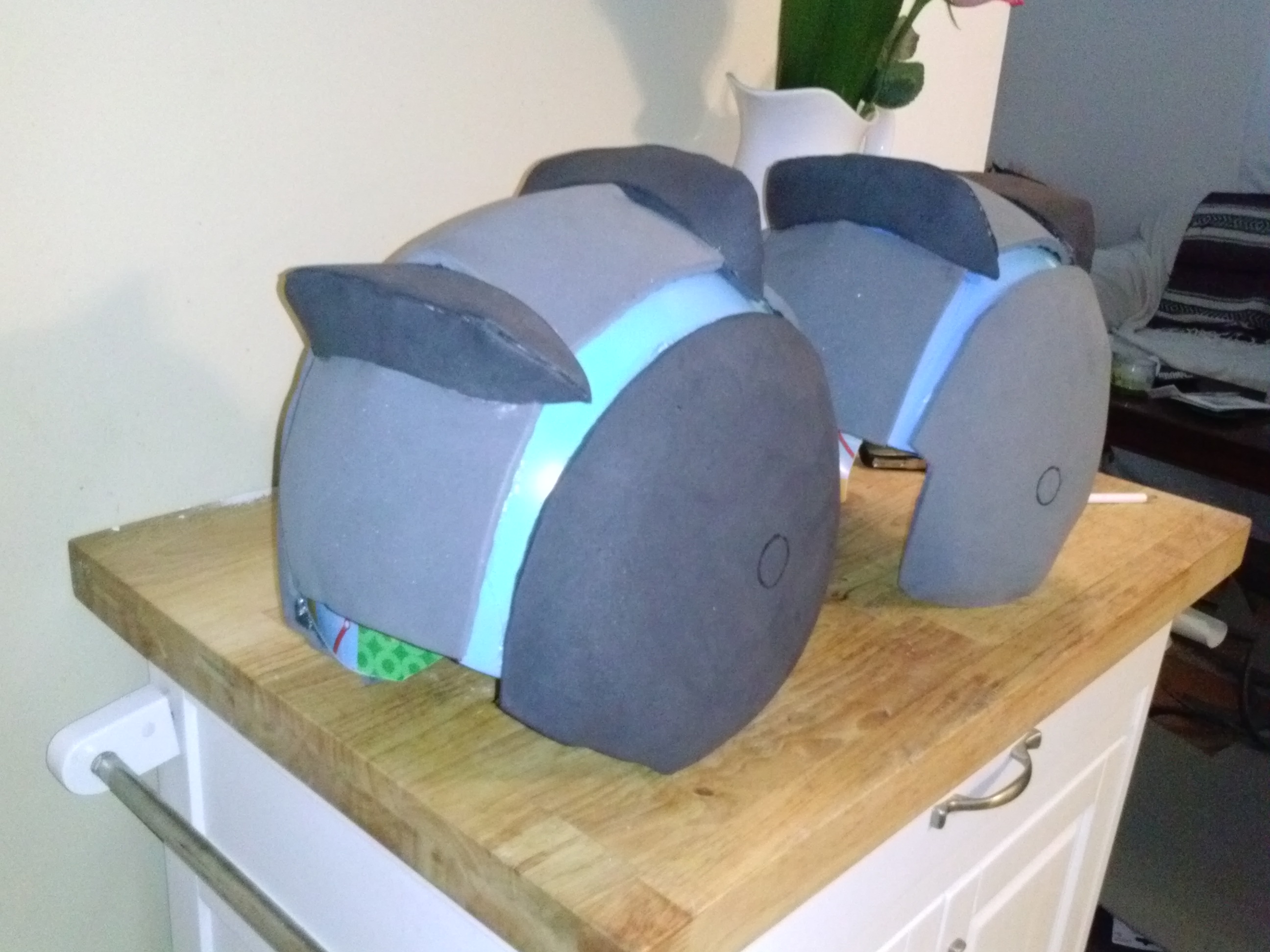

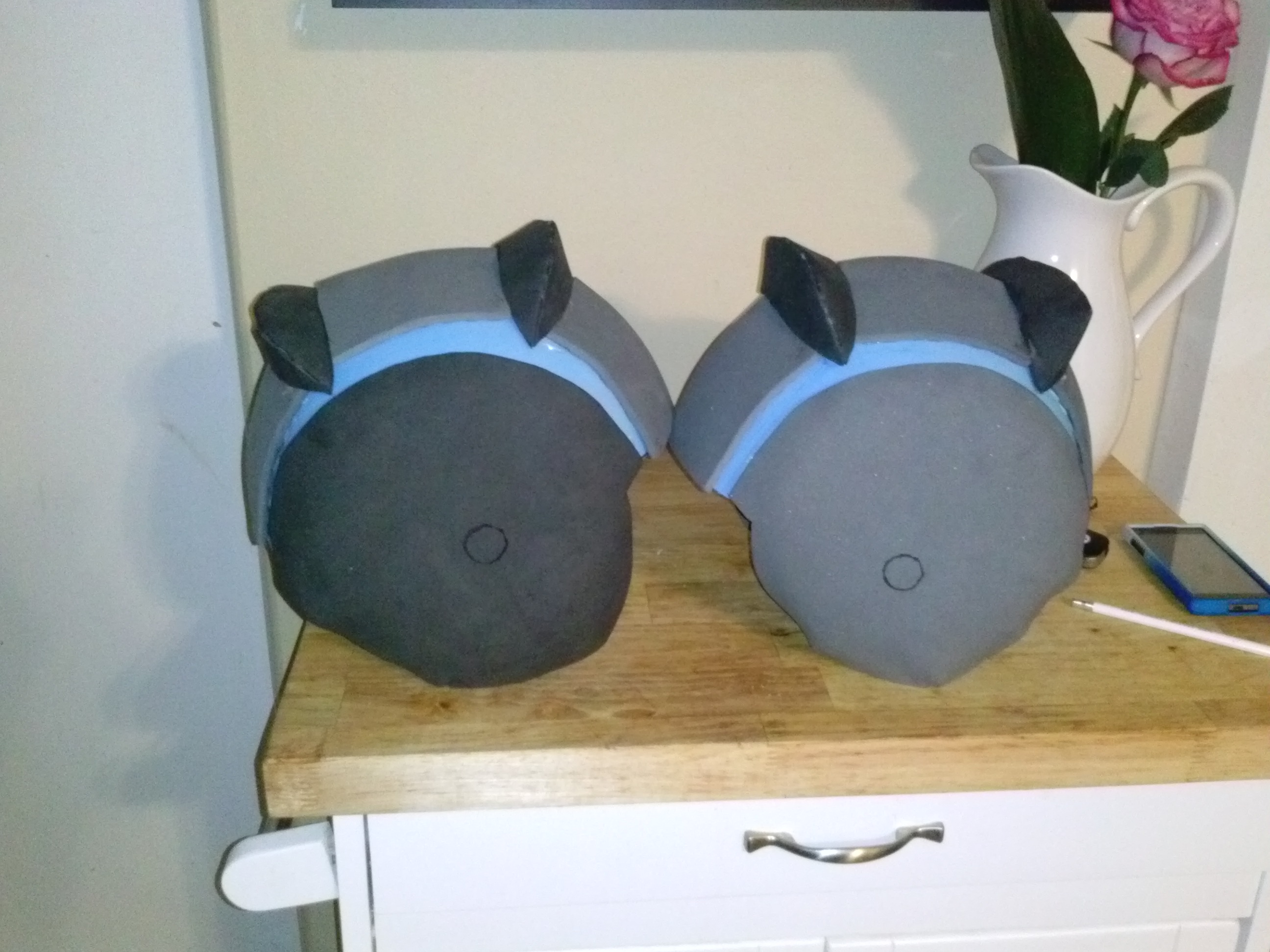

Okay, so I have a lot of photos of the shoulders. These, for me, were extremely tricky (especially because I am not using any templates). We glued two $1.00 bowls from Dollar Tree together and then started to cut pieces of foam to put on top of it. It was difficult because we had to find the right size bowls, cut the foam so that it was flush and round on top of the bowls... and yeah, basically that was why it was so hard lol.
So, in this photo I have the front foam piece glued onto both shoulders.
This photo shows what placing the rectangular foam pieces onto the top of the shoulders looks like once the front and back foam pieces have been attached.

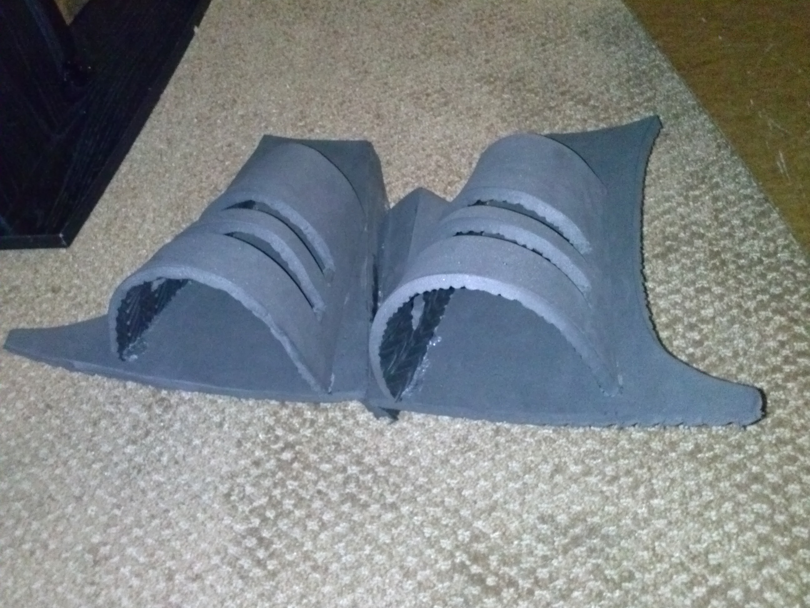

Here, all three rectangular foam pieces are attached to the tops of the shoulders.
This picture shows the spacing for those three rectangles.
Here are the mostly finished shoulder pieces.
And this is a side shot of the shoulders.
