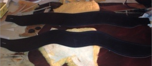

I drafted an angled-tapered belt pattern several times. The first image I posted in this thread is a pic of the first draft I did.
The later final draft is a pic of this belt. [the bottom one]
Because this bottom one was my version of an angled-tapered belt, I redrafted one more pattern to be more accurate to V's. It'd be the top belt shown.
It looks a lot like the DC Direct 1/6th scale figure belt below because after looking at several photos and screen captures, V's belt was more simple looking than the belt I did.
The DC figure belt is not angled enough as V's though so I made my other final draft more angled.
I just eyeballed the angles according to how it would best look on my body. As you can see in the photo, I made red and blue lines. The pic may not best show it but the top belt is 3.5"/approximately 9cm wide at a 90 degree angle from the edge of the belt. The bottom belt is 3.5"/approximately 9cm wide straight up&down from edge to edge. If you were to look at several photos, you would see that the length of the belt buckle fits the width of the belt. So that is how I got the 3.5"

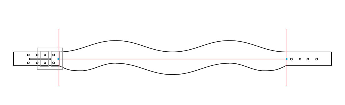

[strike]Anyway, here is an illustration I did, to hopefully get you an idea of how to do your belt. Its just an illustration.[/strike]
[strike]Those red lines indicate the point where your belt will no longer fit through the buckle. When I drafted my pattern, the length between the blue dots (which is where you should measure from) was 33in./approx.84cm, 1 inch less than my hip size. When I measure the length of my standard every day belt I use from the buckle wrap end to the hole I mainly have the buckle fastened through, it is 34in./86.5cm.
Here is an image to give you that idea of how to measure your standard belts. (top illustration-optimum measurement)[/strike]
[strike]When I measure the length in my V belt that same way, its the same length as my standard belt fastened length. 34in.[/strike]
UPDATED info regarding sizing:
What I had here before is incorrect.
I wish I could help you out more. I had wanted to make a "master" downloadable scanned file where I would show how to modify for larger/smaller sizes but my final draft patterns are worn out and I don't have time to redo them or scan my belt, hence why I also have not done anything concerning the dagger holders. :unsure
I will do it eventually as I plan on providing all my drafts and files for download once I'm done with this costume, but if you wanna get it done soon, it helps if you have at least 3 daggers and simply place them angled on your side in the way you think looks best on your body. Look at how they are on V's body. Then look at your own body to see what you have to work with. That is how I worked out my belt drafts. So cut yourself a strip of paper with a width of 3.5in/8.9cm.. Hold your daggers at an angle and slip the strip underneath. Then work out the curves. V's belt is not as complex as everyone originally thought it was.
This helps, I think I know how to measure the belt now, will do a drawing first like yours with my size and place it here so you guys can give an opinion.

Yeah. Just get your belt size. Divide it by 4. You only really need to work on 2 sides. Then just mirror the result for your full length belt. Eyeball the angles out.

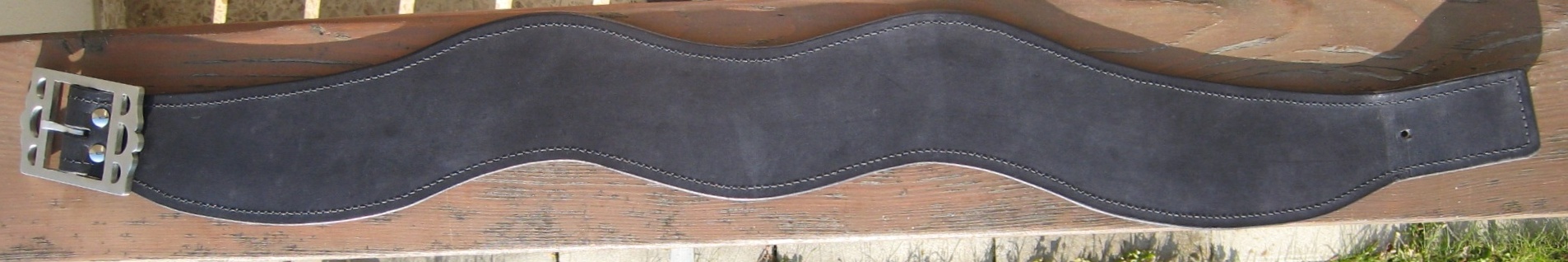

Anyhow, this is my belt:
I like to think of it as the girly version with all its curves :)
Your belt is darker than it looks, right? :wacko
and you should make the 'decoration' hole at the center of the buckle once the belt is fastened.
Oh yeah, absolutely. I've been waiting for a sunny day to make a picture and it was too sunny apparently :D
Dunno about the extra hole. I mean, I know that it's present in the original but I'm not sure I like it...

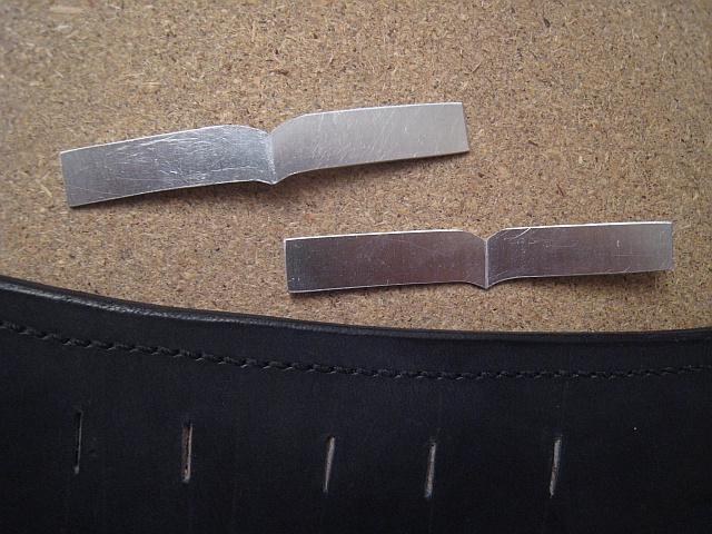

I inserted the holders into my belt yesterday :)
I bent the alu holders in the middle first, then cut the holes in the belt with a scalpel.
The thick leather keeps the holders in place nicely so I didn't need rivets.
You can see that I couldn't get the holders to be neat and flat on the inside but it doesn't really matter in my case.
I also buffed the holders in the end to make alu look shiny.
So I guess this project isn't a WIP anymore :)
I realized just now you went through both layers. Wow. I guess that did work out real well! Anyway, again, well done! :)
