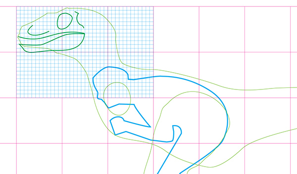

First, we took photos of myself standing (for scale) and then crouching in the suit's necessary position. I used several overlays to come up with a template for my suit over my measurements, and set off to work!

Once I had my solid block, I mapped out the 1:1 grid from my template and copied my dino silhouette to the block:
I ended up angling my dinosaur within the block to get the most out of the foam form. The angled line going down from the hip to the chest is "level."

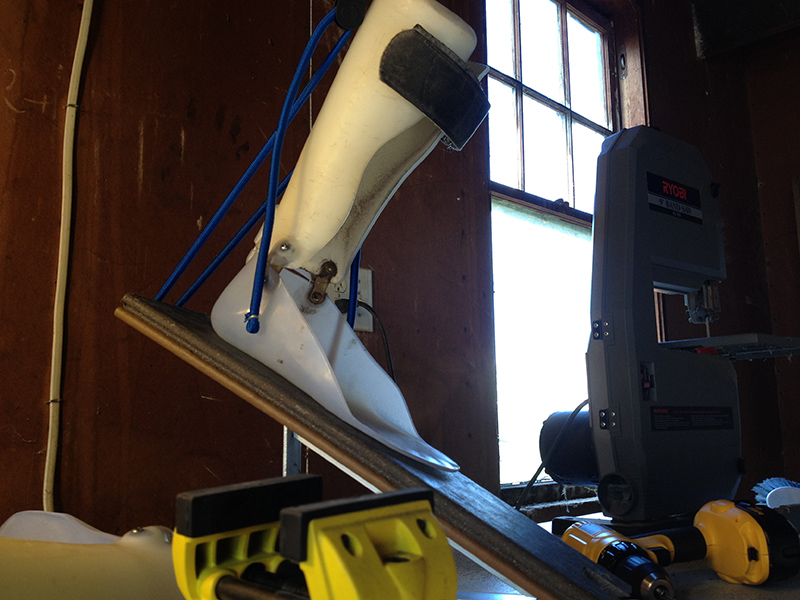

I'm about to go brave the triple-digit temps and get some more work in on him! In the meantime, here's a quick peek at the prototype digitigrade stilts in progress - I hope to be able to wear them with the suit for at least short bits of time:
They've actually come a ways since that shot. If I just can't manage them with the suit, the length of the legs should work with a lesser heel/costume boot - but these would be awesome.

Do you build orthotics/prosthetics? Just asking based on the articulating AFO in one of your pictures. I build prosthetic legs for a living.
I don't - I actually purchased those off of eBay to incorporate into the stilts. Interesting work though! What would you charge to custom make a pair like that? what material is the white plastic, most likely?

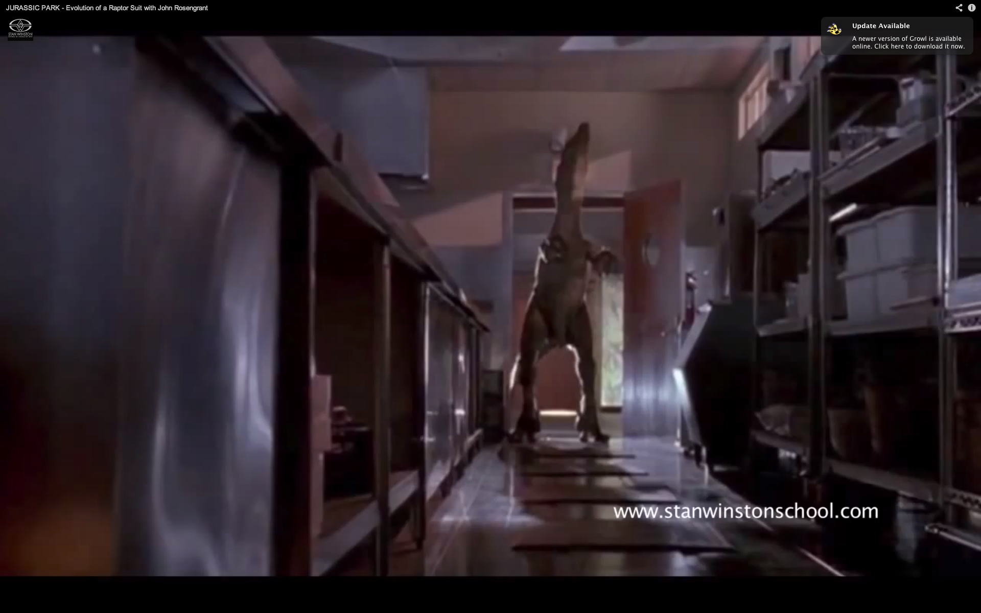

John Rosengrant said he was good for about half an hour in the suit. I'll need it for much shorter amounts of time than that. Its first appearance will be a sort of petting zoo environment, and after that it will hopefully make a brief appearance on a sort of ride as wagons come through. Also, the suit will be engineered to take as much weight off your back as possible. I'm hoping to hinge the whole thing and balance it at the waist.
Besides - you can always stand up straight to give yourself a rest when you need to! This is a costume in JP1:
