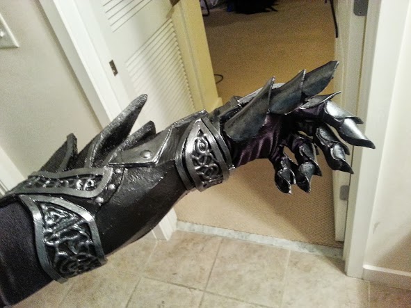

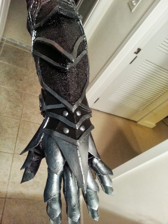

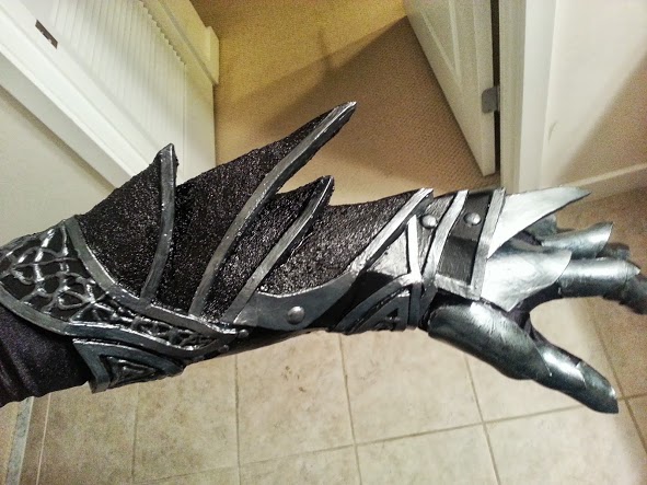

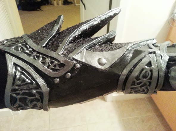

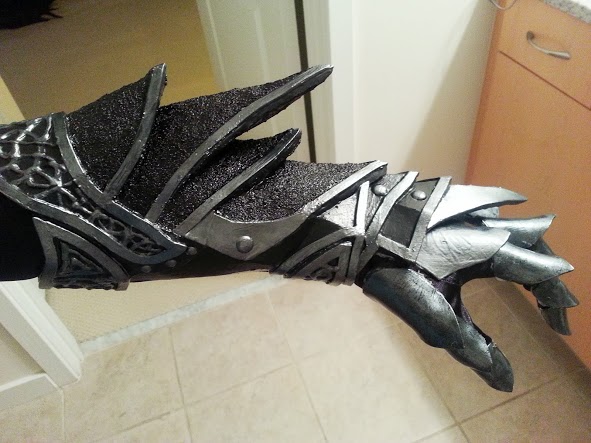

Snapped some pics after doing the first layer of paint on the gauntlets. Still need to add more detail and weathering, but here it is shiny looking. I realized its harder than I thought to take a good picture of my own arm :D

Re: Skyrim Daedric Armor - first time foam build (WIP pic heavy)
This is some of the most amazing work I've seen. Really nice job. I may try to do this for my next build; I'm feeling inspired.

Thanks all! Not being able to spray paint and having to hand brush everything is definitely making it take longer but at the end it should be worth it.

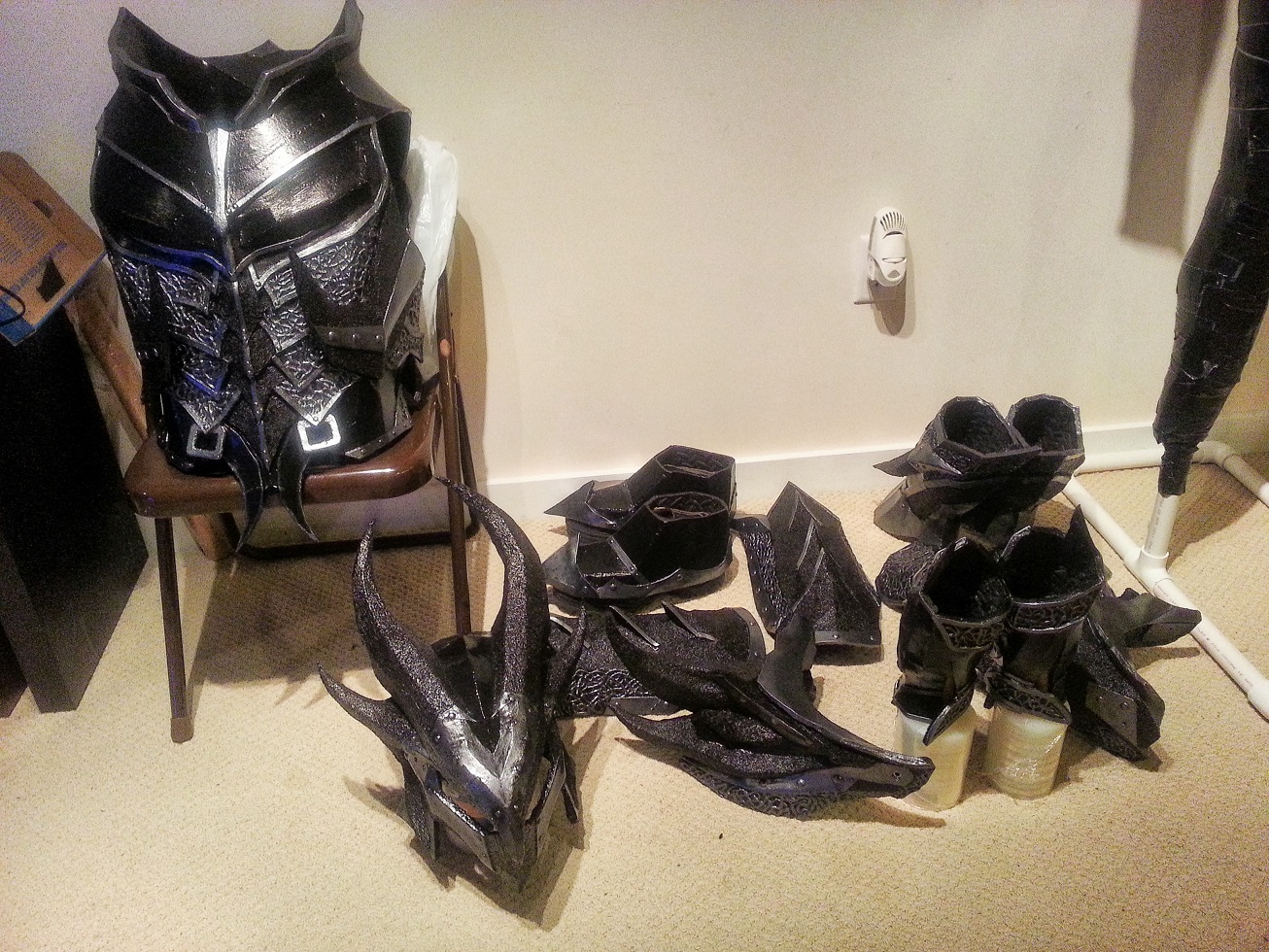

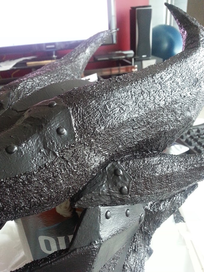

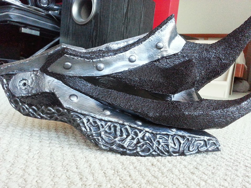

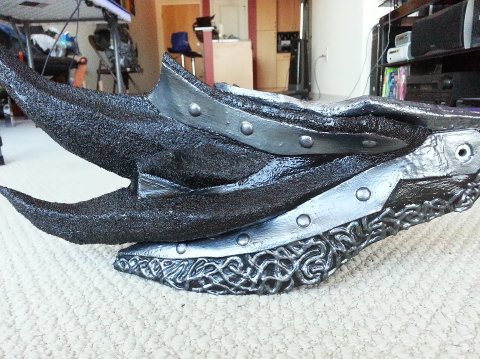

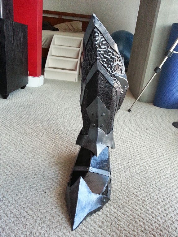

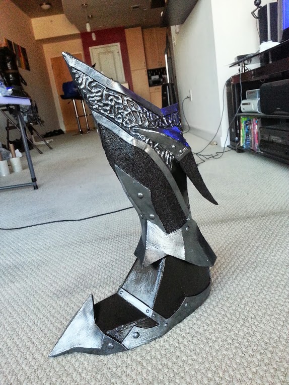

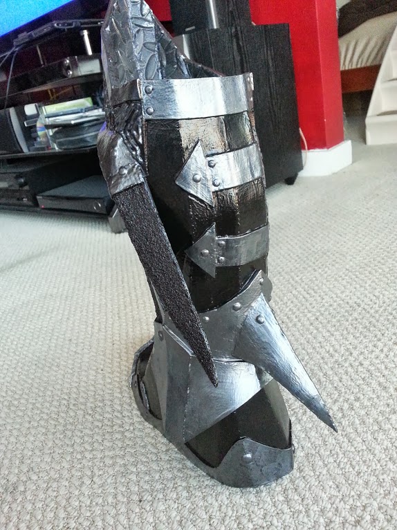

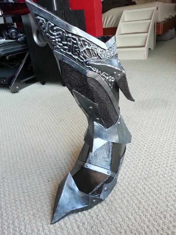

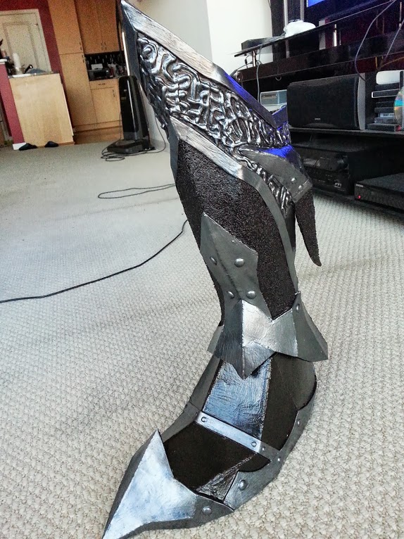

More painting done! Wanted to take some pics of the parts when they look all shiny before weathering:
Holy Jeepers, Batman. Those newest parts are blowing my tiny mind o..0
Agreed. You're clearly being careful with this and it really shows. Excellent work!

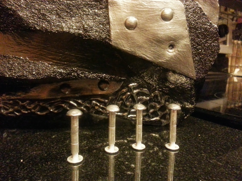

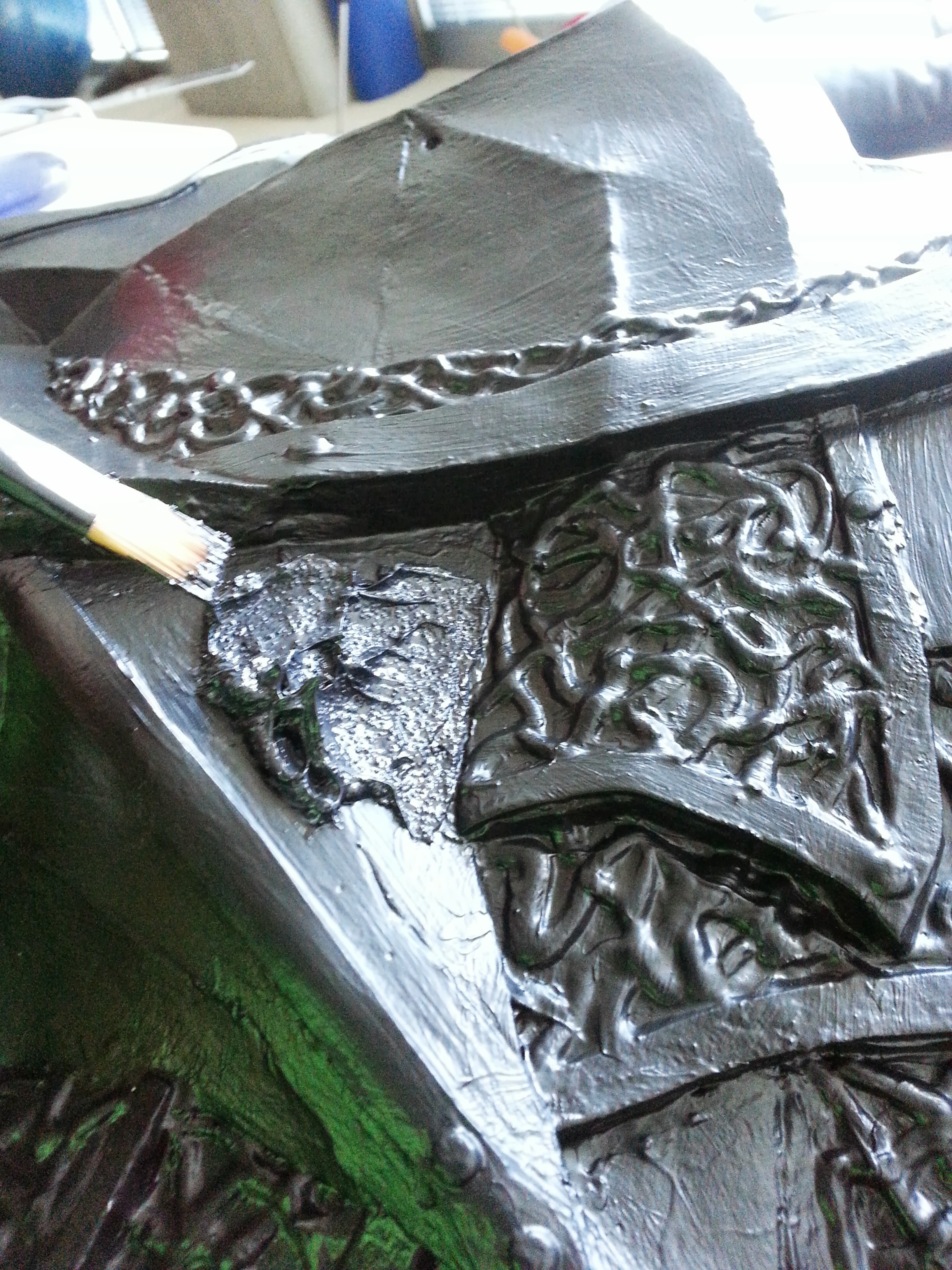

Minor detail, built up and painted the tops of the Chicago screws that will hold the shoulders to the breastplate to match the fake rivets on the armour.
All the pieces are almost ready to be put together!
