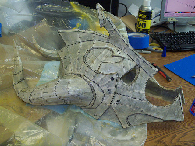

Mucked with the shoe parts today, slushed and peeled them. Used some mold release, that and the thicker silicone coats made tearing the paper off a breeze.
100_0506.JPG by makingawesome, on Flickr
100_0507.JPG by makingawesome, on Flickr

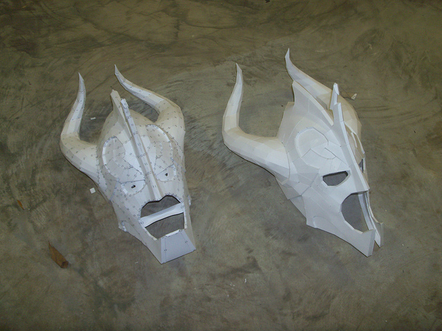

So I built the helmet, too big. Then I built it at the right scale.
103_0051.JPG by vrogy, on Flickr
Then I burned the wrong scale(used acetone).

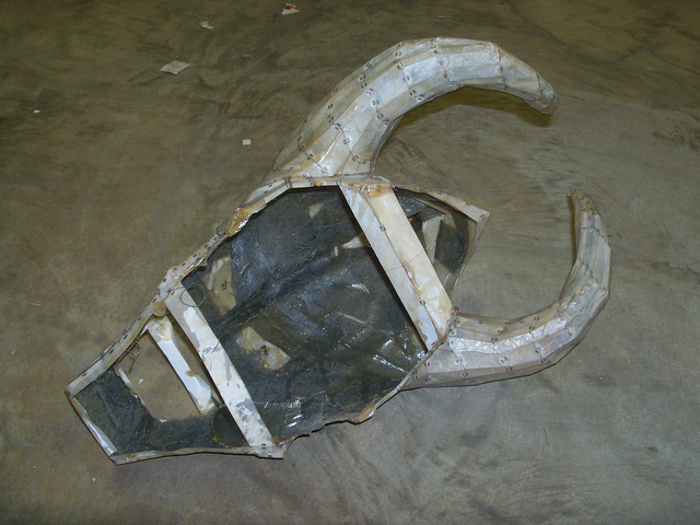

Resined and reinforced. Used some synthetic loose-weave fabric.
103_0064.JPG by vrogy, on Flickr

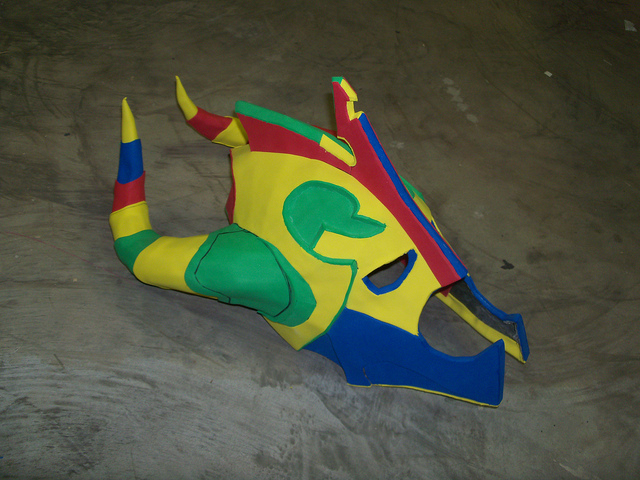

Then I sketched up where the different sections of foam would go, and dremeled down errant fibers..
103_0066.JPG by vrogy, on Flickr
The thin craft foam is.. most importantly, cheap as hell, and when applied correctly smoothes polygons down.

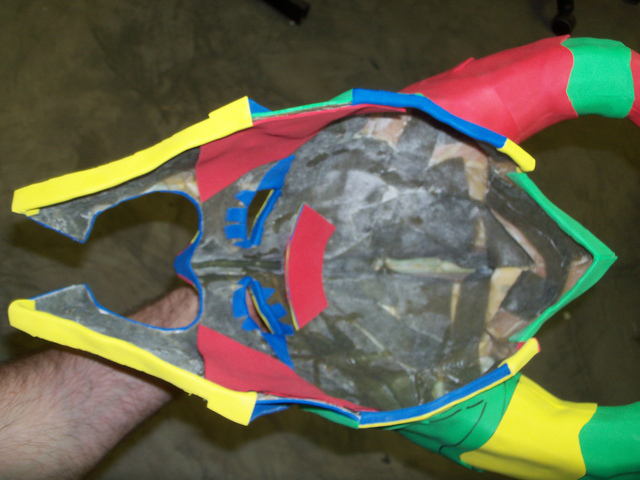

.. some time later..
103_0077.JPG by vrogy, on Flickr

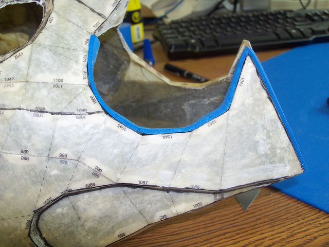

Also added a few layered strips inside and over contact areas, around edges.
103_0079.JPG by vrogy, on Flickr
Now it's time to do some weathering/slicing, some elmer's to seal the foam up, and paint.
