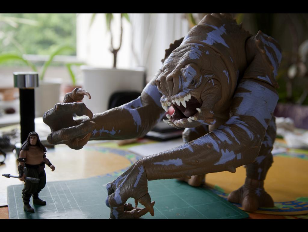

. . . you can clearly see that I already sharpened his teeth with magic sculpt and sandpaper ...
. . . and finally ... recreating my favorite Rancor movie-shot ... alas with the unfortunate Gamorrean Guard ...

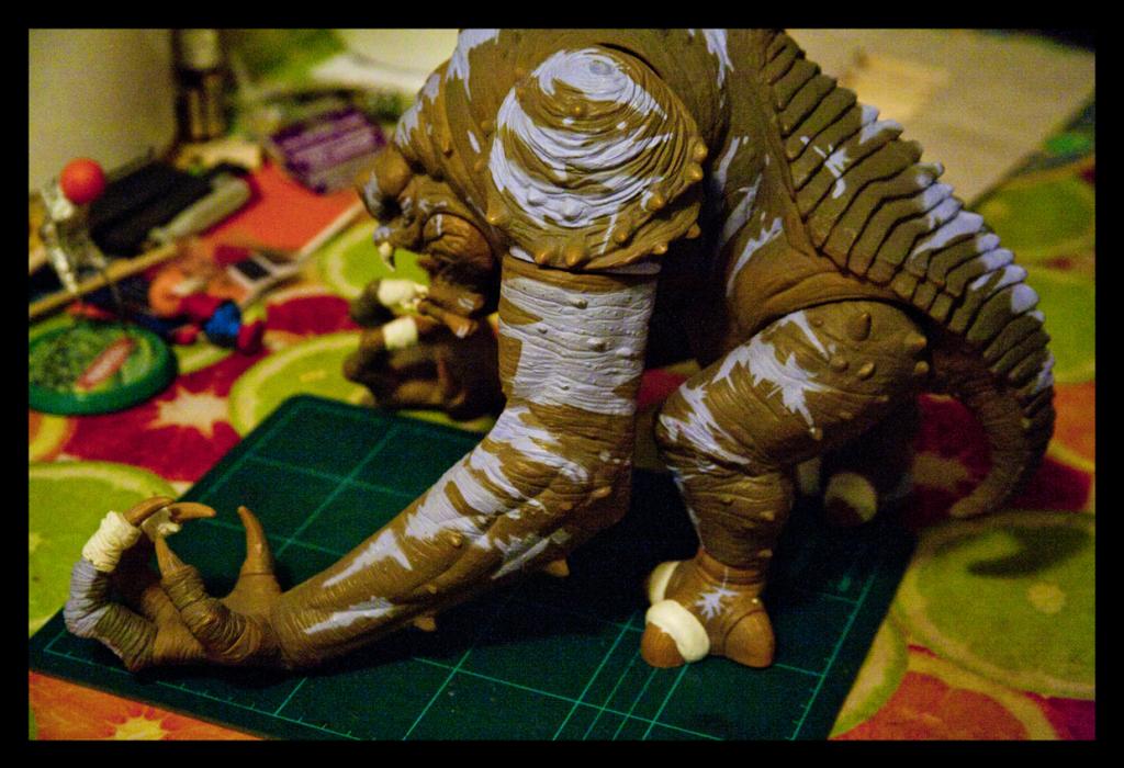

Today ... I took a step back ... and looked at pictures of the Rancor
. . . and of the one Rancor just in front of me ... and there was something off ... I've always been good at spot the 10 differences between two of almost the same drawings ... yet I just could not lay my finger on it ... and that's when it hit me ... the fingers are one bone to short on this hasbro version thus making the nails appear extra long ... so all I had to do is remove some of the plastic around the nails in order to be able to recreate another finger bone ... before changing the shape of the finger-nails ...by the way all the removed plastic you see on the left will be re-used again as bumps and lumps on the body ... with some magic sculpt added ... just so you know for those folks, like me, who are keen into recycling as much stuff as possible ... even when upgrading a Rancor ... so here you see what I removed ... oh yeah and I clipped some bits off of his thumb nails too ... now they are much sharper in appearance . . . so far so good ...

As you can see I added the extra finger bones and some wrinkles in the skin with magic sculpt :

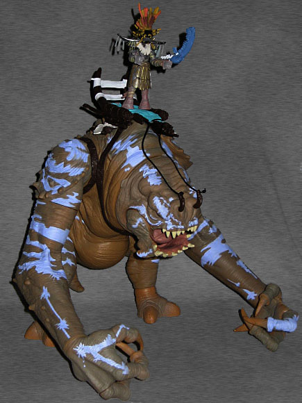

Yes it did. In the first picture of post #9 you can see this is originally the 'Expanded Universe' version of the Rancor not the ROTJ ... alas I don't know it's history ... and the paint is actually a pale blue not white ;)

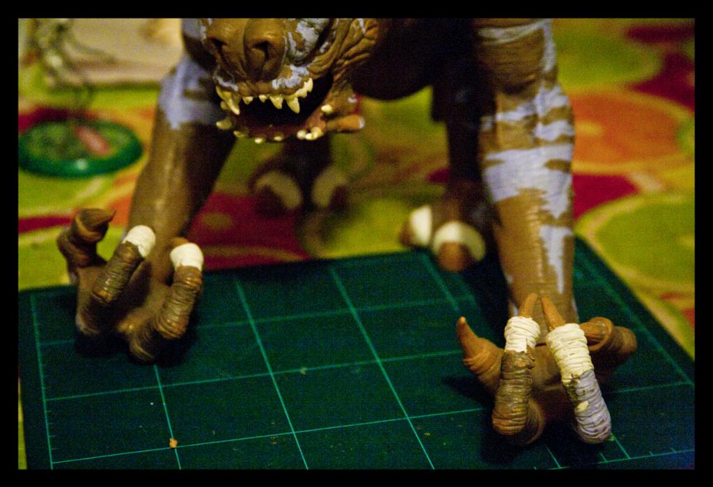

As you can see I made his toes a bit more blubber as seen on the original still need to add some more magic sculpt and details but it's looking good.
Then I finished his nails on the left claw ... so they blend in better with the added bone :

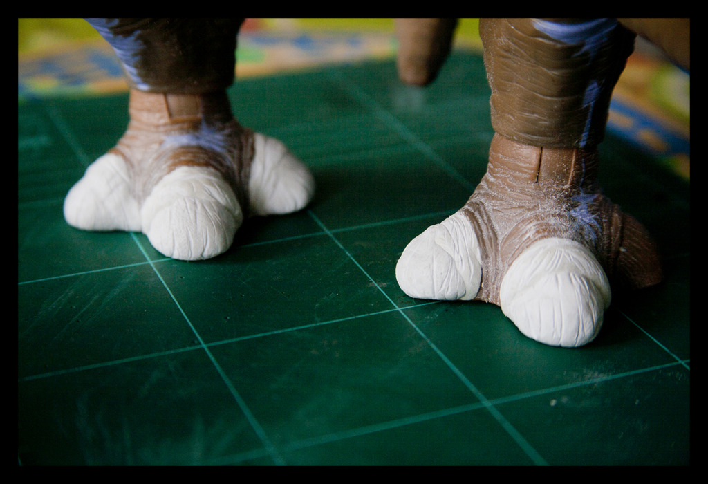

Due to the fact that Magic Sculpt is really easy to work with . . . even after it's fully hard . . . I was able to scrape and file more scratches and other organic lines in the feet thus getting a little closer to the original puppet :
