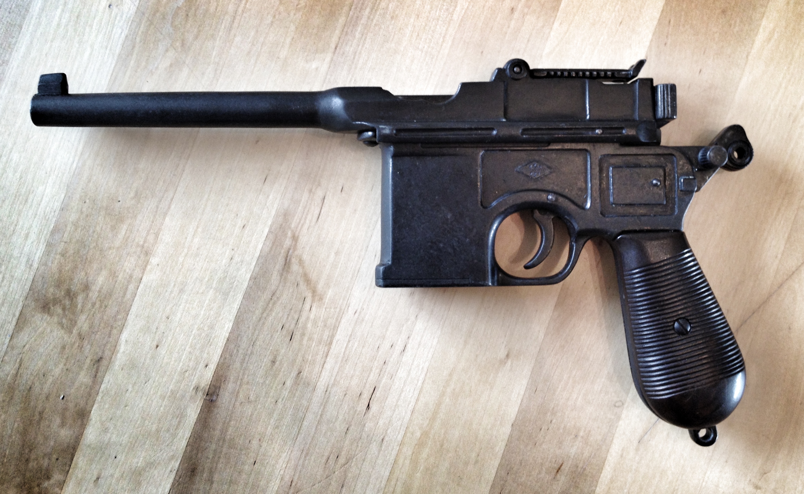

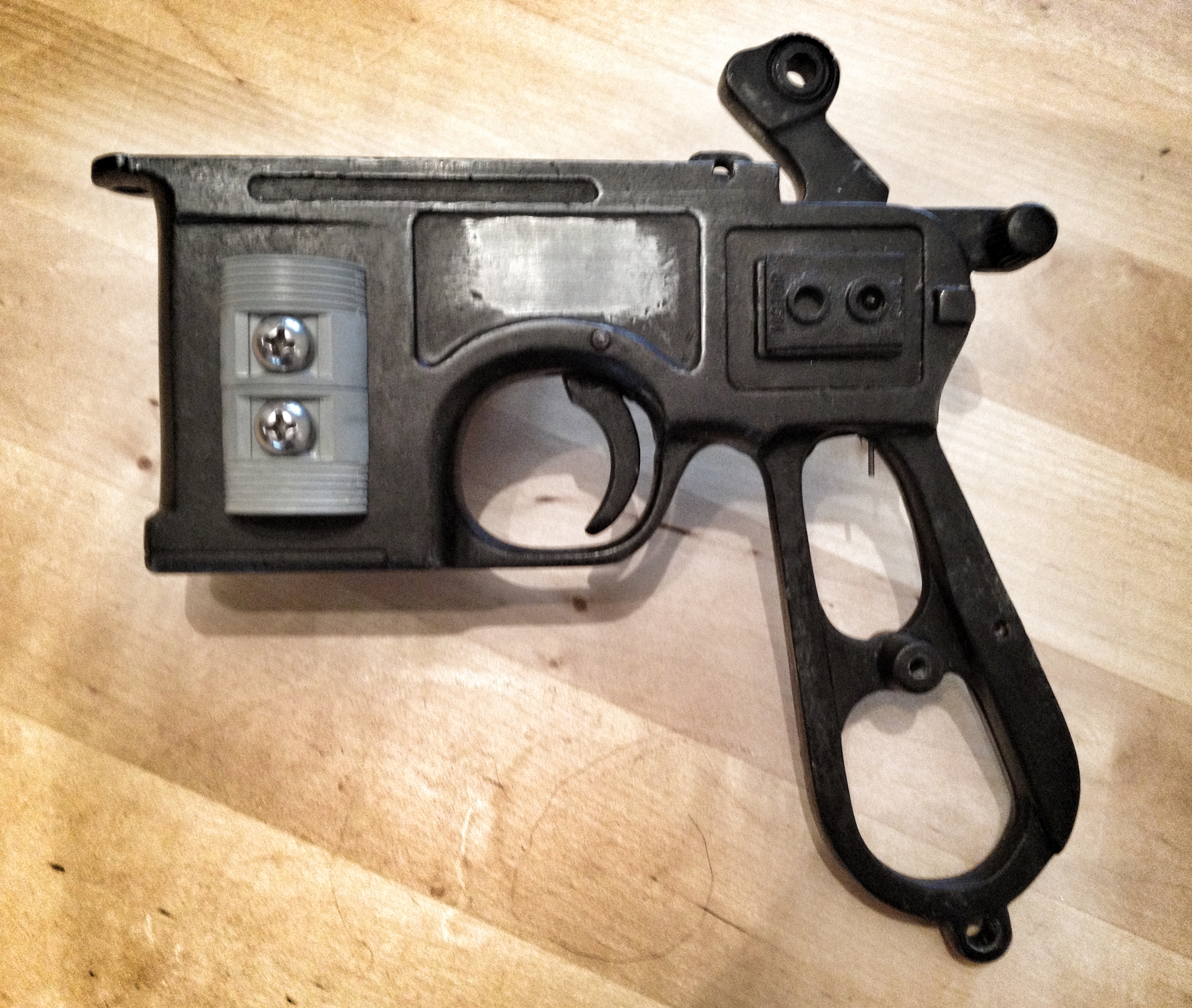

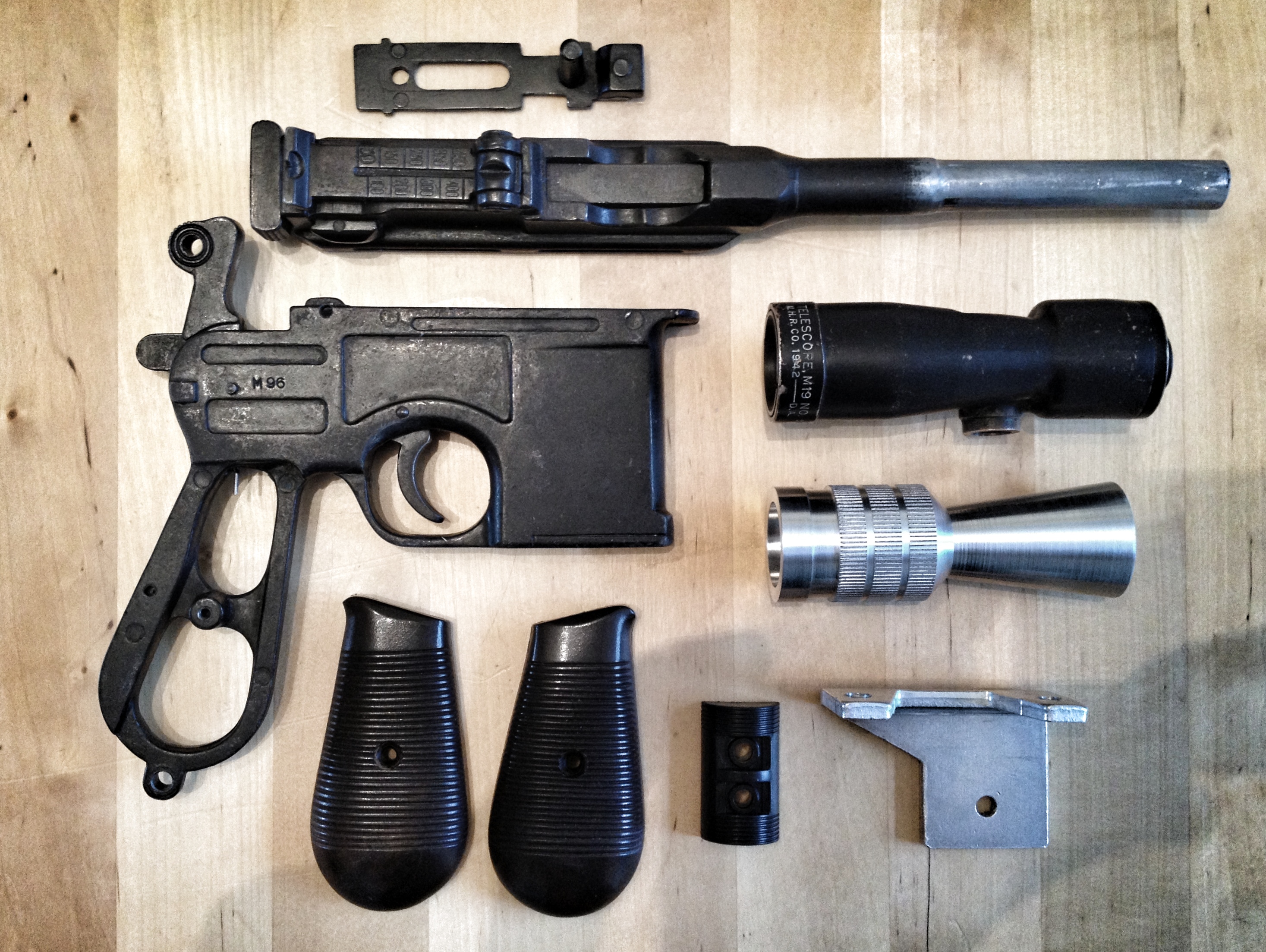

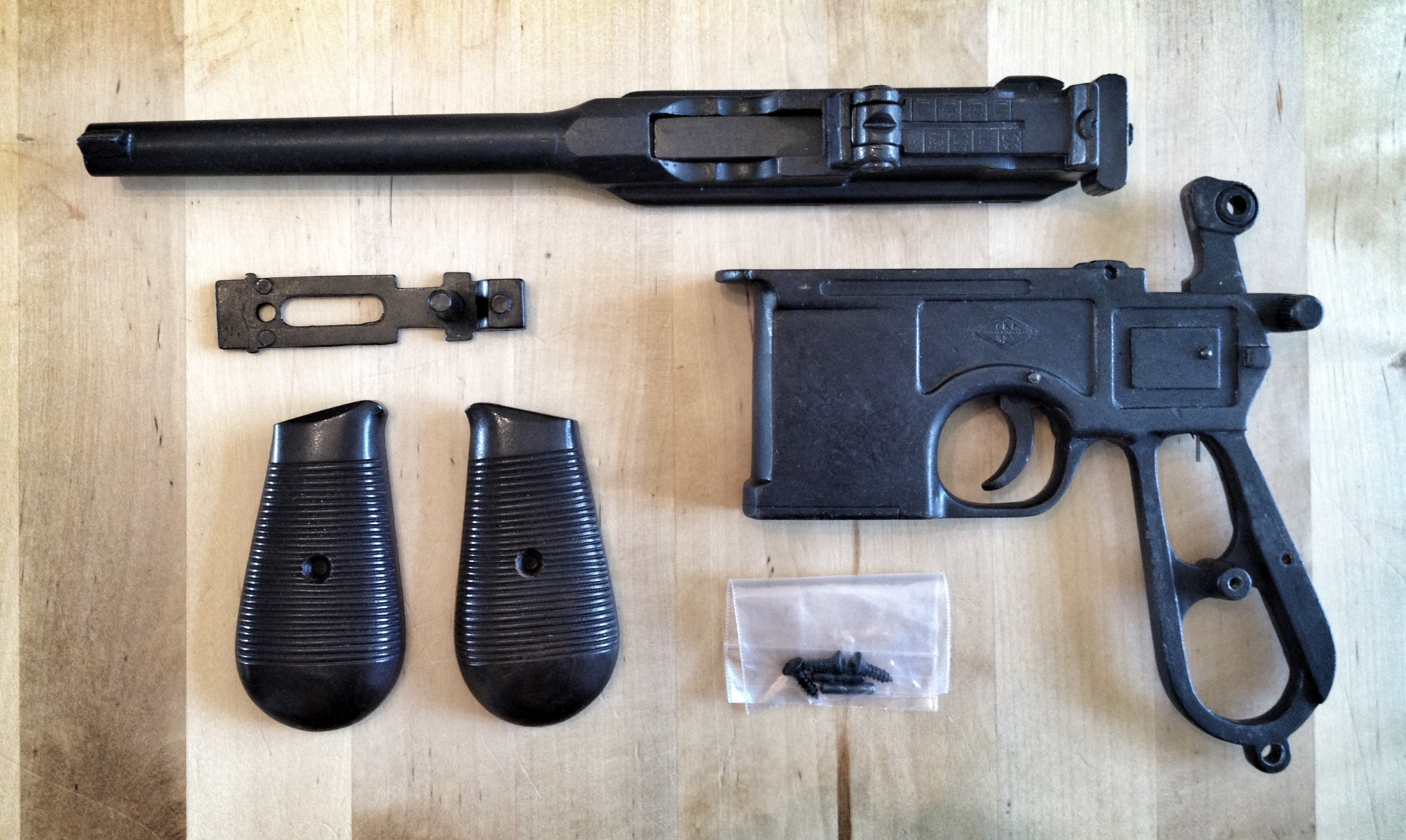

So I got my Mauser broken down for starters

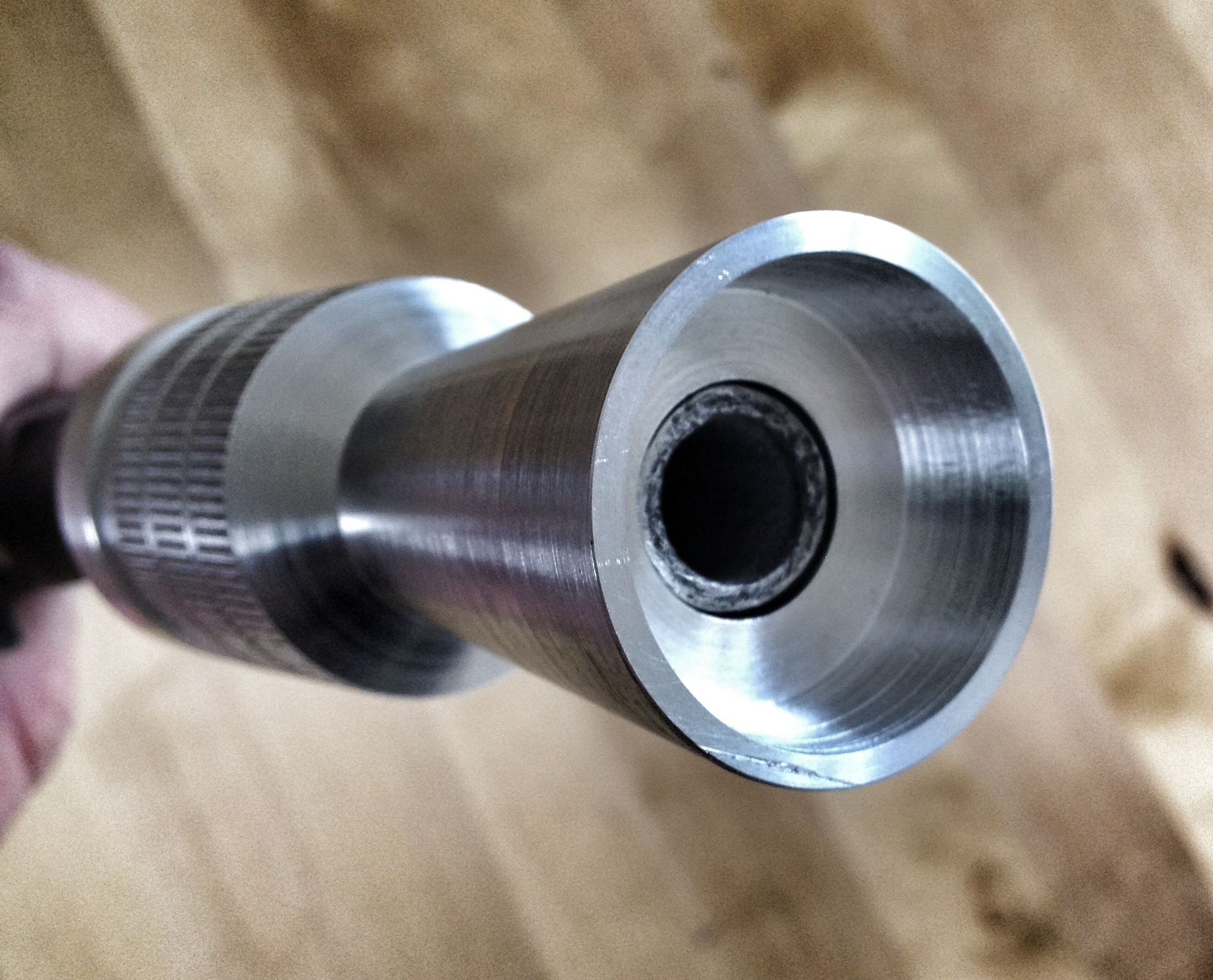

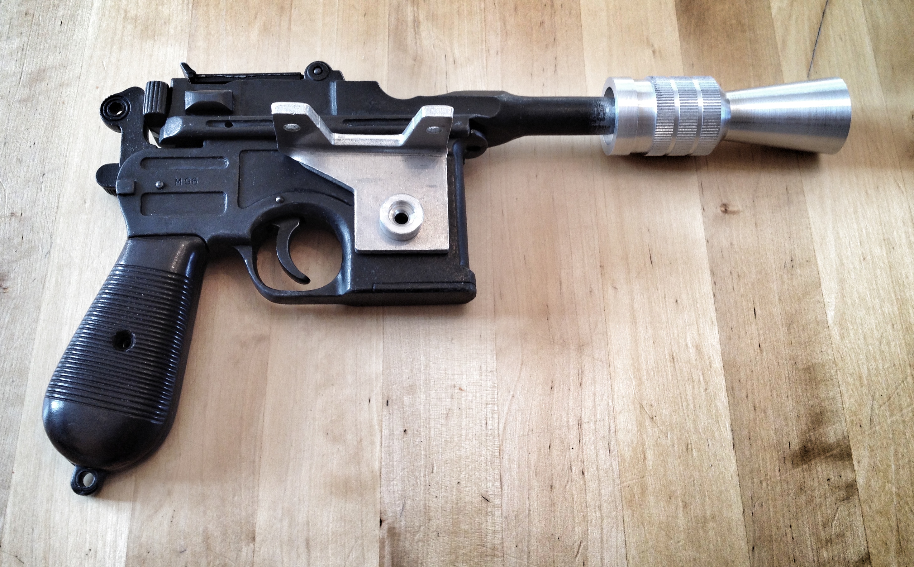

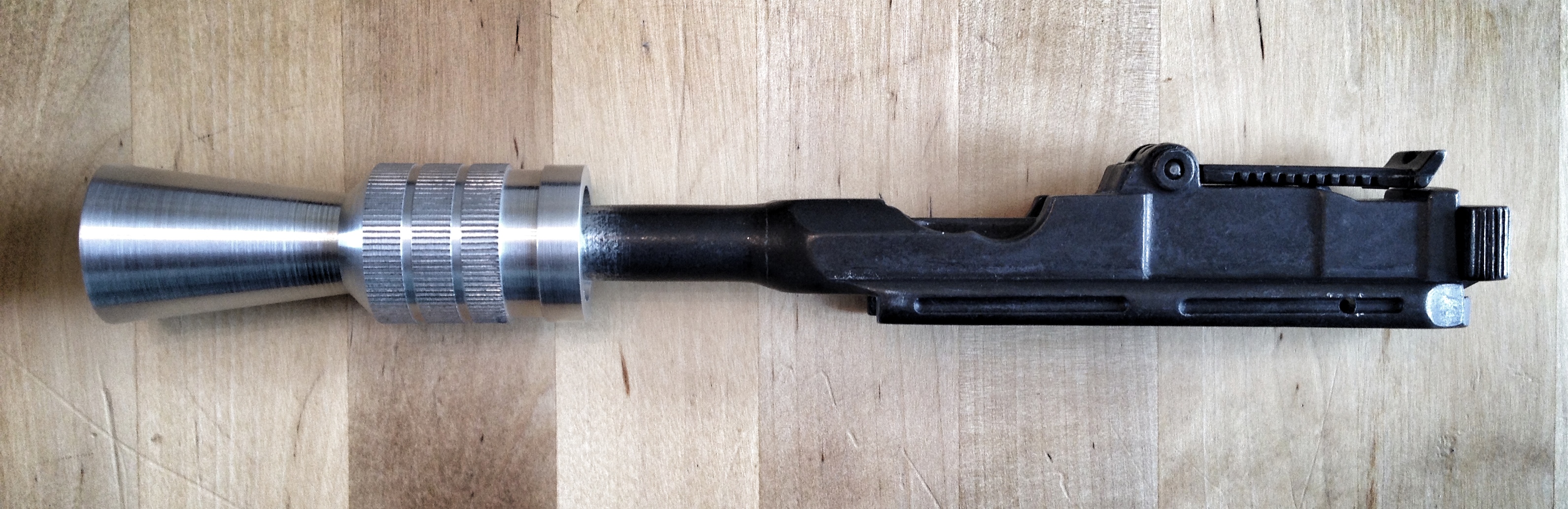

As the flash hider is the only part that has arrived so far I thought I would start there :)
I sawed off the front sight from the Mauser & found that the Flash Hider wouldnt fit barrel was too thick or inside of hider too narrow :lol
so I set about filing & sanding the barrel down with a metal file & sandpaper (before realising I could use my dremel)
after some work I've filed the barrel down enough that the flash hider slides on ok
I read in another build thread that the barrel inc flash hider should be 5 inches?? not sure if this is correct but it is what I've worked too for now
do people think that's too long, too short or just right?
obviously I can make it shorter if needs be (dont know about longer)
compared to my Doopydoos resin blaster it looks a lot longer but I Don't know how accurate that was

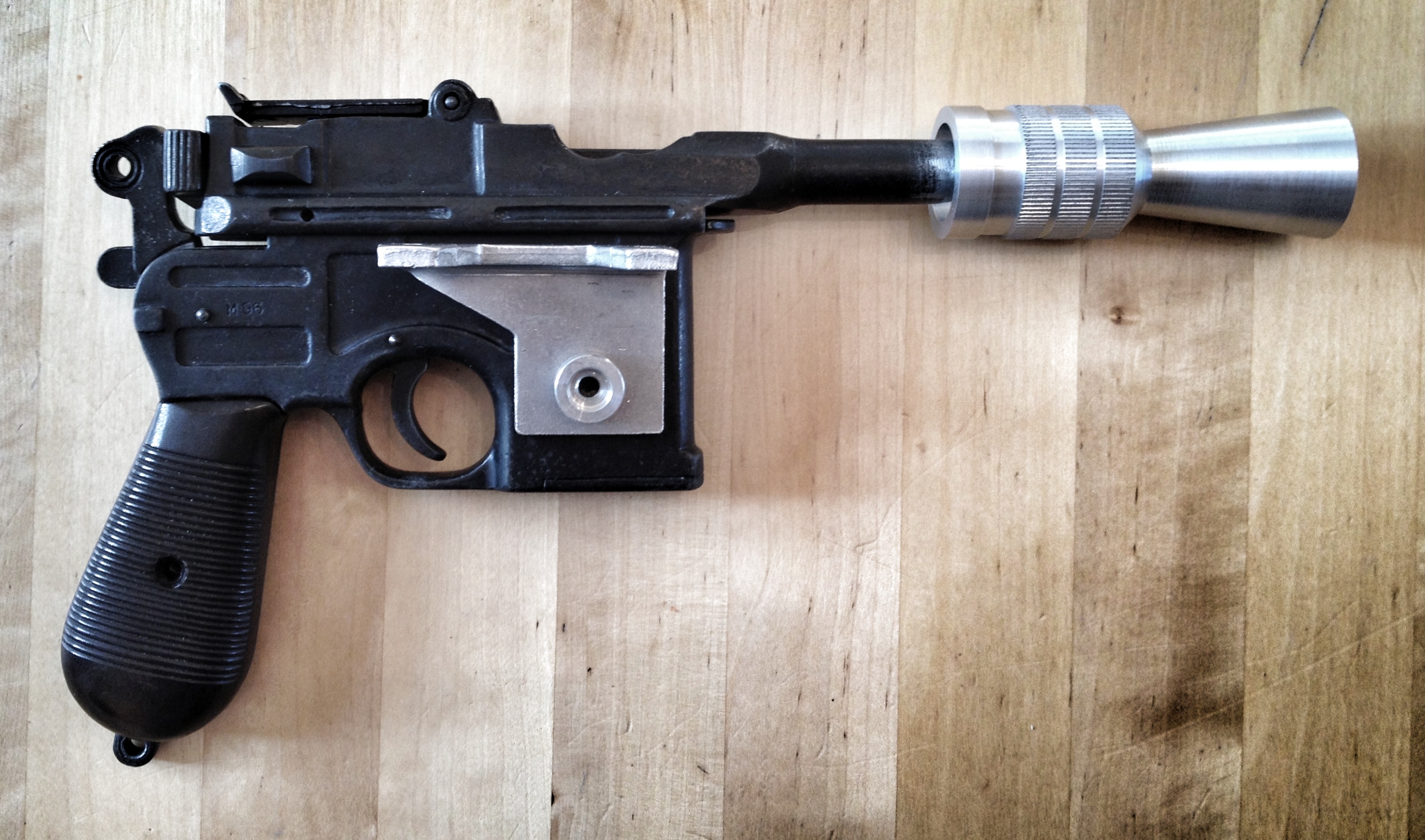

I've also sanded off the denix logo & the nub from in front of the hammer
not sure if I'll want to paint or blue the denix although it may be easier to paint as i'm not familiar with bluing & the pics I've been looking at look more like paint (but I may well be wrong)
like everything on this build it will be governed by my limited skills & available tools/parts rather than 100% accuracy
You may also notice that I'm missing the slider from the mauser sight, wasn't there when I got it, not sure where I'll find one either, no luck so far
need to get the rest of the Mauser rubbed down & then just wait for the parts to arrive

Off to a good start! IMO, you could let the barrel peek out a little bit more, just so the muzzle edge sticks out of the hole. Also, to my eye, the barrel looks a tad too long - I'm building one of these too right now, and made some screenshot comparisons before I was happy with the barrel length. The Denix has a little different outline compared to the MGC, so one has to compromise a bit. Trust your eye - go for what looks right when compared to screenshots.
I wouldn't worry about the metal work - the Zamak alloy Denixes are made of is easy to work with. The alloy is soft making hacksaw, file or drill work a breeze.
As for the bluing/painting dilemma, I'd recommend rebluing with a product like Birchwood-Casey's Aluminum Black. Very easy to use, results are at the very least comparable to the Denix original bluing. The Denix contains very little aluminium and will turn black as soon as you apply the compound.
I'd sand the Denix logo area smooth and apply bluing compound to it - not as time consuming as stripping and rebluing the entire gun. Just sand the area, wash and degrease well, then apply the bluing compound. For best results, follow the directions on the bottle, but do heat the area you're about to blue - a heat gun will suffice. Oil the blued areas afterwards for a nice, gun-like sheen.

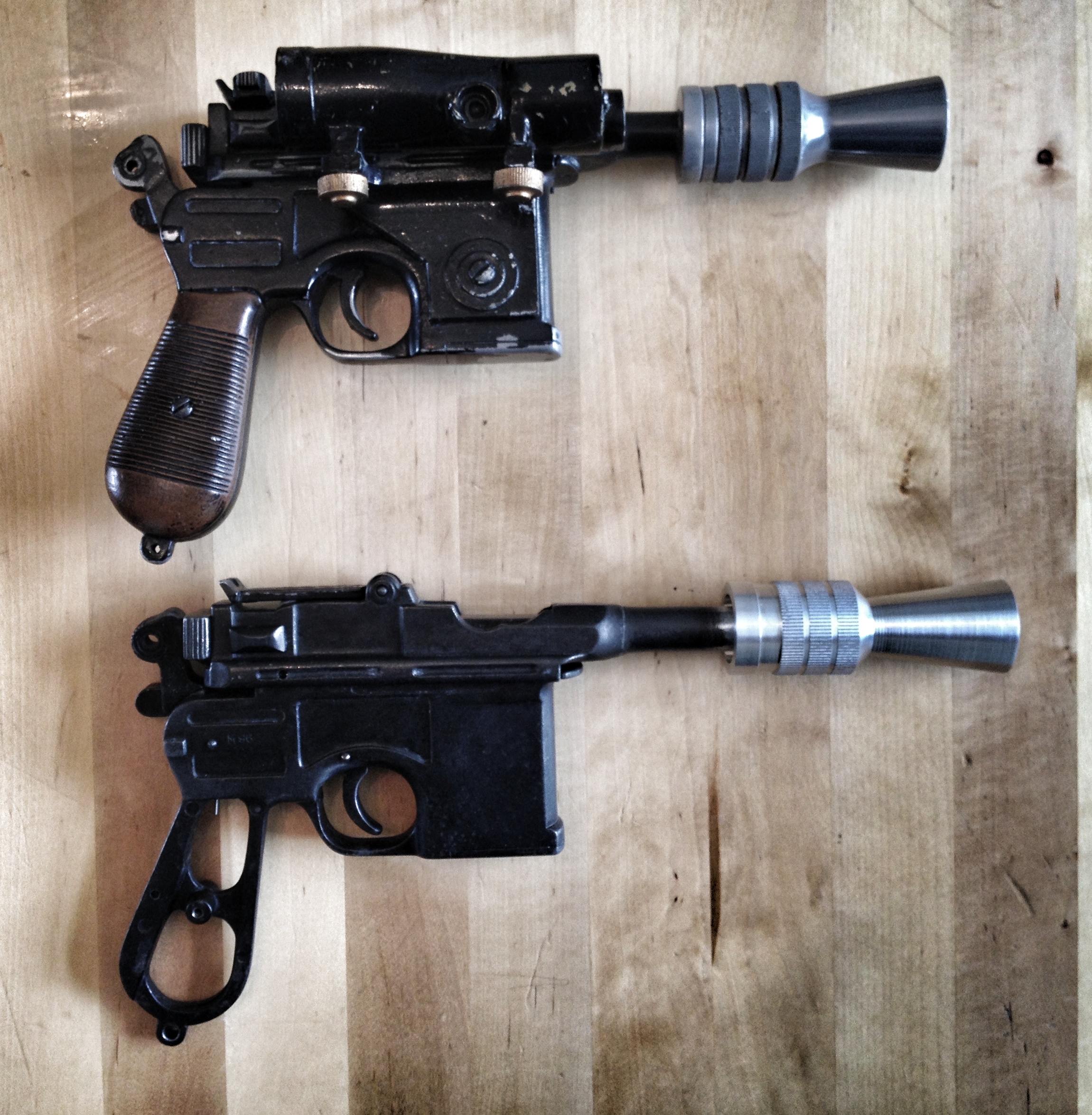

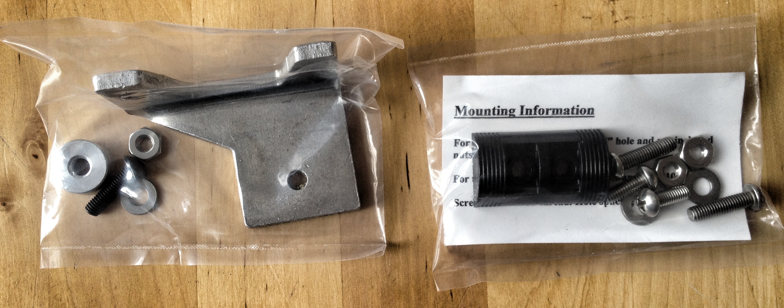

Ok so technically I've not made any build progress but I got a package in the post today from Blast Tech :)
My Scope Mount & Pistons, they both look great & come with all the fixings
just eagerly waiting on the M19 Scope now, also hopefully got a more accurate Bespin style Mount knob & some detailing greeblies coming,
I won't start drilling anything until it's all here & I can decide which parts best to use
I need to rub down the rest of the Mauser, it's finished is a bit mottled & nasty so I want to start over
still not sure which way to go i.e. Blued or painted
I have no clue about blue or how to apply it, I've been looking at the birchwood casey blues on ebay & there seems to be super blue, perma blue & Aluminium Black not sure which I'd need??
I may still go with paint as I know what I'm doing :lol

I would recommend to re-check the correct placement of the mounting-bracket before drilling into the mag well.
Seems like it's placed too low atm...

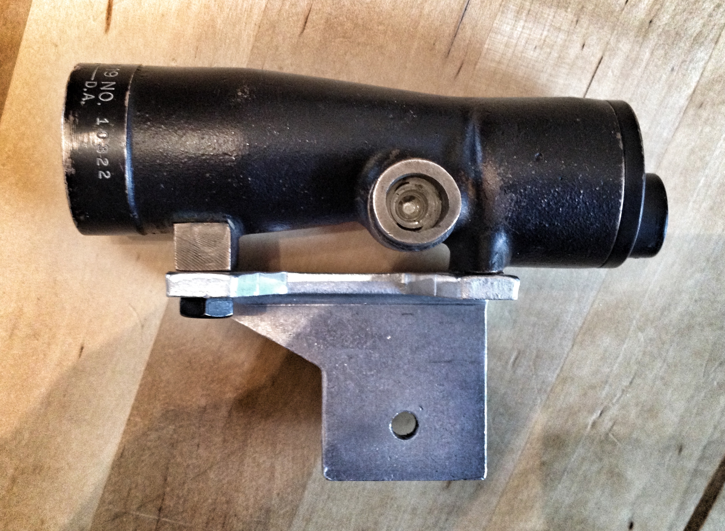

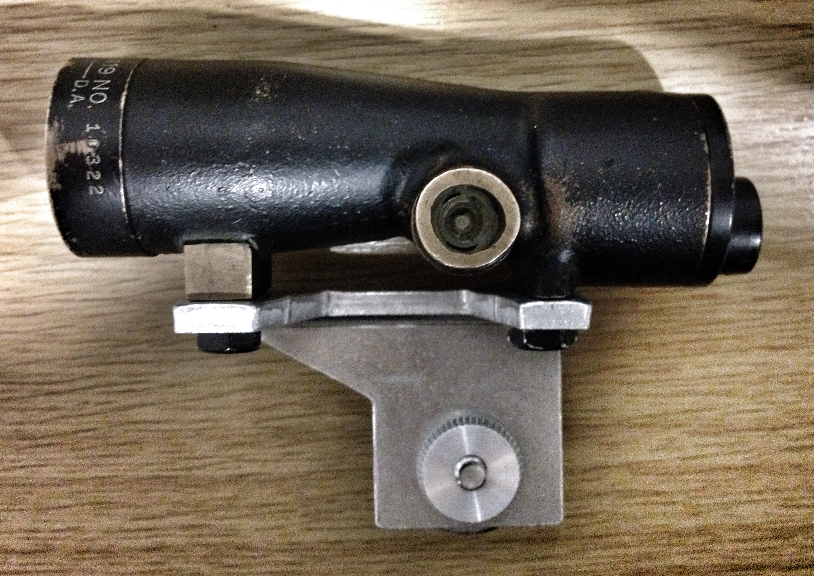

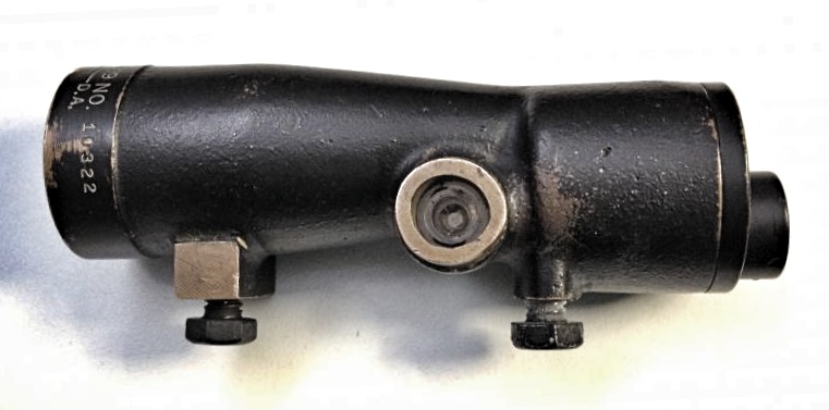

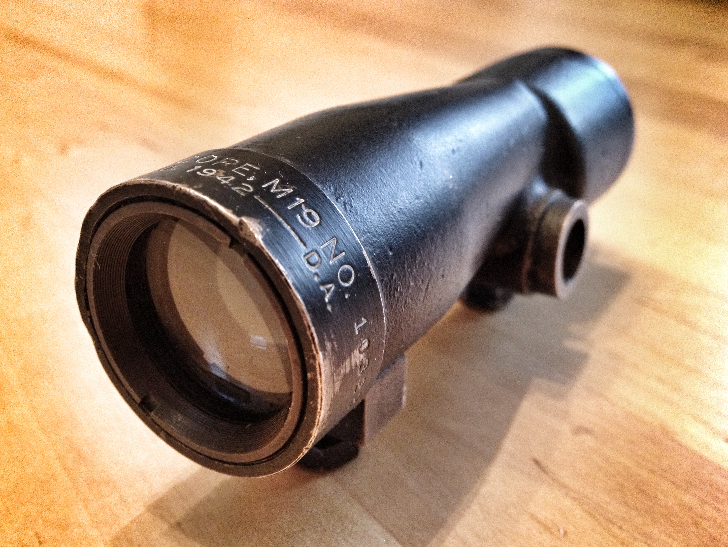

Ok so once again I've not technically made much build progress but ...... my M19 scope came today :)
I love it, I'd happily just have it sat displayed on a shelf, for 70 years old it's in pretty good shape
It's had it's screw threads enlarged at some point, it's not really noticeable but I'll have to enlarge the holes in the scope mount to fit
I'm just waiting on a couple of detail greeblies now & then I'll have to man up & get started :lol
based on the advice I've had here I've ordered some Birchwood Casey Aluminium Black for the Mauser along with some silicone gun oil (hope that's right)
if it doesn't work out I can always start over & paint it :)
the only thing alluding me now is a replacement slider part for the adjustable rear sight on the Mauser, I'd go with a whole new sight but can't find one of them either :lol

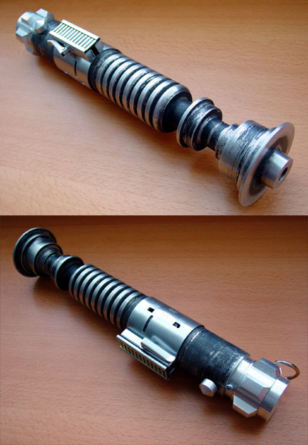

IMHO, The Aluminum Black is a must to replicate the scoring on the muzzle. Most likely you will need to use a little steel wool to break up the surface area so that the AB takes to it. AB tends to work best and adhere better when you do a light coat, rinse it, and keep redoing to you get it the way you like. Otherwise if you try to do a deep dark color in one pass, it may not adhere to the surface.
For some reason I do not have picts of my DL44 on hand but I have some other images to show what you can do with AB:
All the black on the Katarn and Luke V2, the black/weathering on the Obi emitter, and the weathering on the dog tag.

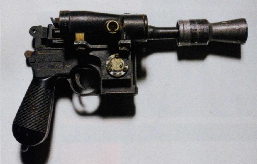

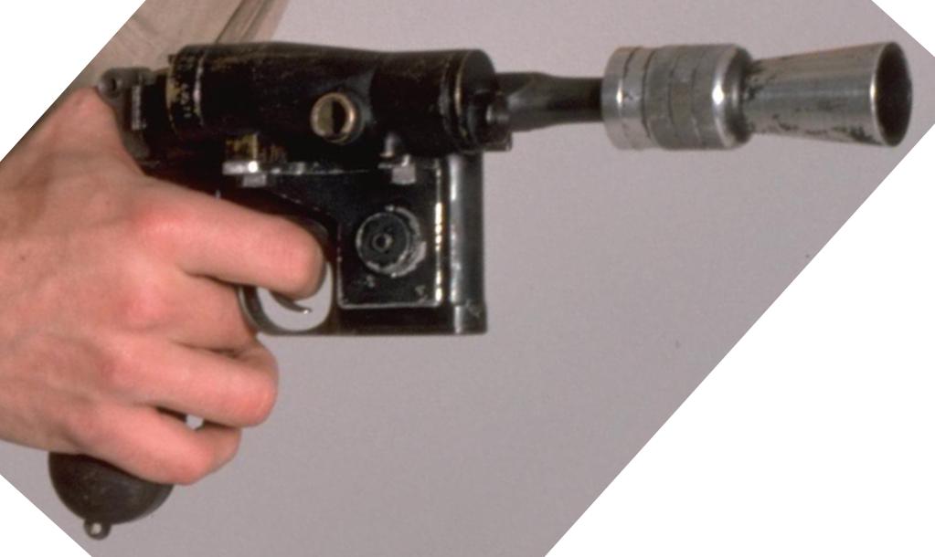

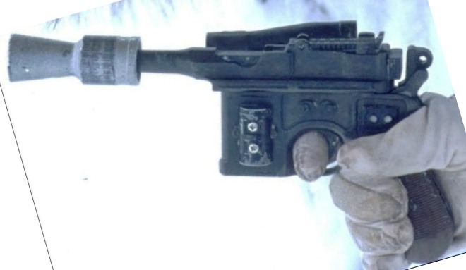

They look great, I'm hoping that the Aluminium black works for me but I'm not sure how I will go on, there is still a chance that this will end up painted :lol
From the pics I've seen of the original props I can't tell if it was painted or blued (I'm guessing blued??)
I've tried to gather as many pics/screenshots of the prop as I can to work from, that said there don't seem to be that many
don't think I've ever seen a pic of the left side of the Bespin blaster
here are the pics I've got so far, if anyone has any others I'd love to see them :)
They're all just taken either from either this site or google images so I'm hoping I'm ok to post them here (please let me know if not)
I realise that they are a mix of the Hoth, Bespin & Luke's
Does anyone know if the Bespin Blaster had a spacer between the scope mount & the Mauser? I've seen it done both ways & trying to decide how best to do it.

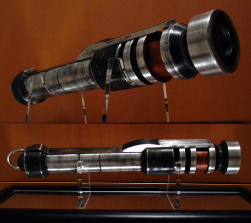

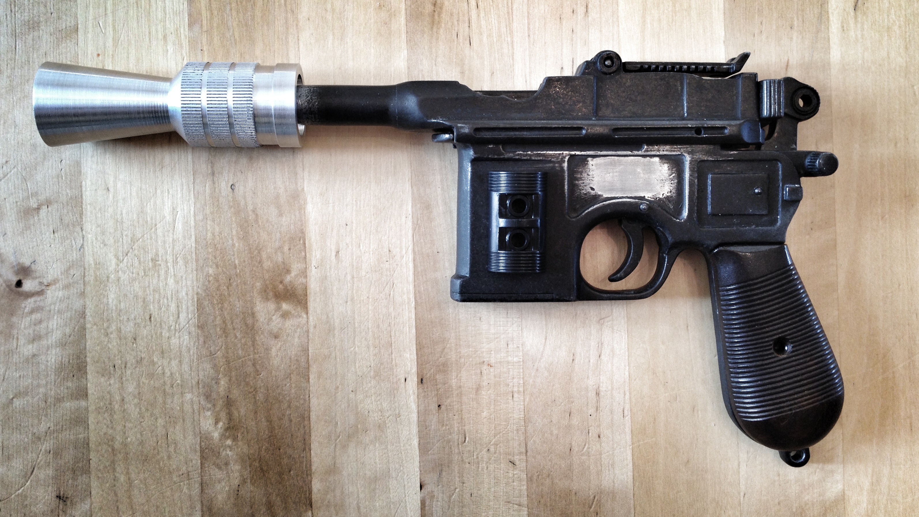

Got my last parcel of parts for this today from Odiwan72, Motor Coil plates, side details, V8 Pistons & another Bespin knob :)
so decided it was time to actually crack on with it a little,

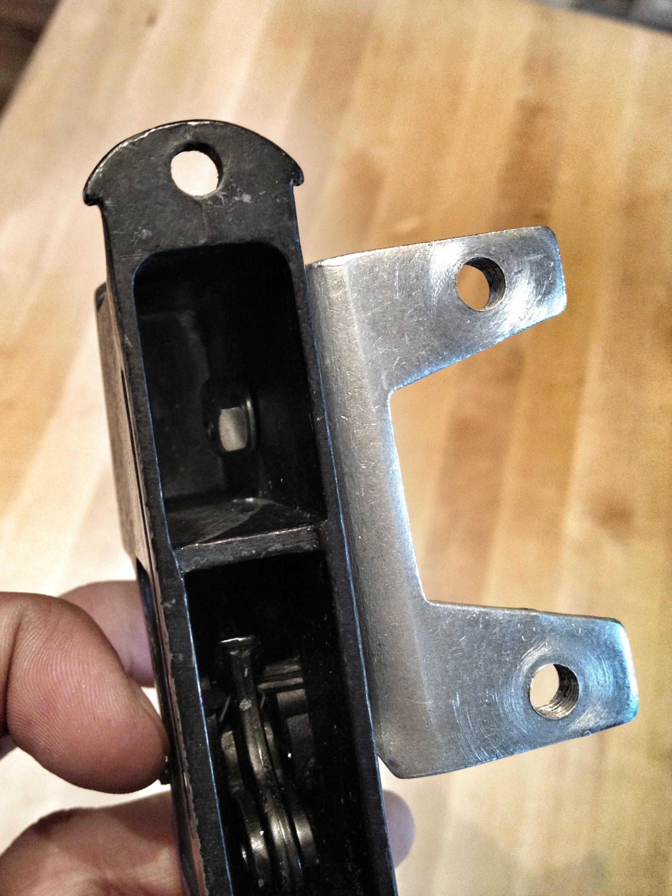

I enlarged the scope mount hole to take the wider threaded rod,
& then I took a deep breath & started drilling into the Denix
I don't have the steadiest hand & I wasn't brave enough to break out the power tools so I just used a hand drill, only took about 2mins to get through the magwell
fiddled about getting a nut & washer on the inside & the threaded rod (cut down screw) was just long enough,
I've not used any spacers or washers between the mount & the mauser at the moment,
I may need to use a drop of epoxy to hold the mount in place when I'm finished to stop it swivelling (even though I know that's accurate :lol)
will try to get the piston's drilled & test mounted tomorrow,
funny the moment I put the scope mount on it felt like a Blaster :)
Luke/Han shared has a spacer. Store - Product Detail

Tiny bit more progress, got the holes drilled for the V8 Pistons again with the hand drill
I've got 2 different pistons the Black Blast Tech ones (which are one solid piece) & some grey revel ones,
not decided which I'll use yet but may well go with the Blast Tech as they just feel a little more solid & are pretty close,
very fiddly getting the nuts & washers on inside the magwell
also decided I needed a longer threaded rod for the Scope mount, so I cut down a longer screw with my dremel (broke 2 more blades :lol) but the longer rod works a little better
guess I need to think about painting/bluing parts now
still not sure if I need to push the barrel a little further through the flash hider, think maybe a couple more mm's
Re: Han Solo ESB DL44 Blaster (my first attempt at a metal blaster build)
One thing about the V8 pistons...
Most of us backfill them with bondo or miliput to make them more rigid. Without that they tend to deform when they are screwed to the mag well.
Markus
