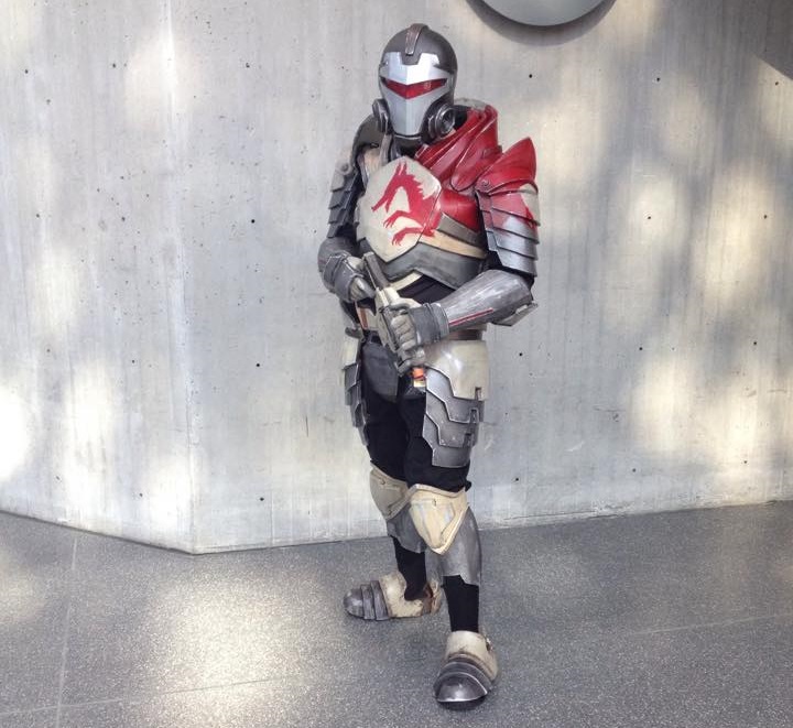

So, doing my part to "give back" here and show my builds from files on this thread! :D Thanks of course go to @Darhood, for his work extracting all these files!
Further thanks go to Zero-Sama, for unfolding some of the pieces... the rest I unfolded myself.
I have all the files collected in one zip, if you are interested, available on 4shared here.
And without further ado, I present my Blood Dragon armor, making it's debut at New York Comic Con 2014! :cool
I even ran in to Doc Dailey in his HALO 4 Spartan!
John Jiao Photography.jpg With Doc Dailey in his HALO 4 Spartan armor.jpg received_10152798273647288.jpg
Build write-up will be coming hopefully soon.
I may also do a tutorial on my Talon speed build, ... I've had several people ask for that! :eek ;)

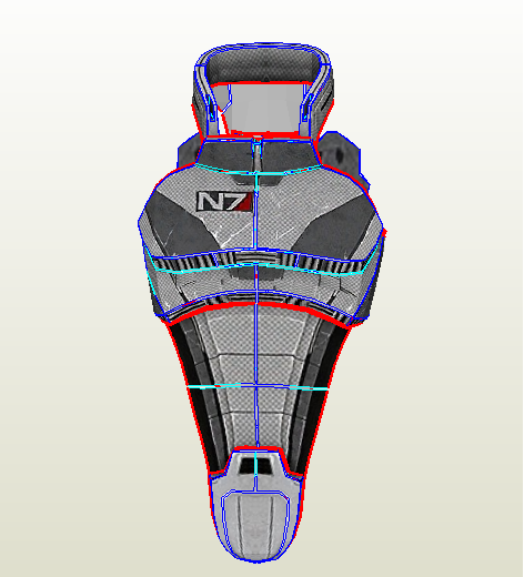

Does anyone have the Capacitor N7 Armor unfolded? Or if not unfolded just in separate pieces (i.e. torso, arms, legs etc.)
I've looked and looked and I can not find it. Or if anyone knows of a 3d software that can delete the parts I don't want. Im on a mac so that has made it difficult. Mostly the programs I've found can't open .pdo files.
