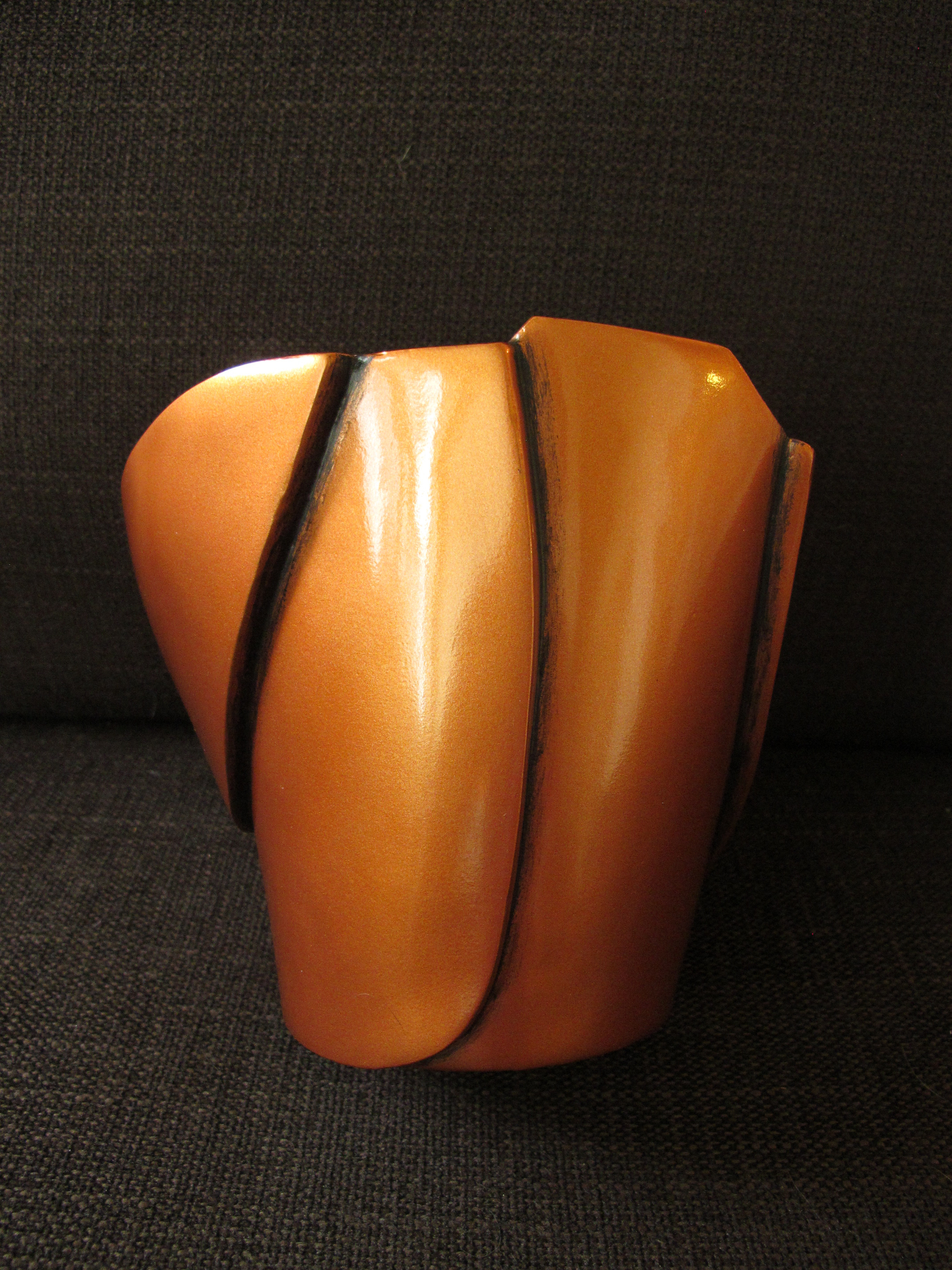

I now have one of the thighs all ready for paint except for a few tiny spots (circled in black):
I ran out of gray primer so I just used white to check for imperfections. Harder to see since it's more transparent than gray, but it worked well enough.
The second thigh's worbla is complete and is ready for bondo:
The thighs fit like a freakin' GLOVE. I love it.

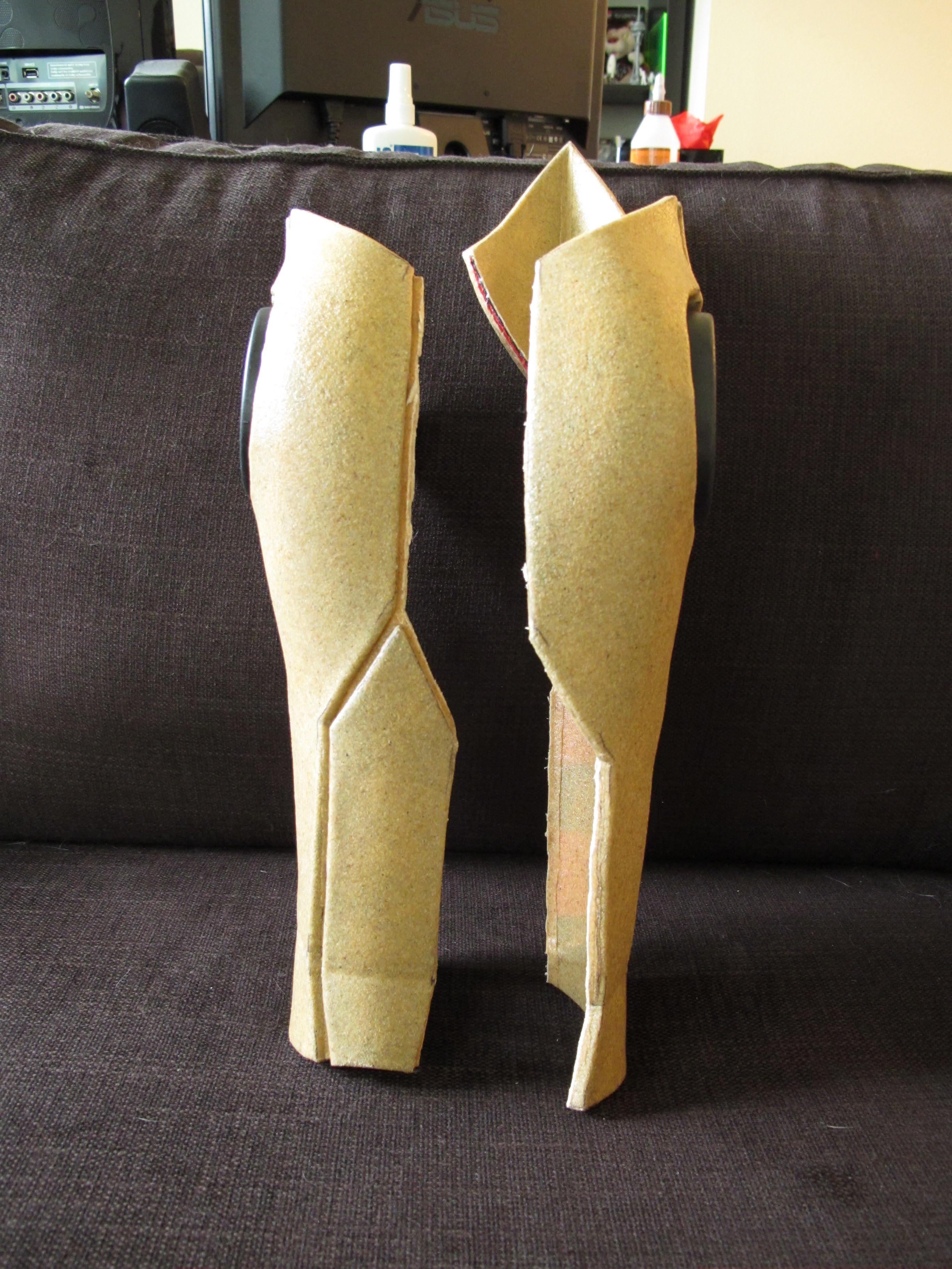

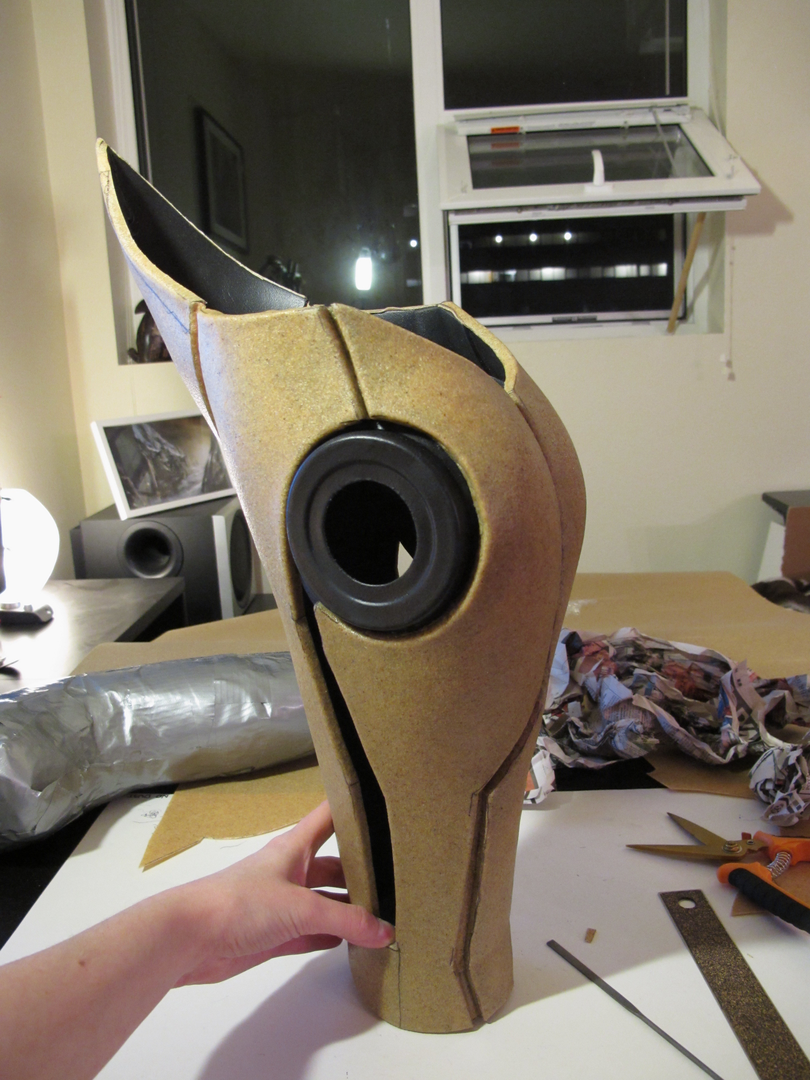

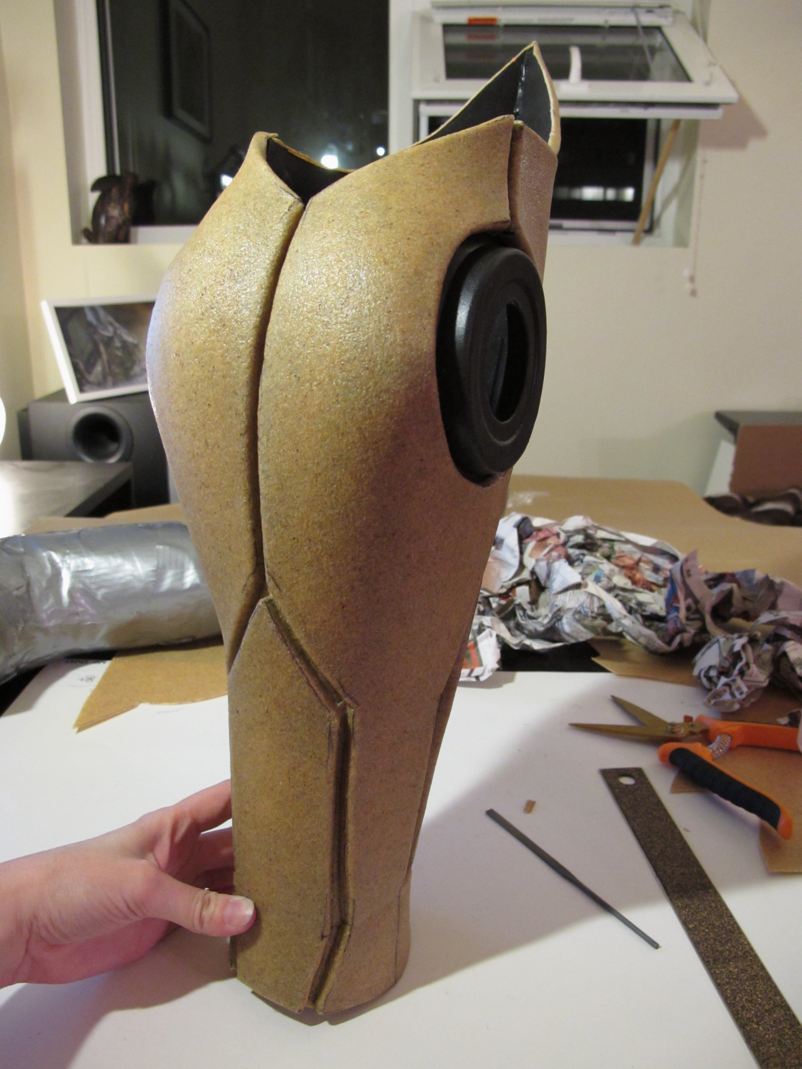

This weekend I started work on the first shin! Originally I was going to have it flex to wrap around my leg and velcro shut but since I'm making it hard with worbla, now I have to cut it into two pieces that will be held together with magnets and/or clips. Before I cut it though, I need to be sure the overall shape is good and that the two pieces will actually fit together after manipulating it with the worbla on it, so I'll be worbla'ing it as one big piece. Since the ankle hole is too small for my foot to fit through this meant I had to create an analog for the shin to be on. I made a quick duct tape cast of my leg and stuffed it with newspaper (like the big whole body mannequin, if you recall), and then hot glued the shin shut around it.
The shin before gluing it shut:

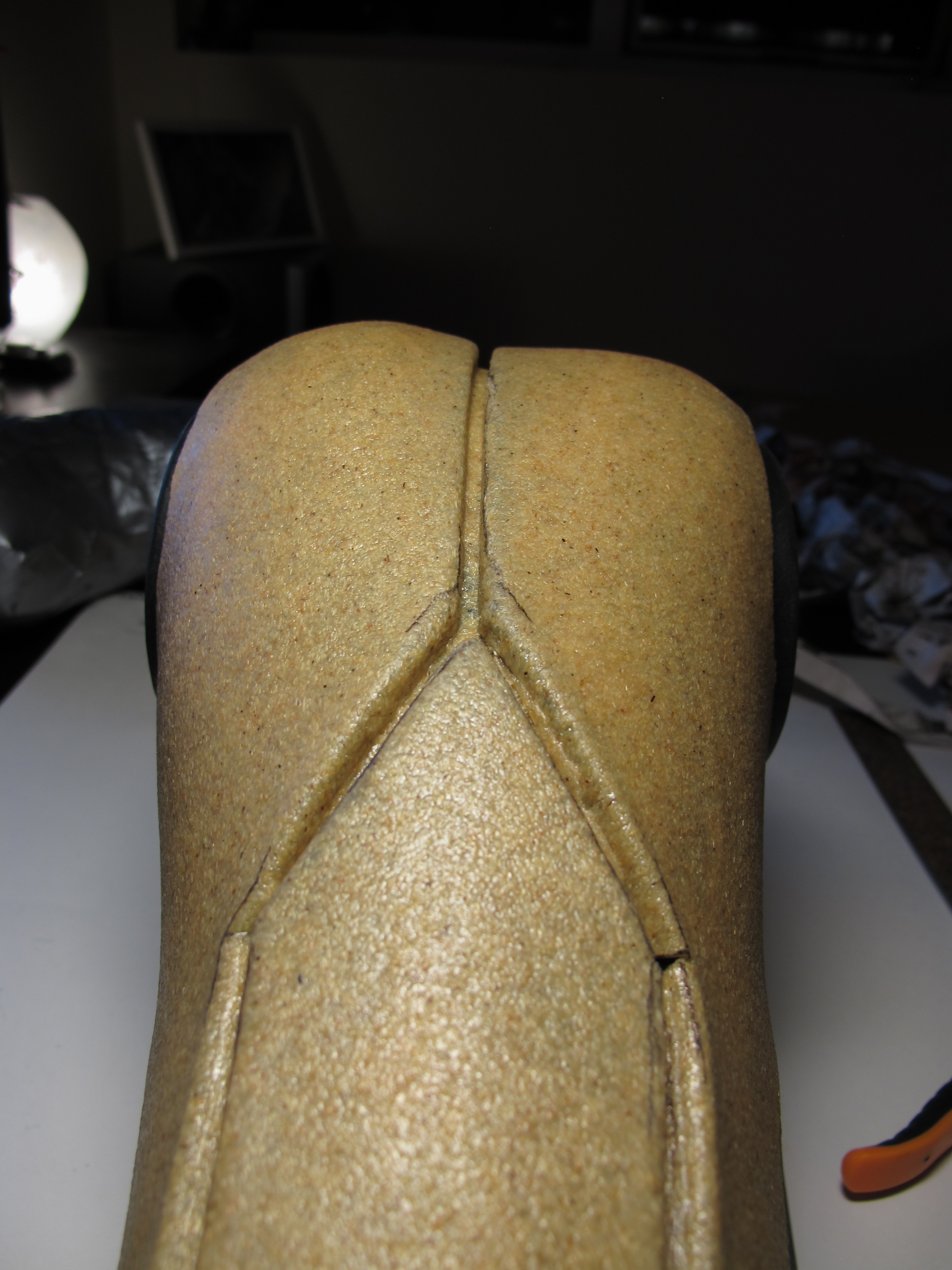

I cut in some V-shaped grooves that had gotten lost in the plastidip and weren't big enough in the first place (the red areas, which is the original red foam showing through after the cuts):
I also did one down the front center, creating a Y shape below the knee spike (done after this picture was taken).

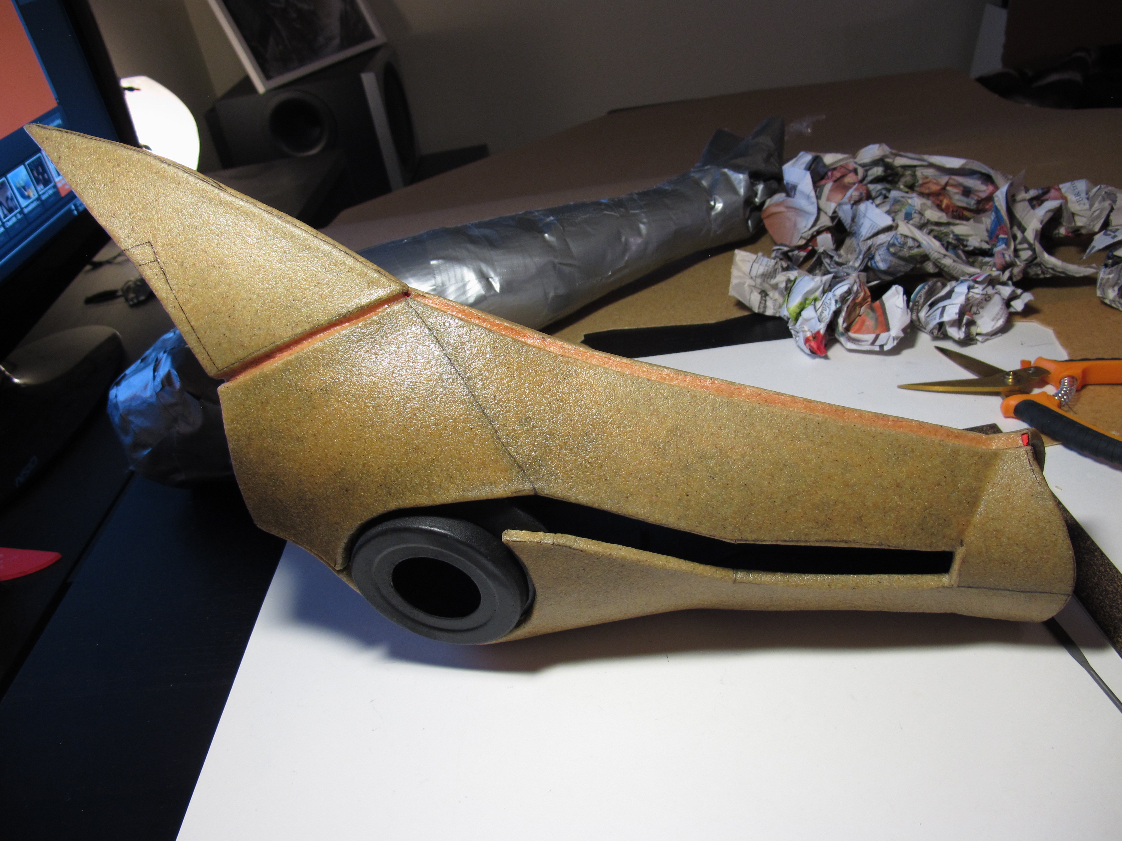

Working on the shin!

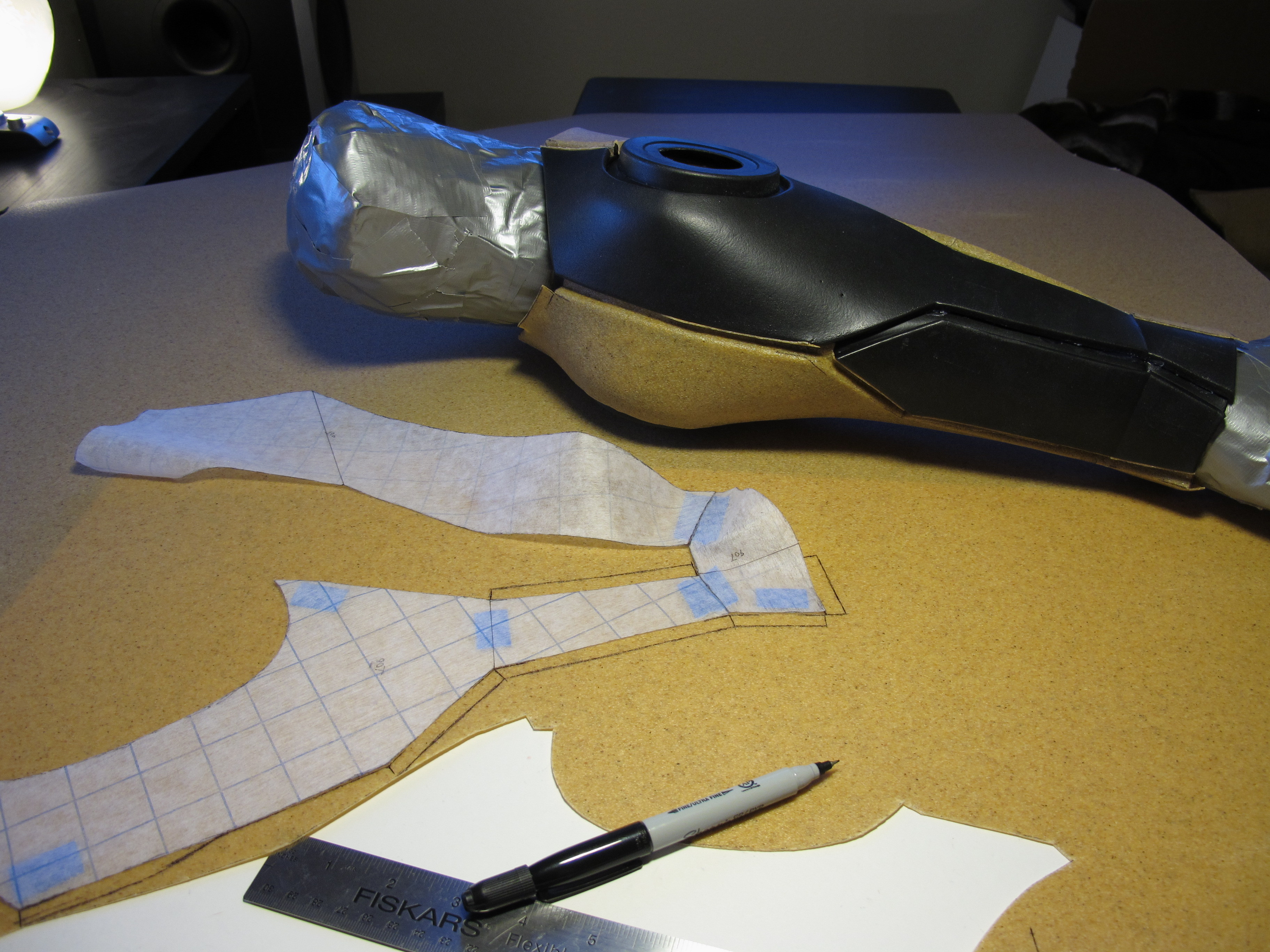

The material with the grid on it is the pattern "paper" I use. It's a fabric-like material which you can find at fabric stores by the yard. It's nice and flexible which makes it way easier to work with than normal paper. I originally made the pattern for cutting the foam shapes out, but now I'm using it again to cut exactly the right shapes out of worbla!

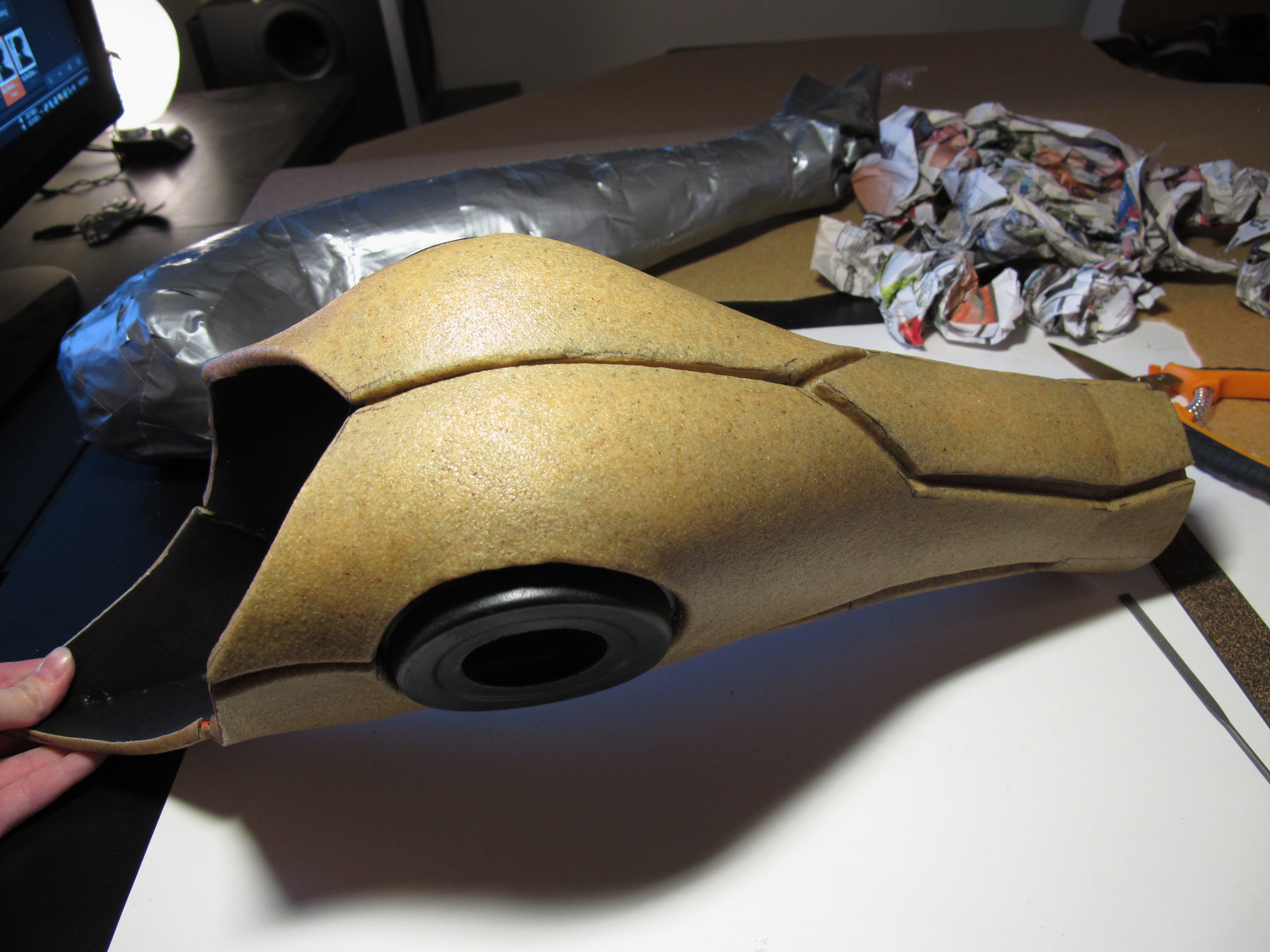

Worbla is so awesome. It allows me to stretch the foam into shapes it would never hold by itself. Here I've warped the left side to be much more rounded:
Subtle curves just make this piece even more amazing. : D
I still need to reinforce the inside with worbla, but it's almost done!

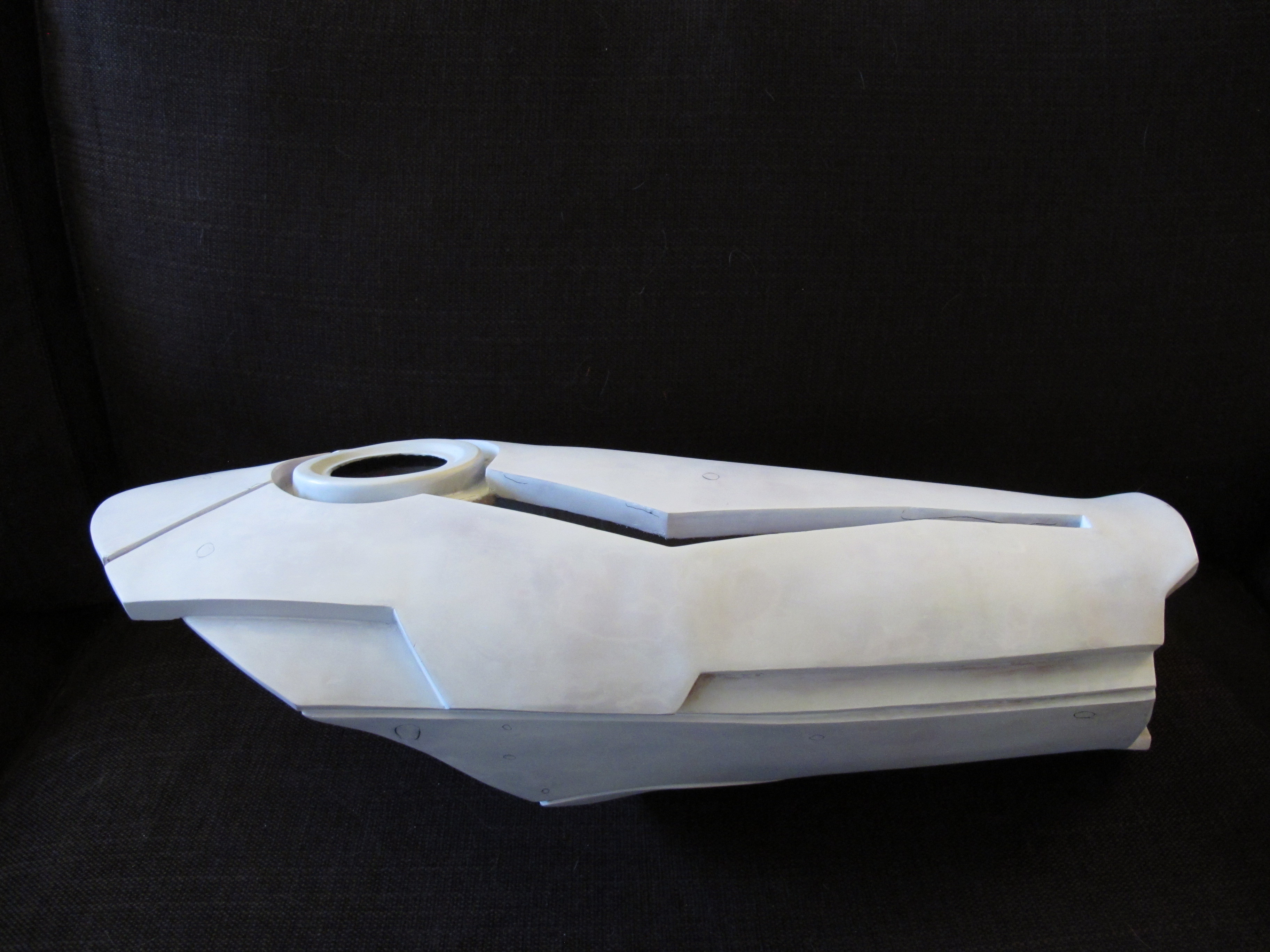

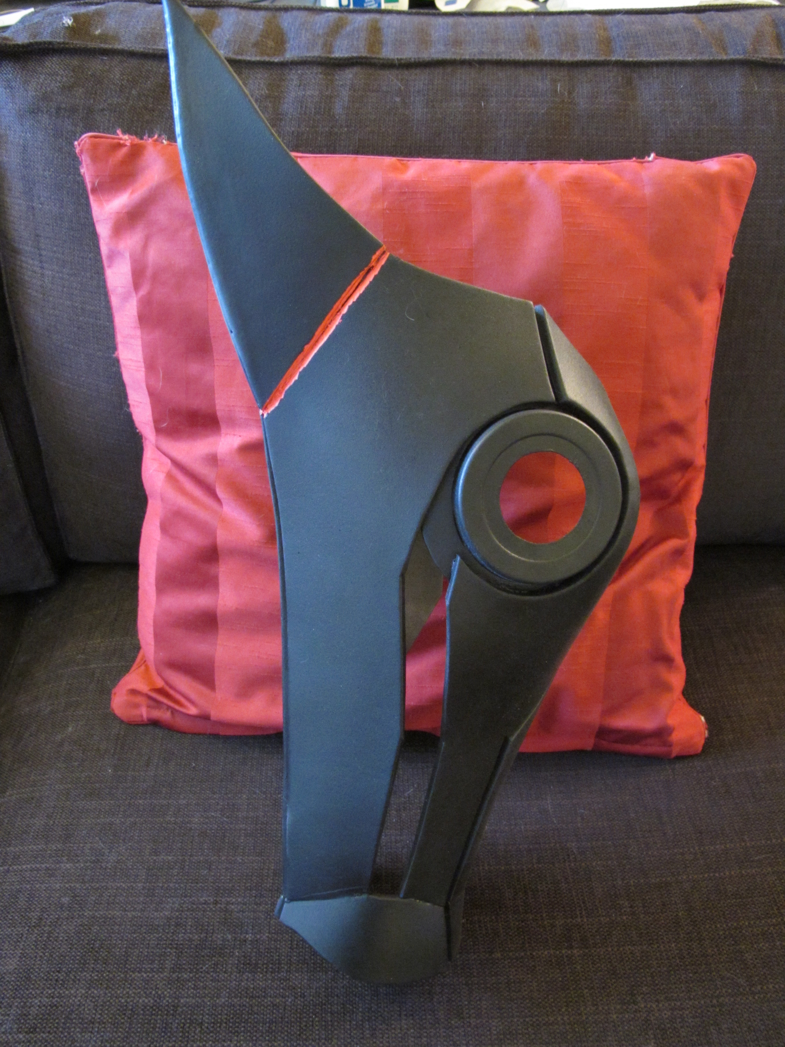

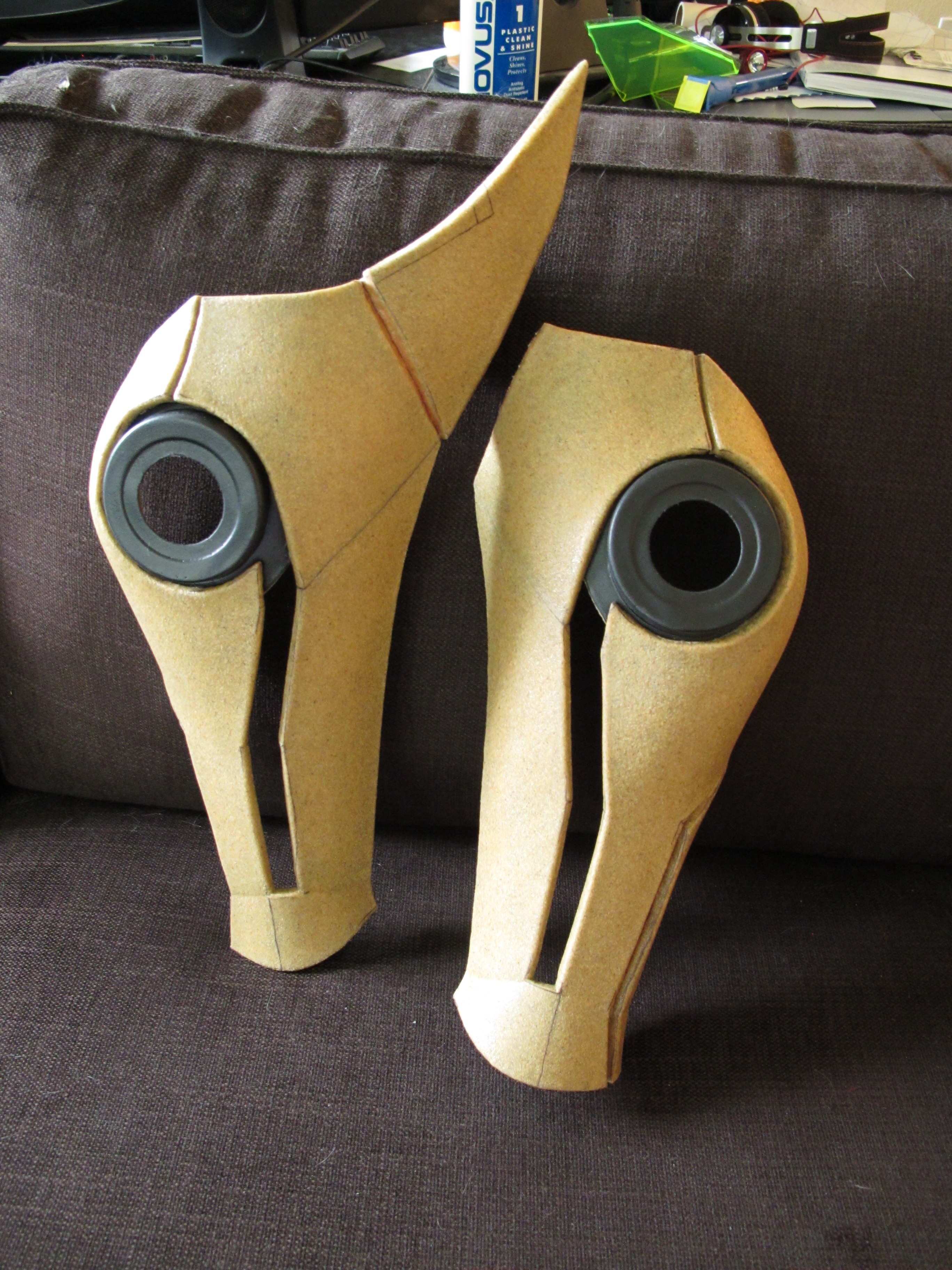

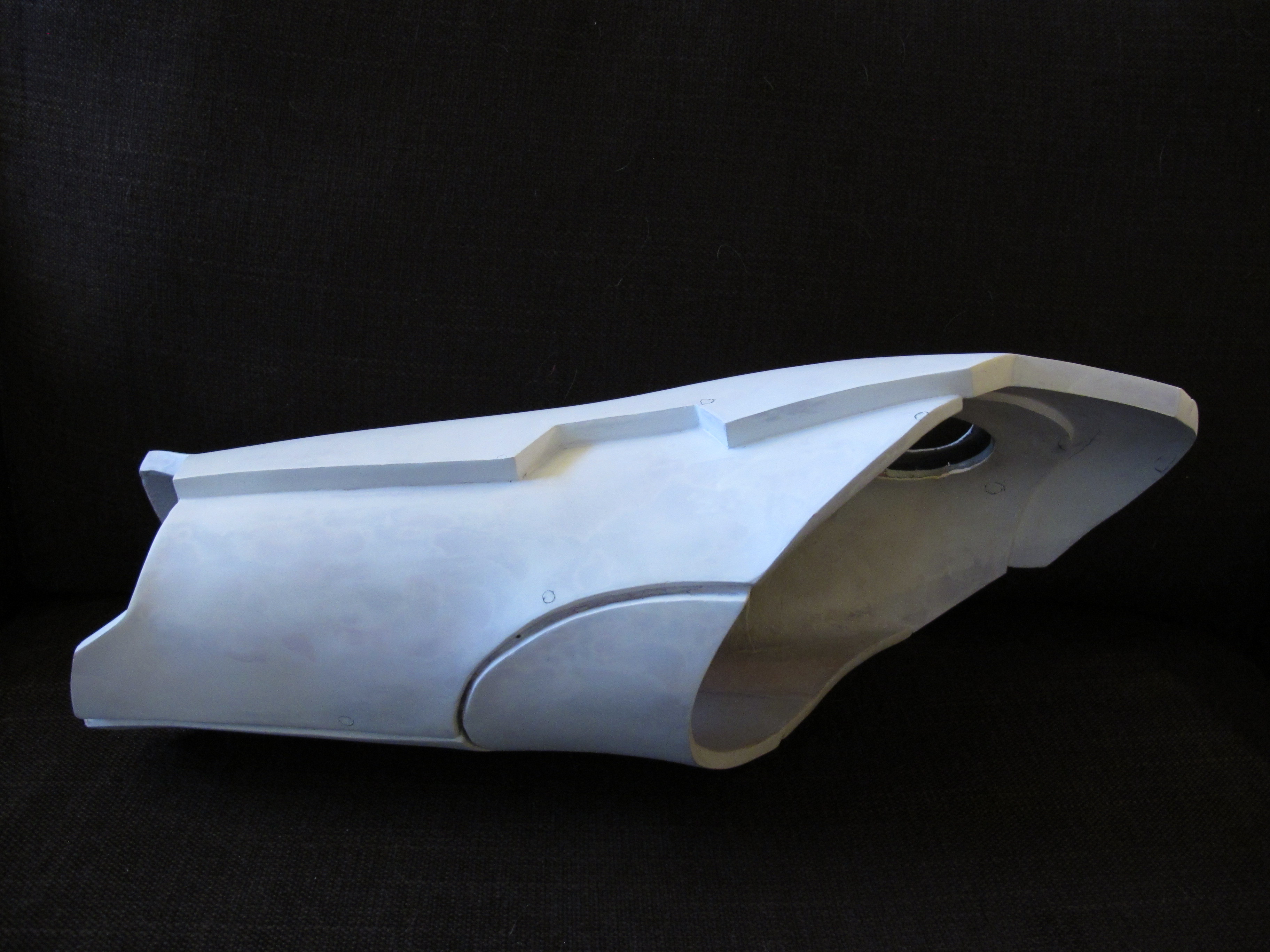

Okay, so lesson learned. Don't put bondo on worbla...at least not without roughing it up first with sandpaper. Bondo doesn't adhere to raw worbla so it just peels off. So far my tests of sanding worbla with 80 grit before applying the bondo appear to be working though. Previously, for the first thigh, I had applied a layer of wood glue before the bondo. While that seems to hold the bondo on it causes issues while sanding, mostly because the glue sands slower than the bondo which causes more bumps. What a headache.
I'll be spending the rest of today bondo'ing stuff, but I did a few other things recently:

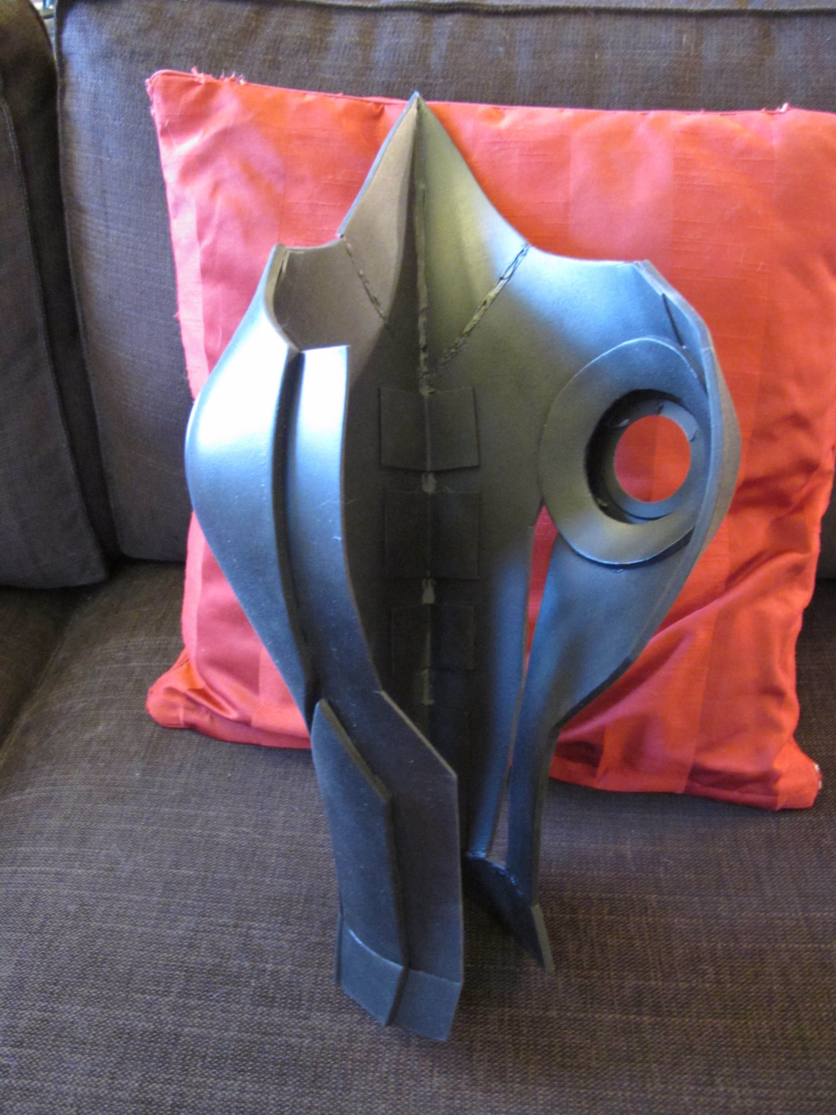

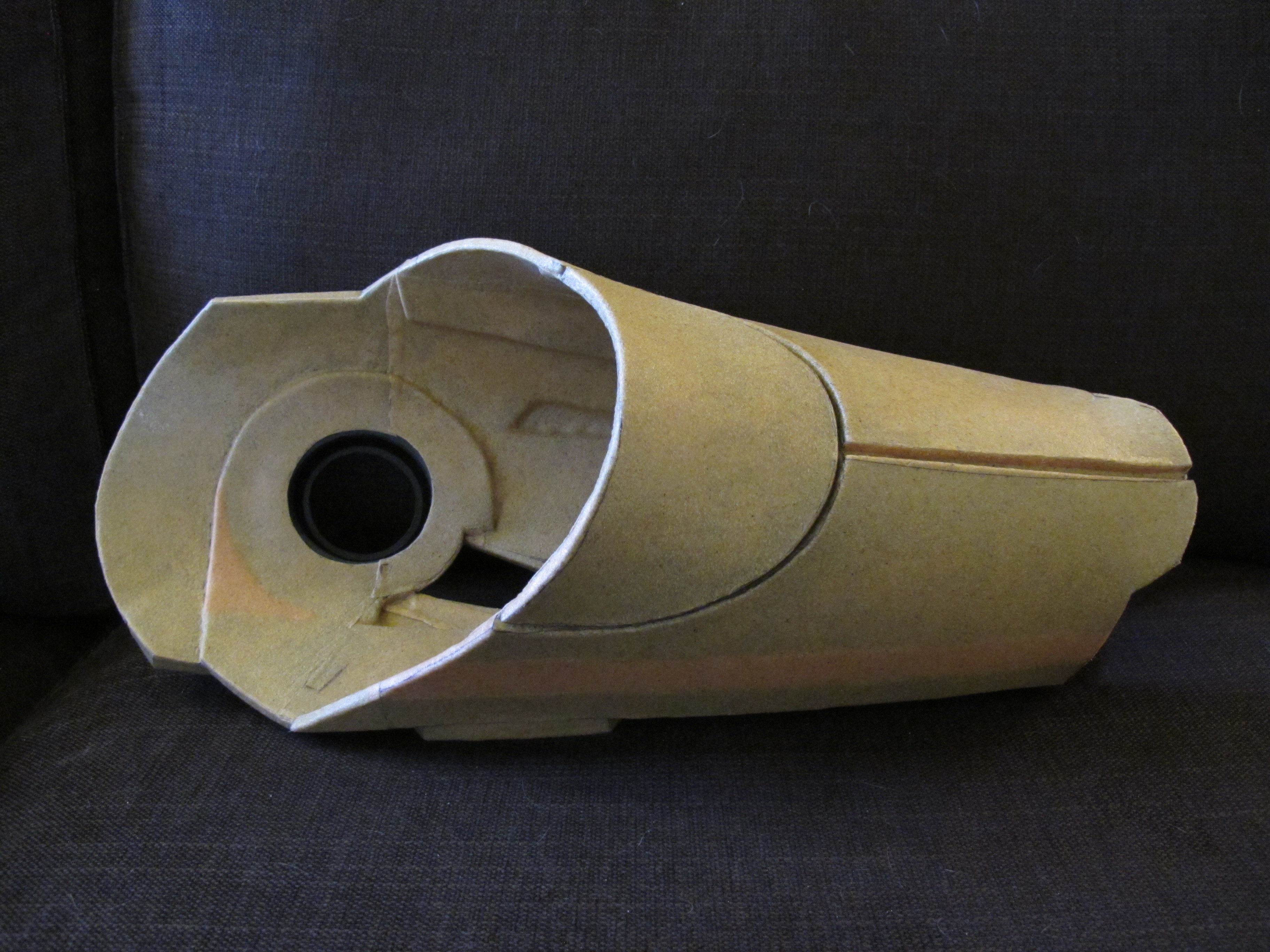

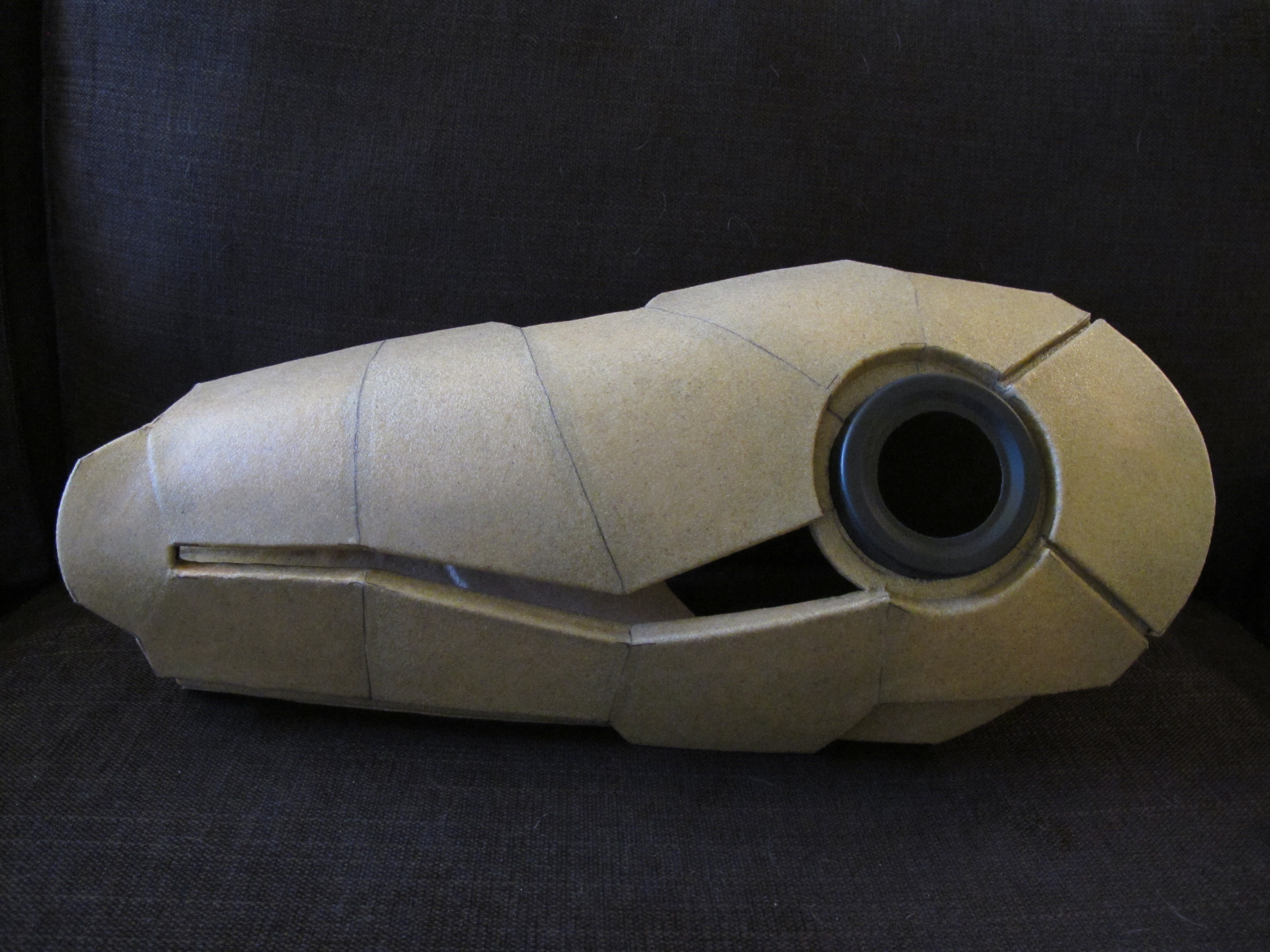

I finished worbla'ing the first shin (reinforcing the inside and cleaning up edges and seams), then cut it in half. I haven't cleaned up the cut edges yet.
It's very, very snug; comfortable, but I'm a little concerned about fitting lights down the sides if it's pressed up right against my leg. There's no real easy way to make more space inside, so I started re-thinking the kind of lights I'll be using. I did a bit more research and now I have my hopes set on EL tape. I knew about this before but ruled it out because EL wire is very dim, so I assumed the same about EL tape. This tape, however, seems to be made more for commercial uses and I'm betting it's pretty bright, at least bright enough for me. I ordered a sample which should arrive in 1-2 weeks. I'm so excited to see it! It comes in different widths, can be cut, and comes in the perfect color: "kryptonite".
If this works out this will make things SO much easier. *crosses fingers*

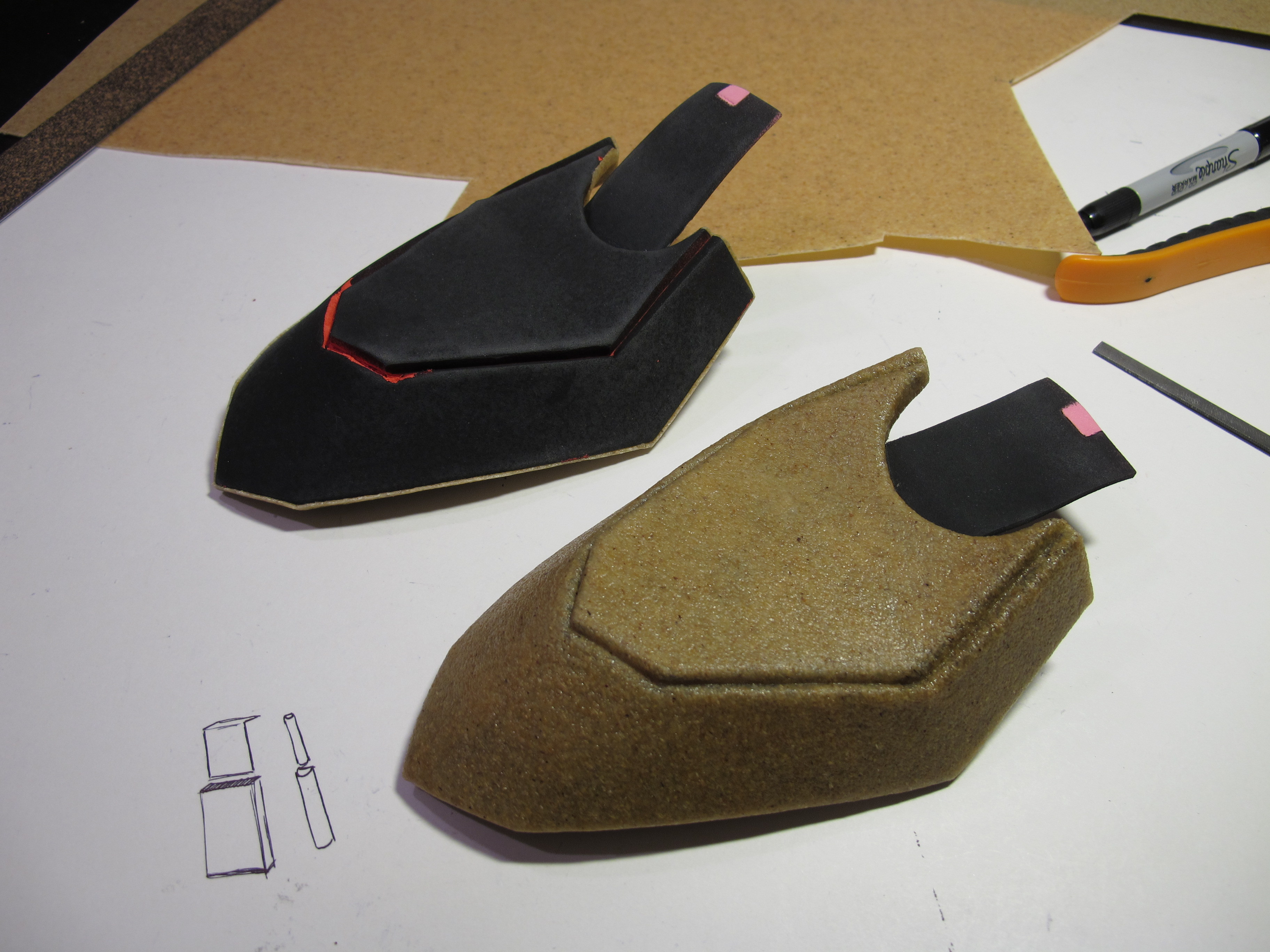

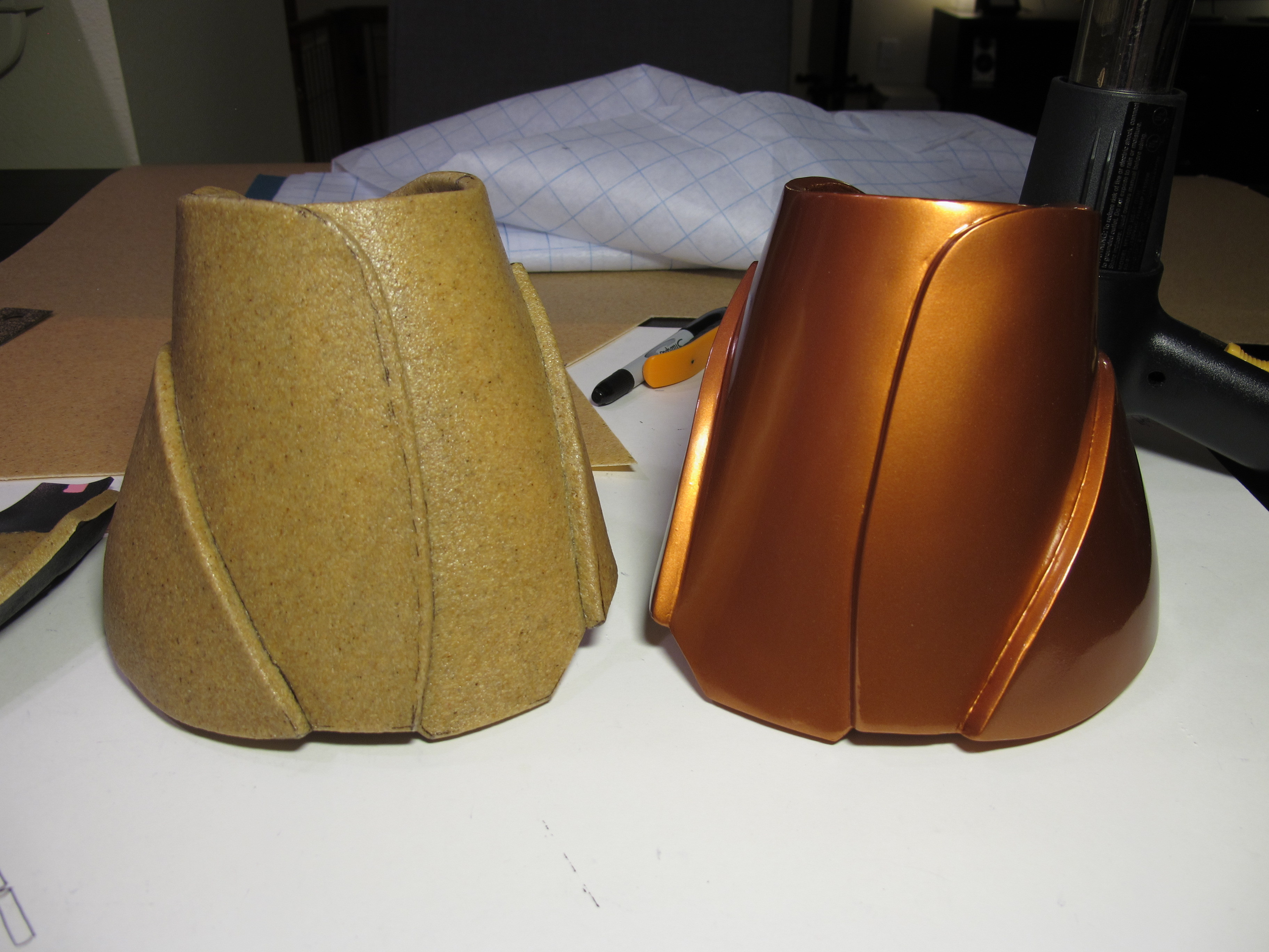

I also worbla'd the second bicep and both shoe tongues, which just leaves the last shin to worbla! I'm holding off on doing that until I figure out what exactly I'm doing with the lights.

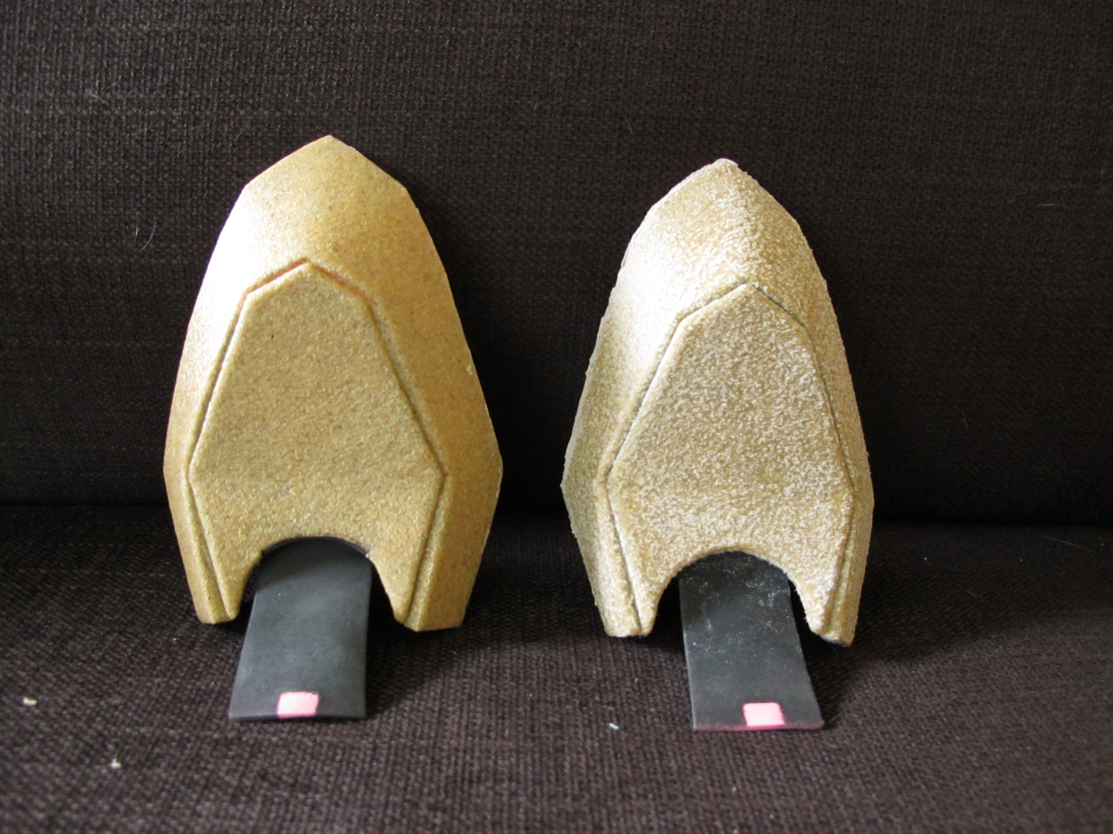

Here you can see the right tongue has been roughed up:
And bondo applied to the inside:

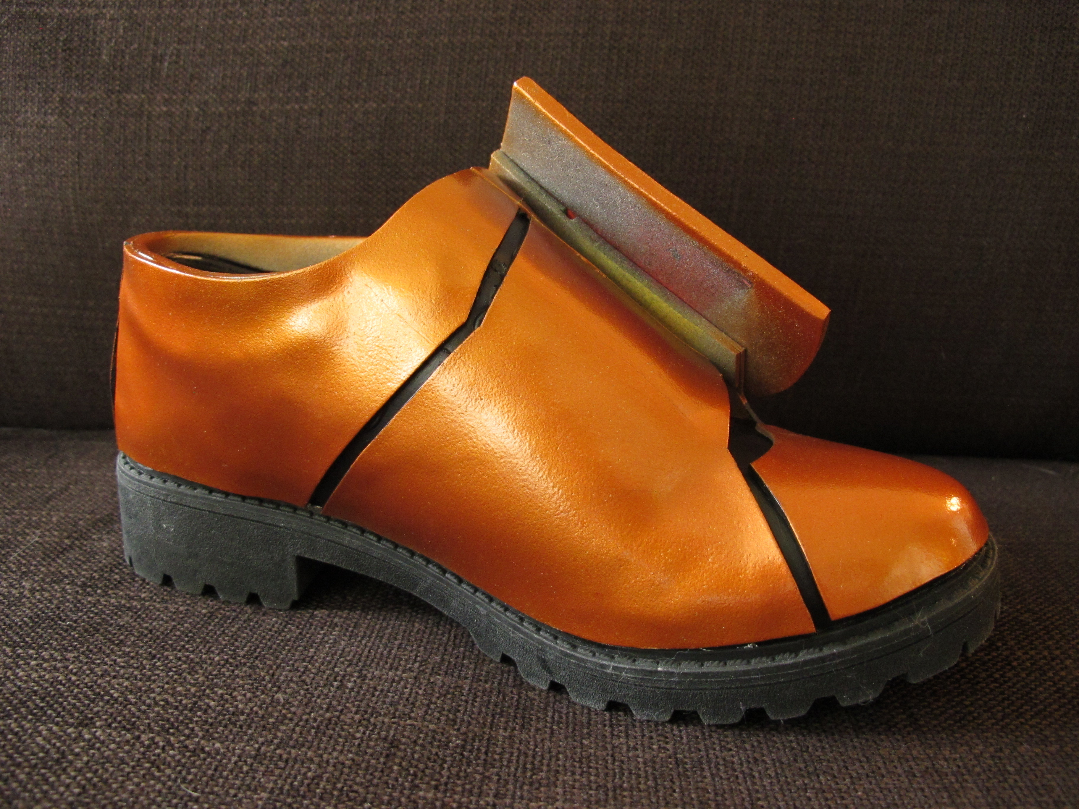

I added detail grunge paint to the crevices of the first bicep, first shoe, and both halves of the forearm armor.

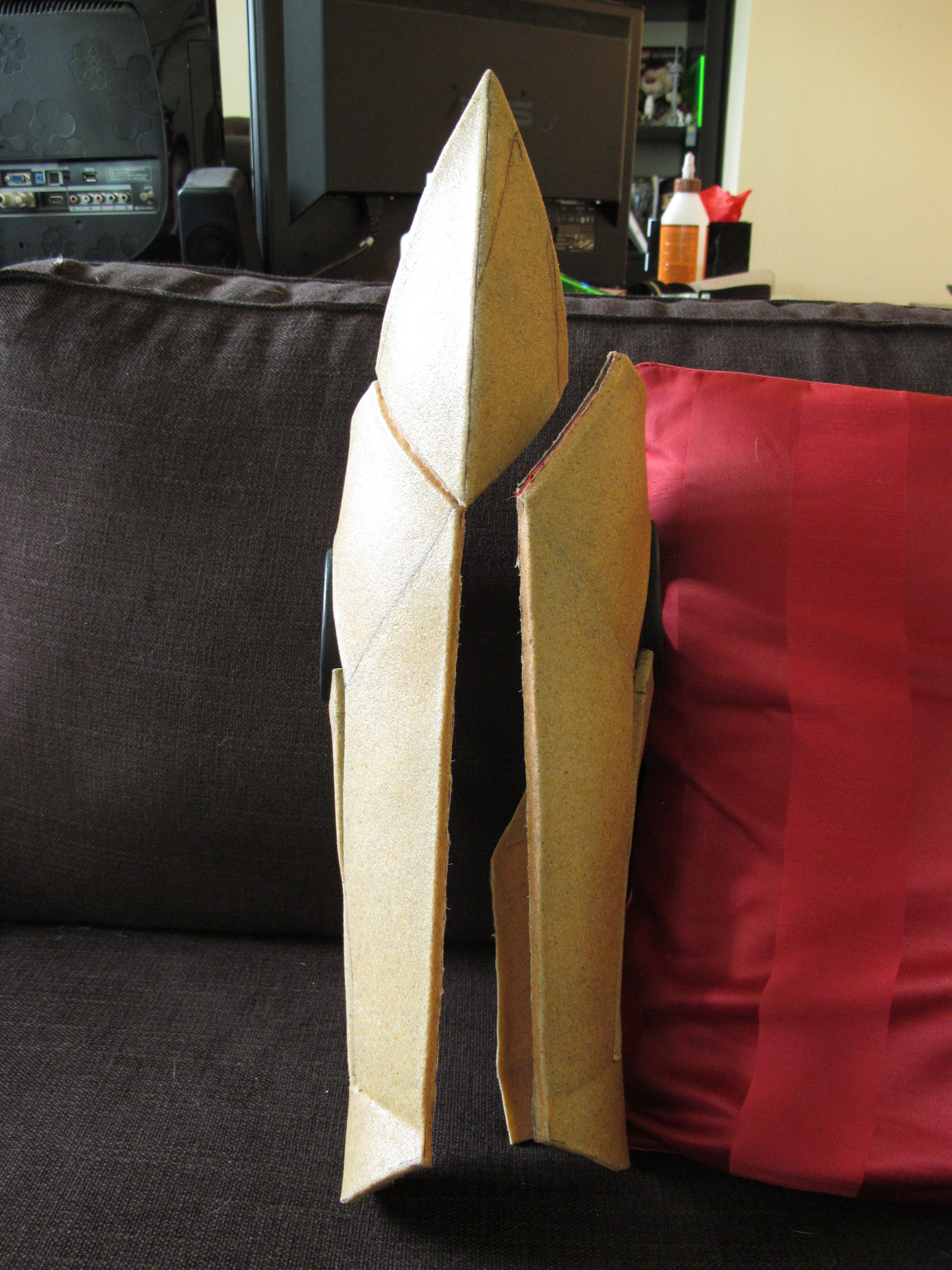

I figured out how to keep the two forearm halves together too. To keep them from moving around against each other I simply hot glued some worbla tabs on the inside, locking them in place when they're lined up. Later I'll add velcro, snaps, or elastic to keep the halves pressed together.
