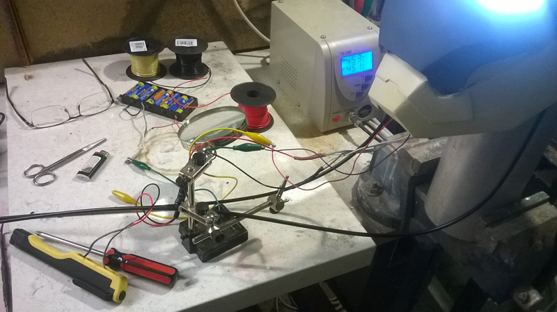

Update:
Had a bit of a solder session and tidied up all the batteries and wiring. I'm just using AAA and AA for now, but will eventually change to LiPo once I advance it all a bit.
Eye lights and video glasses are all one unit now. Easy in, easy out.
And a quick motivational shot with all the lights going.

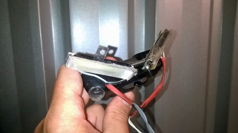

James tidying up the LED strips for the eyes

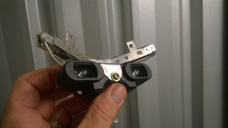

Tonight I drilled the hole for the camera and hot glued it into position to test it. I've got to fiddle with the camera angle and depth to get it exact. The external hole is 10mm but the rim of the camera is 1mm thick and can be painted to match the shell of the faceplate, reducing it's footprint to 8mm diameter. With a clean-up, paint and the lights on it should be pretty hard for anyone to see it.
I did some practice walking in the house and performed some simple tasks in the kitchen, wearing the glasses and camera. It's obviously a little different from normal vision and will take practice and some getting used to, but it is FAR better than the standard narrow slots under the eyes as seen in other suits. No more crashing into things and wondering if I'm on the last stair or not. I am one happy little Mr Stark.
I then designed another all-in-one bracket so the camera, video glasses, eye lights and battery/command unit for the VG's will all pull out together by undoing just two screws. Tomorrow I'll fabricate and install it.
Photo showing position of command/battery unit. (An attaching arm for it will be welded onto the eye bracket.)
Bendable mounting tab of the camera, ( narrow end of tab to be welded to eye bracket)
