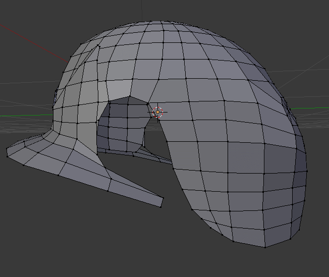

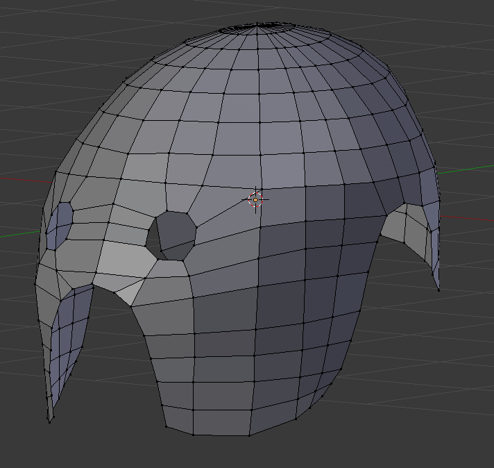

I've been wanting to make one of these cool helmets for a while, but couldn't find any files online. So here is one I've created from scratch in Blender.
Uruk-Hai Berserker - Blaxmyth - Download - 4shared
The file is unlocked, so feel free to improve it. It's free for sharing. I'm interested to see what eddyborg can do with this, based on the improvements he made to my ABC Warrior.
The scale is just a guess, where I tried to err on the side of it being slightly too large. The file is in A4, but it's easy to move around to suit Letter. If you're trying it for size, I suggest printing out one of the reinforcing cross tubes and holding them up in front of a mirror - might save some time and card.
I'd love to see any finished peps, or get some feedback as to what the scale should actually be set at.
Have fun. Phil
Uruk Hai Berserker by Blaxmyth 1.pngUruk Hai Berserker by Blaxmyth 2.pngUruk Hai Berserker by Blaxmyth 3.pngUruk Hai Berserker by Blaxmyth 4.pngUruk Hai Berserker by Blaxmyth 5.png

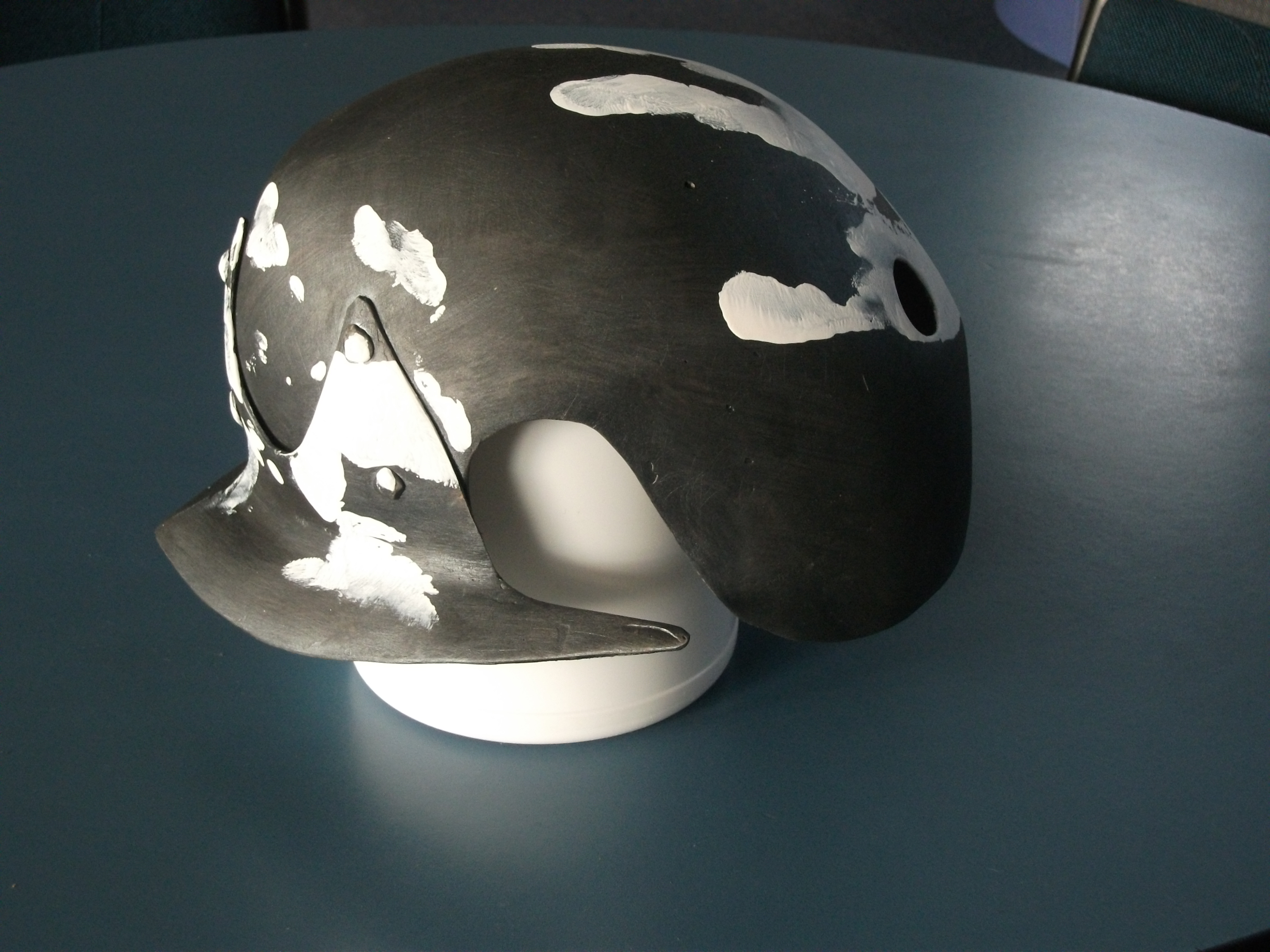

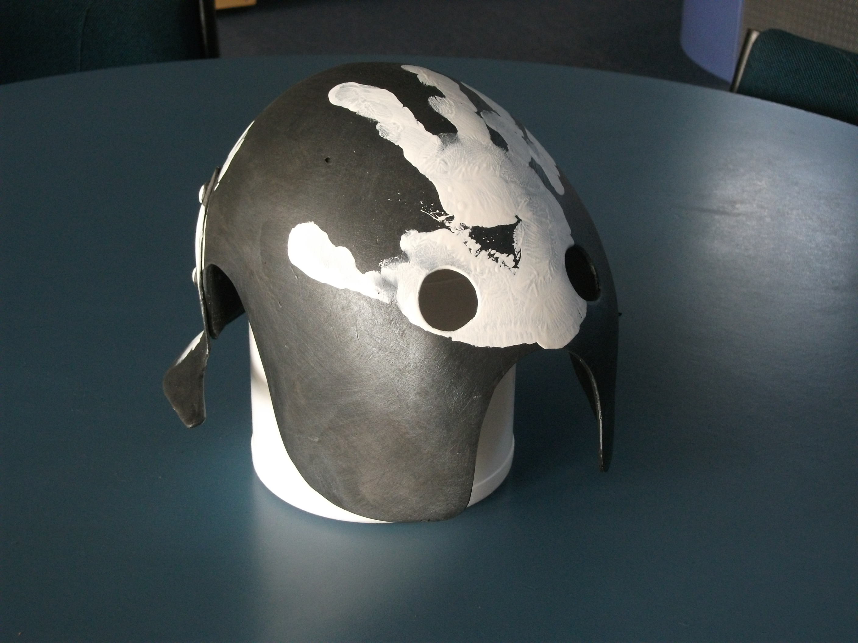

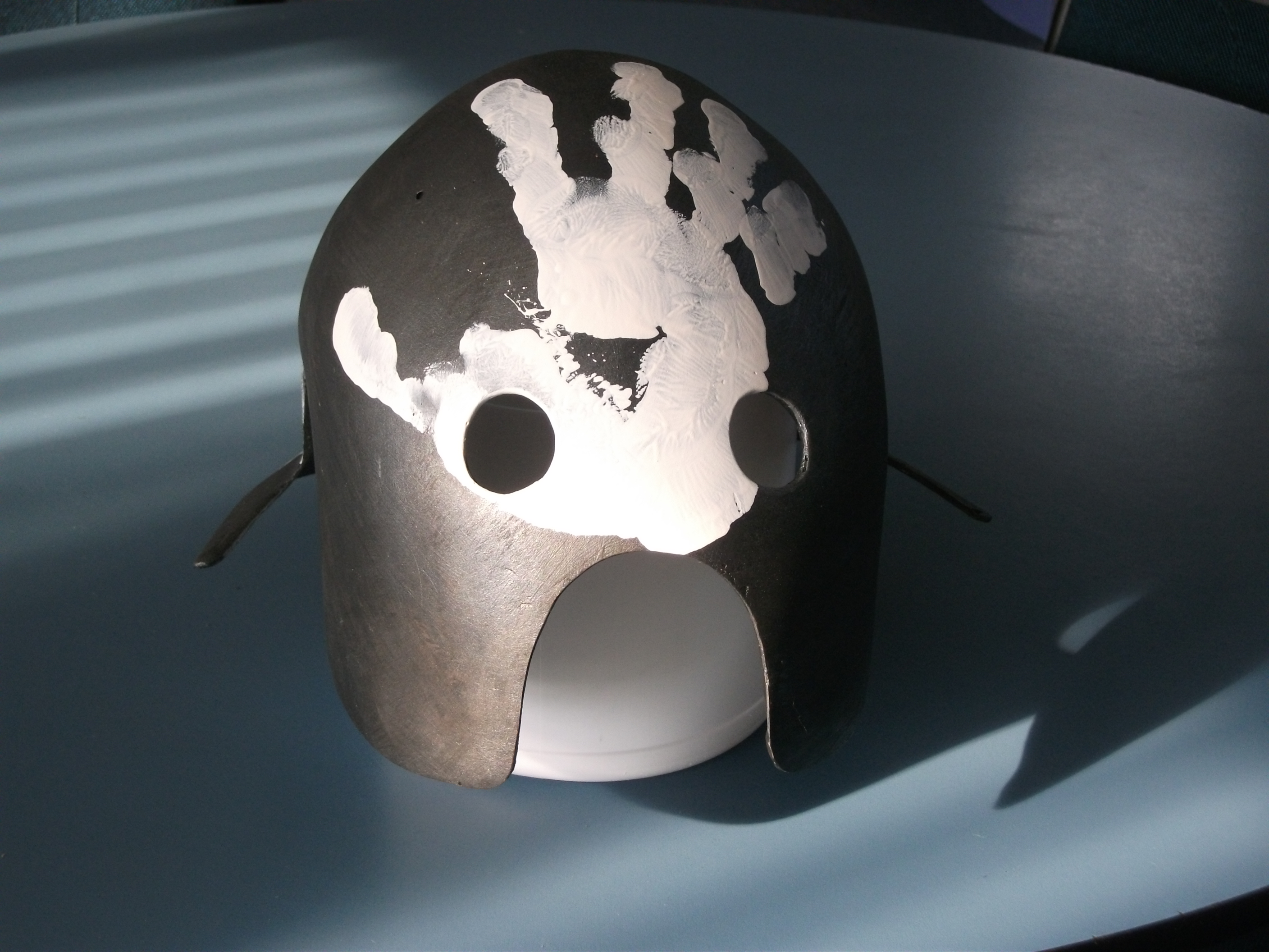

Hmmm – just finished building the one I just posted. It’s a bit too large for me, but would probably be just right for a real 6’ 6” 300 lb Uruk. I’m going to finish it off as a display piece, so it won’t be wasted effort.
So I’ve rescaled it to measure 170mm between the two vertices at the lower front of the ear arches. Also did a version for Letter as well as A4.

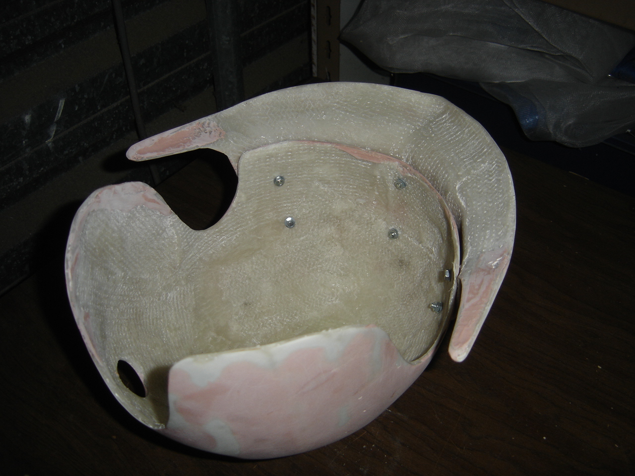

I found this helmet a fairly easy pep to assemble, and I’m going to try the technique of coating the inside of the pep with car wax, rondo-ing and then fibre glassing to add strength. Hopefully I can peel the car off and bondo the outside. Well, that’s the plan…

I've reworked this two-part mesh into a single piece, with a single spacer bar across inside. I've built two of the two-piece peps and while the rim is fairly easy to join onto the bowl, this new file will probably be easier for most.

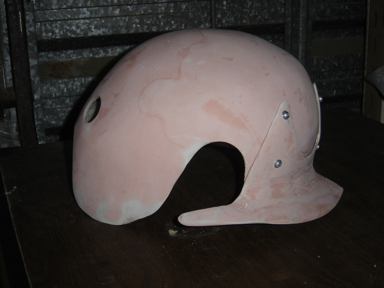

Latest progress shot of my two-part helm, slightly larger than a human could wear. Well, a human with a normal sized head, anyway. Next step is to weather it properly.
Thanks, Xaos! Looking forward to seeing your build.
Yeah, the two-parter is the way to go. I kept the rear three pieces that hold onto the bowl fairly thin so they are still slightly flexible. I used 4mm - 3/16"? - pop rivets to join them, then made fake rivet heads out of Knead It two-part epoxy putty.

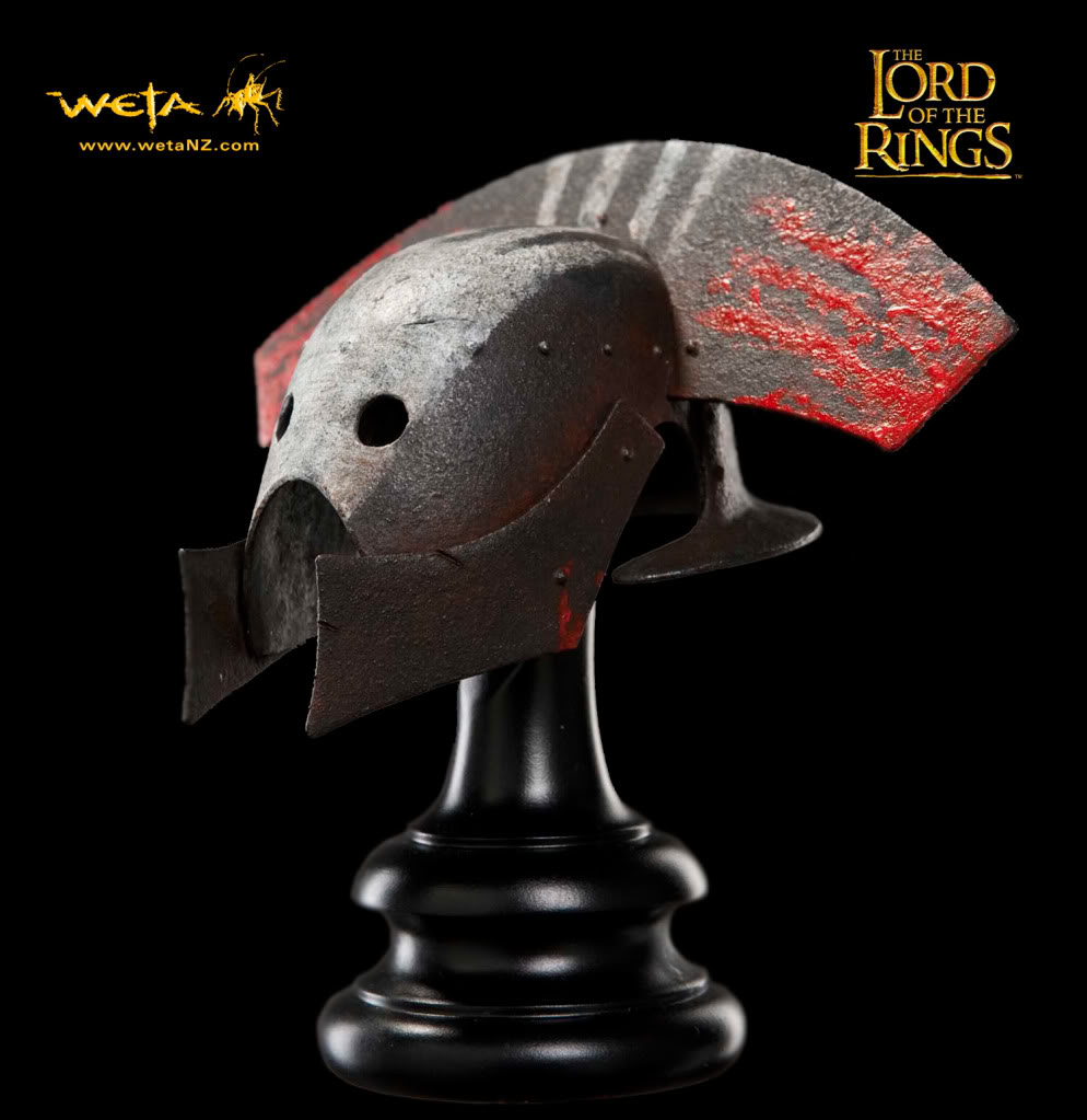

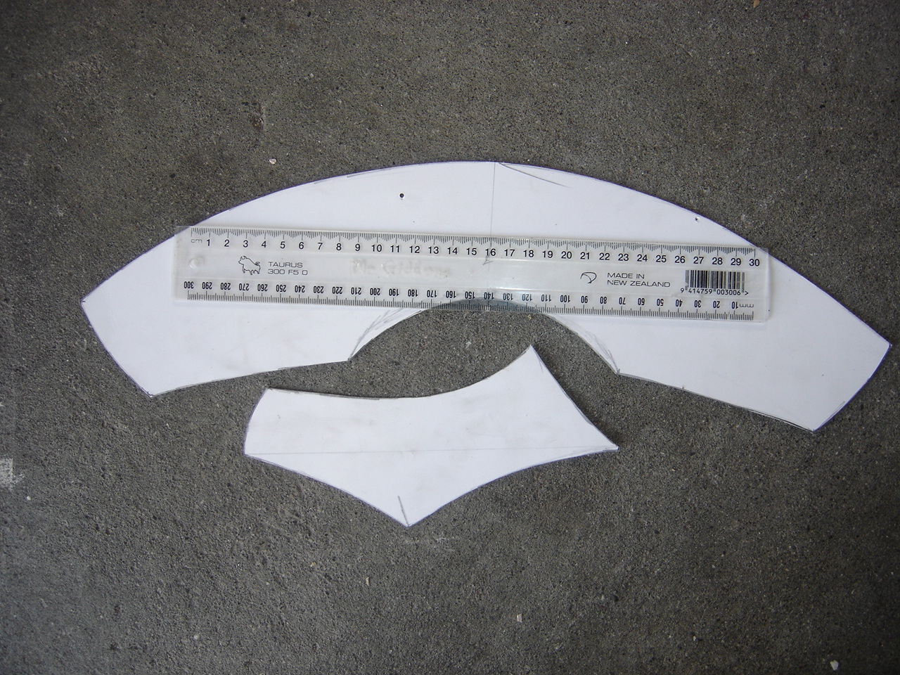

I found some 1.2mm steel sheet in the shed, so made the jowl guards and crest for an Uruk general based on the Weta mini helmet.
Created some templates from cardboard. The pic with the ruler is taken from directly above, so should have minimal parallax distortion.
