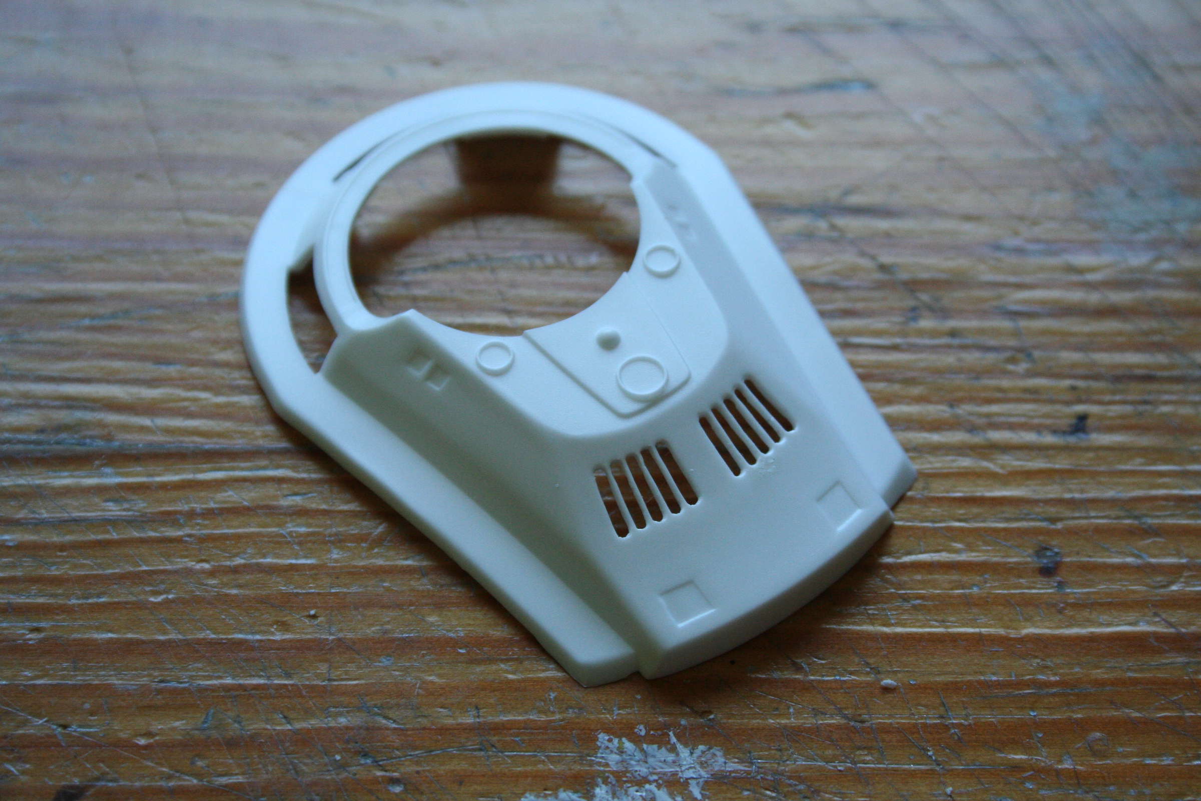

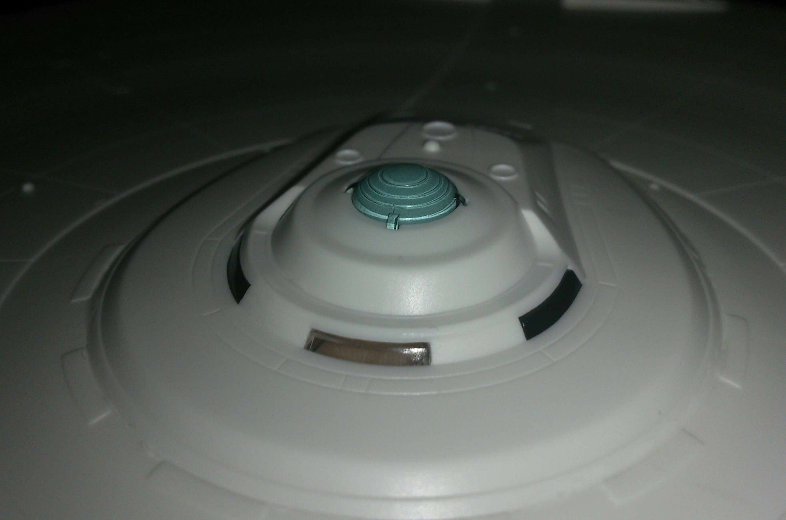

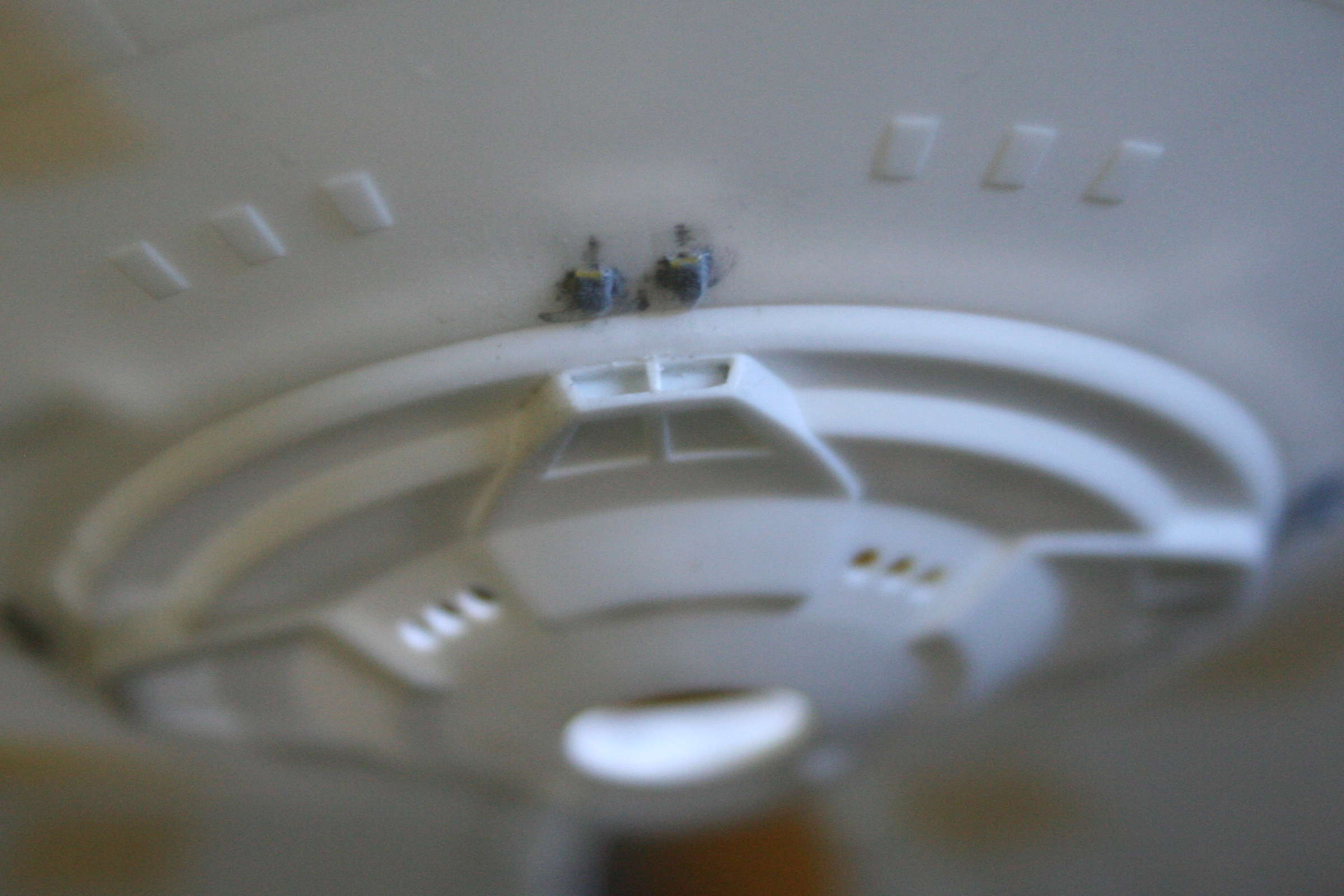

But first I need to finish the disc modifications and filling work. Did some progress during the last two days. The spotlights are almost ready for primer. Then I drilled out some additional windows behind the bridge:
Since these are never lighted in the movie, I already glued a piece of styrene behind them. I will give them a dark wash after painting and let some gloss clear run into them afterwards.

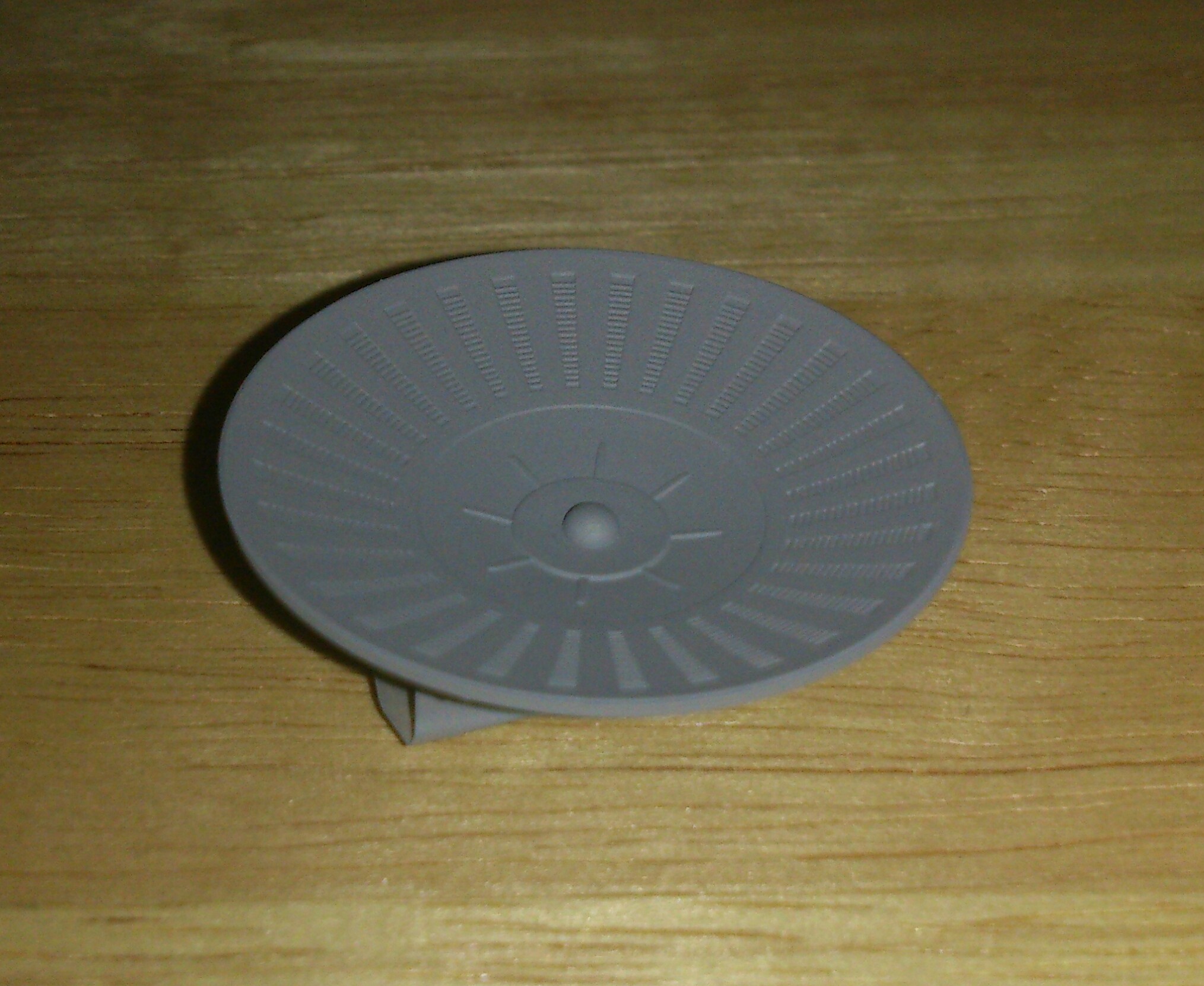

I also discovered another minor inaccuracy on the bottom saucer. The outer surfaces of the cross-like part that goes into the middle miss some holes, and the sidewalls are straight on the model but should be angled a bit. So I first drilled out the holes and gave them the correct shape. Pieces of styrene were glued behind them, and a small strip of 0.5 mm sheet was added in the middle. Afterwards, the sidewalls were sanded to the correct angle. Now the engraved detail on the bottom surface doesn't follow the edge anymore, but I'm not sure if I'll try to correct this, too. It's really a minor problem.
When the glue and filler is dry, I will have a last sanding session, then I'll might be able to spray the primer on for the first time.

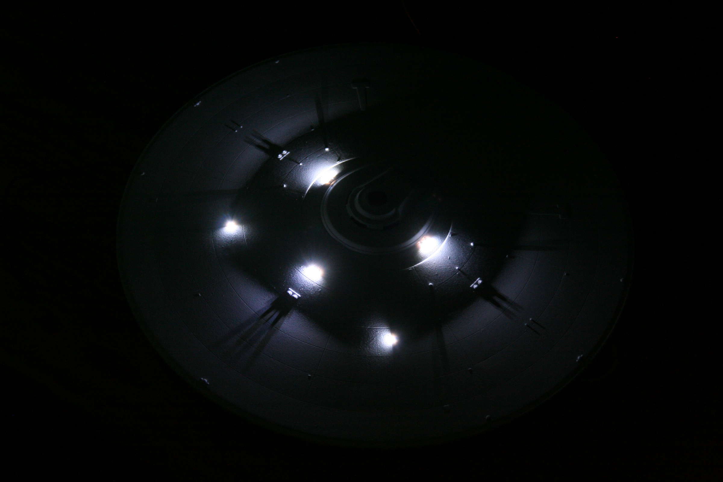

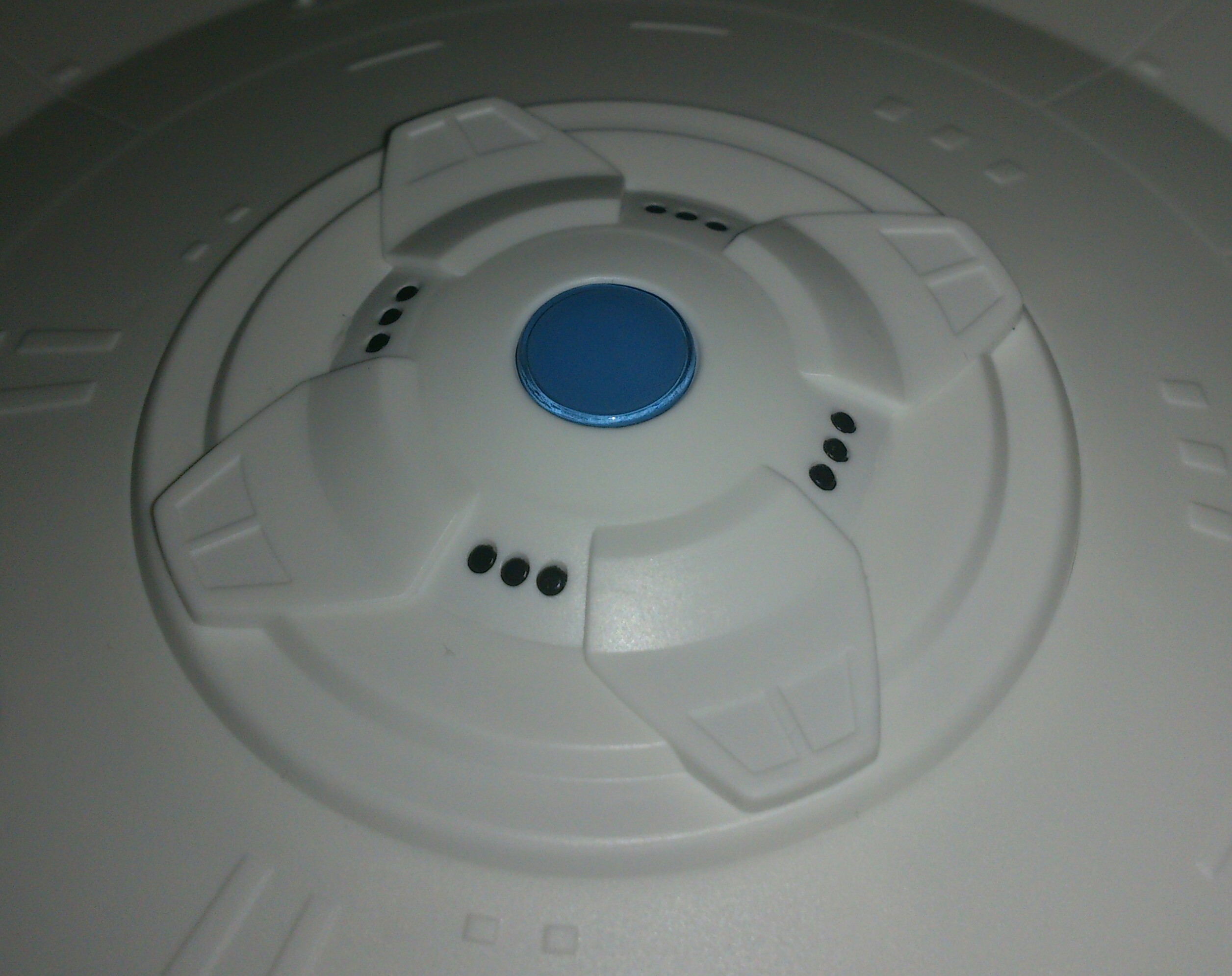

I spent the remaining day with some more sanding until the saucer parts were finished for the primer. I used a layer of the grey Tamiya primer on each side, followed by a second coat of Revell primer which comes out white for easier painting afterwards. Unfortunately it left me with a very grainy surface, so I had the joy of more sanding.

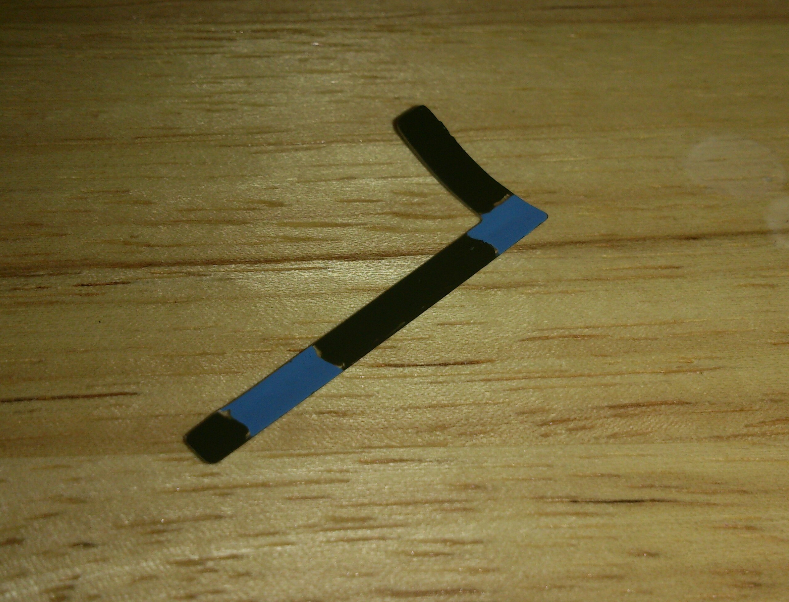

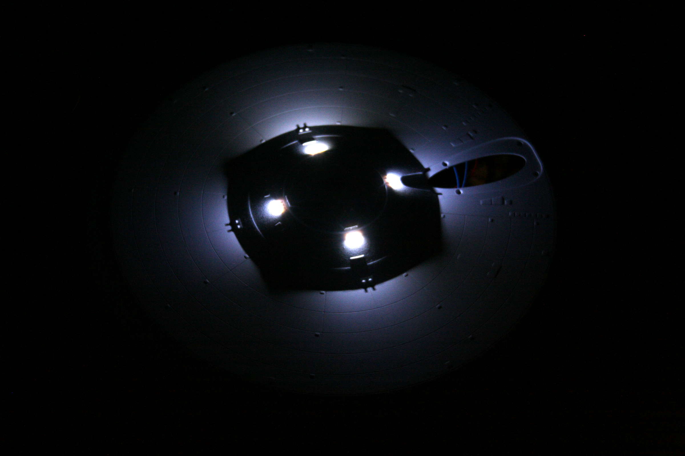

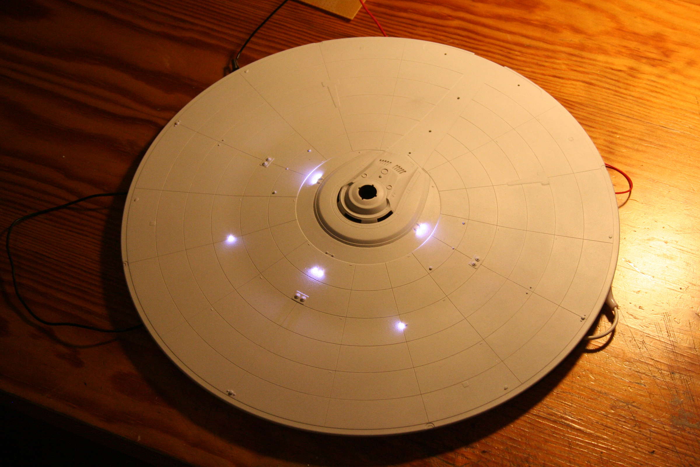

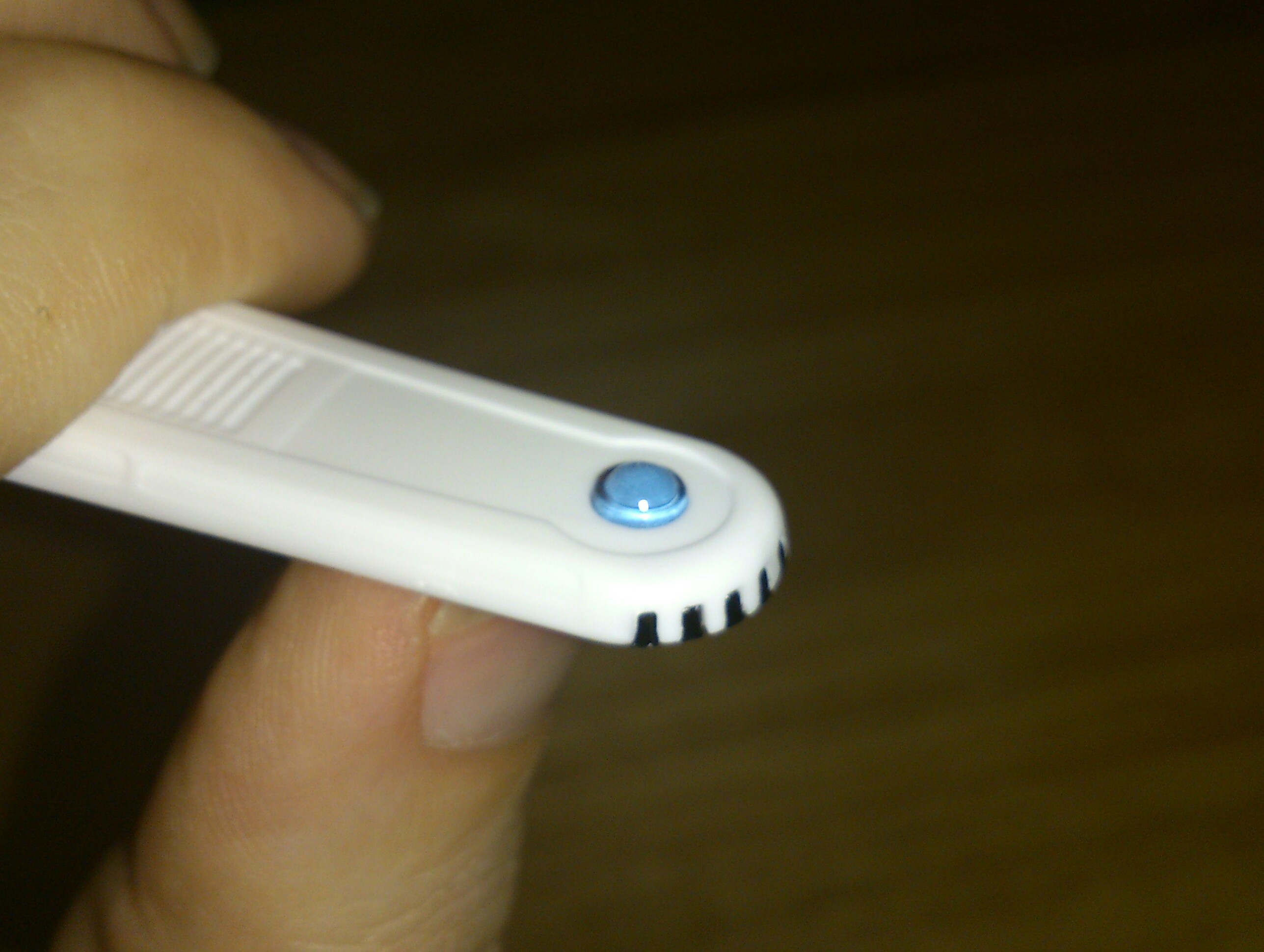

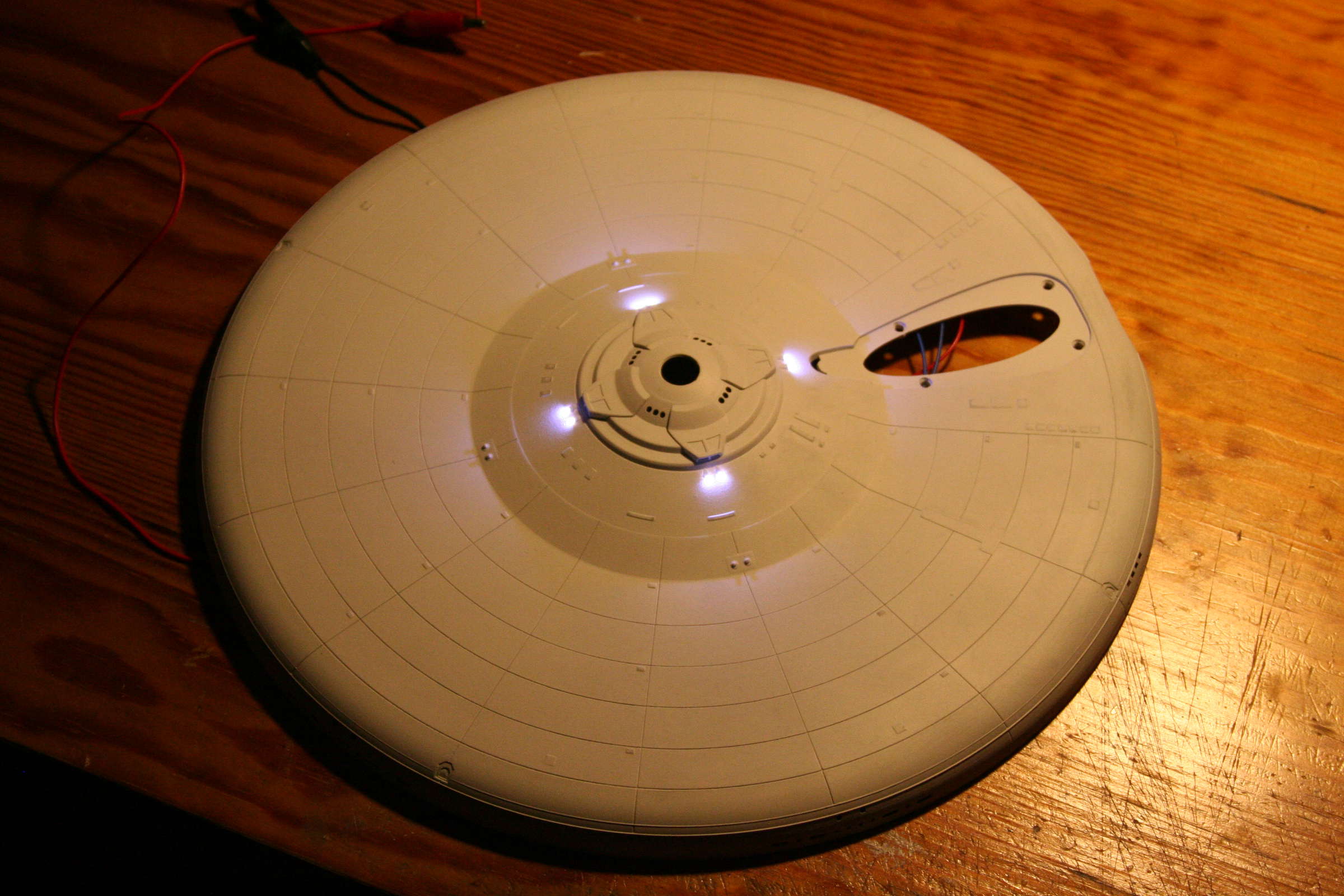

Then the hour came to get out the soldering iron. I grouped the LEDs to sets of two, which were connected to resistors of 680 Ohms in series. This is required for the power source which will be a 9V battery. After some nerve-wracking moments caused by bad connections I'm proud to finally show you the results:
At room light:
In the darkness:

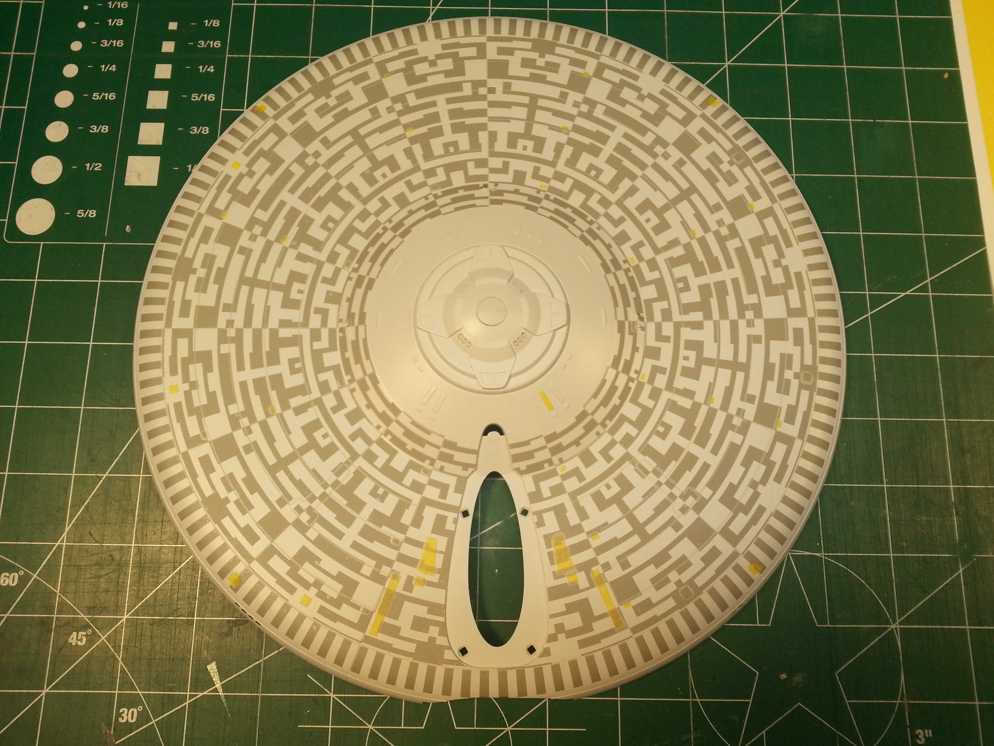

For the aztec sheme I will try the following:
I'll do all the masking work on my own and do it in a basic two-tone sheme (and the blueish areas respectively).
Then the fun starts. I'll try to replicate the interference effects using the PearlEX-pigments highly thinned with clear paints of various glossiness. I read good reviews about those pigments on a Refit thread, and as the effect is also present on the JJPrise, I'll give them a go here.

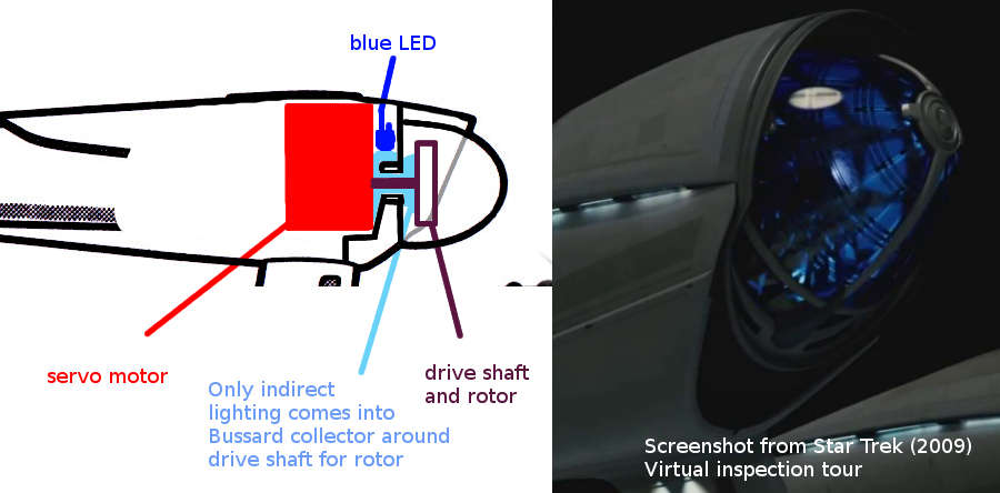

I didn't do a lot of research yet about the engine nacelles, but this is my preliminary plan (left hand side):
Around the rotor drive shaft the hole will be a bit wider to allow some diffuse blue light to enter into the Bussard dome behind the rotor. If you look at screenshots of the movie (or the virtual tour, right hand side), you see that the light is very dim and no direct light source is noticeable, in contrast to some builds which place a bright blue LED directly into the dome. I hope that my idea will replicate this effect closely. Of course I will give the clear part some layers of clear blue color with the airbrush.

Near as I can tell, in the 2009 movie, the blue light in the domes is from a ring of light on the walls of the inside of the nacelle tube. Just imagine a ring of blue light sitting behind the blades. This light then bounces around in the blades and dome to create the lighting effect. I have a CG model of the JJprise, and can test this theory if you guys would like by simulating it with CG (but physically accurate) lights.

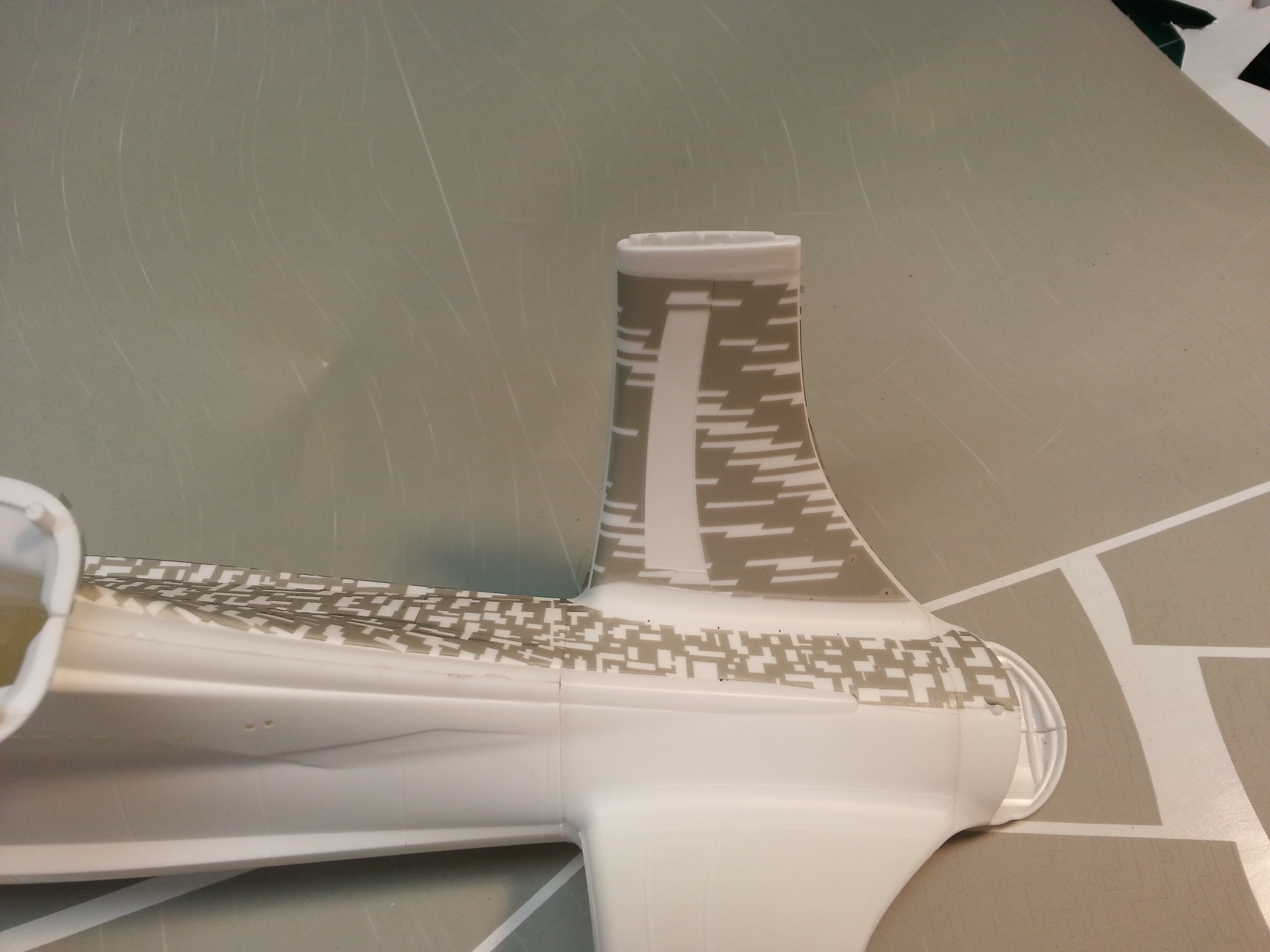

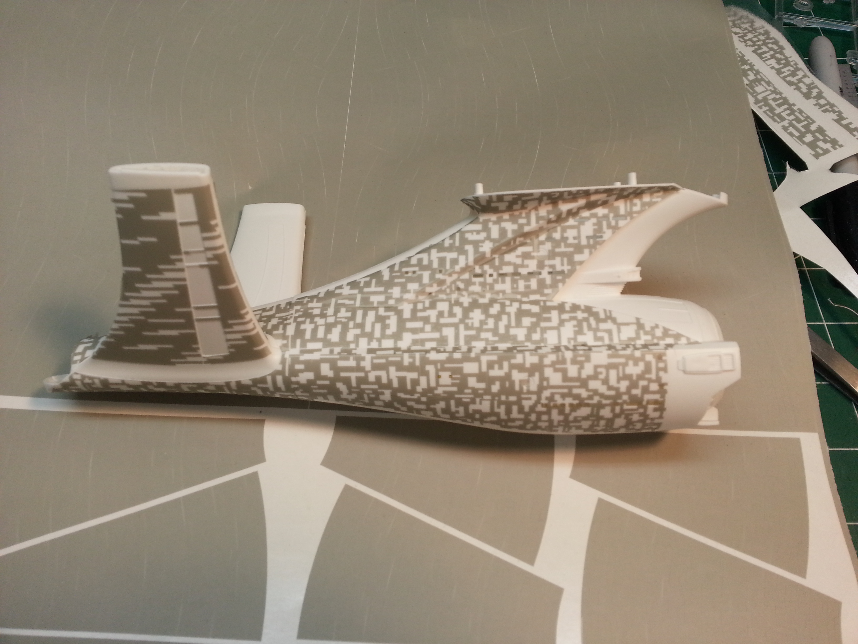

Hi folks,
Just wanted to let you all know, my aztec paint mask set will be available Monday June 23rd.
I'm putting the finishing touches on the nacelles now & working on the instructions.
This will be another in my line of "complete masking solutions" with aztecs, windows, & a lot of the accent colors.
Here are a couple of teaser pics! Ignore the color issues, I don't have the best camera.

DanielB, thanks for the offer! I almost did a CG model of the Bussard collector on my own for this but decided that I have enough confidence that my plan works. And there's not too much room for different approaches to depict it in the model. It seems that in the original model there is a light source in the middle of the rotor which extends into a flower-like stucture to the front, but as with most lights on the ship it seems as if the CGI-people did some tricks to get the look we see on the screen (there are more spot light cones on the ship than it has lights). There is also a mirror at the front cap of the collector which reflects the light back. But I don't see a way to replicate this as it would require a hollow drive shaft for the rotor and a sliding contact for the LED's power. This is clearly above my ability.

Are these masks done out of vinyl or the stuff that you put tape over to transfer them to the model?
Both, the mask materials are vinyl & kabuki tape, & transfer tape is provided with the kits. Transfer tape can be used on any type of masking.

Hi folks,

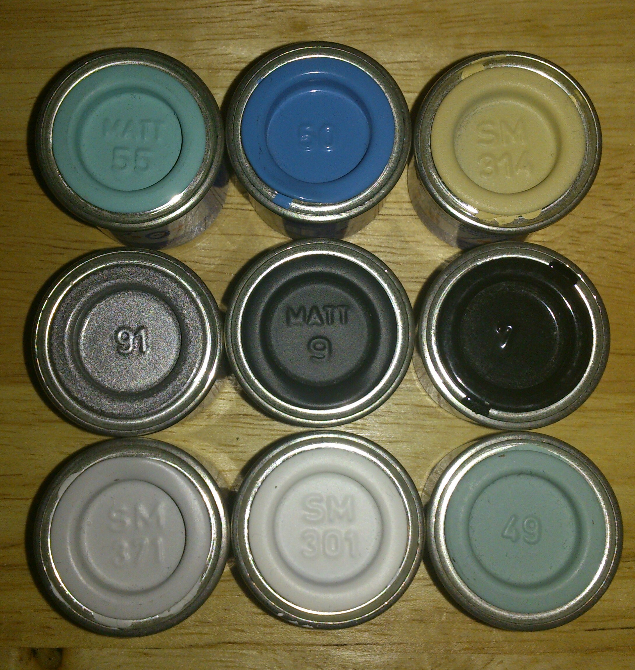

Thanks, just found them. Can they be mixed into clear acrylics? Namely revell aqua colour gloss clear. Won't be using them on this as I really don't have the confidence with airbrushing yet. However now that I have a source for the pearl colours it might sway me towards the 1/350 refit as my next model. Have a can or two of tamiya pearl white lying around from my 1/1000 build so will be a good base on the 1/350.
Also, for anyone who is using revell paints, sm314 is a much more accurate colour to screen than the white/yellow mix given for colour callout J. An 85% sm371 and 15% 49 gives a much more subtle and less garish colour than than the callout F. Matt 9 also gives a better colour on parts B 74, 75, 76, 77, part J 63 and part K 51.
Some of the colour mixes and callouts by revell are shockingly inaccurate. They have bits that are meant to be black with a hint of blue light painted yellow. Areas that are meant to be mainly copper/bronze they have in completely clear blue.

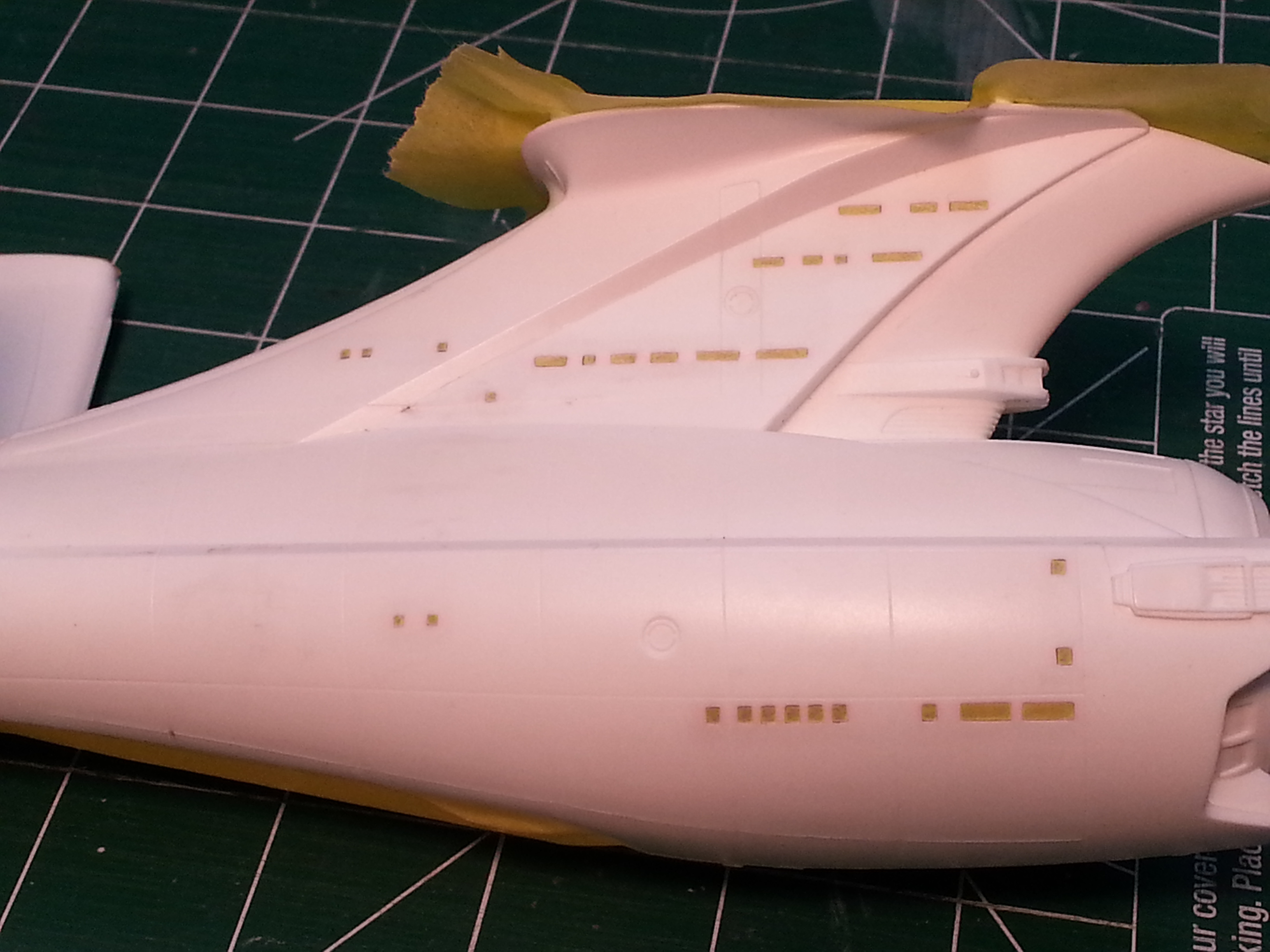

Right, first up the PNT decals:
No idea of release date or price for these yet.

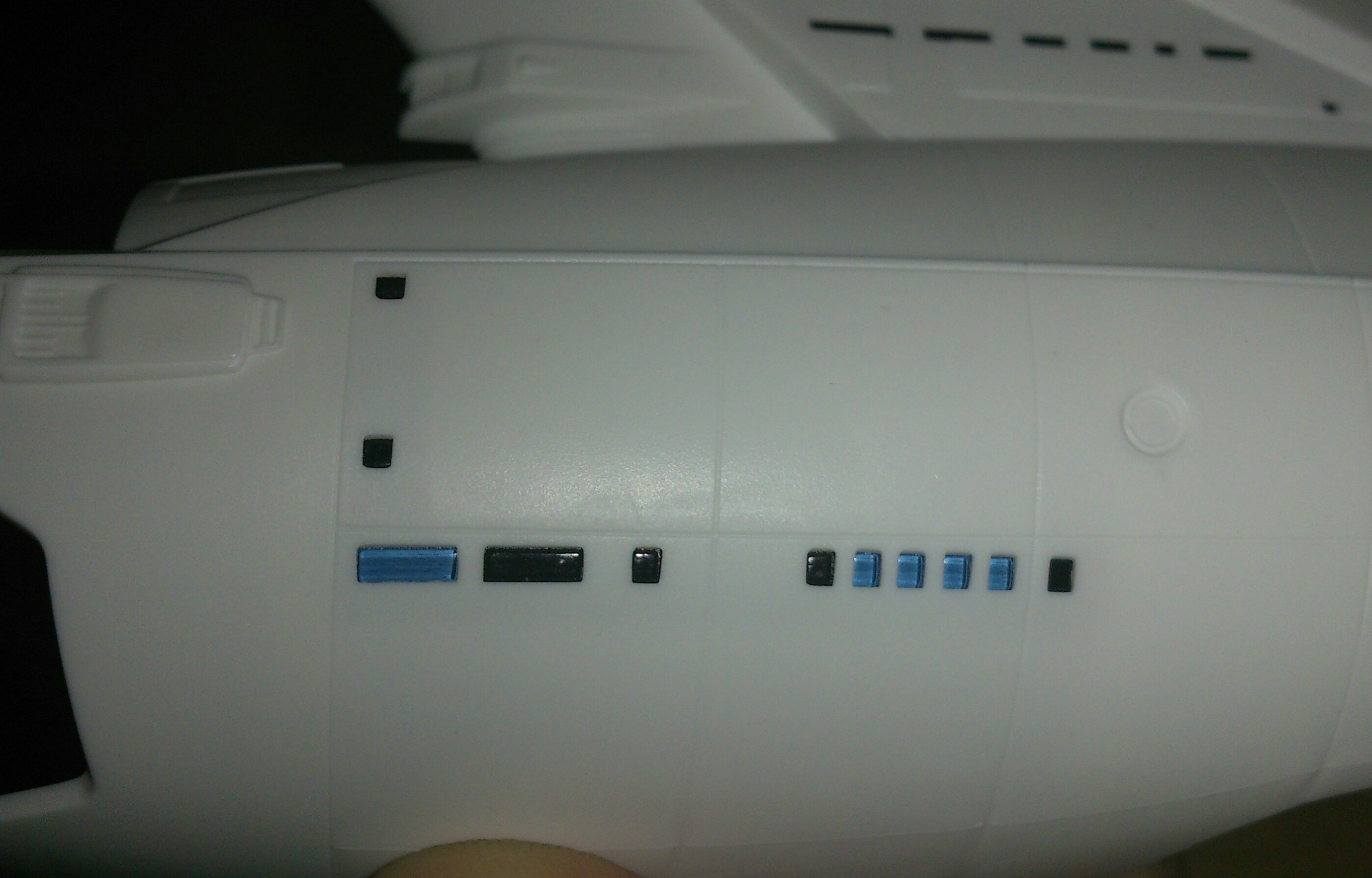

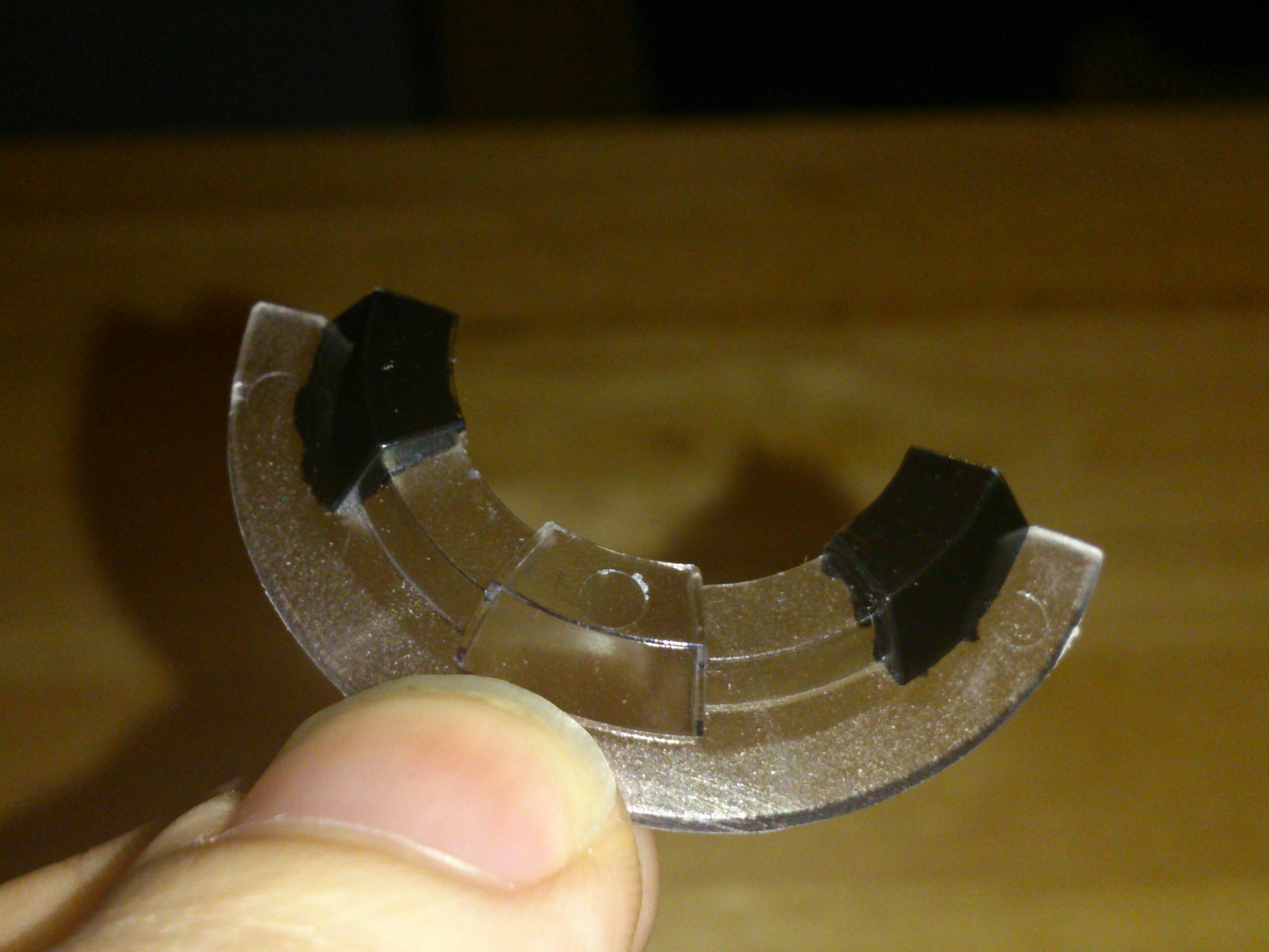

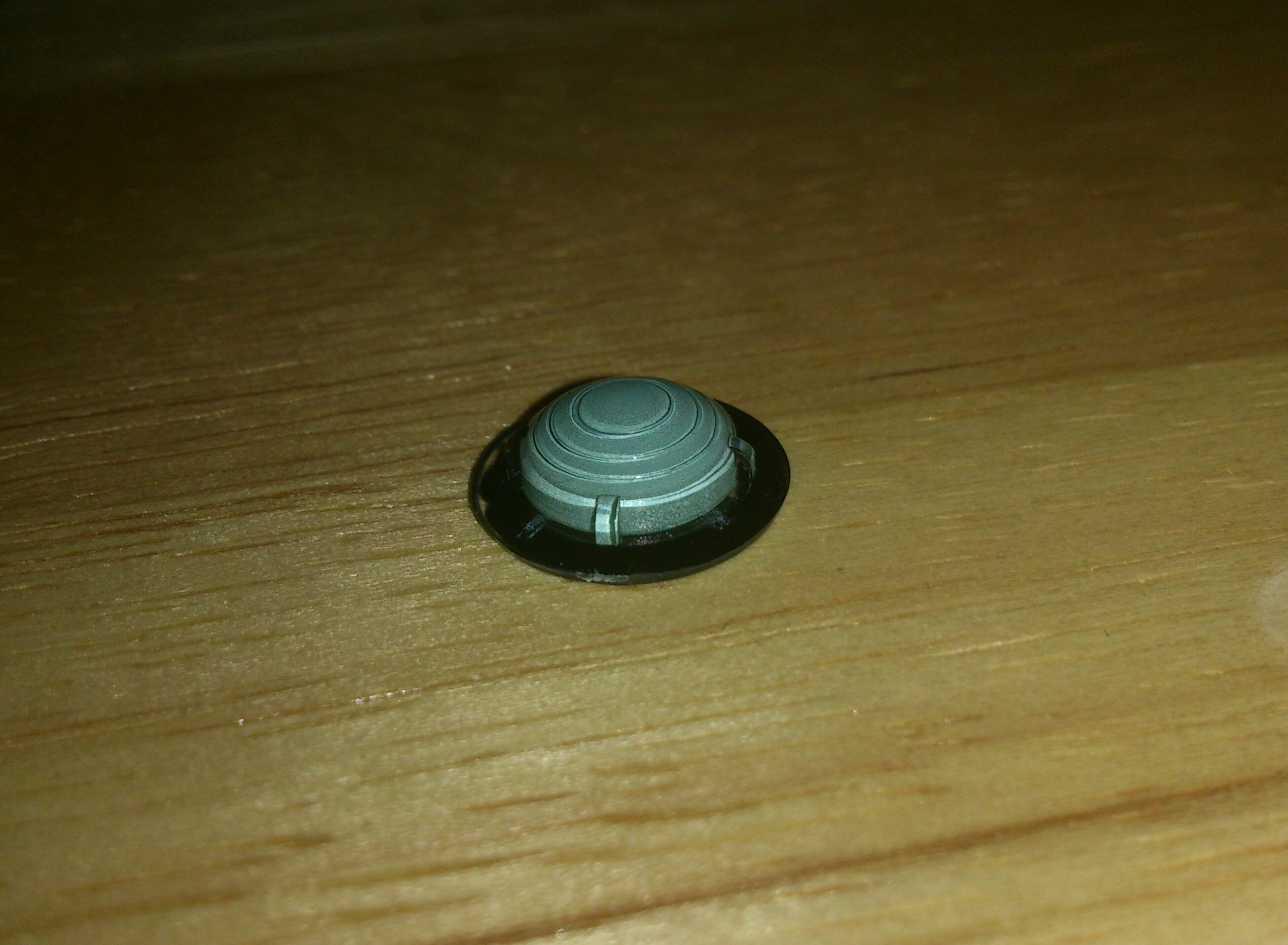

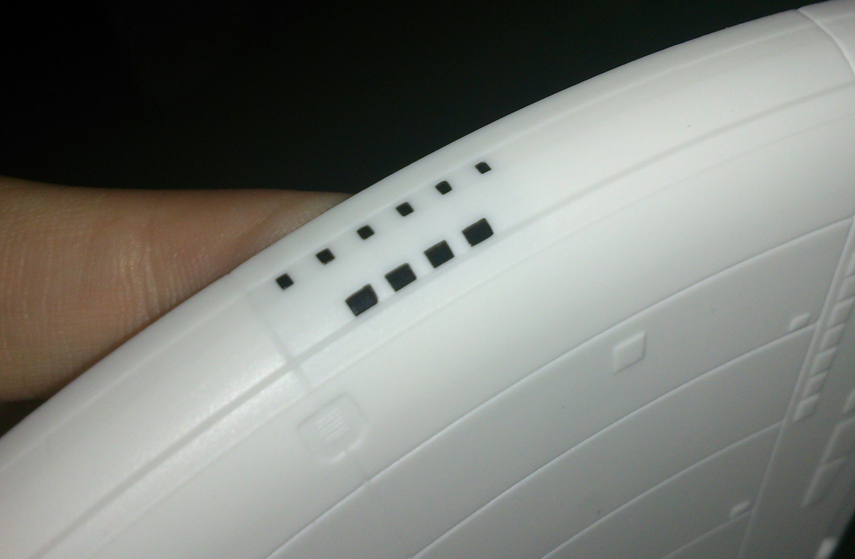

Window effect:
Was achieved by back painting the clear parts with gloss black and light blue,
Same effect was used on the lower sensor dome,

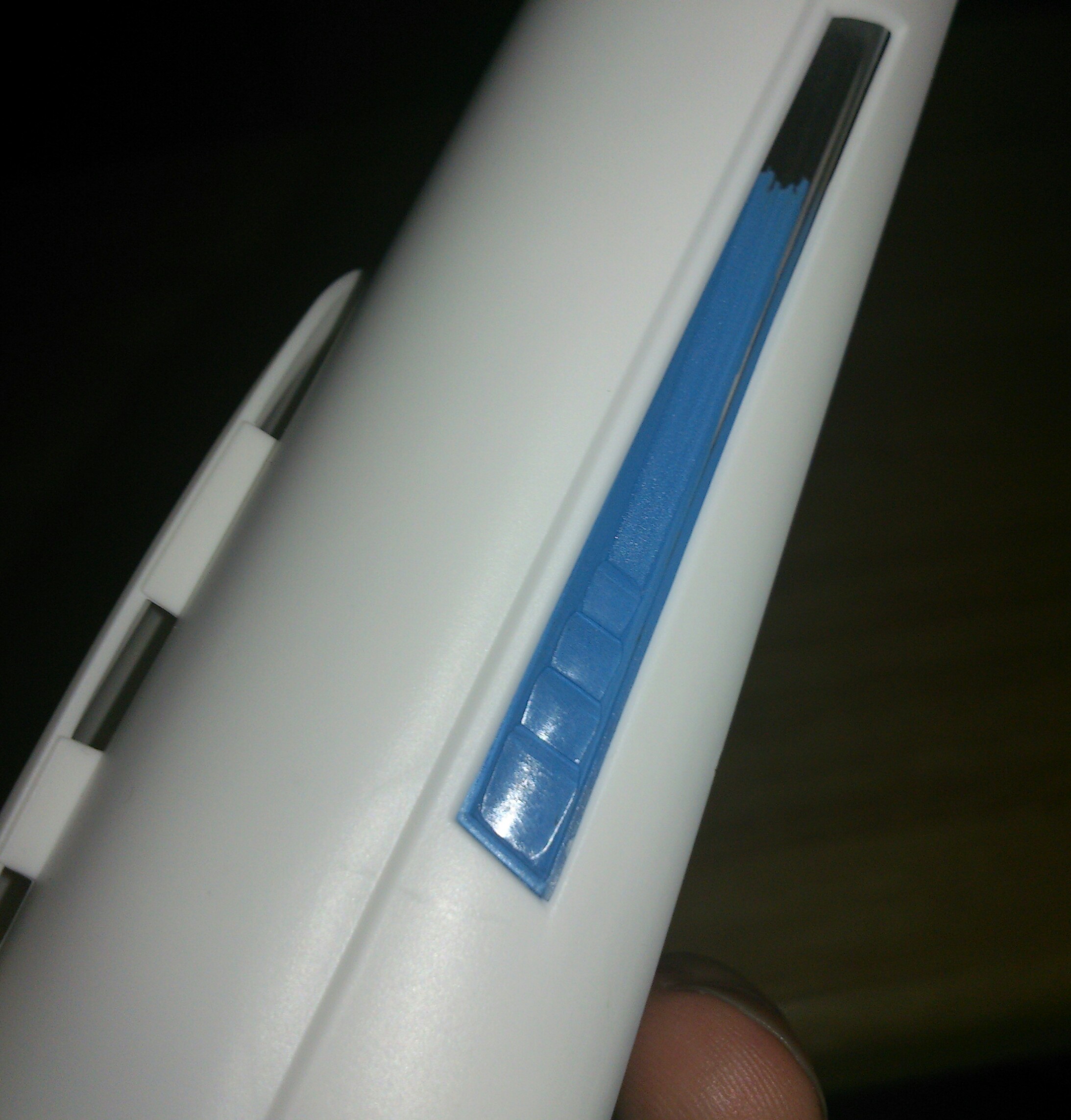

The effect has been used on the vents under the nacelles but the piece needs masking and spraying dark grey from the outside,
The bridge dome and bay windows have been back painted with gloss black and a bright teal colour, though not sure what to do about the central bay window that looks into the bridge,

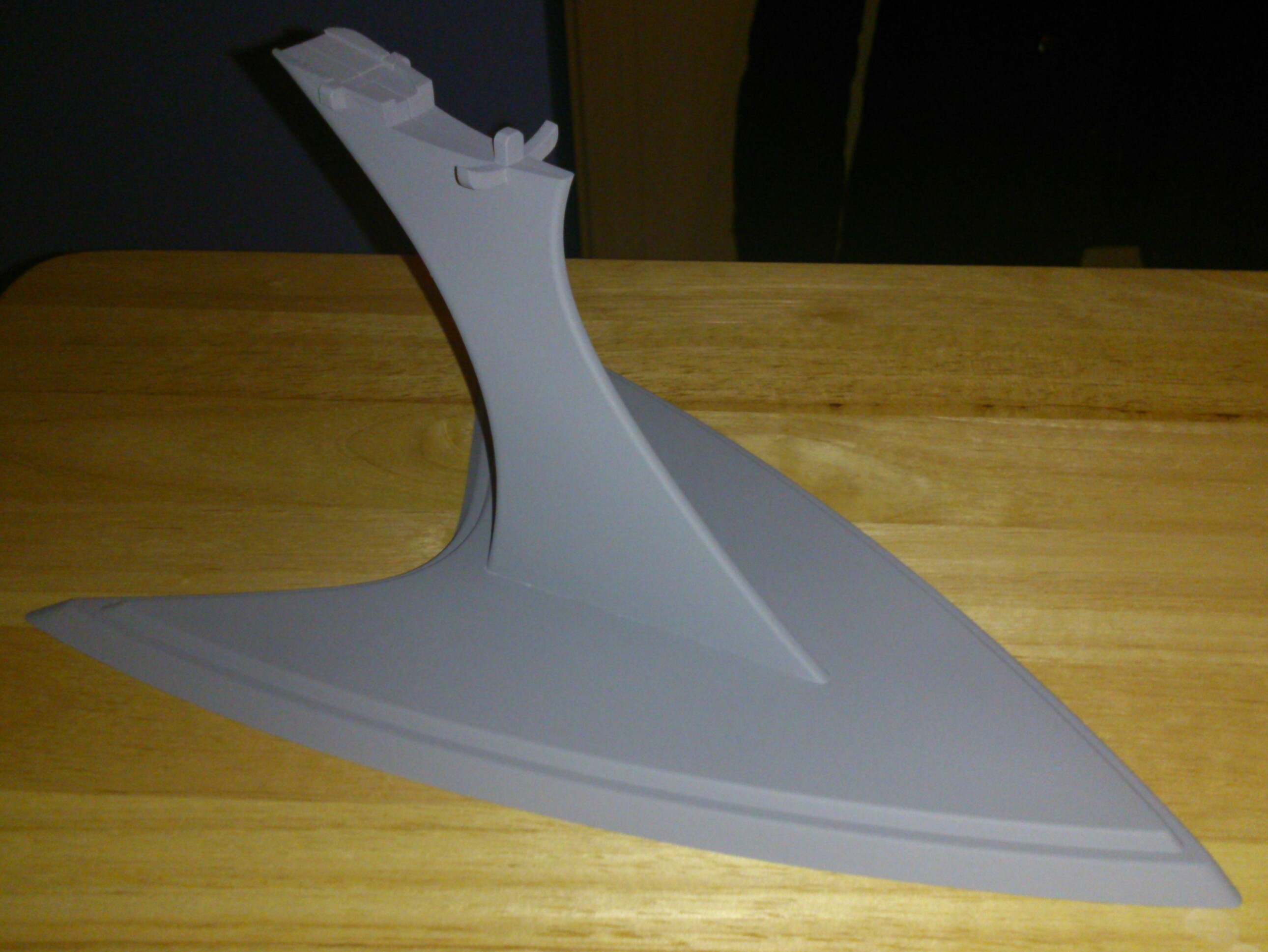

The base and deflector primed and ready for colour coats:
Some of the paints mentioned in my last post, from top left ((matt 55)the teal used for the bridge dome, (50)gloss light blue for windows and sensor dome, (sm314)the beige to replace colour callout J, (91)the steel for base and back painting the bussards, (matt 9)the dark grey to replace the semi-matt black, (7)gloss black used for windows, (sm371)semi-matt light grey for callout A, (sm301)semi-matt white for most callouts, (49)the better colour for callout K):

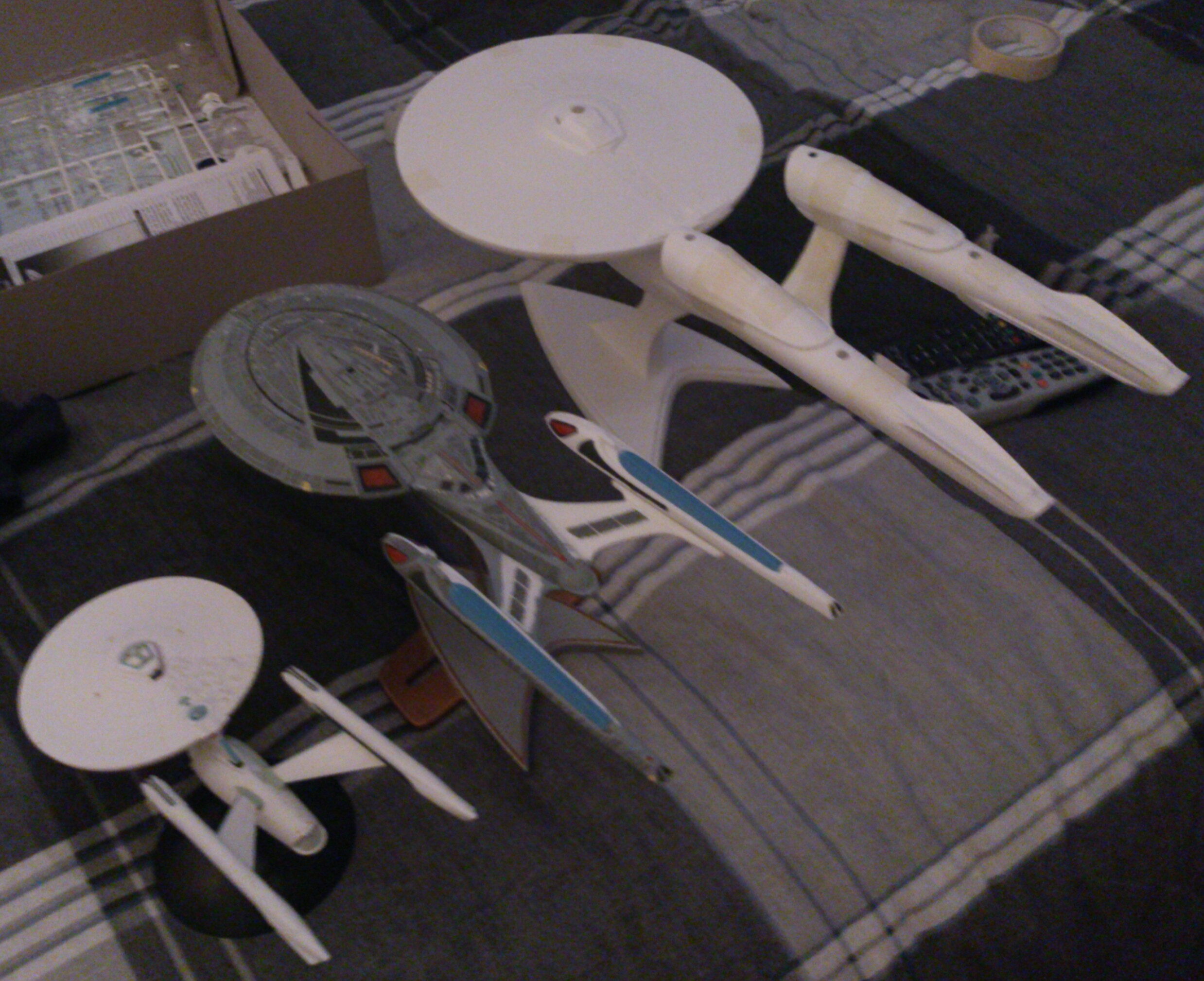

Finally a quick dry test with comparison to polar lights 1/1000 refit and amt 1/1400 ent-e:

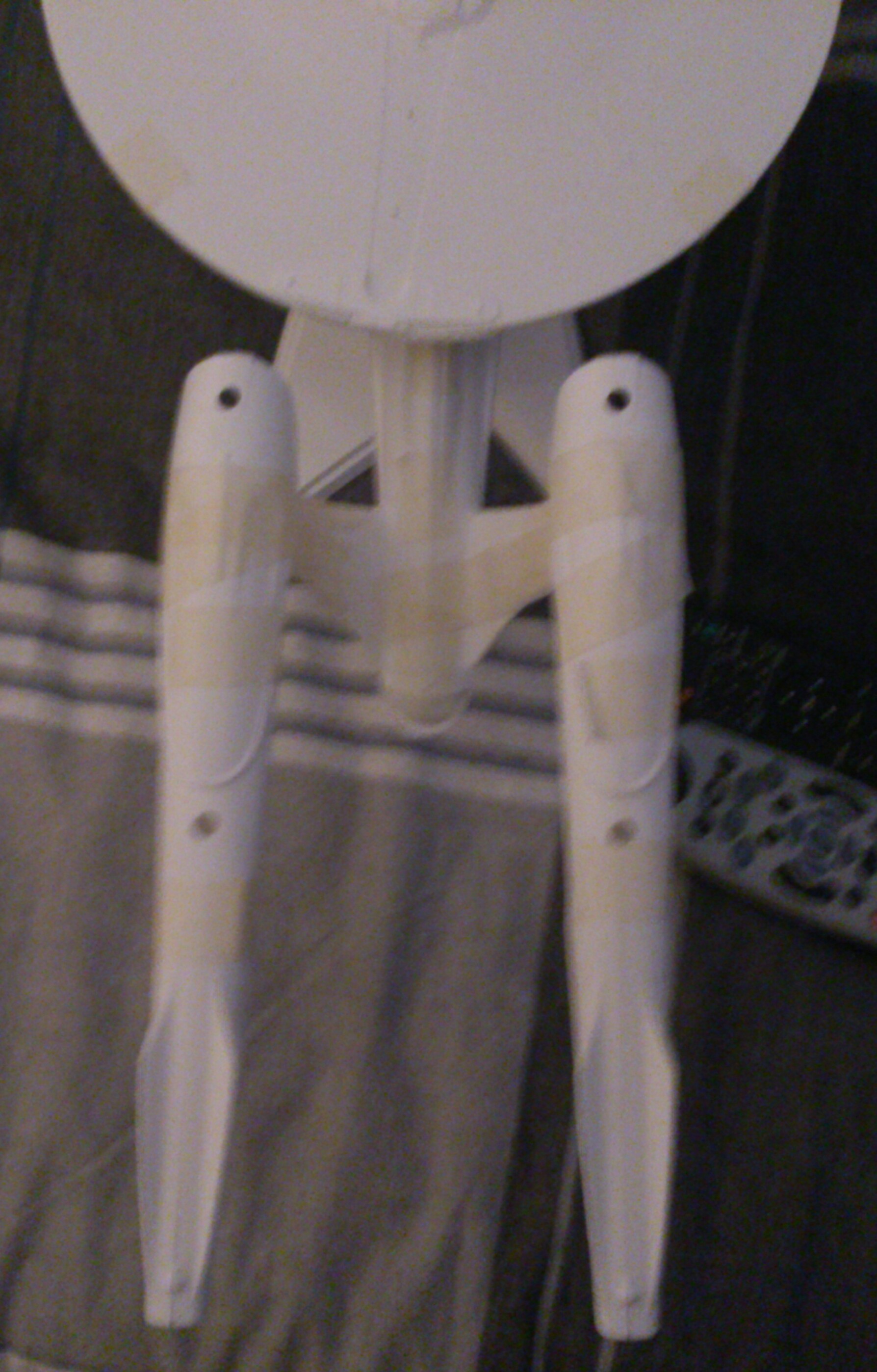

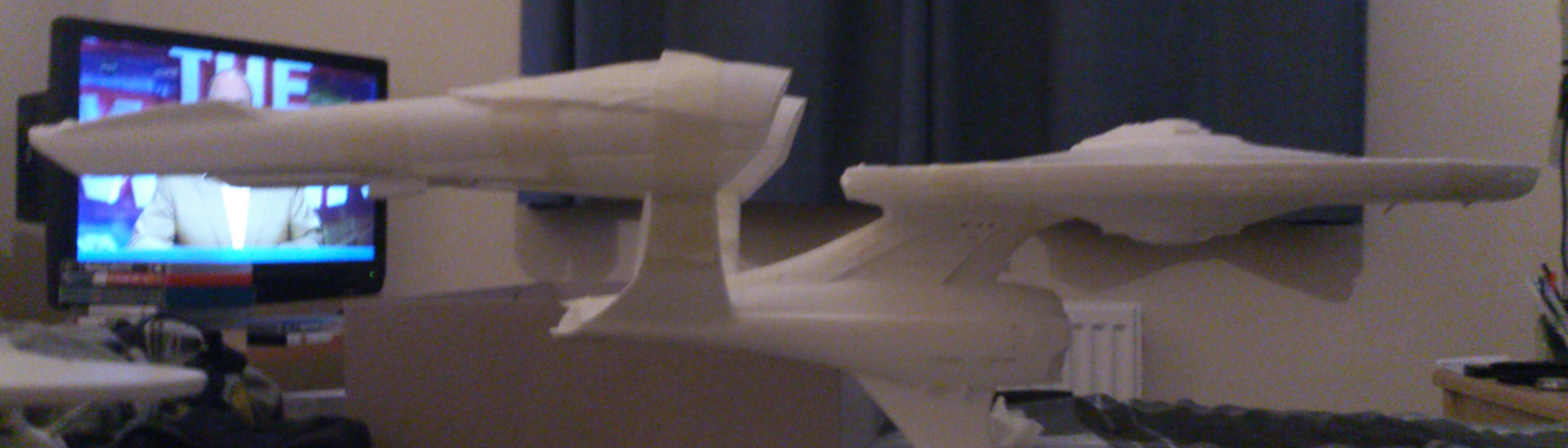

And showing the nacelle droop issue:
Had the pylons taped together pretty tightly and the nacelles secured well but still would not stop drooping and angling away from each other at the back. Has anyone found a solution to this yet as I had an old tos amt kit with a similar issue but never managed to fix it (though that was 10 years ago)?
