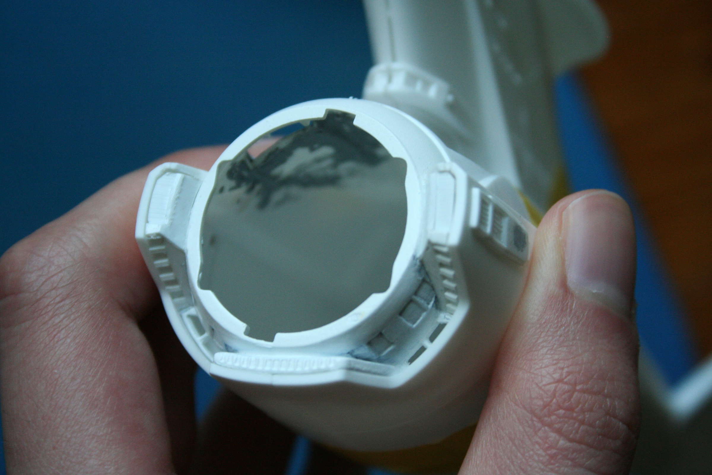

Hi - I am curious on how you did this mod of the deflector piece. I see the photos and am wondering what you used to build it back up, and also why you cut the angles off the side in the very first photo. Did you repurpose those?
I ask, because this seems to be the single most difficult mod and want to have a handle on it. Great work too! Wow!!
The 4 Star, in the meantime, I cut off the whole side panels of the part, as they were totally off. I rebuilt everything from plastic sheet in 0.5 mm and 0.25 mm thickness. And of course, some filler. I don't use "glue", I prefer ethyl acetate. You can hold the parts together, then dip a fine brush into the ethyl acetate and then to the gap between the parts. The e.a. will run into the gap, and slightly pressing the parts together gives a strong connection, the plastic is welded together. After some seconds it is dry enough for moving on.
Here is a picture of the deflector base from 5 minutes ago. It needs just some more filling, then it's finished.
Hope this helps!
Thorsten

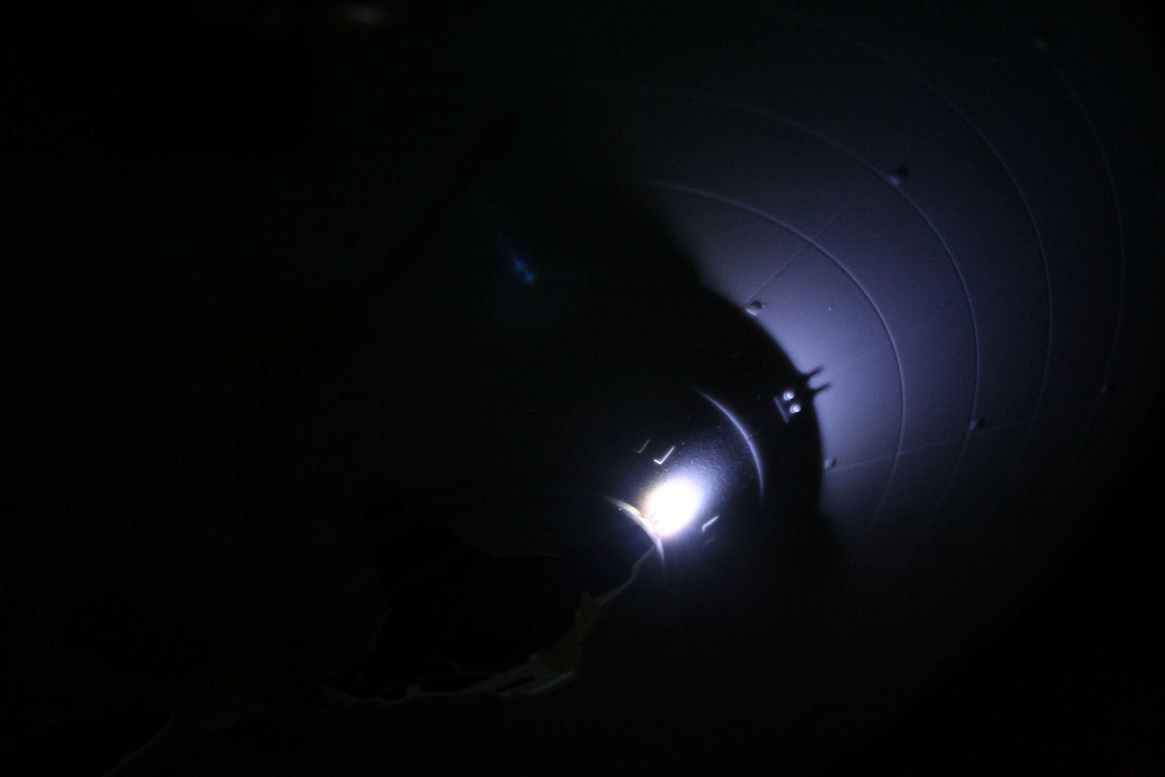

Today I've made good progress. I've built in all the 16 spot lights in the saucer section. I had only 2 where the solder connection broke thereby, but at least I can now finish this subassembly. Here are two pictures from testing two built-in lights in the dark:
(Look at those lens flares - this REALLY is the JJPrise :D)
But sorry, no pictures of all lights turned on at once until the interior is finished and the resistors are in place. Don't have enough alligator clips.

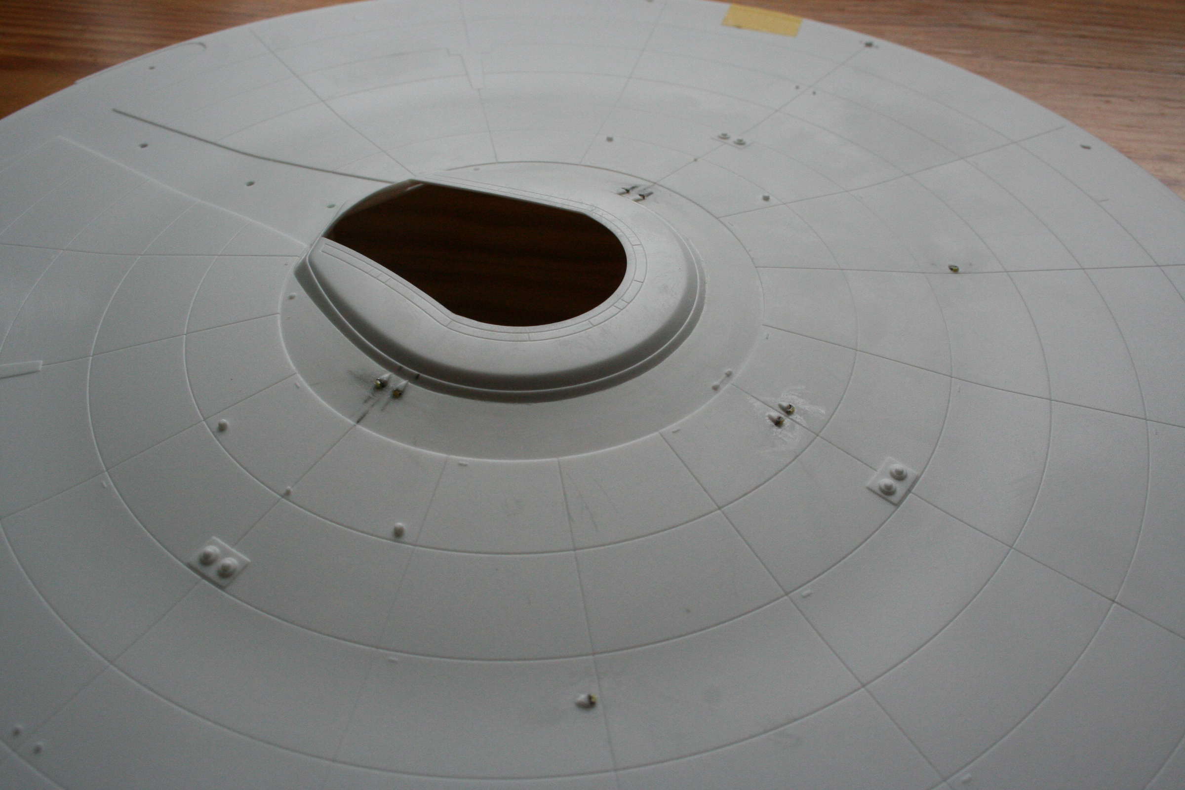

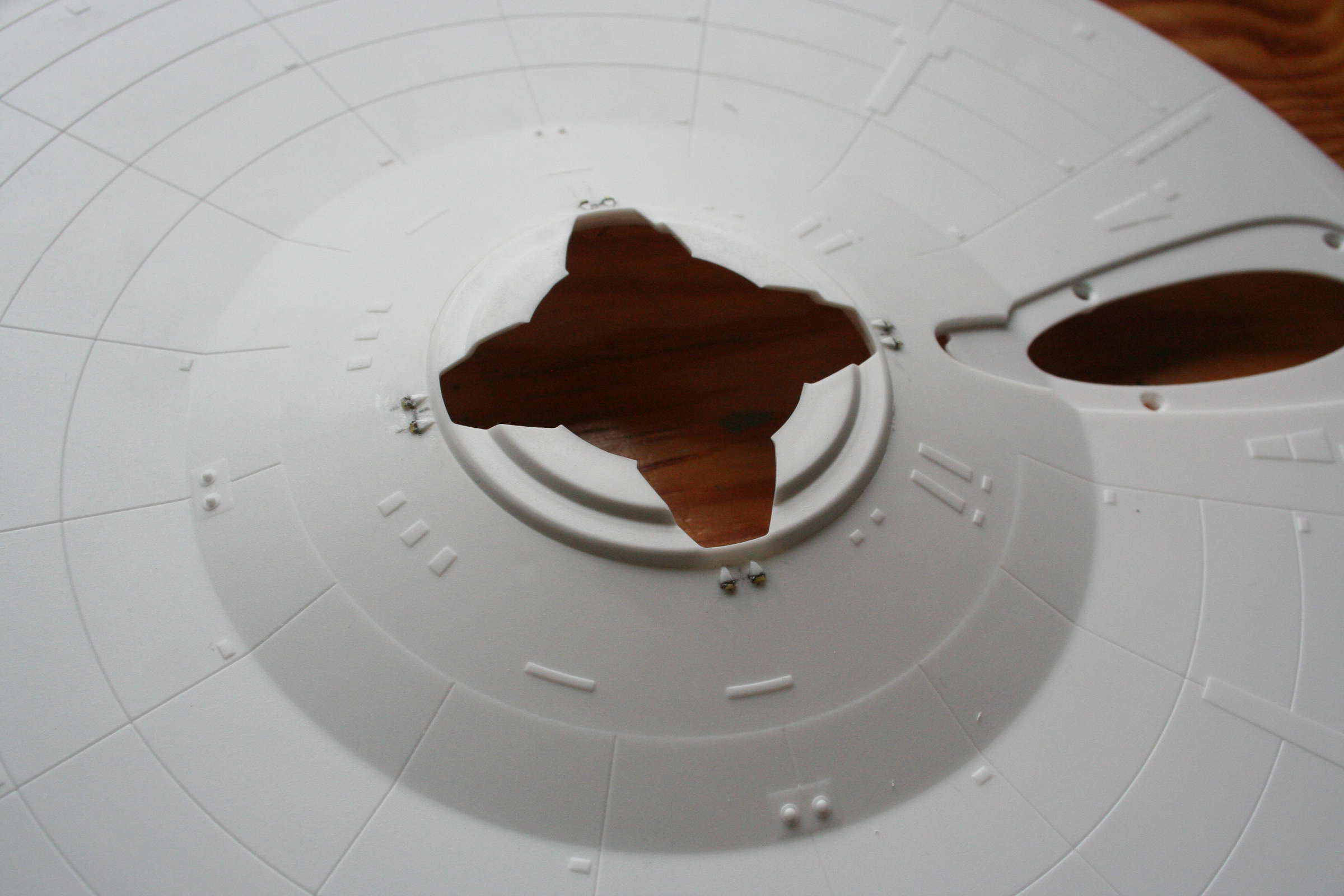

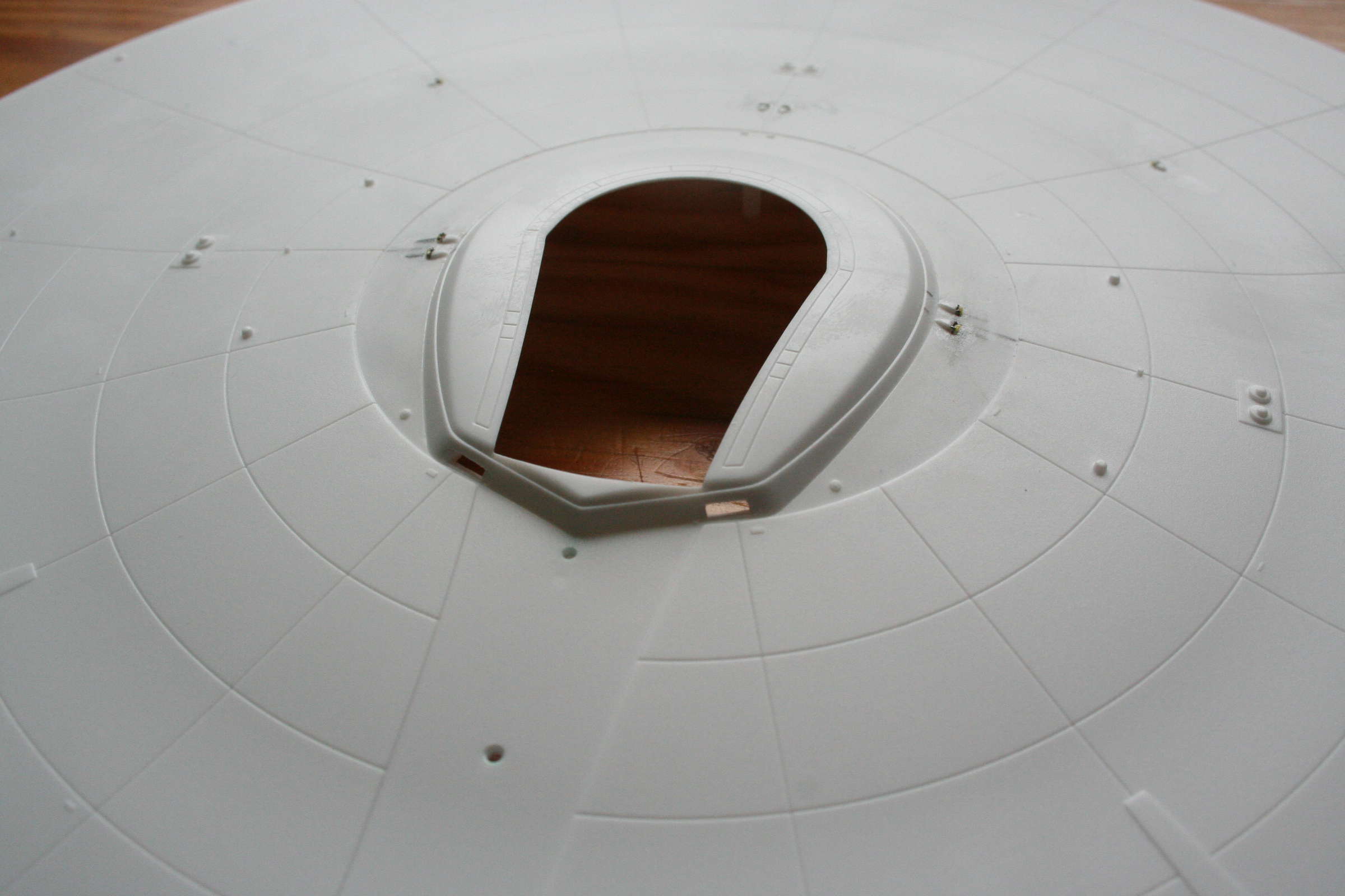

Here are some daylight pictures of the spot ports.
The ones around the bridge and on the bottom are not present in the kit, I added them from small triangles of 0.5mm plastic card. The raised panel detail around the bridge is mispositioned, I removed it to not collide with the spotlights. Probably I'll rebuild them from 0.25mm plastic sheet.
The LEDs are put onto the surface of the saucer as seen in the pictures above, and are glued with CA. It needs some sanding to get the excess glue away. Then I'll putty the LEDs to the surrounding plastic to get a smooth finish.
Hope this helps!
Thorsten

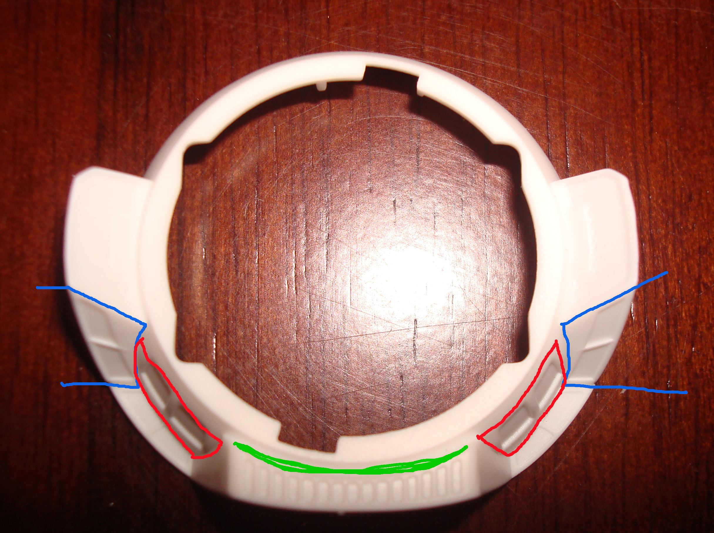

Hi - hopefully this will be my last question on the defector mod. Here's a pic of the original piece. I see you first cut the blue, then the red sections.original piece call out.jpg
Where I'm getting lost is what you did in the green section. You gave that grill line breathing space and I cannot figure out how. Also, did you reduce the size of the indents to fit 4 in? What I'm shocked at is how you made more room where there was none!

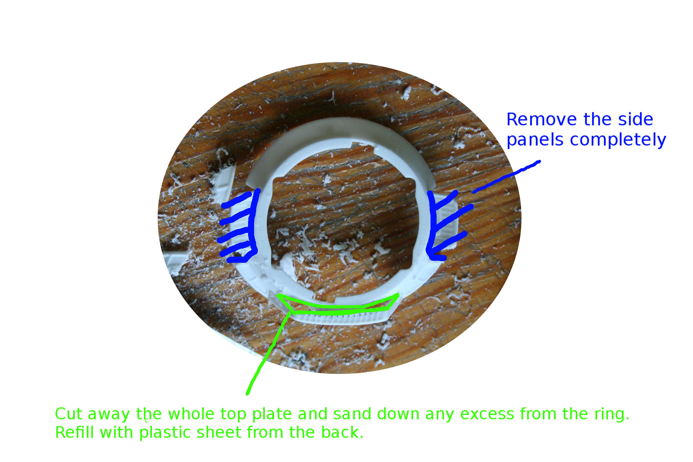

Hi,
don't worry about questions, as I understand, this is what forums are for! :)
Do these pictures answer your questions?:
I wish I had taken more pictures of the process... If it's not clear, ask again and I will try to take new pictures of the part, but it's too dark right now.
Cheers!
Thorsten
Awesome - so basically keep the ring and trash the rest, except keep the grill line at the bottom. Ballsy!
Also, do you have a HERO picture that you used as reference to discover the inaccuracies?
Yes, that's the way to go, imho. At least it worked quite well on mine :rolleyes

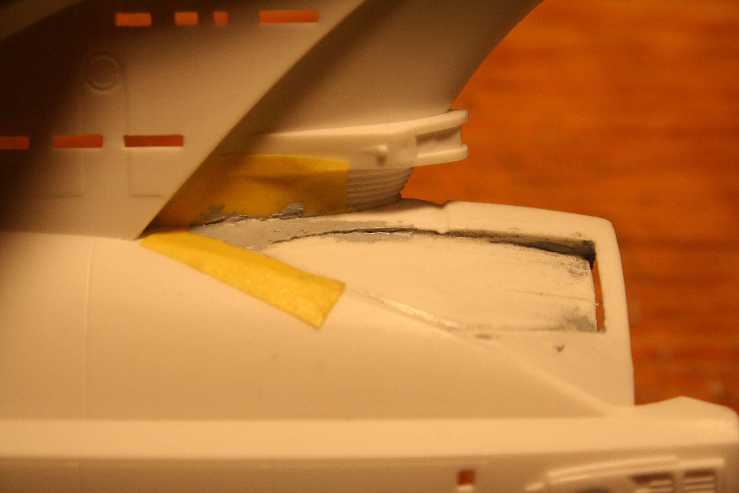

Please, can you explain what you mean with "HERO picture"? I have 100 MB of screenshots from the 2009' movie and from this Blu-Ray-extra feature you also referred in your video. For the deflector base area, the scene at 3:50 of this virtual inspection is pretty useful as is a high-res section of the famous render of the Enterprise in front of Saturn. I didn't bookmark the link, if you need it, drop me a PM with your email address and I'll send it to you.

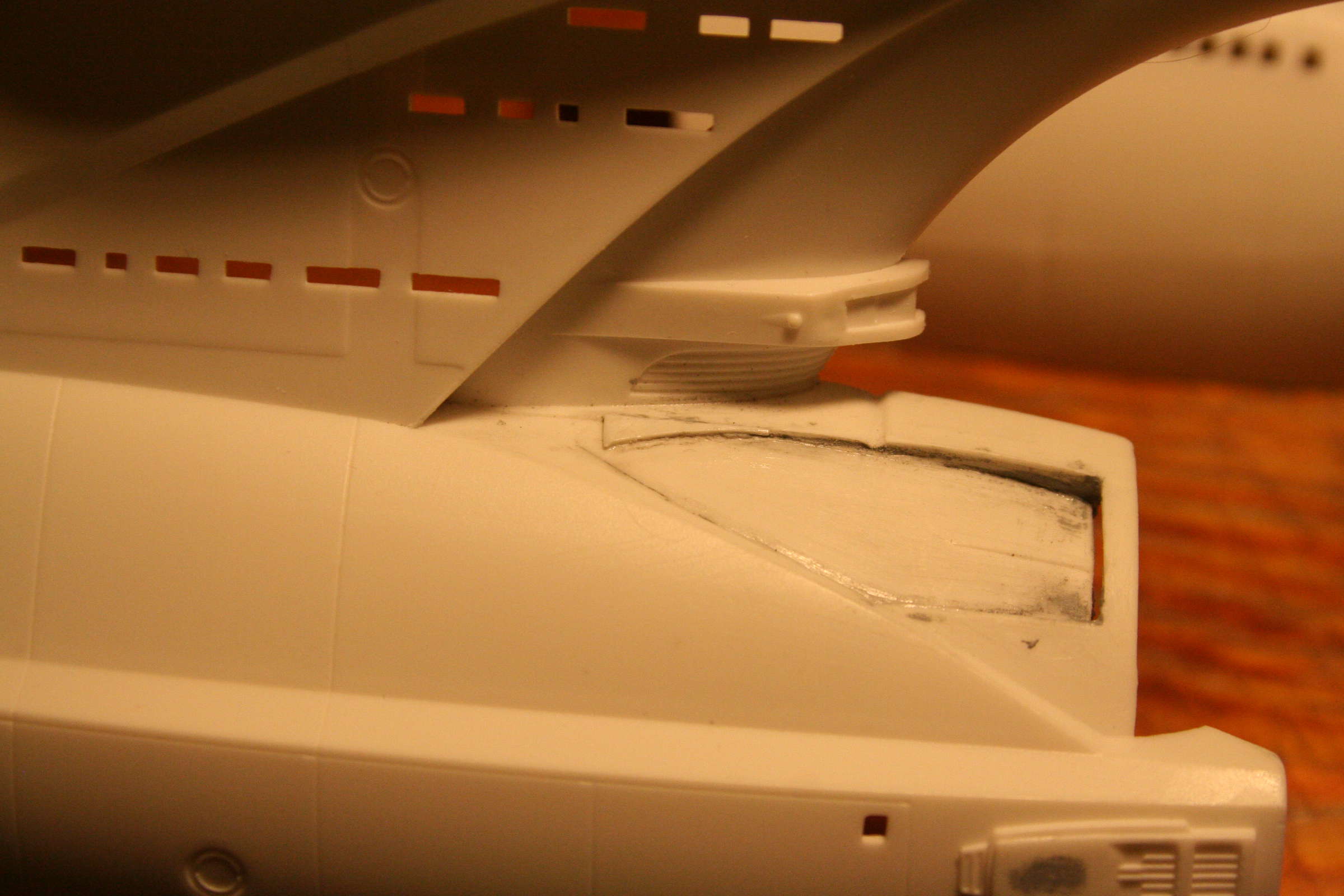

BTW, there are some additional details in the area below the torpedo launcher which I'm working on in the moment:
- The upper border of the recessed area is not straight but curvy at the end. I realized this too late to just make the cut curvy, so I have to modify the line by adding material. The first picture shows small parts of plastic sheet glued into position, the second picture shows the area covered with filler.
- There is an additional groove in front of the torpedo launcher on top of the hull. This can be filed in very easily.
Thorsten

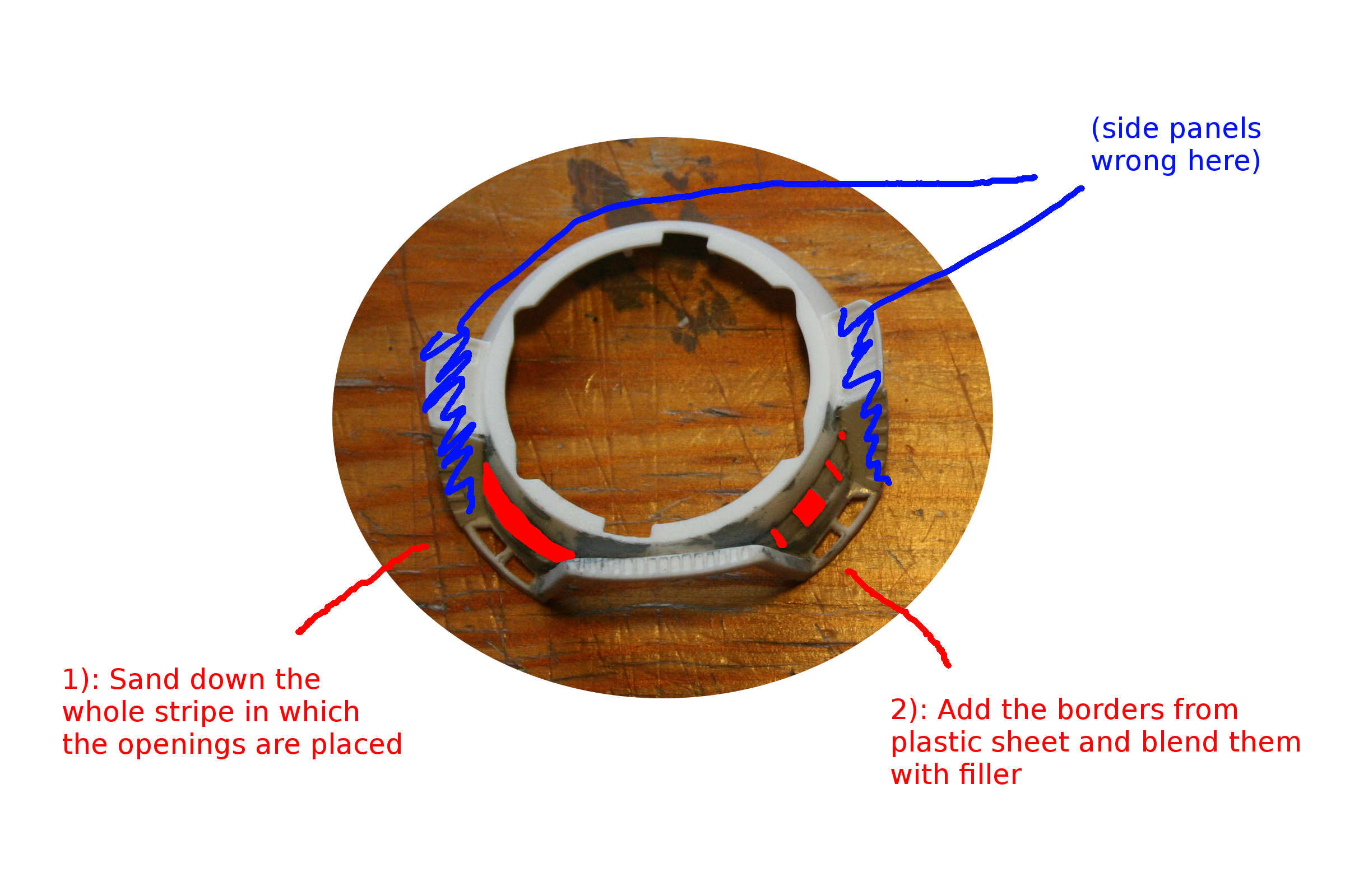

The first version of my modifications of the side panels was off, so there might be some confusion because of that. This shows the final configuration:
uss-enterprise-2009-revell-review-build-ent_stid_rev_build_020.jpg-195197d1370713277
http://www.therpf.com/f11/uss-enterprise-2009-revell-review-build-184688/index4.html#post2932264
This shows it after the first (wrong) modification:
uss-enterprise-2009-revell-review-build-ent_stid_rev_build_007.jpg-187070d1369091215
http://www.therpf.com/f11/uss-enterprise-2009-revell-review-build-184688/index2.html#post2906309
The groove under the torpedo launcher isn't there in the kit - I added it, it's part of the modification work. You can see it in some scenes of the movie and the virtual inspection rather clearly.
I doubt there is any difference in our kits, there is just some drilling, cutting, sanding, filling, and lots of more sanding and drilling between them ;)

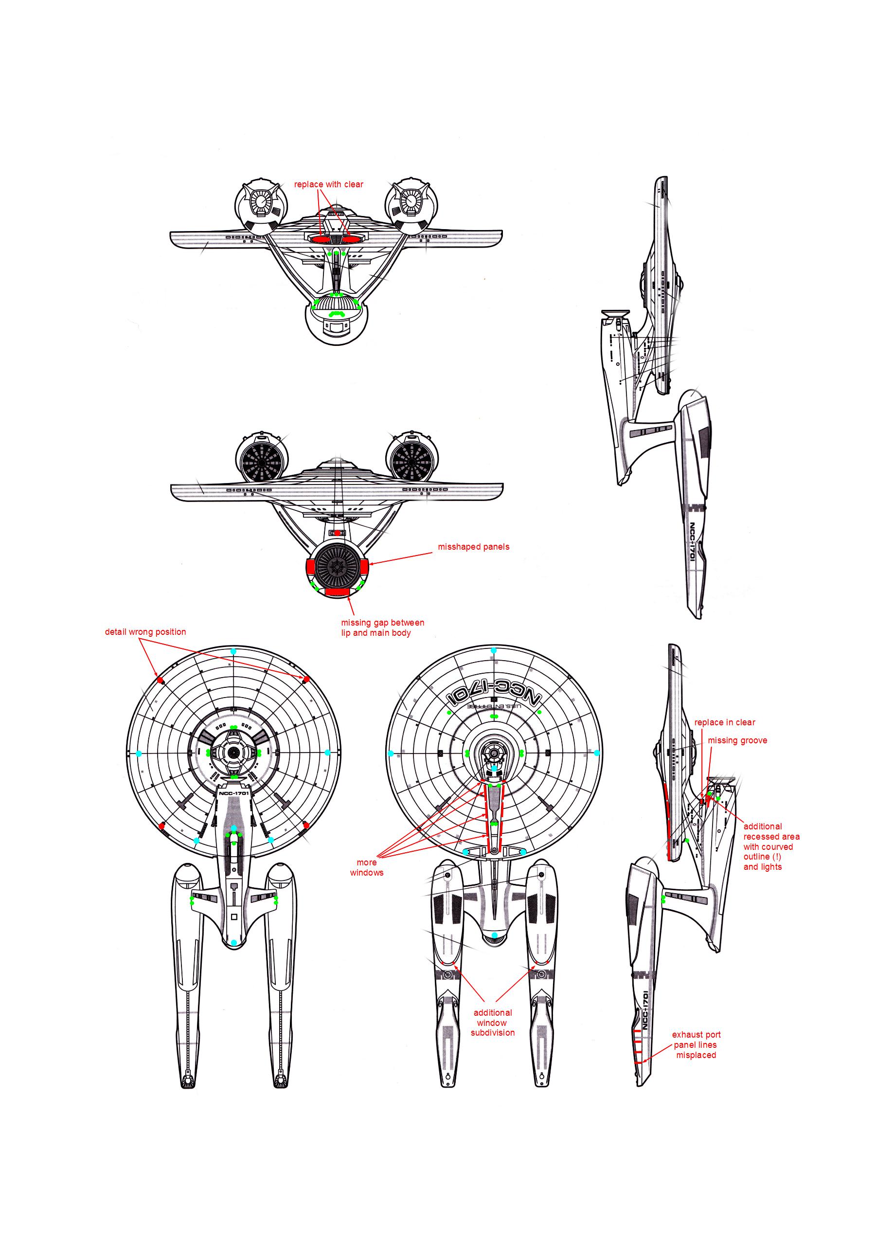

BTW, here is the updated modifications sheet for reference:
Cheers,
Thorsten
